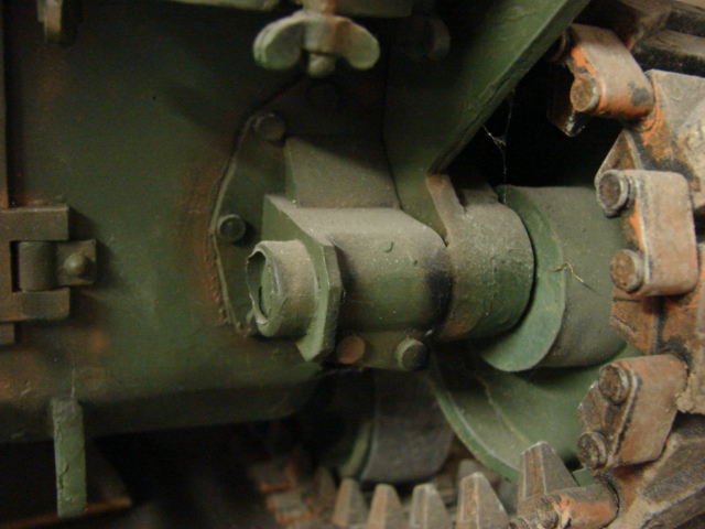

  1. Viper M4 Sherman Idler Mount Quick Fix set. Set comes with two resin Hex heads, and two plastic discs. This set is a simple quick dress up kit for the Viper Idler Mounts.
Stock Viper Idler Mount:
Modified with the dress up kit:

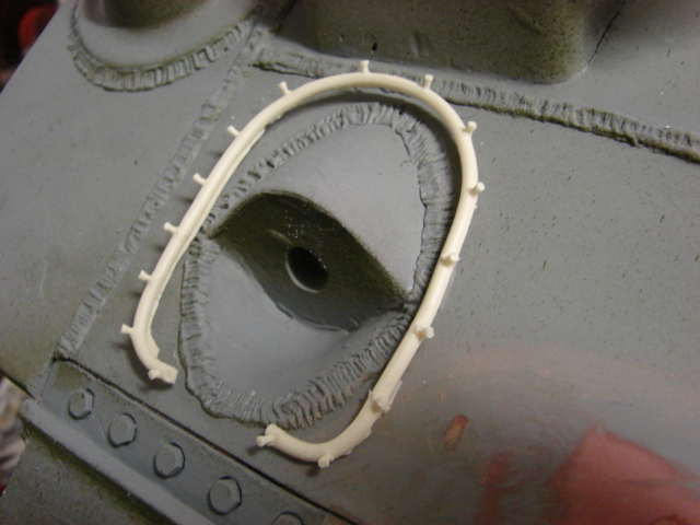

For the engine air intake mounts to be installed I needed to drill out the positions that the intakes would be mounted to. On these shermans the intakes are also counter sunk into the rear deck. To do this I engraved the counter sink with a dremel.
The intakes now have the proper height and seam around their base.
