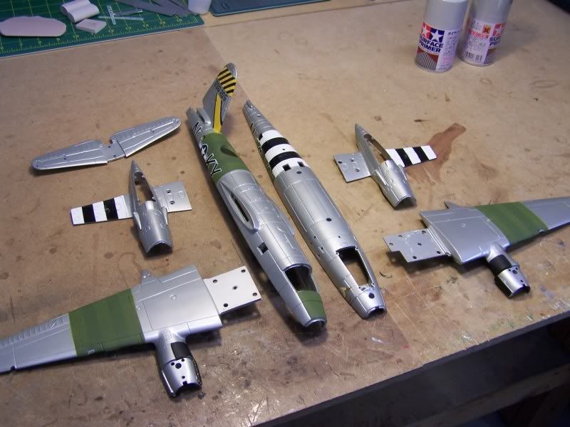

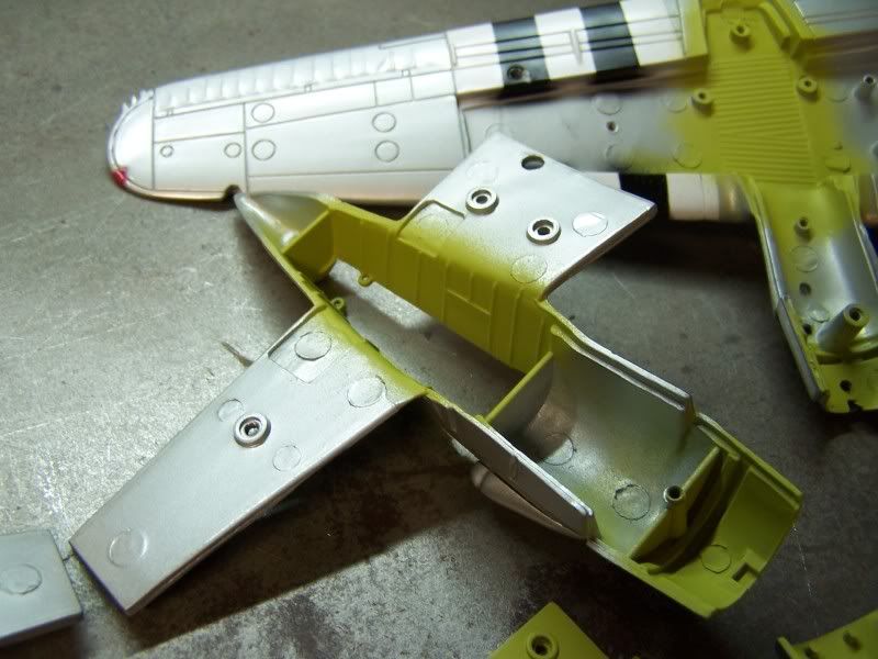

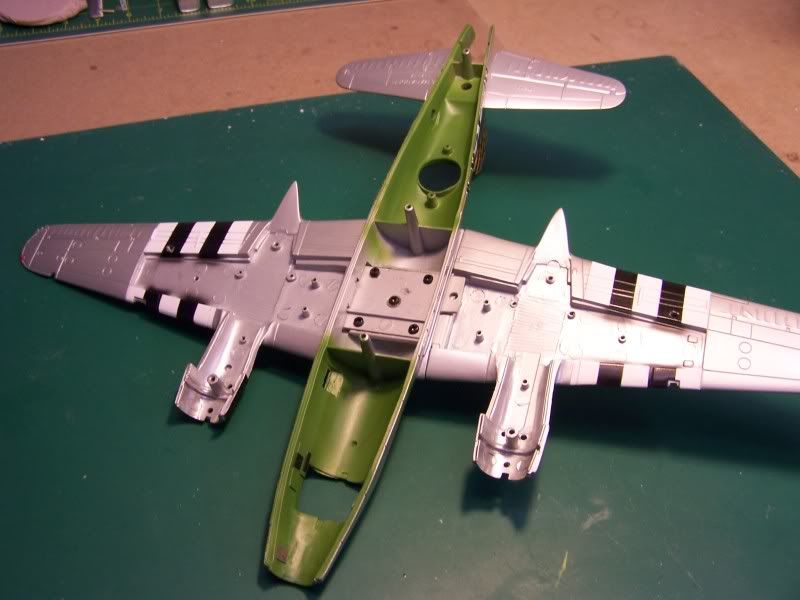

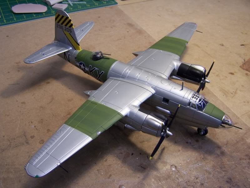

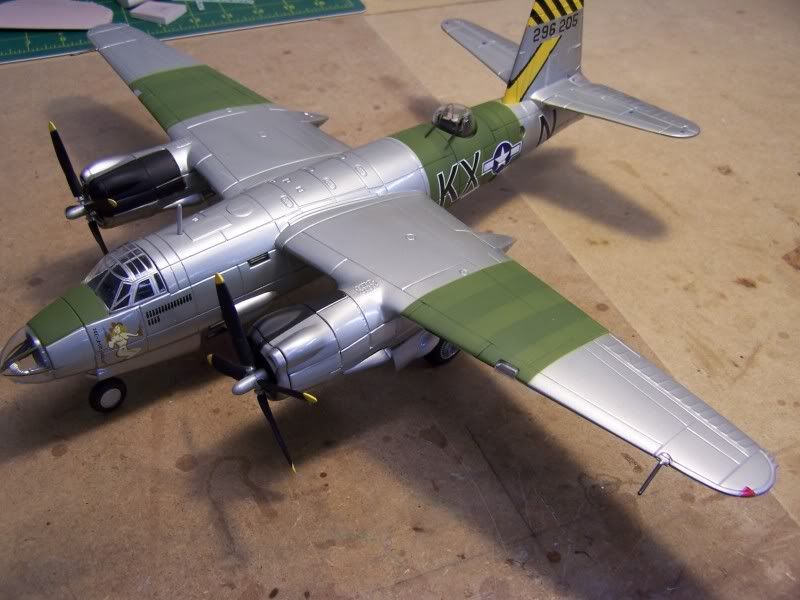

A friend of mine has contracted me to detail several Franklin Mint Aircraft. Starting with the B-26 Marauder. He supplied me with the aircraft, several sets of decals, parts from other Monogram kits, and resin parts. Spent a few hours today disassembling the die cast beast.
Before

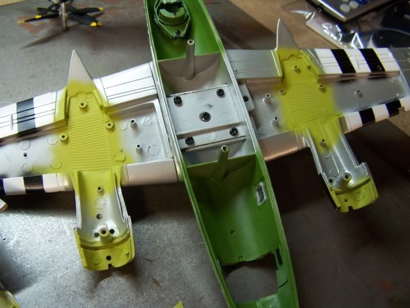

Tail Section

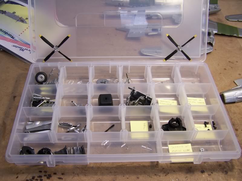

Completely disassembled

Wow thats cool, before I knew how to build, I use to buy those. I now know where they are made.[:)]
Gonna fill thse panel lines? [:D]
I have to agree with Hans. The panel lines of die cast models are really wide. I guess it is a casting problem with metal. Even the cars have them.

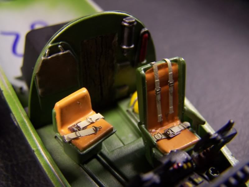

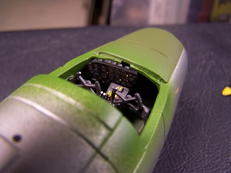

The cockpit is just about complete
Cheers
A HUGE improvement Rob [Y][Y]

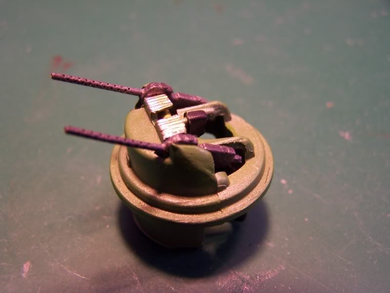

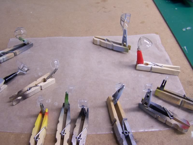

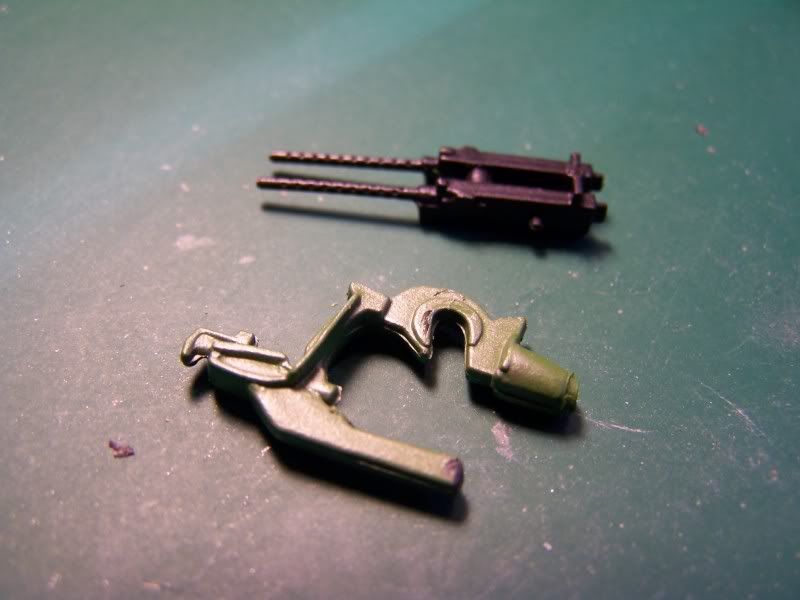

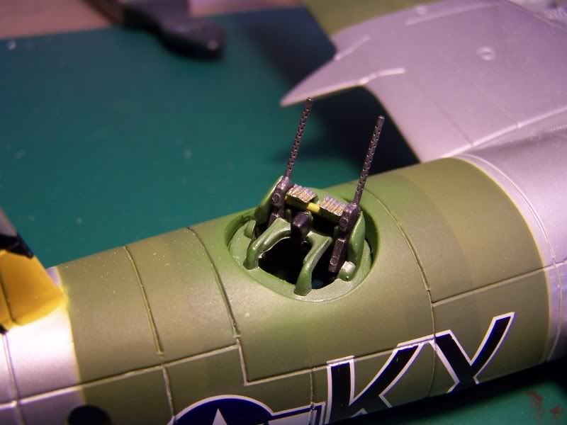

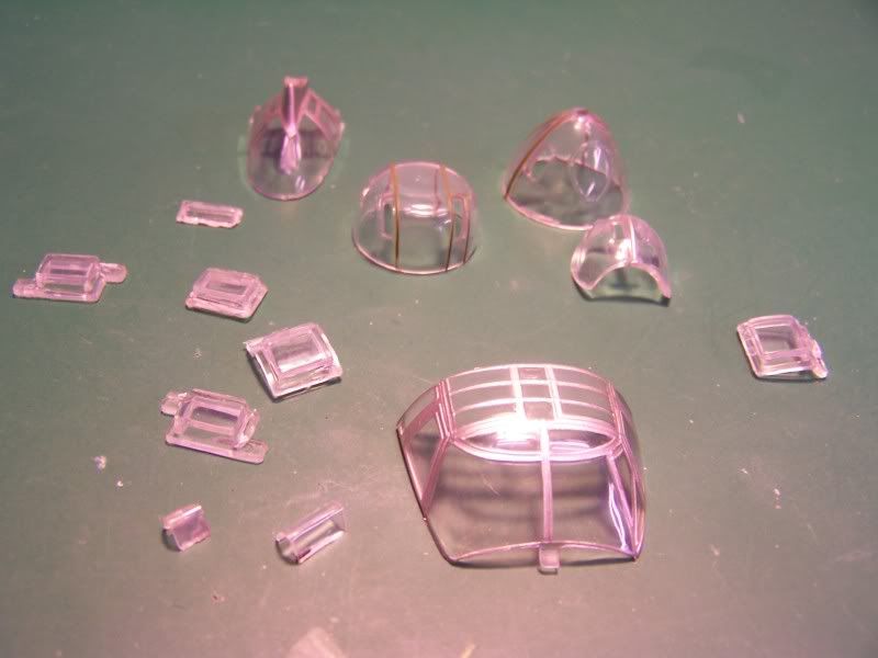

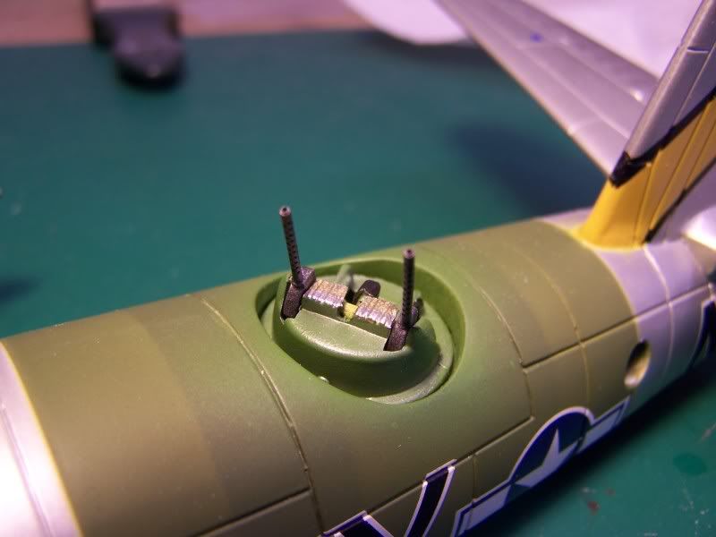

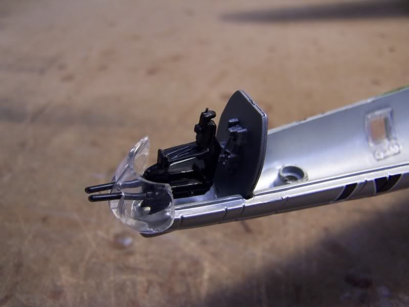

Spent a little bit of time today working on the B-26. All the clear components were futured and the tail gunners position was painted with new gun barrels added.
Before coating
After coating

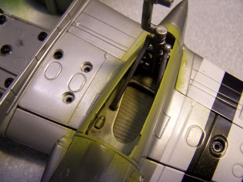

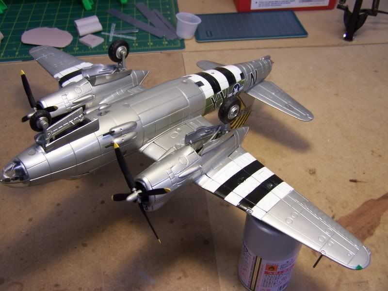

Reinstalled the Wings
Top Turret is complete. I’ll install the glass after she’s painted.

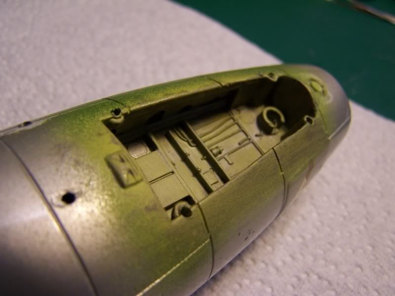

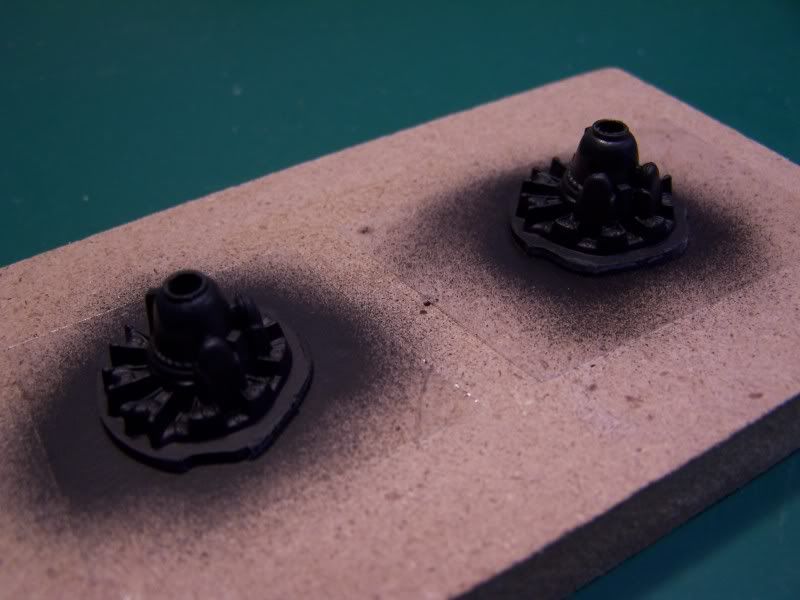

Started the enigines today as well.
Cheers
Nice work so far Rob. Keep us posted.
Regards, Rick

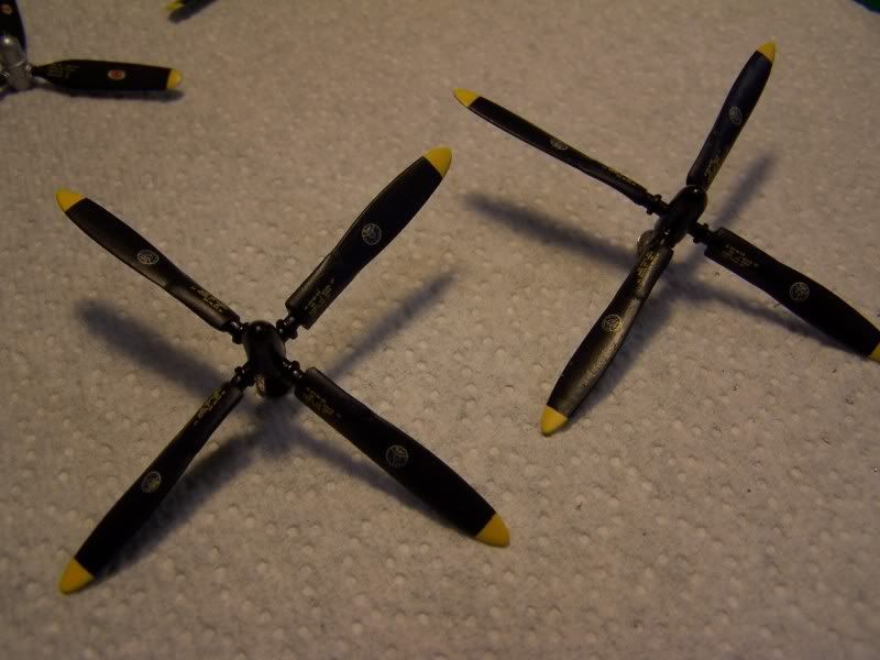

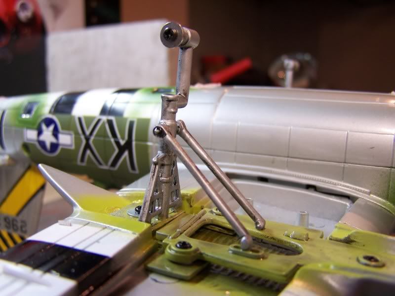

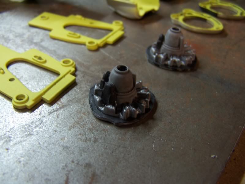

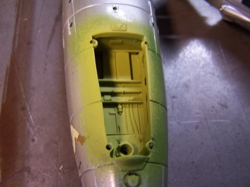

I finished up the engines today and painted the gear wells. Installed the windows into the fuselage and painted the tips of the props yellow.
Merry Christmas

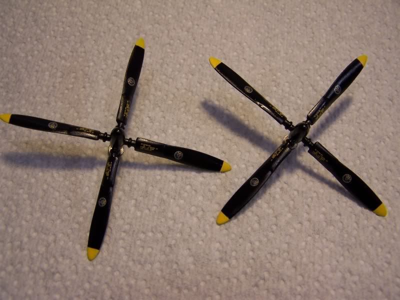

I started weathering the wheel wells today and applied the decals to the props. Dull coat will follow tomorrow.

Props are ready for weathering.

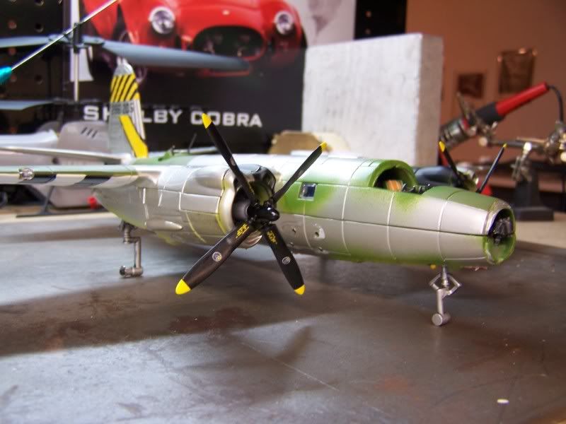

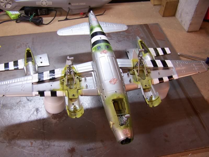

Filled some seams, and holes, and attached the mains today.
Cheers

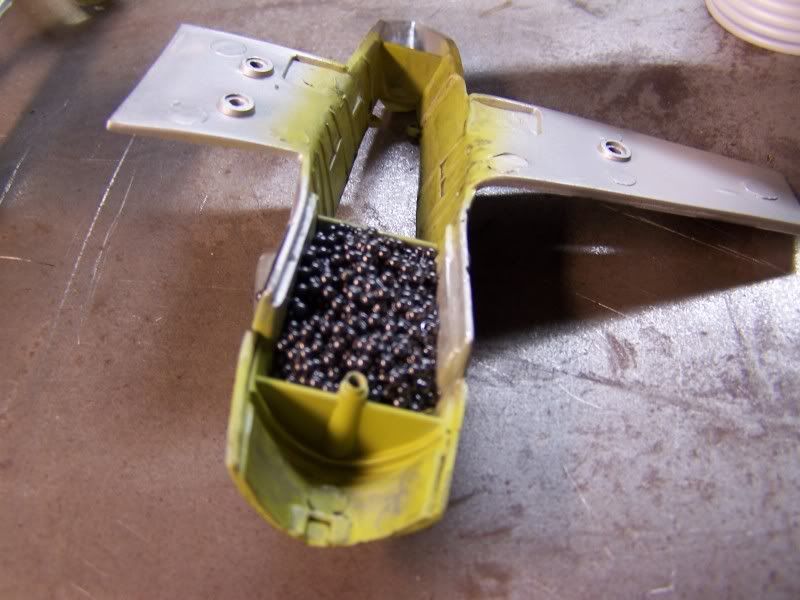

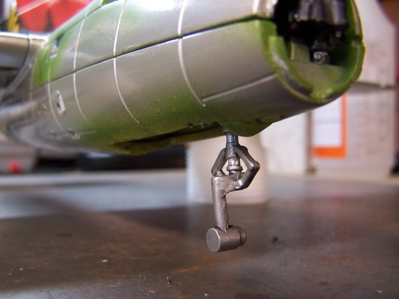

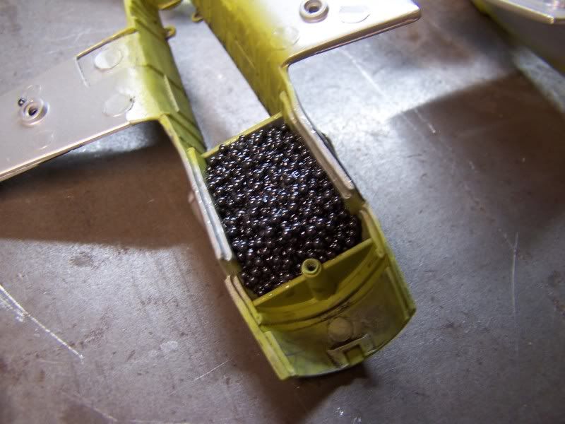

Added some lead weight today to ensure she sits on the nose gear.
Thanks for looking
Cheers
Thats alot of lead, she must weigh a tonne by now. Looking good so far. are you going to leave the exaggerated panel lines or smooth them off? Cant wait to see more.

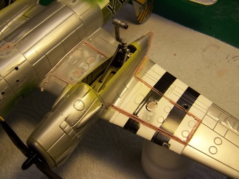

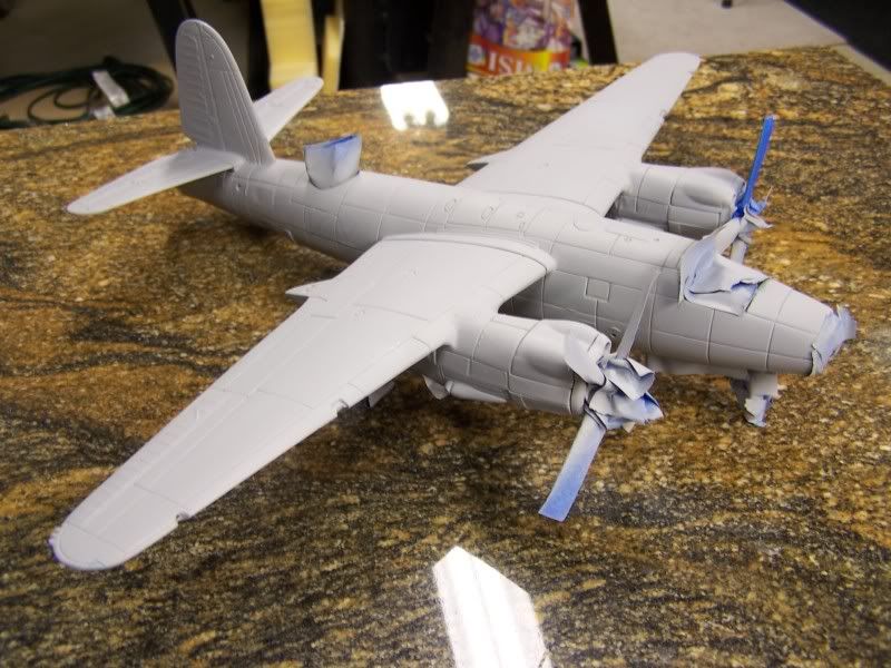

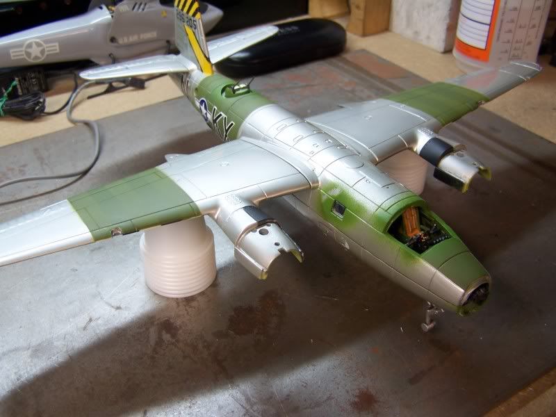

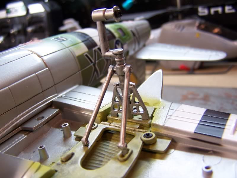

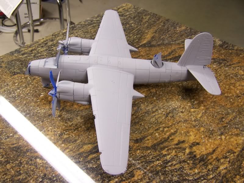

Started working on the seams. Using bondo, I fill the seam them just as it starts to kick, run a scribing tool down the existing seam. When done, all the seams should be balanced out!
Cheers
She’s 90% ready for color. Working with a Die Cast model requires a new method of attach when painting. Almost everything has to be assembled prior to paint.
Cheers
Way to go Rob!
Great to watch you work. Final finish? Thanks, Paul
