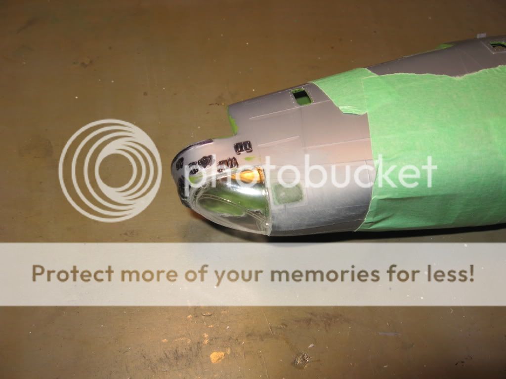

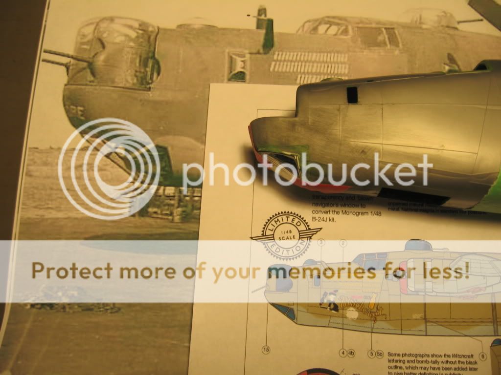

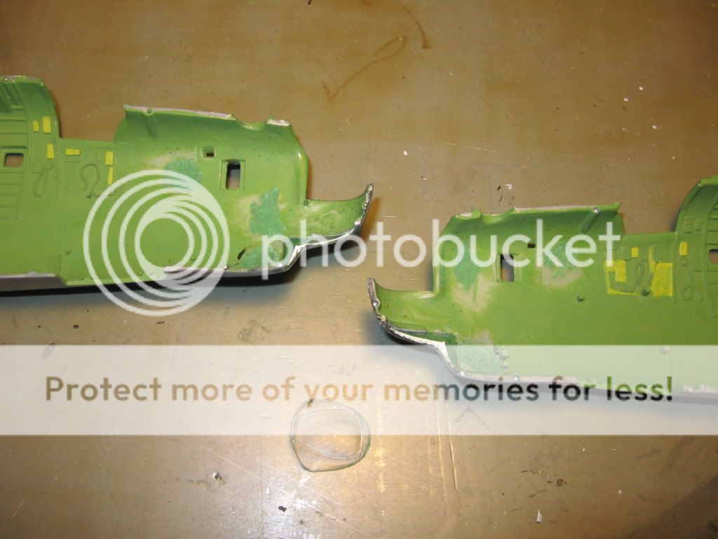

Here’s the latest on my build.

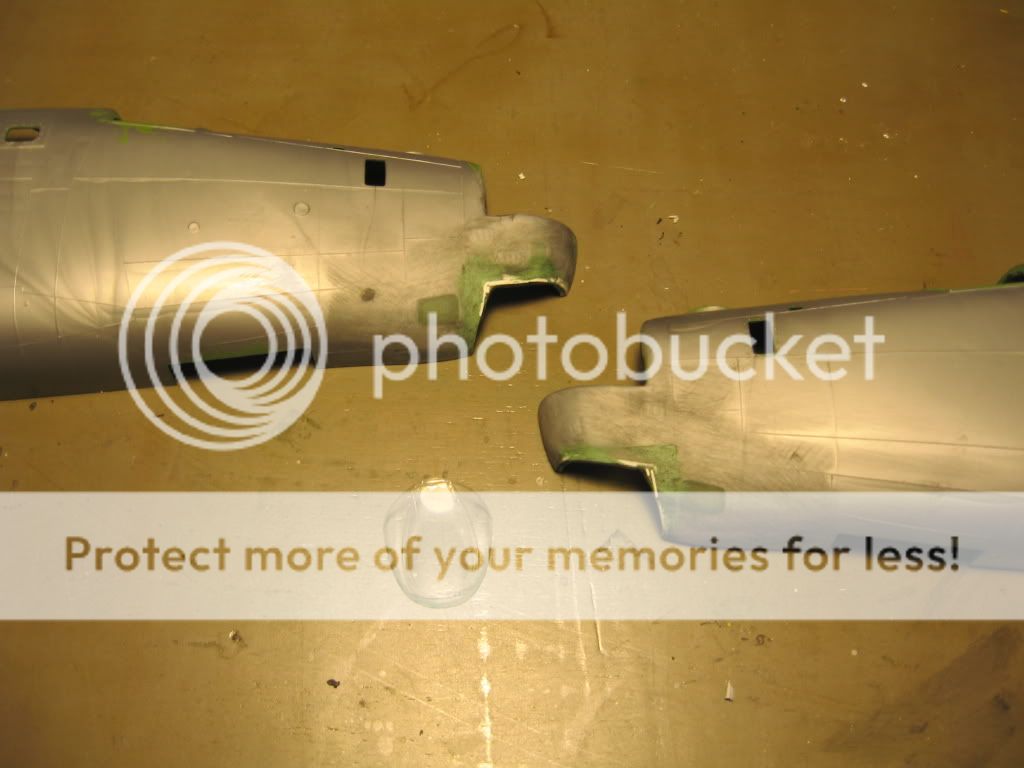

First pics are what got me into the idea of converting the old R/M kit to an H model. Not much difference visually and what there is , can be changed by using good modeling skills and the ole’ noggin.

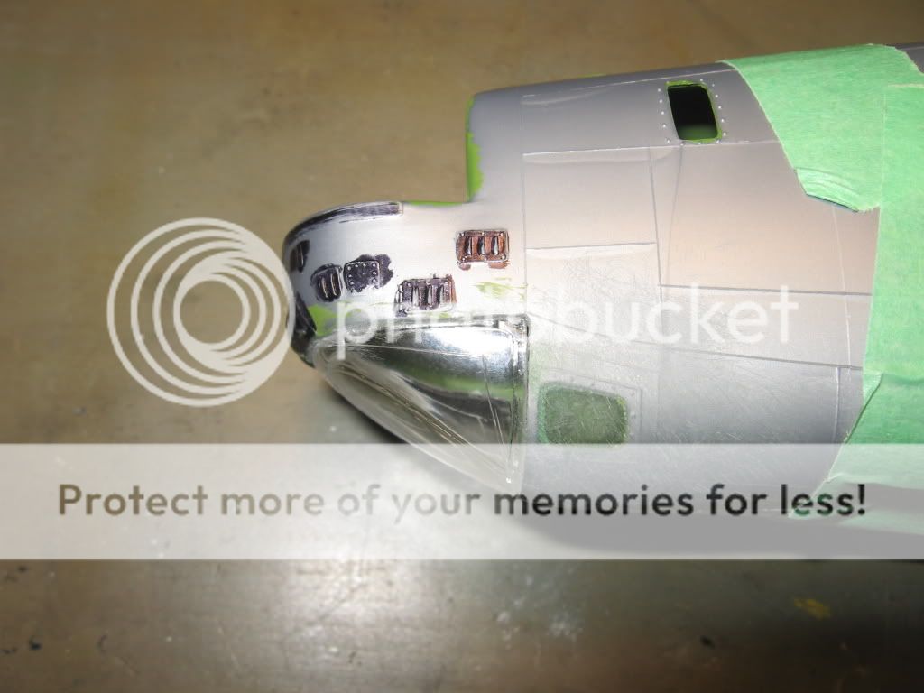

Following pics show where I taped and tacked the fuselage together along with the bombadiers glass. I then taped off and scribed where to trim the glass.
Being careful not to break or crack the clear piece, cut along scribed lines with razor saw. Then glued trimed pieces in place.
Next I had to do some shimming to make up for material lost during cutting and smoothing edges. Then to filling, sanding ,a little spot primer and a little more sanding.
Not exactly 100% accurate, but darn close. Still need to scribe the extra framing on the nose glass, but thats easy.
Ahhhhh, first hurdle overcome. Think I’ll do all the conversion work to the fuselage halves so I can build as if this were a B-24H kit.

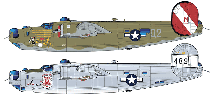

Looking at the war time photo of “Witchcraft” I noticed a panel under the pilots side window. Is that applique armor? The decal sheets show the panel on Witchcraft but it isn’t shown on 489.

Good eye g . One of the field applied armor plate. Not an uncommon practice back then. Not all aircraft had the extra armor, depended on crew preference, etc.
Will be easy to add a bit of sheet plastic there and on the right side in same spot.
