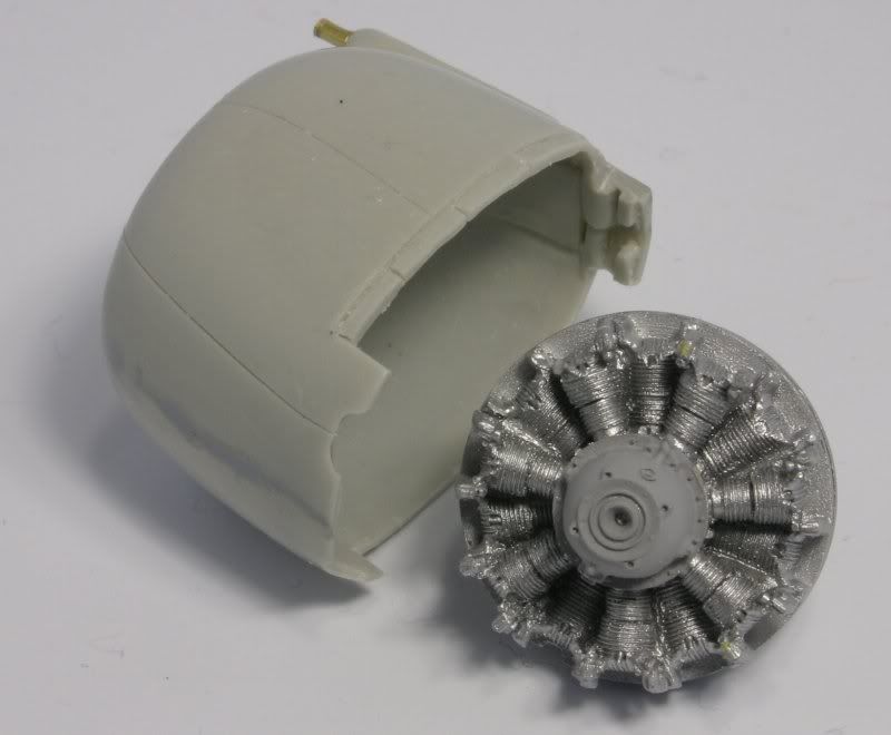

The engine made by Academy simply … is not good enough, so I replaced it with a resin kit. Theengine cawlings are also a bit “rough” so I made a correction here as well
Academy engine …
it just does not make any sense
Academy parts are out of this world … [:)]

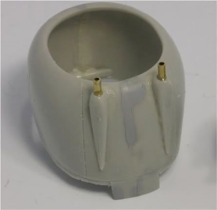

Next step was to correct guns covers …guns covers are much too long …
a comparison …
and after some time it looks like this:

very nice build so far! BTW, where did you get brass tubing for the guns? I’ve been looking for something like that for mustang wing guns and maybe B-17 .50 cal barrels.

Iv’e got them at LHS in CT. I think even Luckymodels.com carry all kind of brass parts (and with very reasonable prices too)

I finished the engine (at least for now) and started wirking with flaps
fitting …

Grzegorz, did you try to fit the propeller while the engine is inside the cowling ? When I was building mine H-75, I’ve made a gun barrels from hypodermic needles, but I’ve discovered, that they were to long, and the propeller blades couldn’t rotate because of them - I left the project with the problem unsolved.
Hope you can manage with it !
Regards. Aleksander
Thanks for pointing this issue. I will take care of it. The length of the barrels was set according to drawings and pictures I reviewed. The engine position is also not set yet; and it will not be as shown on Academy instruction - I think those are wrong.
