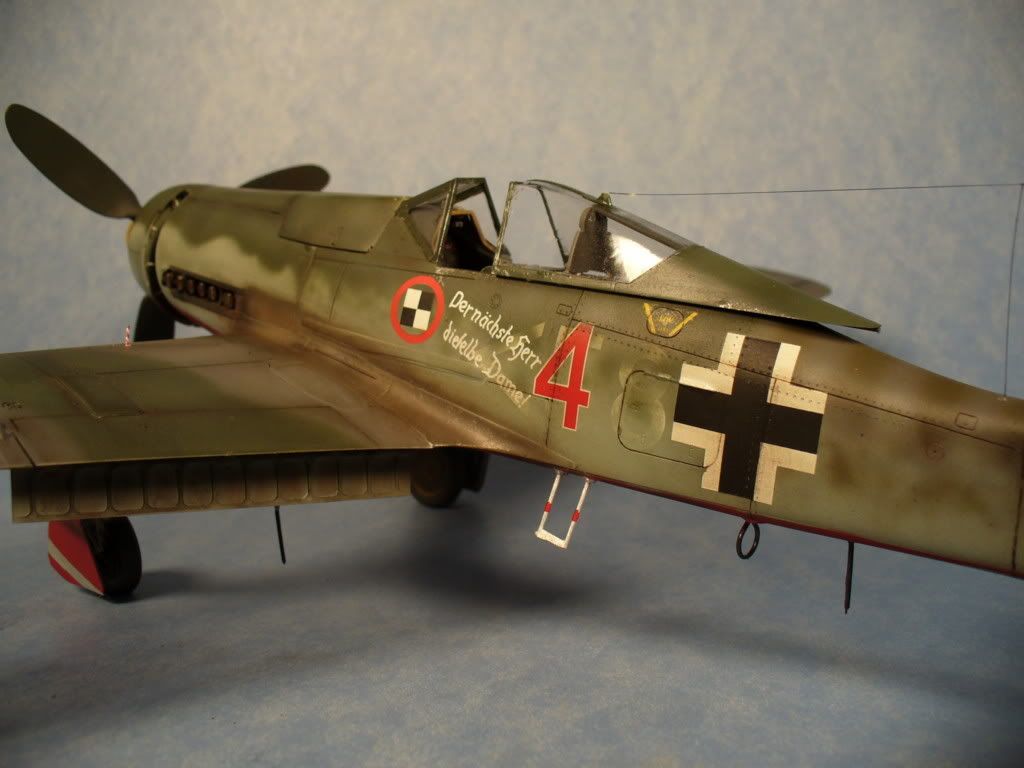

1/32 Fw190D-11 "jet defender" lots of pics
The basis of this build was a 1/32 Hasegawa FW 190D-9. I used the Rutman D-11 resin conversion set. To make most of the modifications I then added a aries masters cockpit, exterior PE set, Quick boot exhaust + gun sight as well as eaglecals decals. I scratch built/added the throttle lever, radio antenna, brake lines, cooling gill actuators, light rivet detail, flattened the tires and changed parts of the insterment panel to represent a D-11 fully fitted with bad weather gear and up graded gun sight… Hollow brass was used for the cannons. The prop blades, spinner, gun hood, supercharger intake scoop, upper 20mm cannon buldges, lower center wing insert, lower otter wing inserts and cockpit are all resin. I had the resin fuselage for the D-11 but the fit was so poor I found it would be less work to use the kit fuselage and do all the modifications and rescribing to it rather then fight with resin example. The other resin parts fit very well and I had little or no trouble incorporating them in with the kit parts.
The aircraft modeled is a vary rare non production prototype V58 version of the Fw190D-11. Originally flown by focke-wulf for testing then used by the verbandsfurhrerdchule Gdj. This aircraft has been painted over twice in is a career. Once by the Verbandsfurhrerdchule when they received it from focke-wulf and again when taken by JV44 and quickly redone in the wurgerstaffel “jet defender” colors. This is a very unusual D with a lot of history behind it. Not only is she colorful with the Jv 44 marking but the not often seen RLM 81 molted with 75/76/83 gives it a real eye catching look. The partly painted over tactical numbers, stripped bottom and slogan gives the viewer a lot to look at. According to my research red 4 did have all radio and electronic hardware installed and all antennas were in place. The only other fully fitted D serving with the jet defenders was red 3. Another odd feature of this D-11 is the Very early style canopy fitted to a late prototype jumo F powered mechine In fact all other Ta’s and D’s powered by the jumo F have the late blown hood. Packing 2200+ HP, four 20mm cannons and upgraded weapons electronics this was the last thing a P-51 wanted to see pull in behind him.
The Wurgerstaffel of JV44 only task was to defend the me262 during take off and landing operations. They were forbid to persue allied fighters. The colorful lower surfaces were to aid flak gunners that ringed the airfield in identifying them. Red 4 operated the various airfields within the Reich until wars end. Pilot info for red 4 is sketchy. Karl-Heinz Hoffman was probably the pilot but no real proof can be found.
In some of these pics the weathering appears heavier than it really is. This seems due to the lighting I am using. When looking at the close up pics you can get a better idea of what it looks. I have a color enhasement builb used in aquaruims. It does a great job of bring out color, but at the same time overstates some color changes it when photographed. Also I noticed the some of my pics the pilot tube is missing off the wing. I must have knocked it off during the photo shoot. With all the small details, fine rivets and layered color shades used it’s best viewed up close and in person. I have not got a good pic of the bottom yet. There’s a lot of paint work and weathering done there. I’ll post one after this weekend.

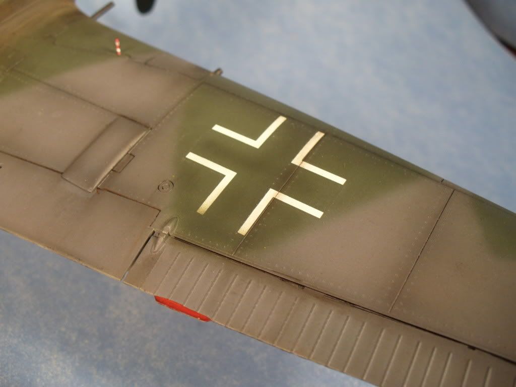

2 closer shots shot fine rivit detail and over painted unit numbers

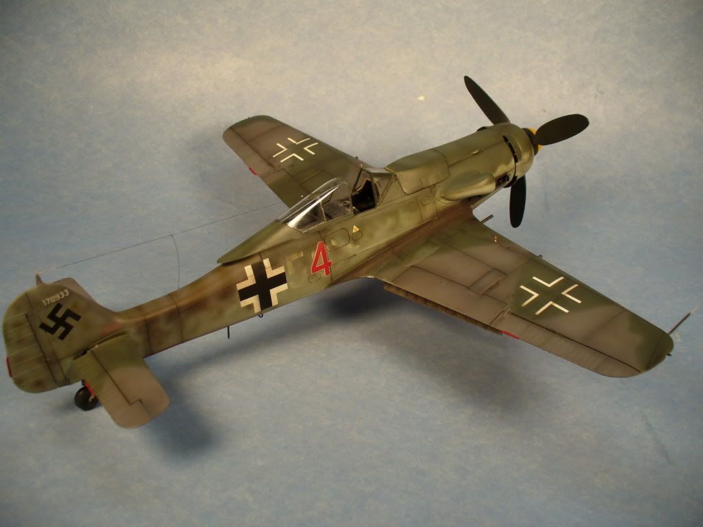

Stan that is really nice. Great airbrush work. Nice bit of research too. Question about the tail. In a couple of the pics the vert stab has a piece on the front that gives the profile of the wooden tail. Was that a removeable piece on the real A/C? Would it have been added for extra stability or simply to make the A/C appear to be a differnet version?

wing nut I’m sitting here trying to figure out what you mean and I think I have. In pic 1 and 5 the you catch just a bit of the other side of the tail in line with the rudder is this what you are seeing? I did nothing to the tail, it’s one of the stock pieces from the kit. It’s also the standered production tail for a D-9. D-9’s did have alot of production variety. 5 different gun hoods were used, 3 tails, 2 props, 3 different prop hubs get into electronics, gun sights, radio, and such and you’ll find strange combs.

OOPS my bad[:D] Now I see the leading edge of the opposite horizontal stab. My brain just could not getthe shape of theWooden tail form the ta 152, that was fitted to a small number 190D’s, out of my head.
Someone built one too many wide tails [:D]
You had me going for about 5 min here. I took the model out and gave the tail a good looking over. Then thought marc has built several of these and knows what he looking at, what the heck i’m I missing. I then reread the post again and see “in some of the pics” Scroll up and fish eye the pics and thought just that, he seeing a wide tail due to the angle the pic was taken.
