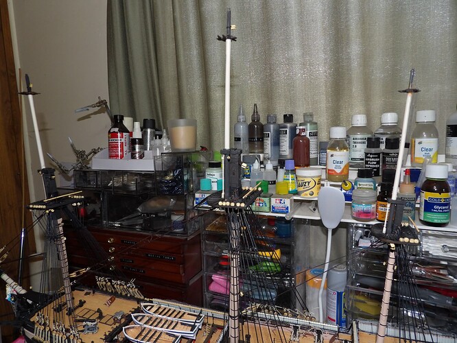

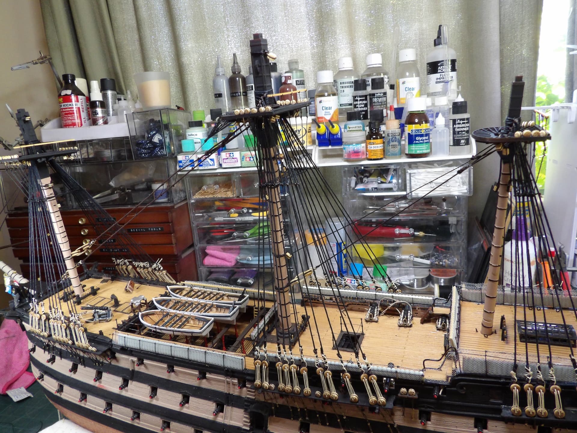

the futtock shrouds are on .

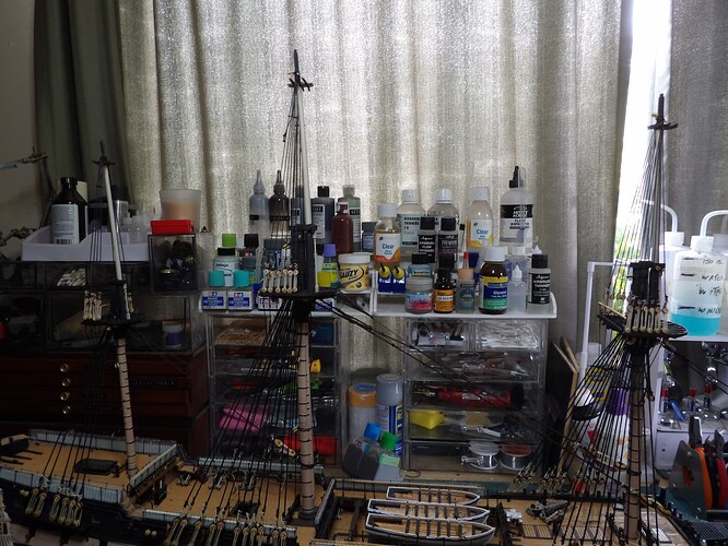

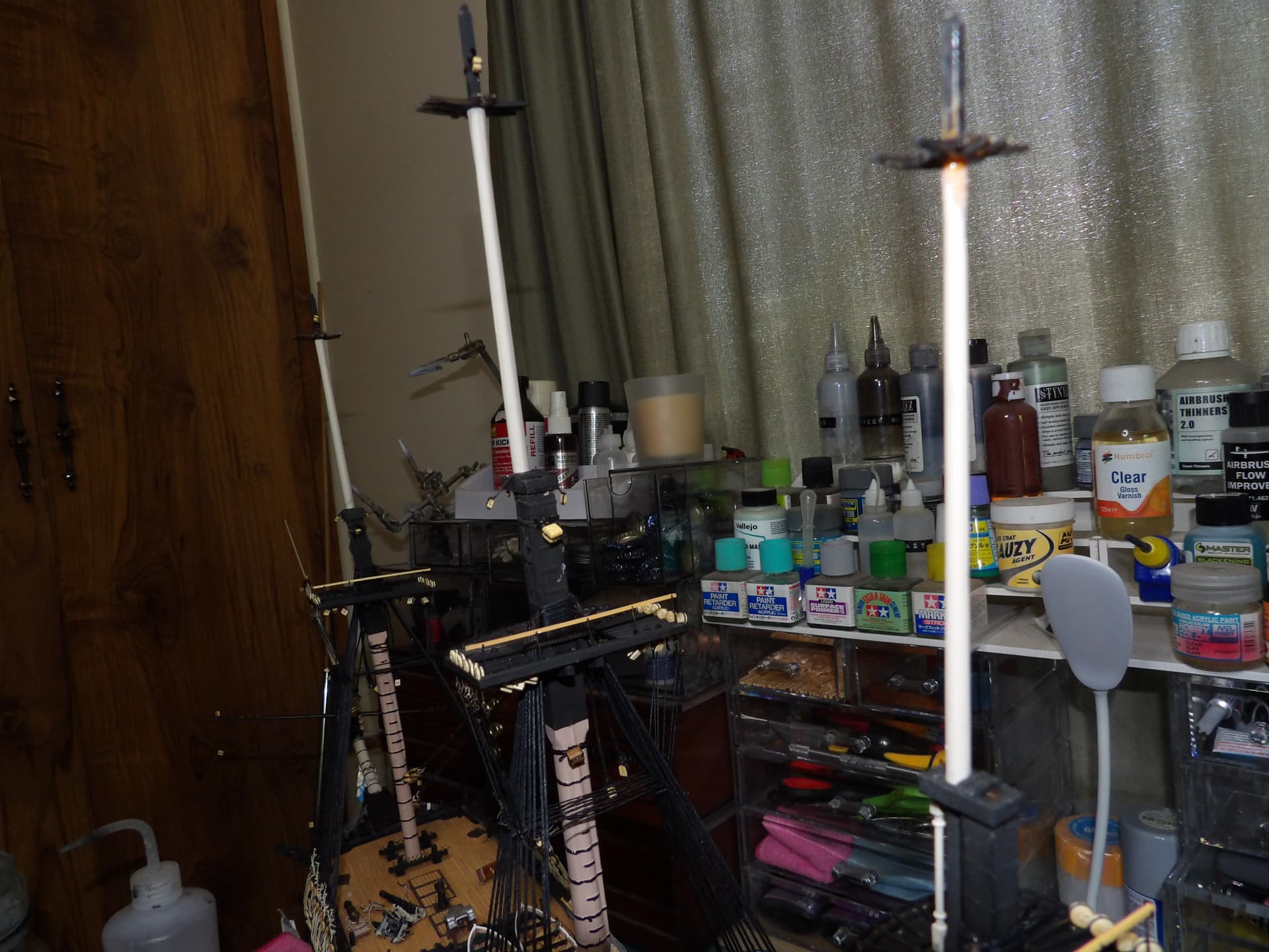

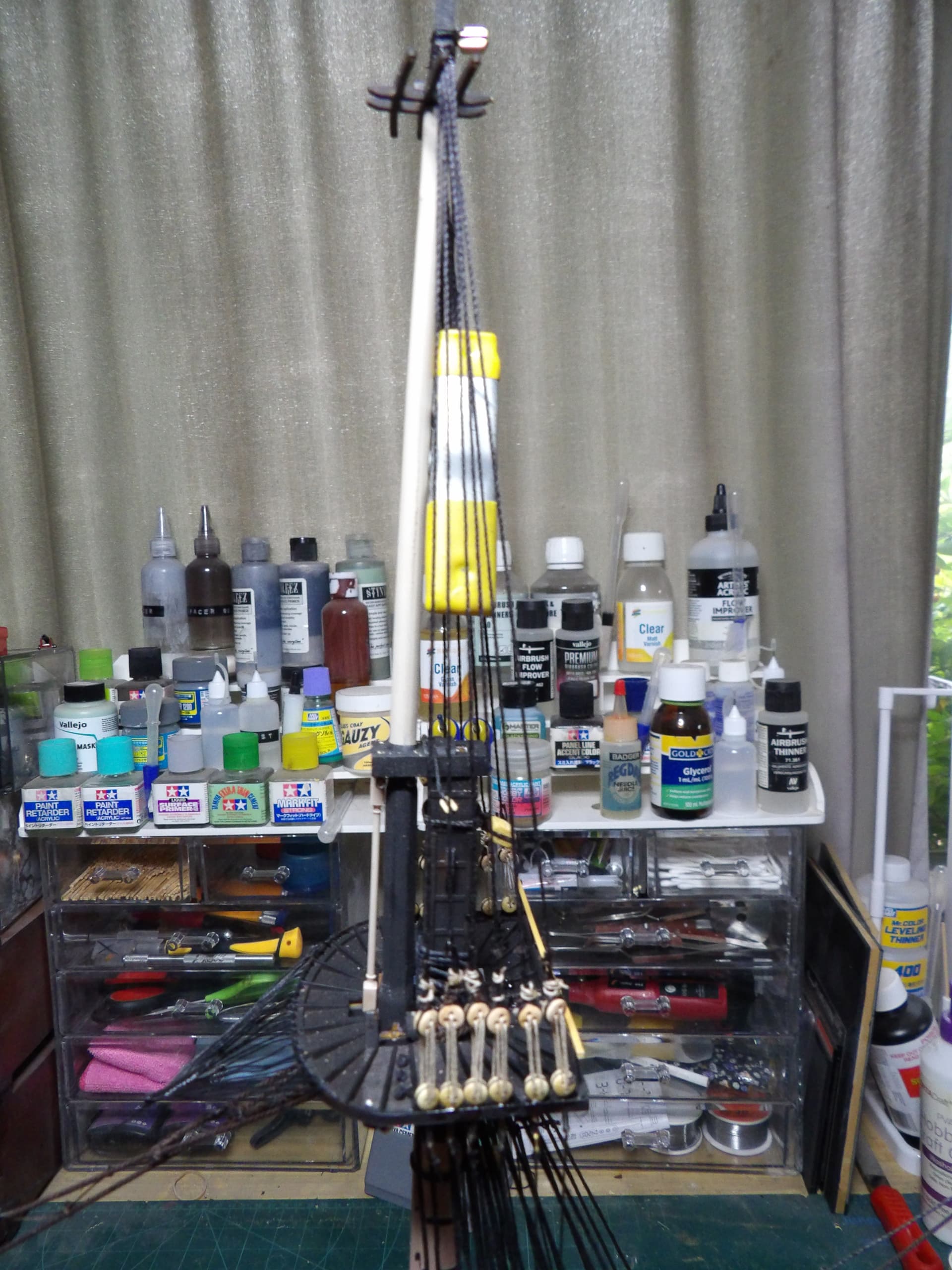

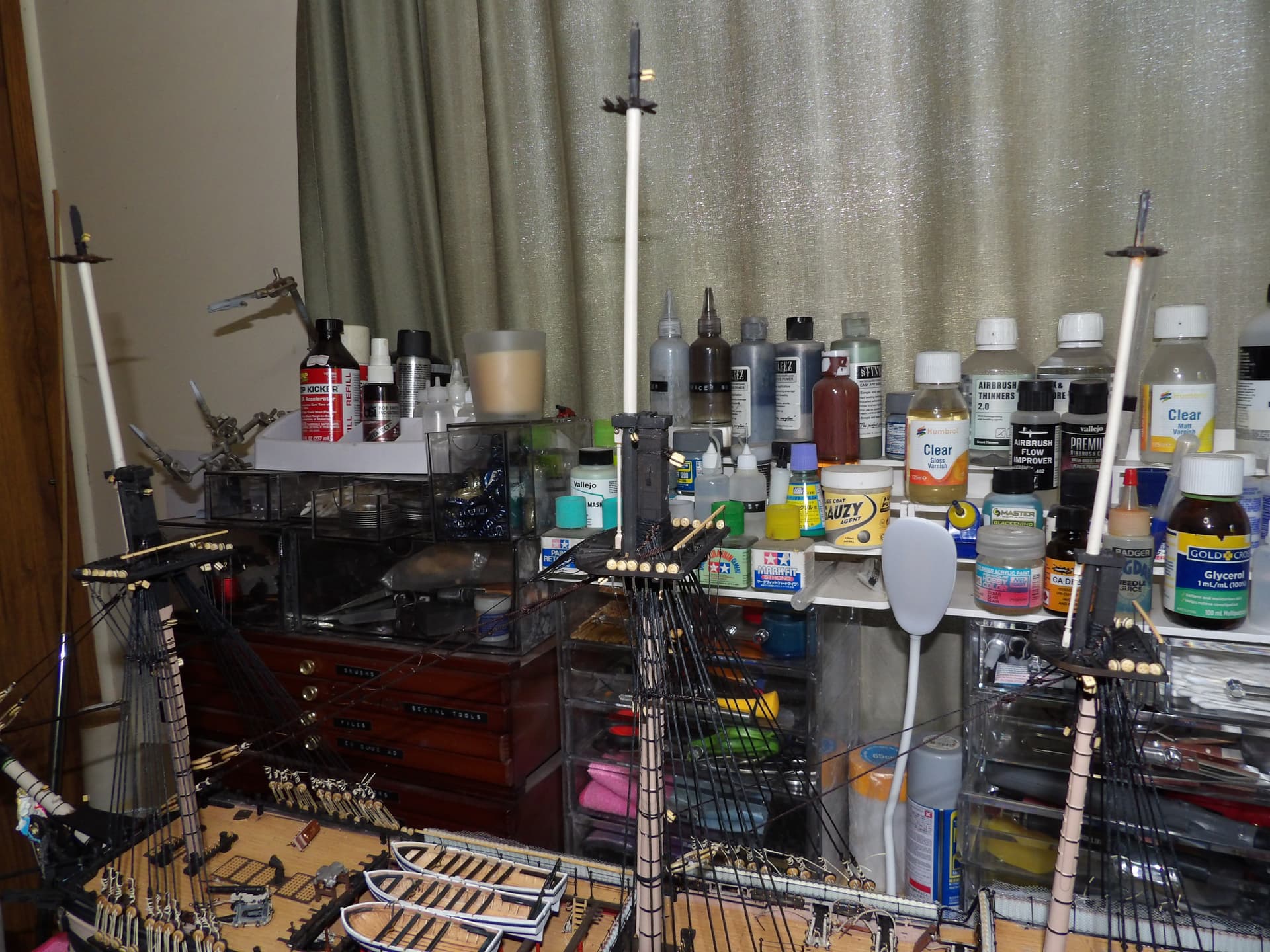

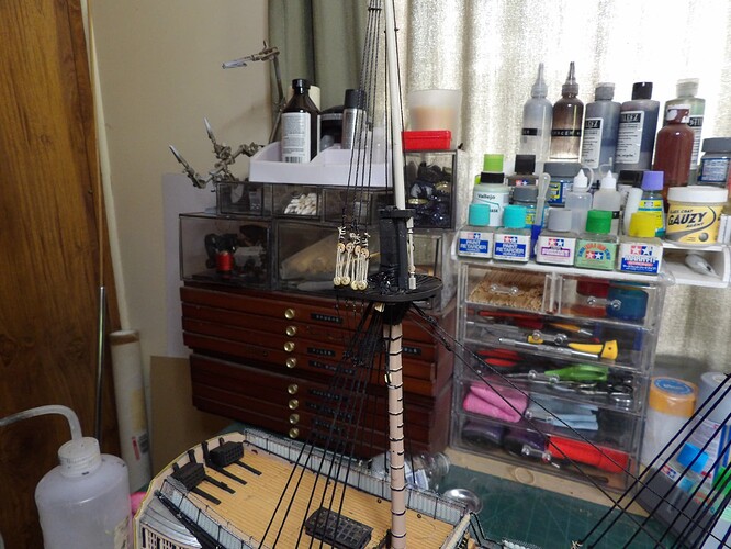

top masts are in , onwards and upwards .
I’m very happy with how they line up .

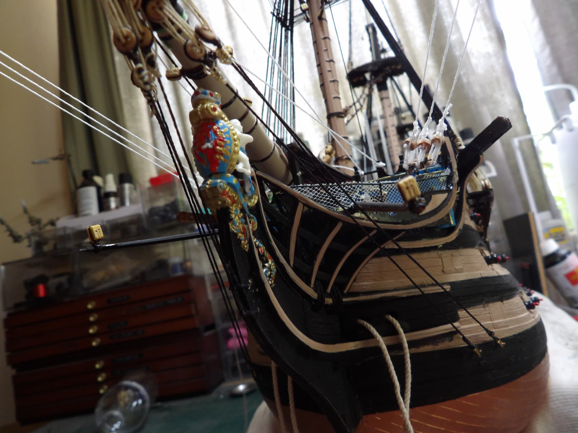

Looking amazing Steve5! May I ask what color/paint did you use for the stripes along the hull?
I went to artesania latina and bought the updated colours for the victory , sorry I don’t know what it’s called it just says hull .
it’s the second from the right colour 72 , 73 is for the masts .

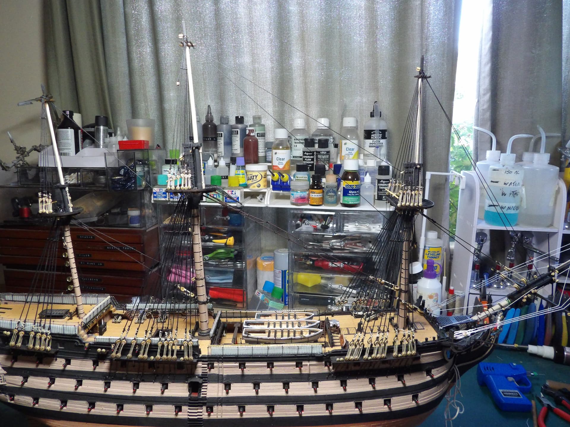

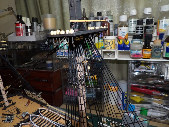

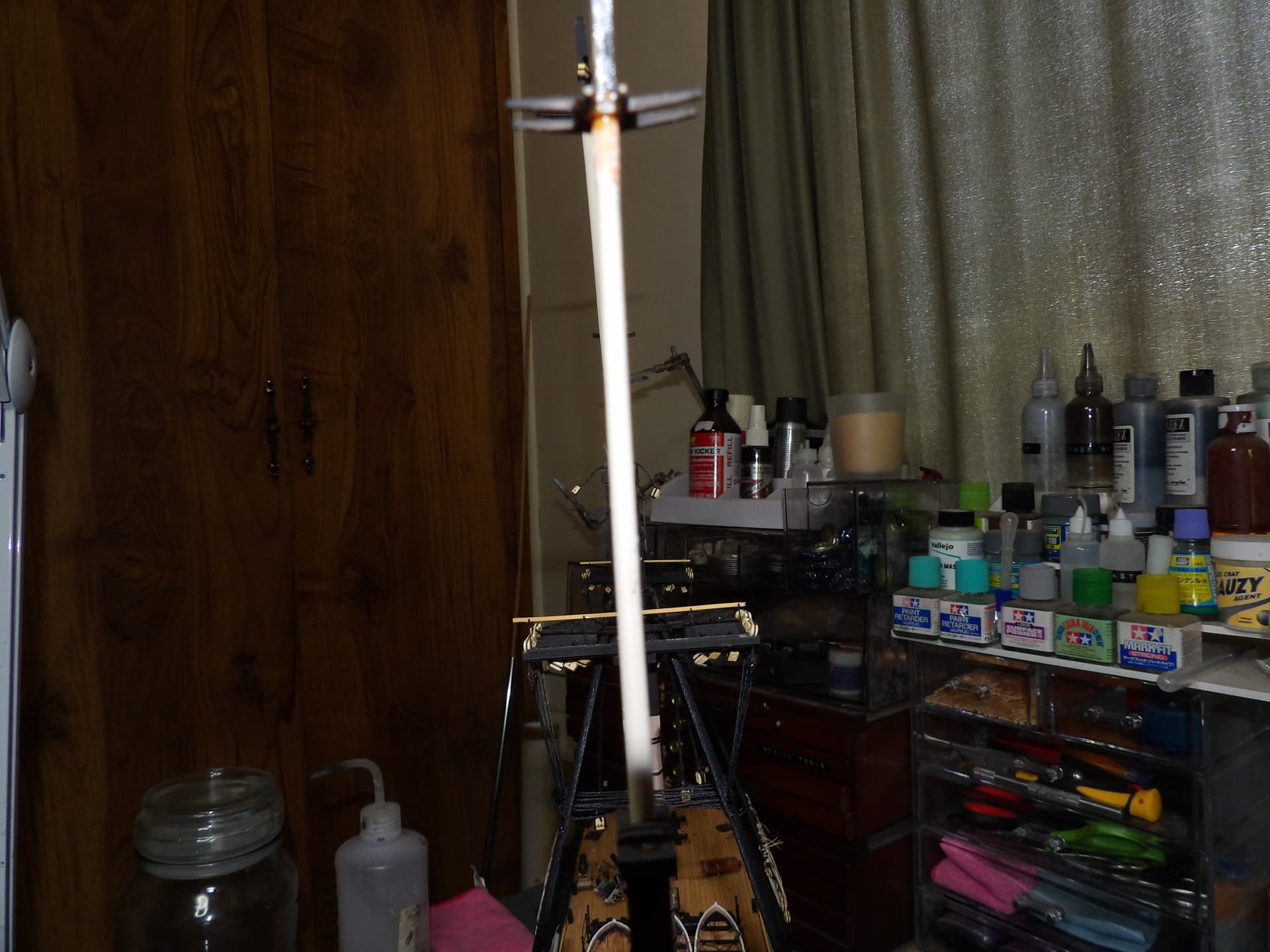

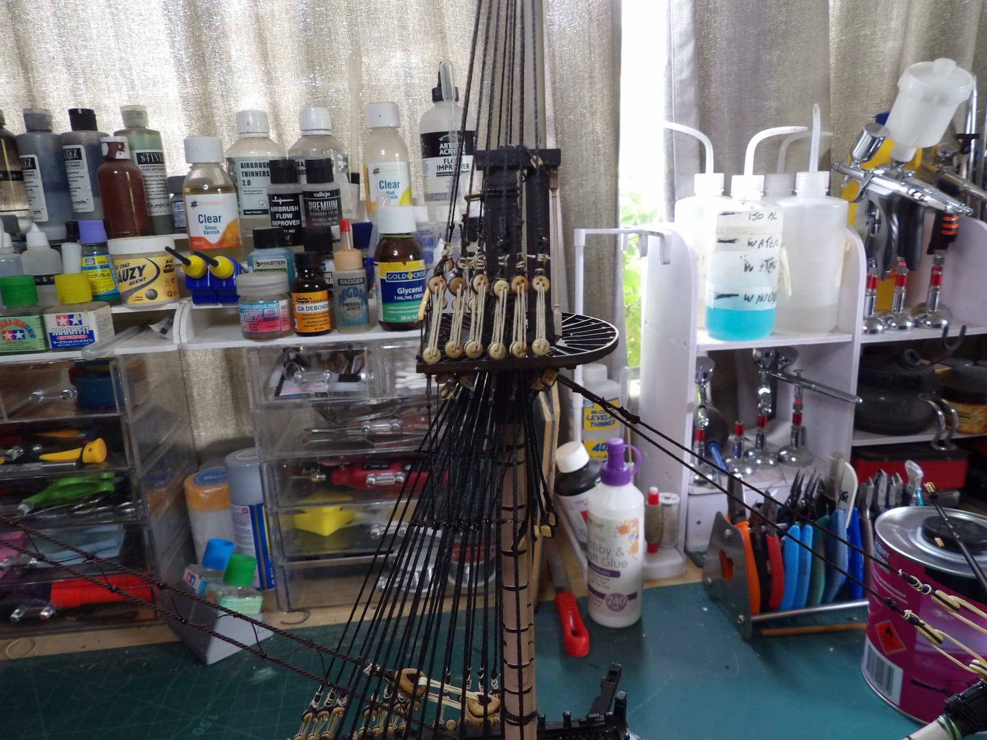

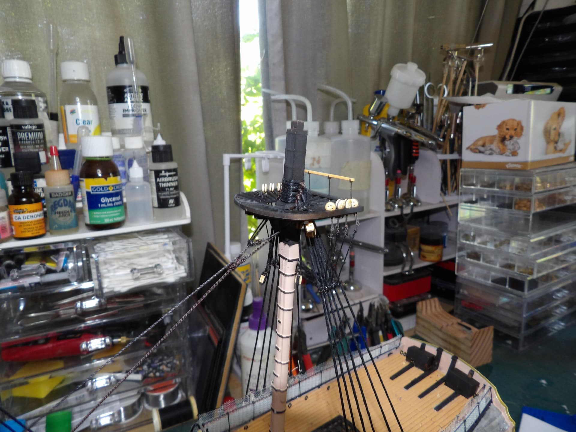

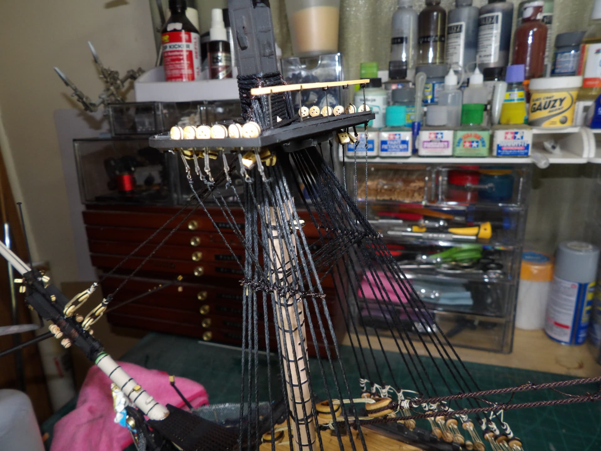

the main top sail mast shrouds are on , for some reason , these were far more difficult to put on , than the lower ones

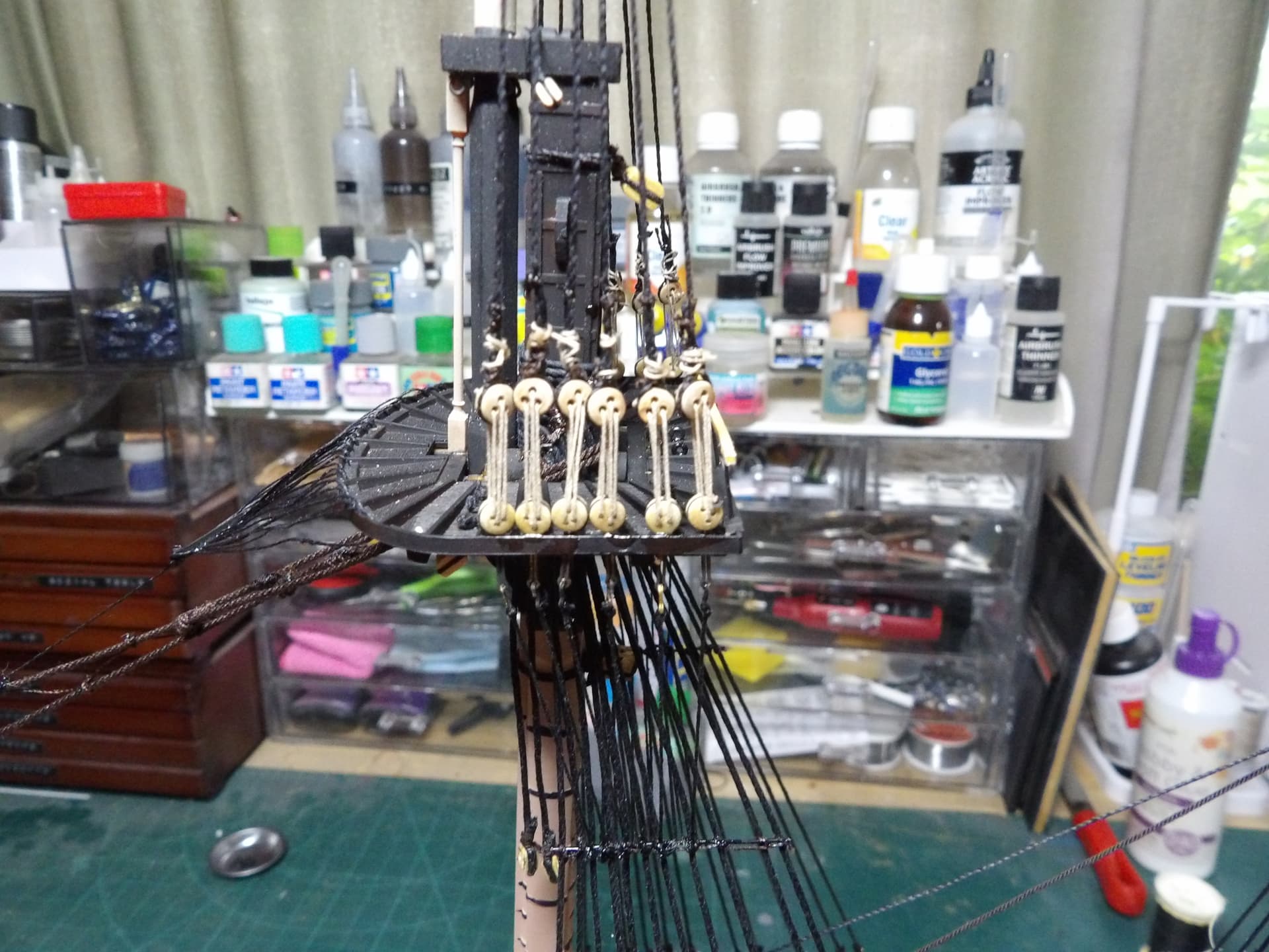

finally all the top mast shrouds are on
I even managed to keep all the masts aligned

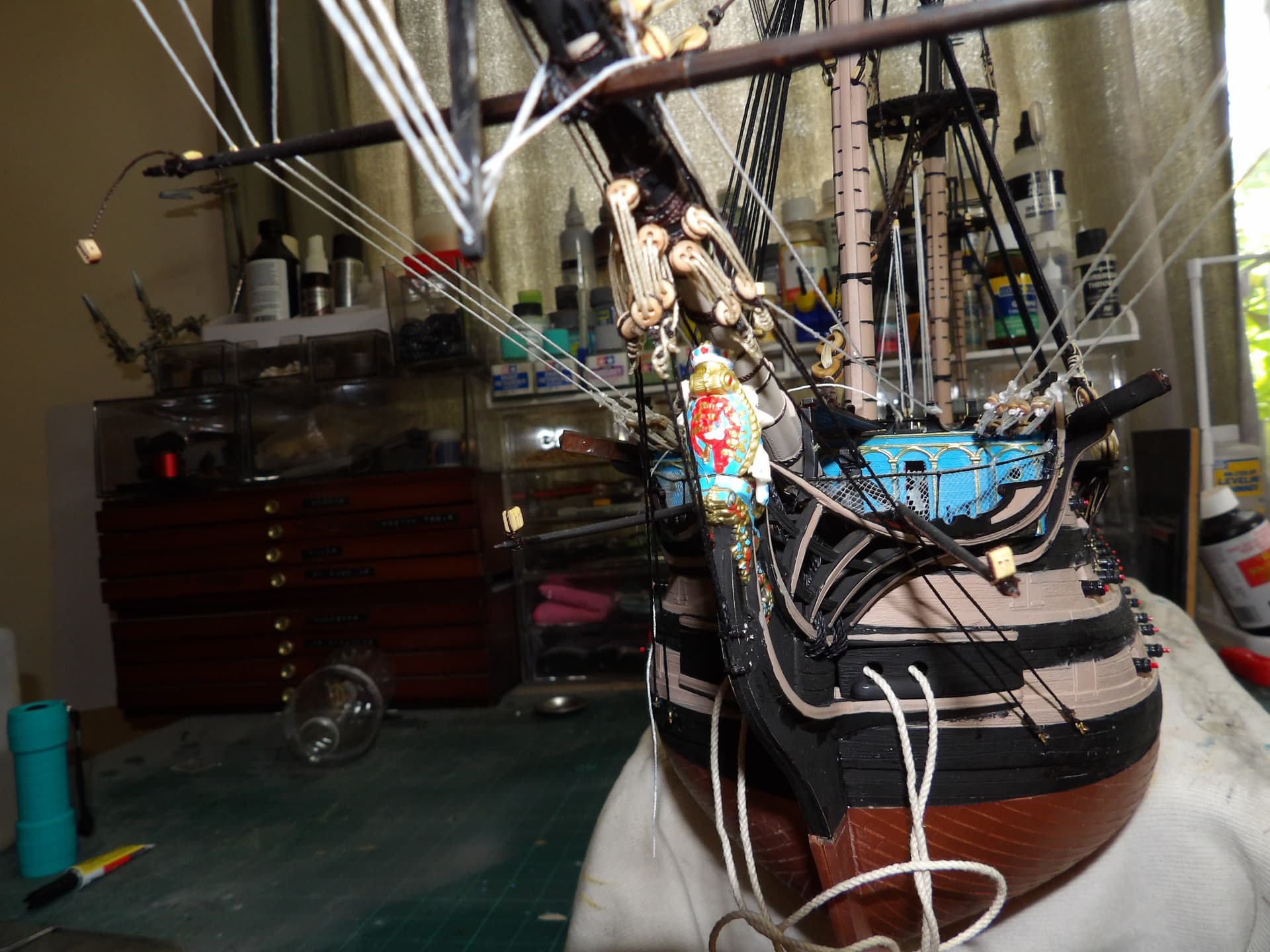

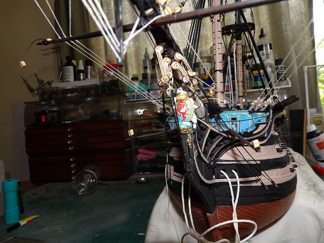

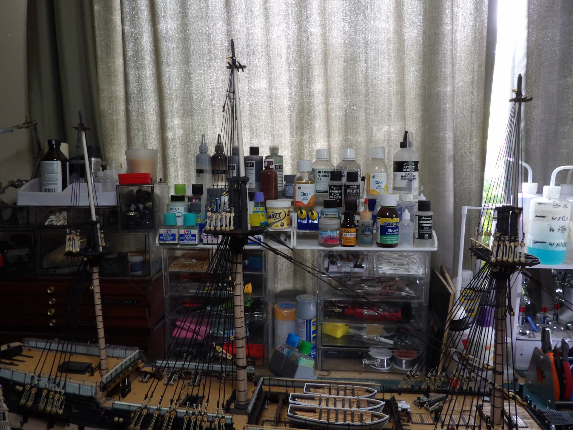

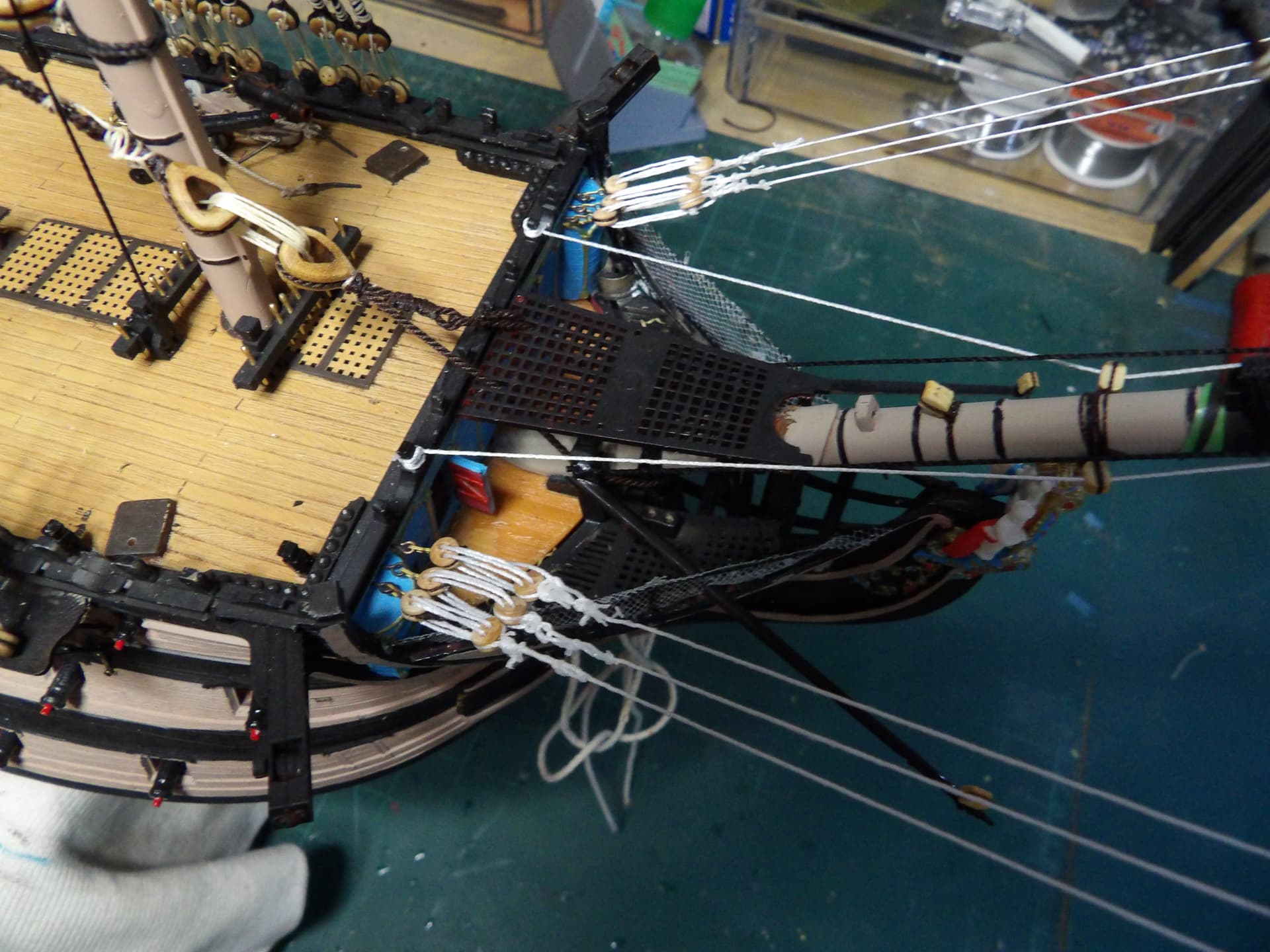

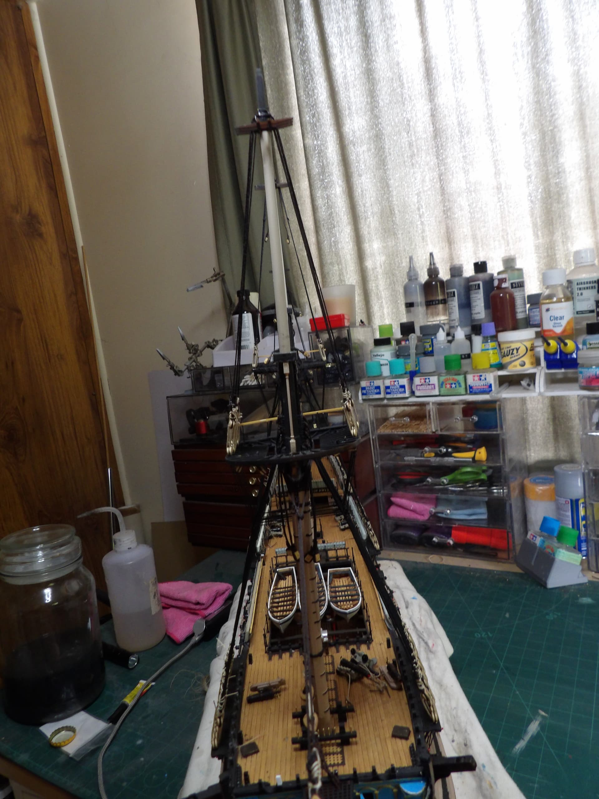

all the top mast forward stays are done . started on the bowspit now .

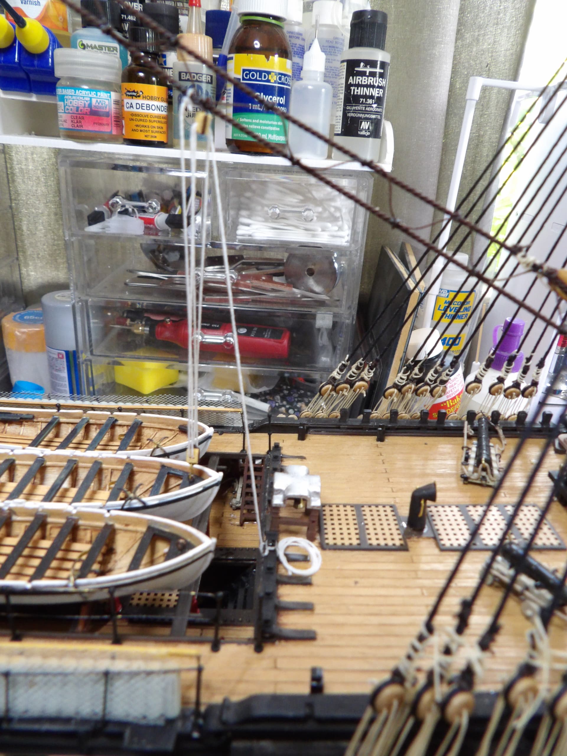

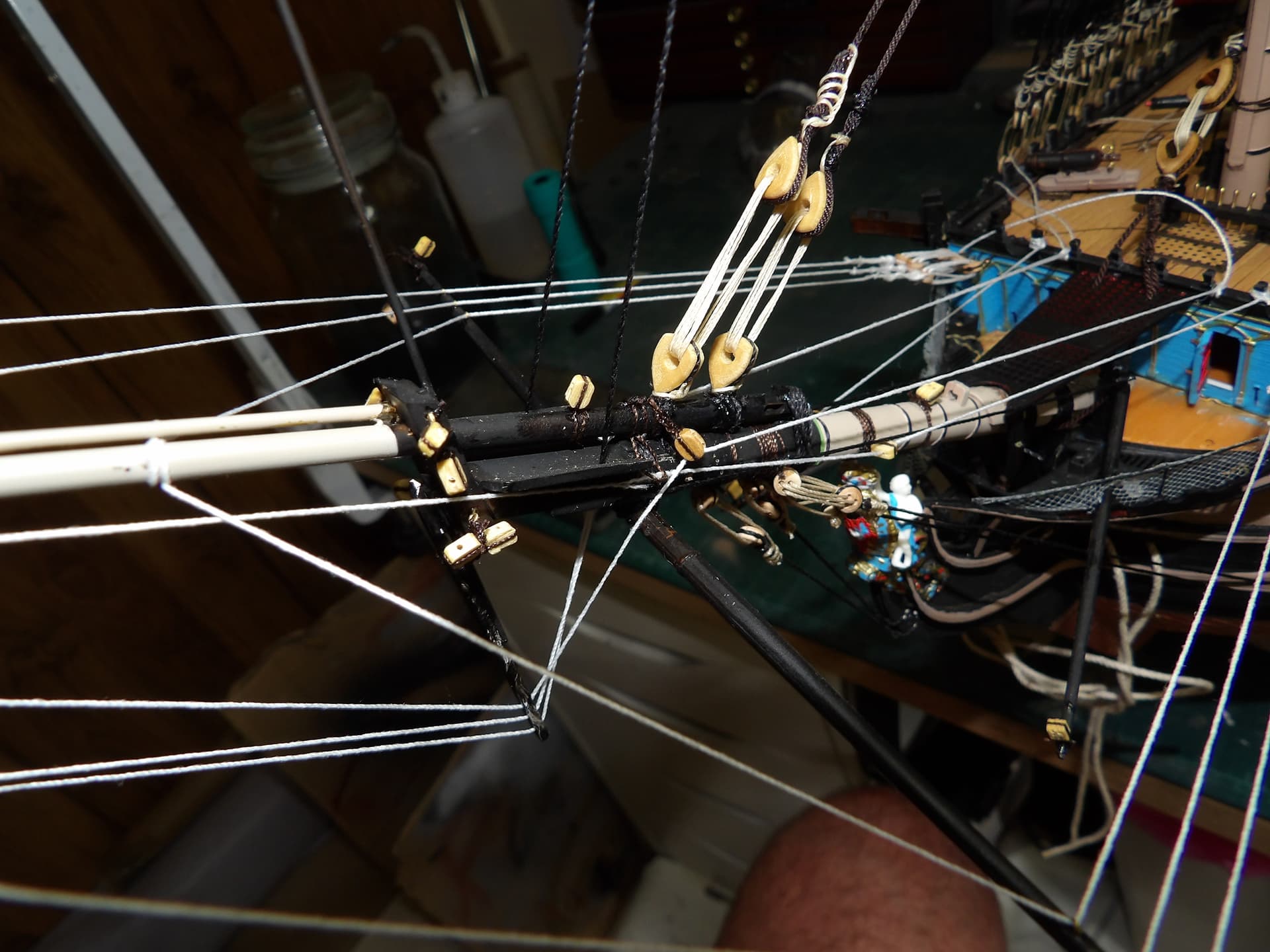

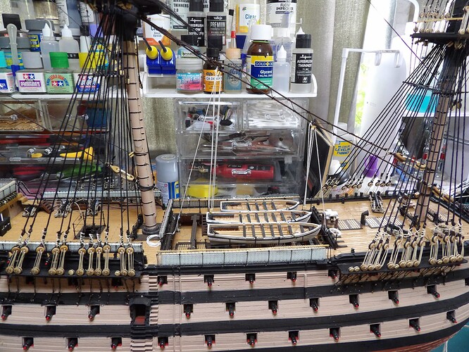

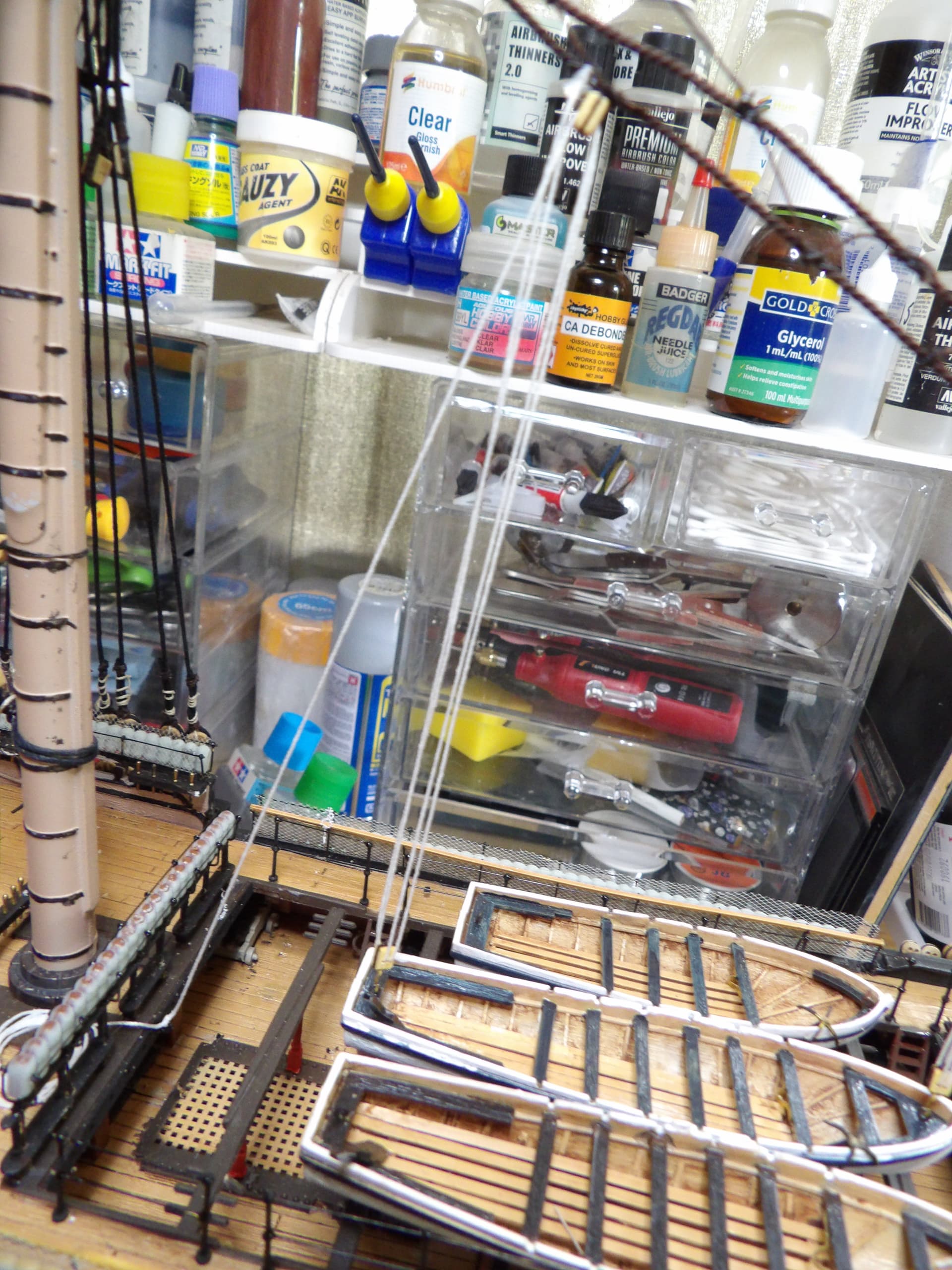

got the boat hoists on .
this was a fun exercise , most of the blocks I had on , were in the wrong spot ,
had to take them off and redo them , fun times .

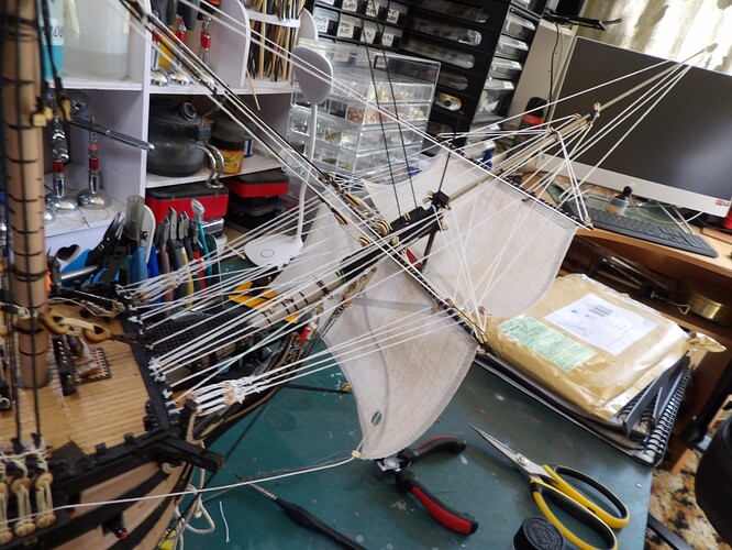

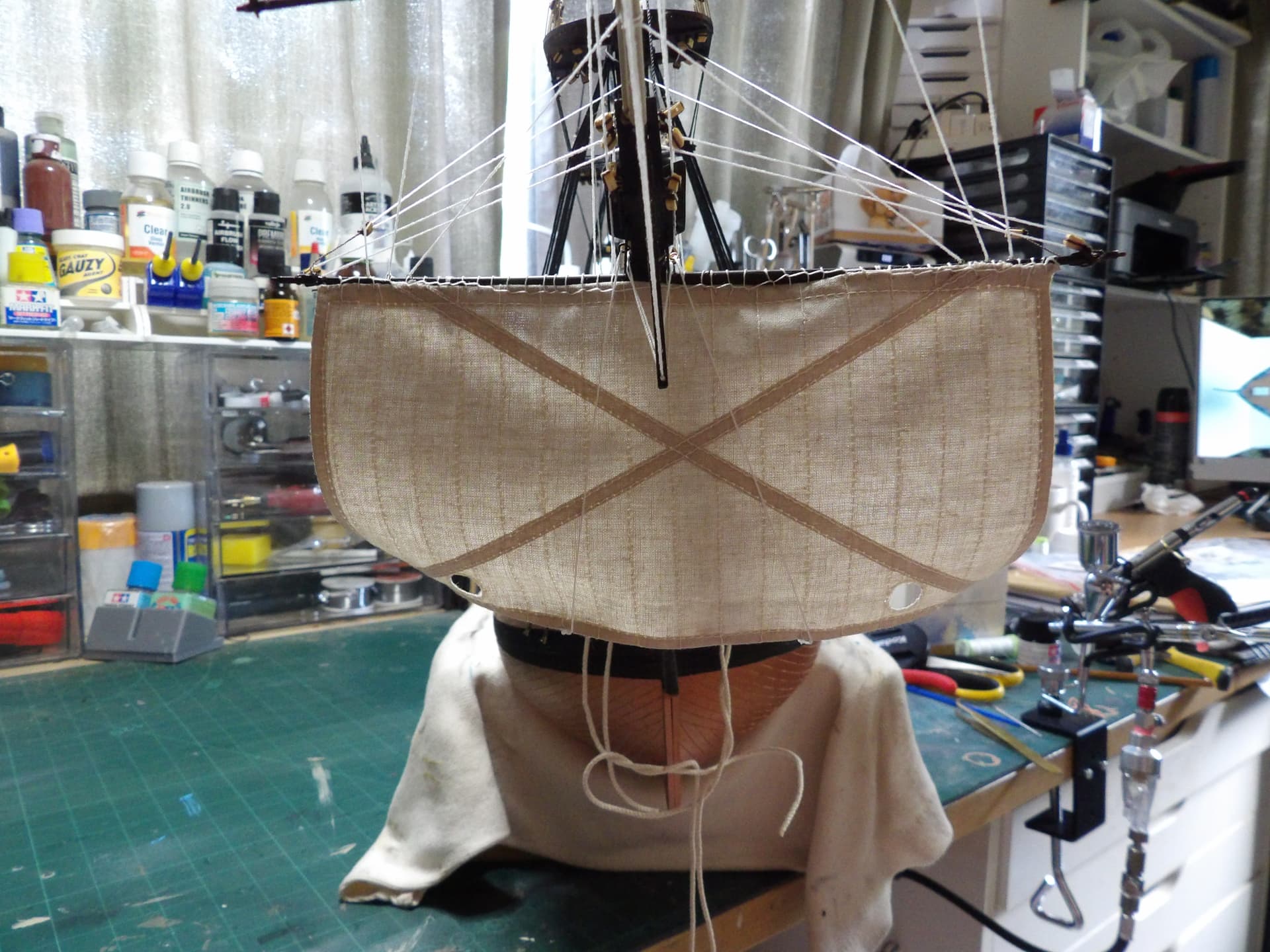

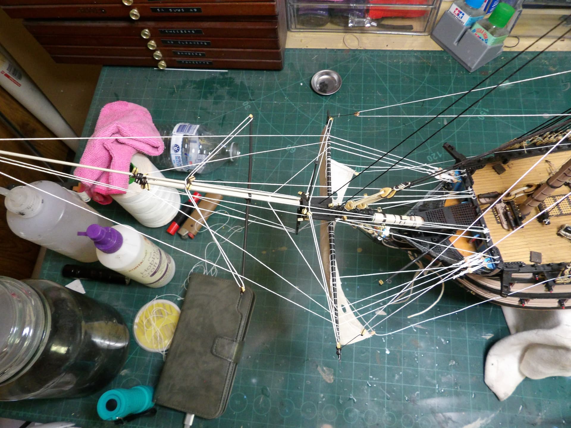

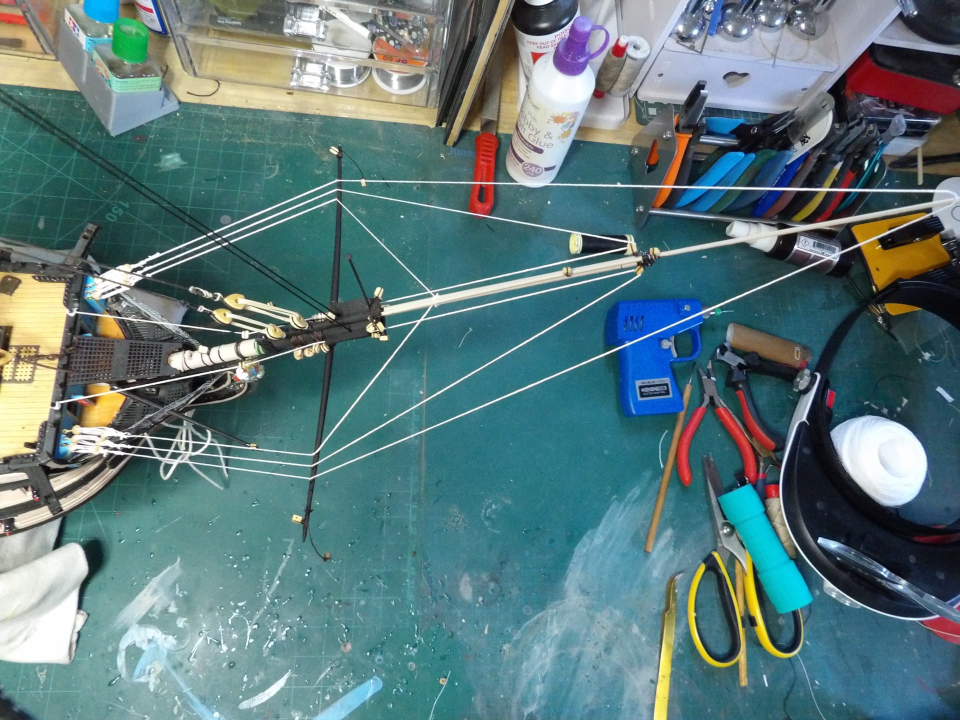

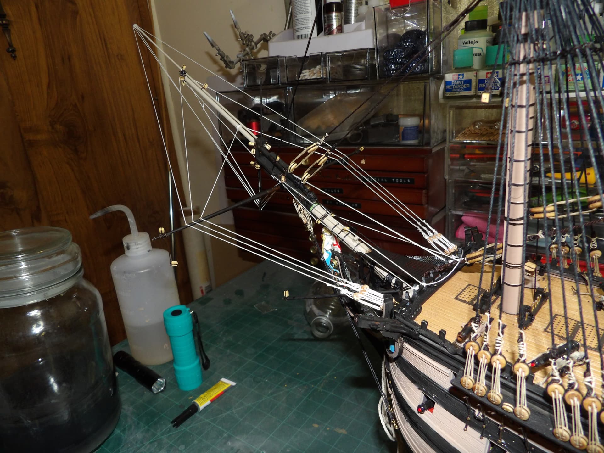

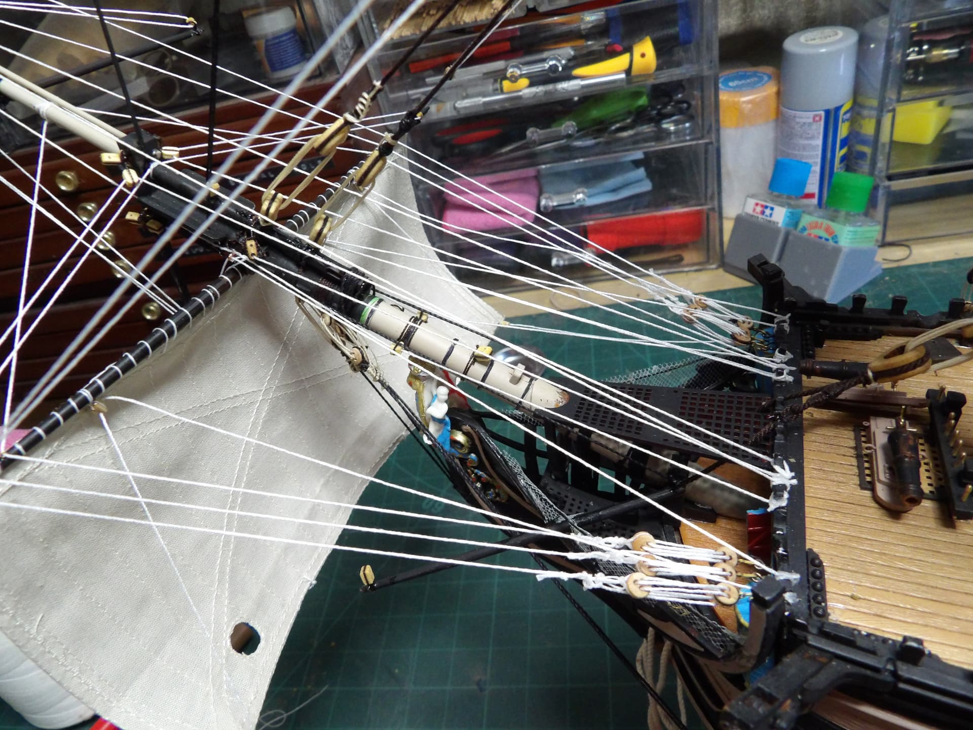

well some more work is done on the bowspit .

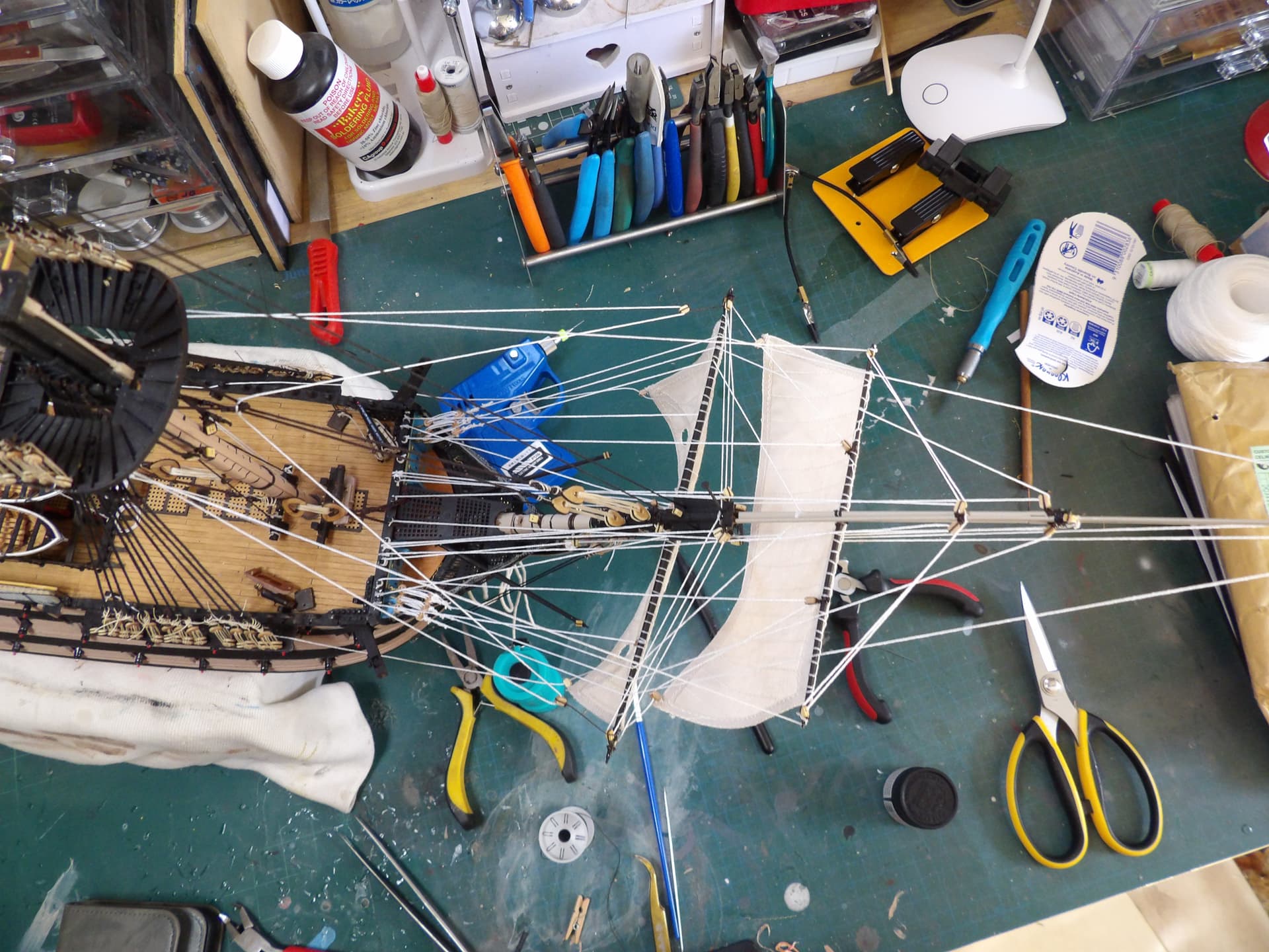

got some more work done on the bowspit , the spritsail is on , as well as the clue lines , braces and buntlines .
Museum quality work Steve!
thanks tom , nice of you to say so .

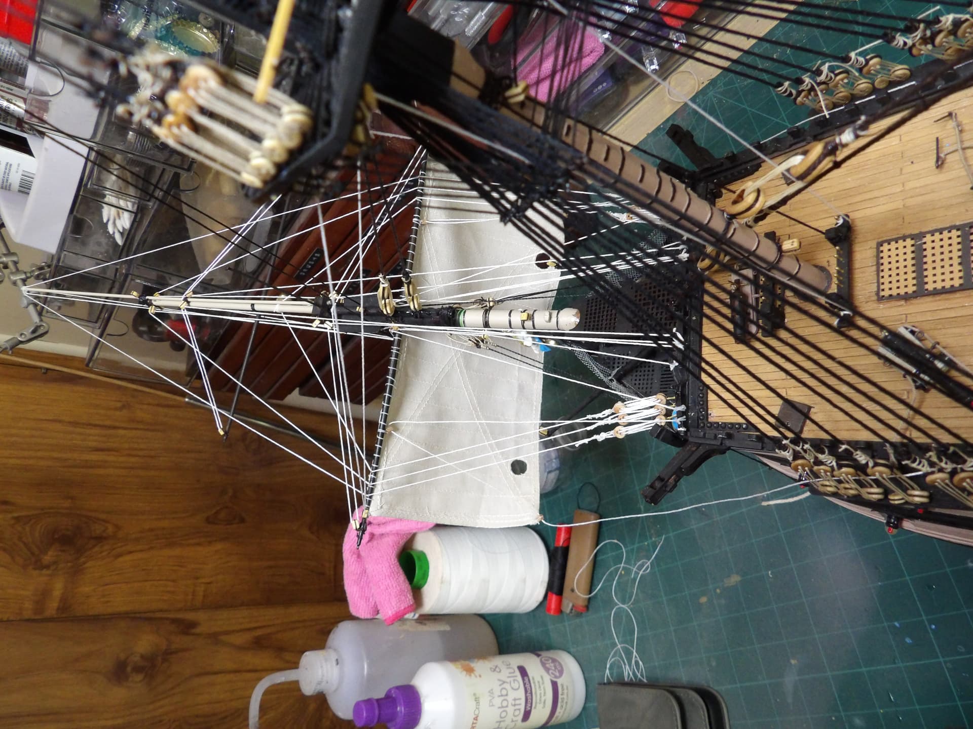

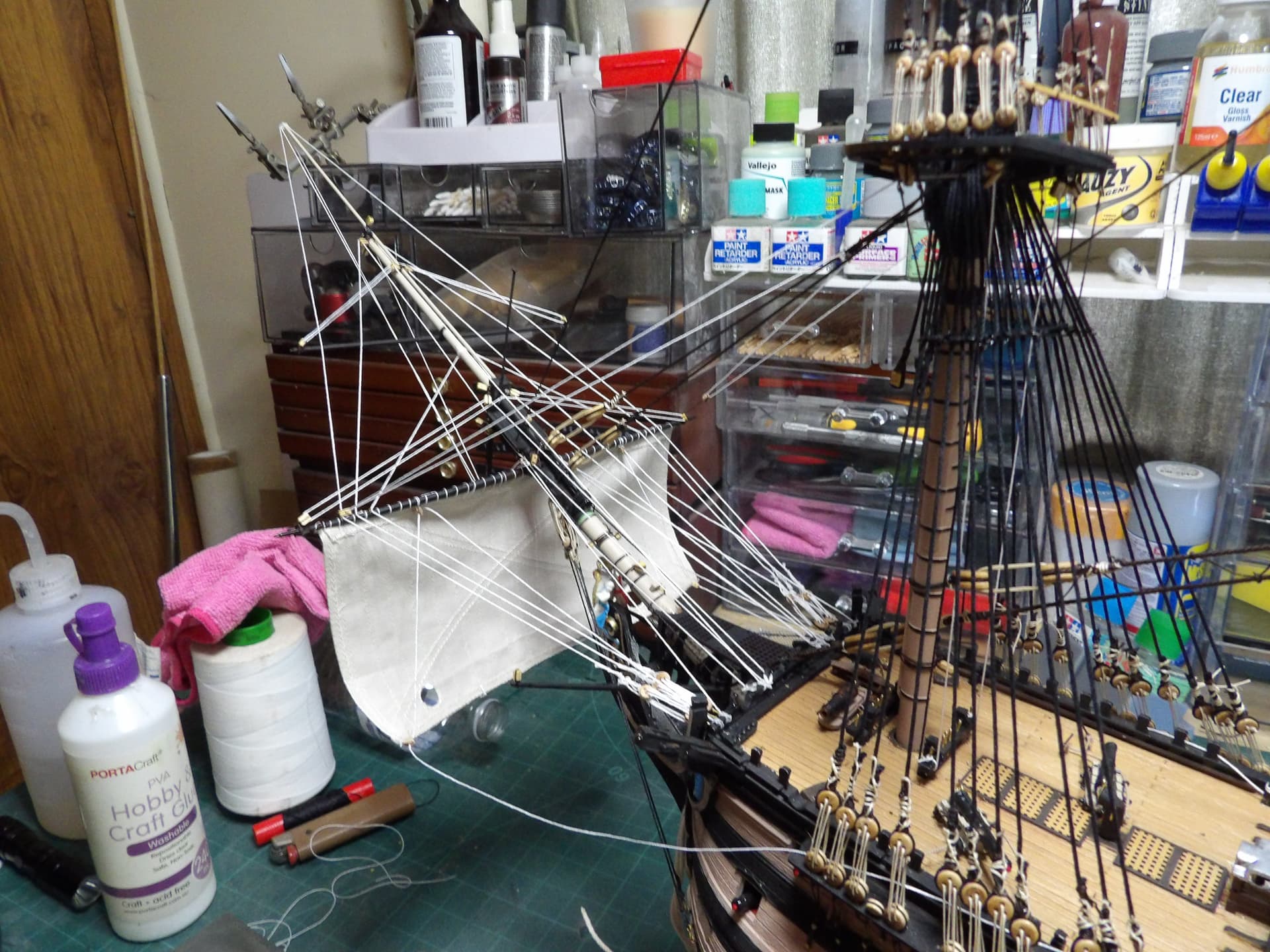

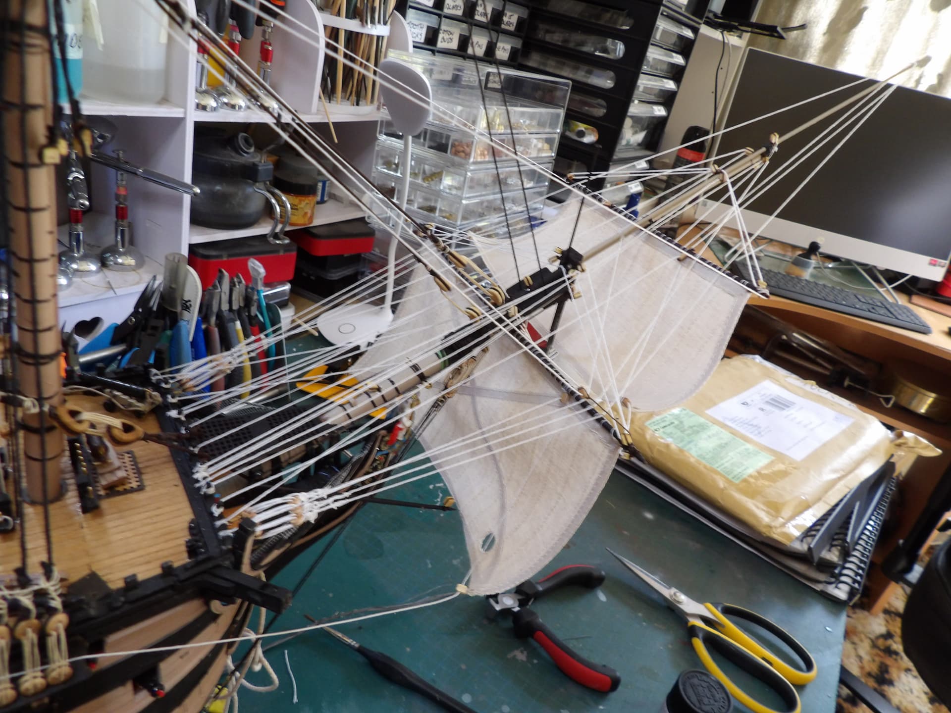

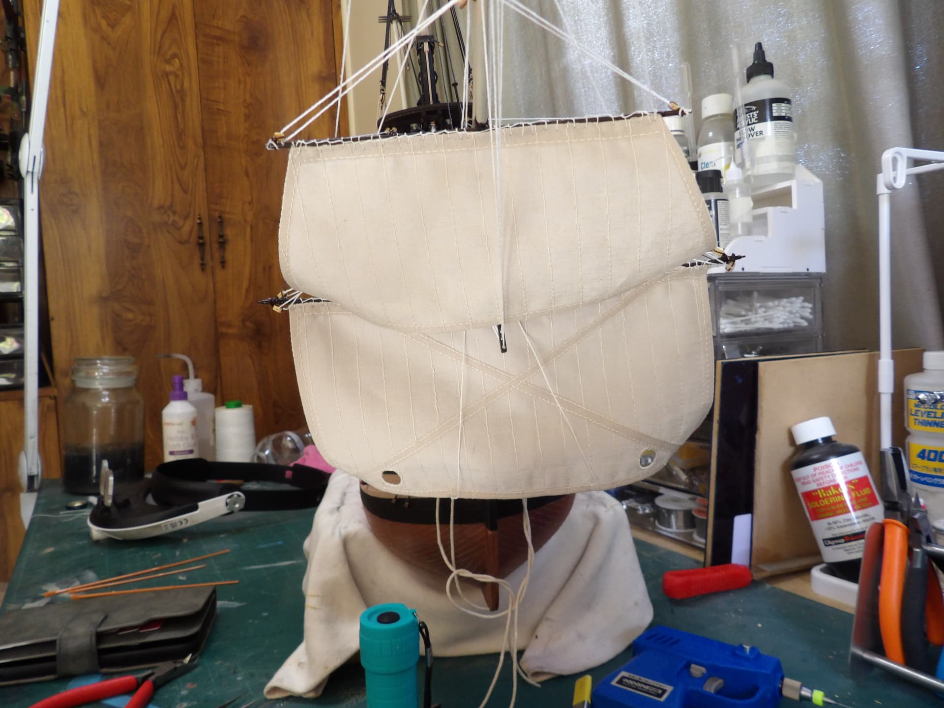

the the topsprit sail is now on .

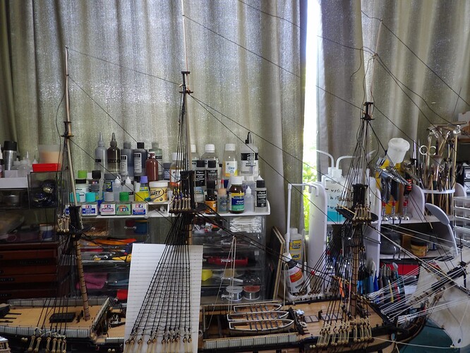

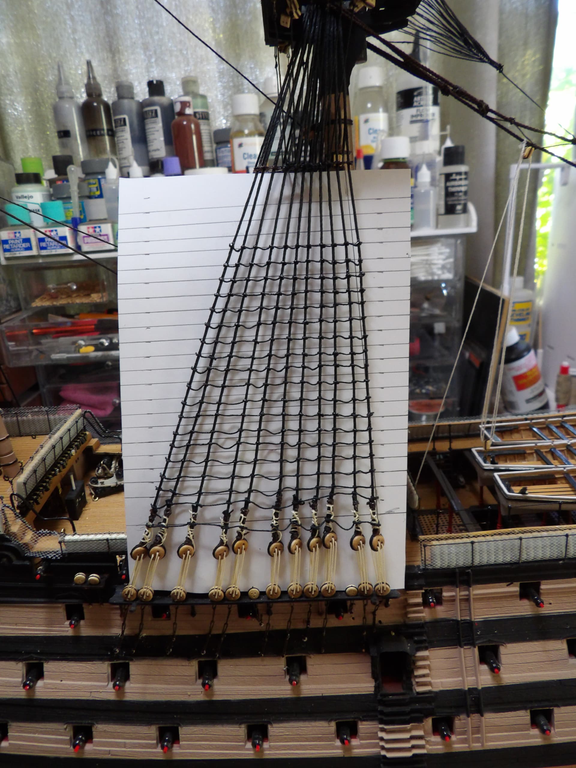

all the forward stays are now loosely in place , I can’t do the back stays , as they will interfere with the ratlines , so now the really fun job of about 2,000 + knots for the ratlines , :face_with_bags_under_eyes:

sorry drkoin , I bought these sails from hismodels , pretty reasonably priced .

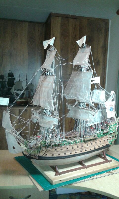

but i have made my own out of silkspan , or modelspan , type of paper very easy to use .this is my soleil royal with it .
thankyou for helping out luvspinball , it’s good to have many ideas .
Hehe that’s okay, thanks for the answer ! That’s one very nice Soleil Royal you’ve got there. Can’t wait to see your final HMS Victory!
