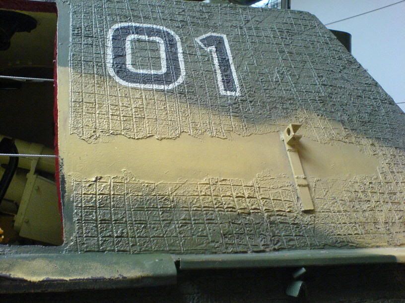

Here are a few pics on why I am bothered by scale, this is the Jagdpanther at the London RWM.

FYI, I haven’t tried the hot iron technique on the grid pattern like the Jagdpanther at the London RWM. I really don’t think this would turn out very well. This would, IMO, be a candidate for one of the other methods.
