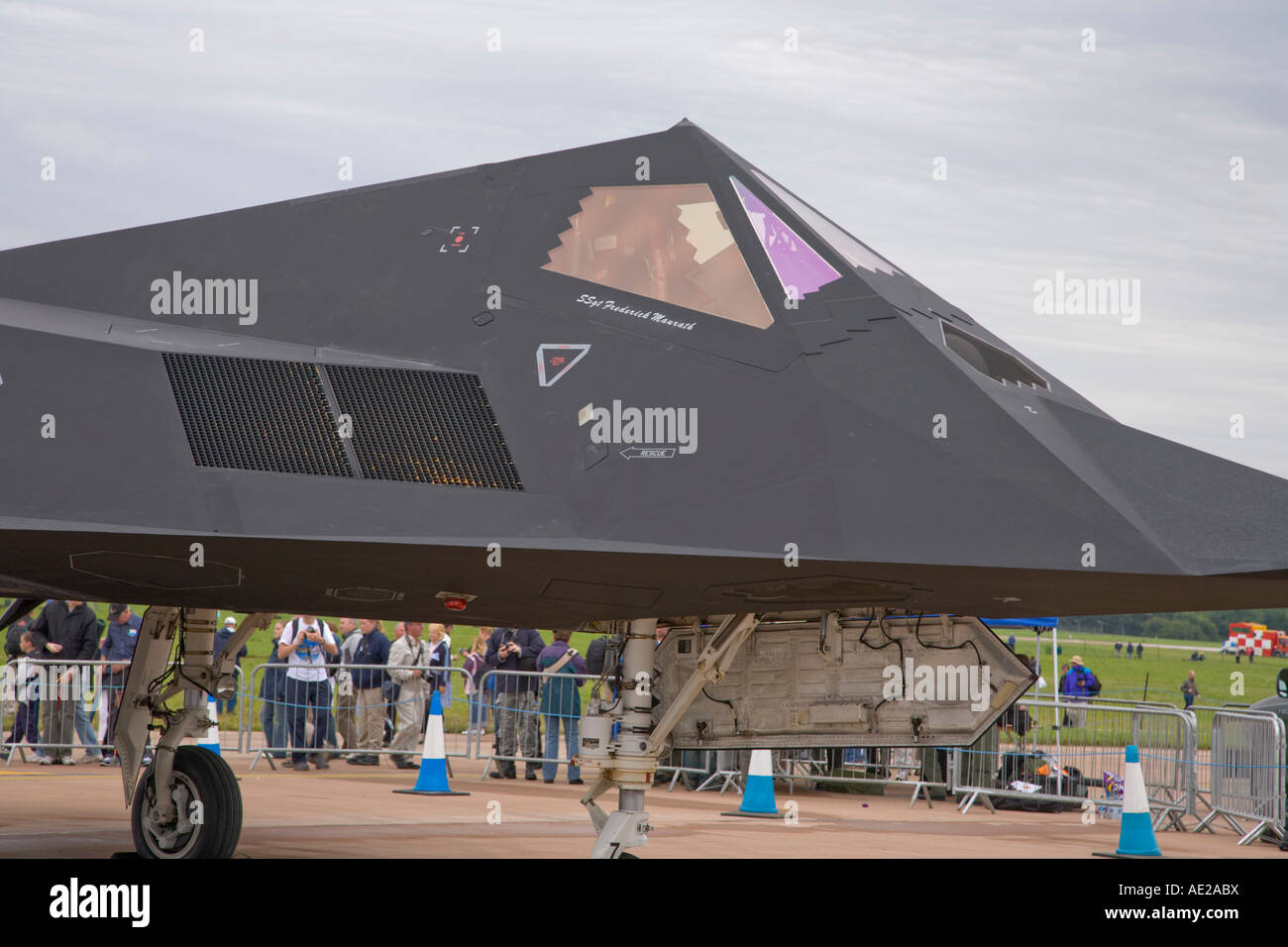

I think you are good to go and are just seeing something you aren’t used to. Many jet aircraft have somewhat tinted canopy or glass. If I’m not mistaken that’s probably what you are seeing in the kit.
Here’s the reasoning (pulled randomly off of the web).
“The F-117 Nighthawk canopy is not yellow, but features a thin, transparent metallic coating, typically gold or indium tin oxide, that can reflect light with a yellow-ish or brownish-gold tint. This is a crucial element of its stealth design, not merely for cosmetic purpose”

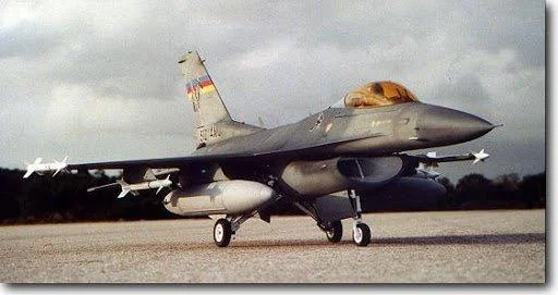

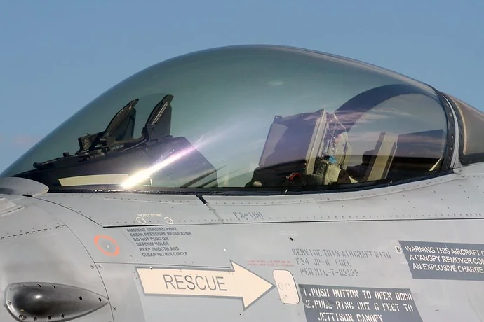

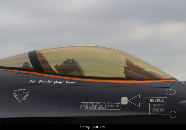

It’s very noticeable on F-16s as well. There seems to be a few different, slightly different colours (especially on the Falcon), but I’m pretty sure it’s often just the viewing angle.
I would build it like it is, but if the yellow is too garish (might be with a black plane), I would tone it down with some transparent smoke colour.
