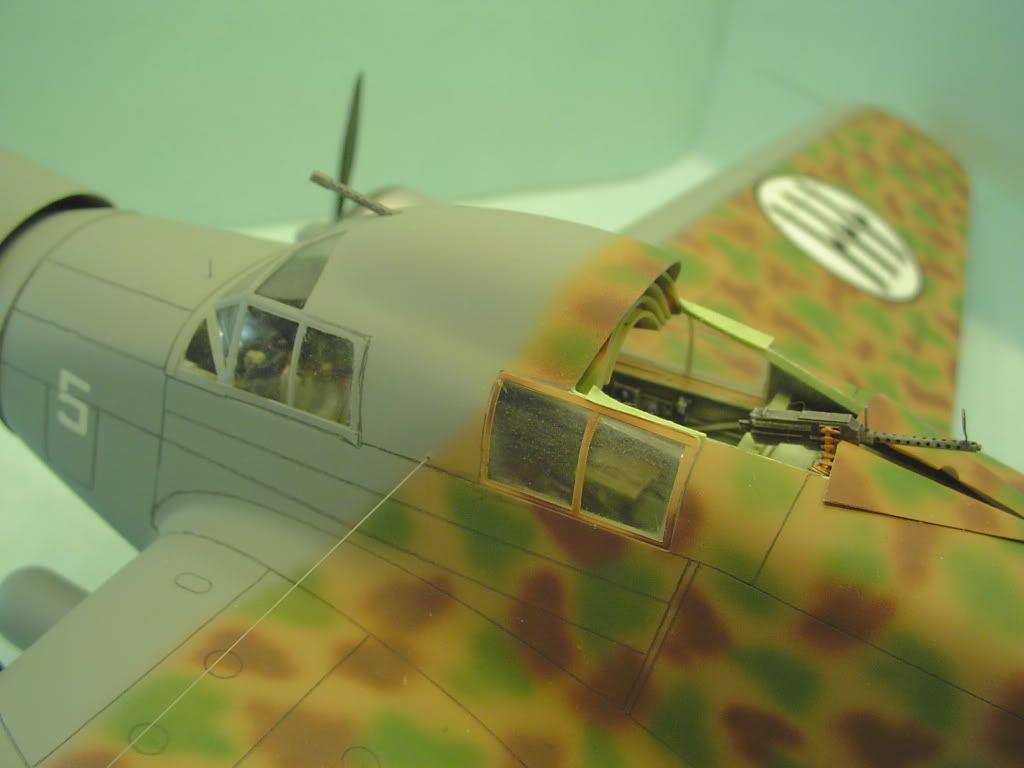

Light green:

If you use Tamiyas paint...XF-71 Cockpit Green....almost the same color in Mannys picture.
