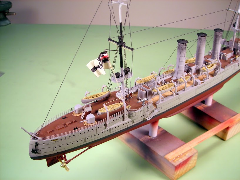

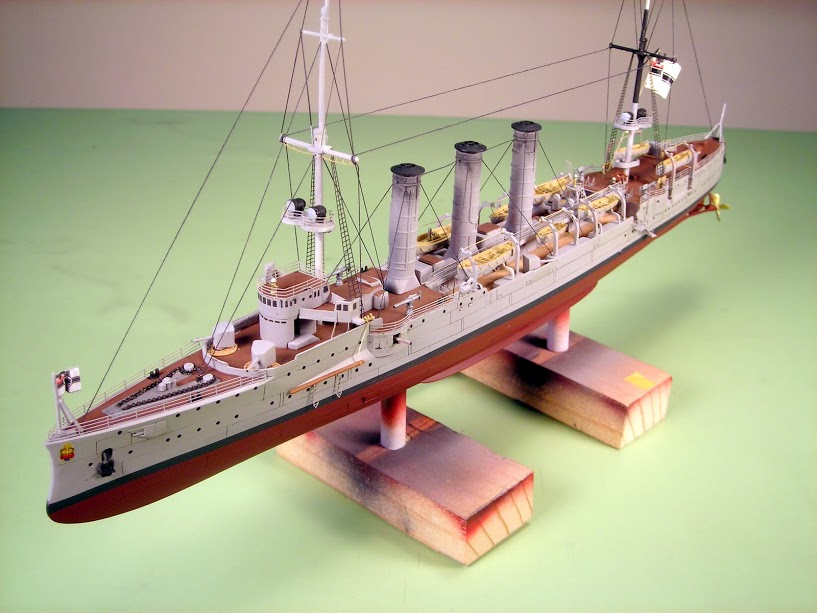

Greg, I built the Emden & used Artwox. It is a little bugger. Here it is.
