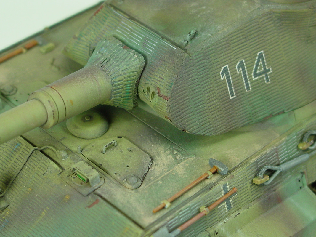

Getting off my lazy butt by episodes, I finally managed to have some work done on this kitten.
My camo scheme was sometimes off, my airbrush spattered a little, I corrected the stripes with kind of a semi-drybrushing ; it worked reasonably well.
Tried some slight chipping around the engine and crew hatches, careful not to overdo it as those machines were pretty new. Could have done better.
I made a mess with Tamiya’s panel line, I tried it on the zimmerit, which was already a very stupid idea, and when I tried to swipe it with an X20 soaked q-tip (like the tag suggests), it started to attack through the Vallejo varnish (acrylic rattle can) to the paint. I think I’m the main culprit, I probably should have let the varnish coat cure for hours. Anyway, I correct most of the mess with drybrushing again and the rest should be relatively hidden.
I’m very happy with the way the engine exhausts turned on, kind of an happy accident (the primer, not very well applied gave it texture?!), just drybrush coats of flat black, red brown…
I’m considering doing a full model wash with oils and lighter fluid, to really mark the zimmerit grooves but am afraid to ruin it… opinions?
Next are pigments on the wheels, kit tracks and tools…
The camo came out great.
Yes of course Tamiya acrylic thinner is going to attack your Vallejo acrylic clear coat.You need to think opposites,acrylic clear-enamel or lacquer wash,and vice-verses.
So your oil wash will work with the acrylic clear,but make sure it is fully cured.
Oldest rule of thumb in the book, dammit![bnghead] should have stick with my regular oil wash and take more time!
Thanks Tojo!
She looks pretty darn good to me.
Tojo has good advice there. Plus I tend to let a clear coat dry a couple of days before doing anything with it. Course, I’ve had my own problems- I just clearcoated a TD and found a bunch of waterspots underneath it. Guess I could just overpaint them but I’ve of half a mind to just throw some camo nets and foliage over them.
[Y] Excellent work, the camo looks great!
