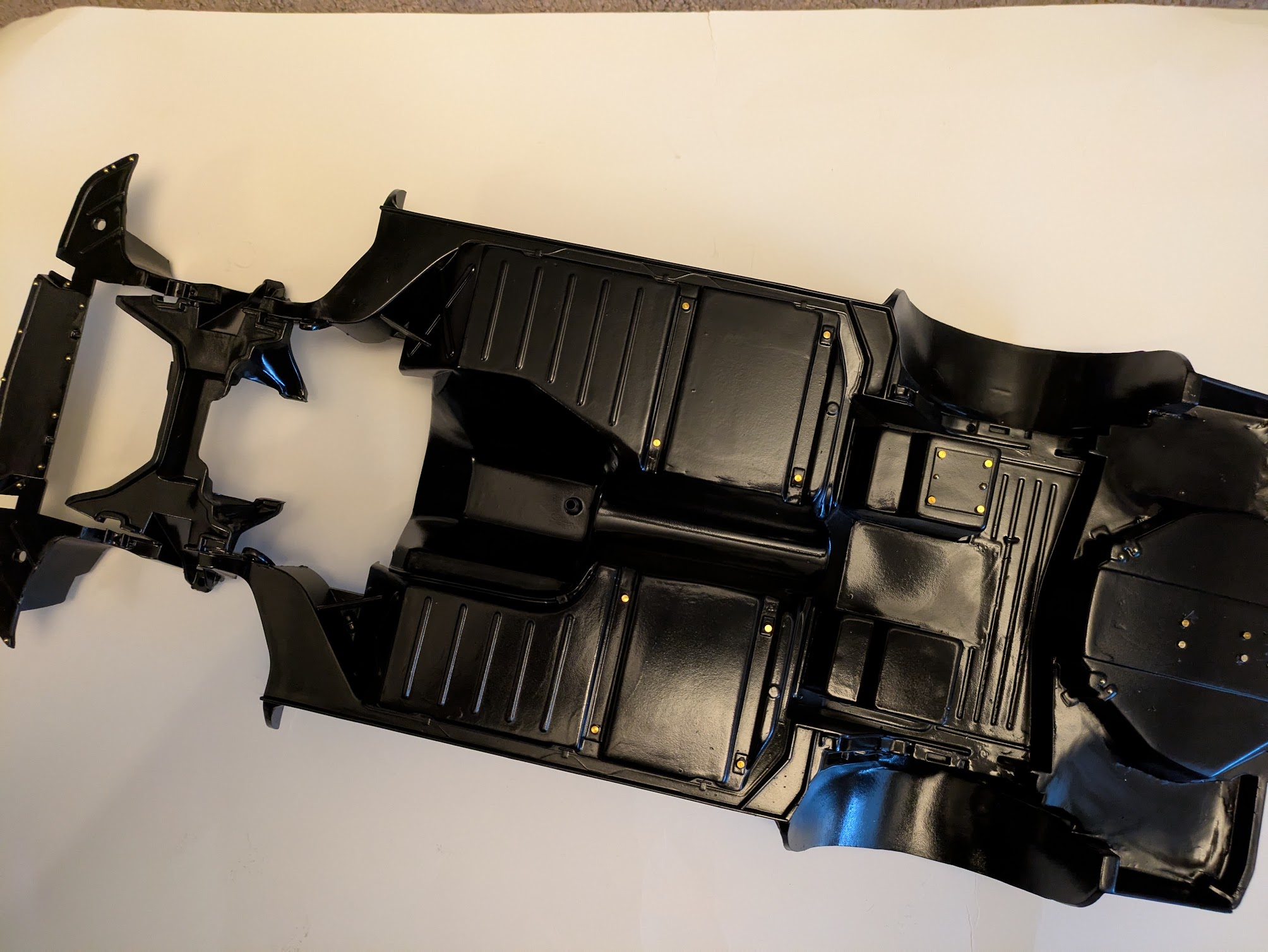

The undercard in the model in molded as a single piece - I decided to cut it and make separately the Rear end, mufflers, exhaust and wiring\piping

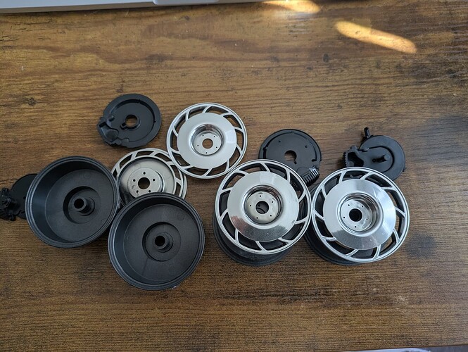

The wheels are also made pretty strange - they have 2 inner sides with molded brakes to the shield. I didn’t like that and decided to make it more real
It required to use 3d printer to make brake rotors. Also, since the brake calipers where only halfs - I molded mine one by duplicating these halfs in epoxy

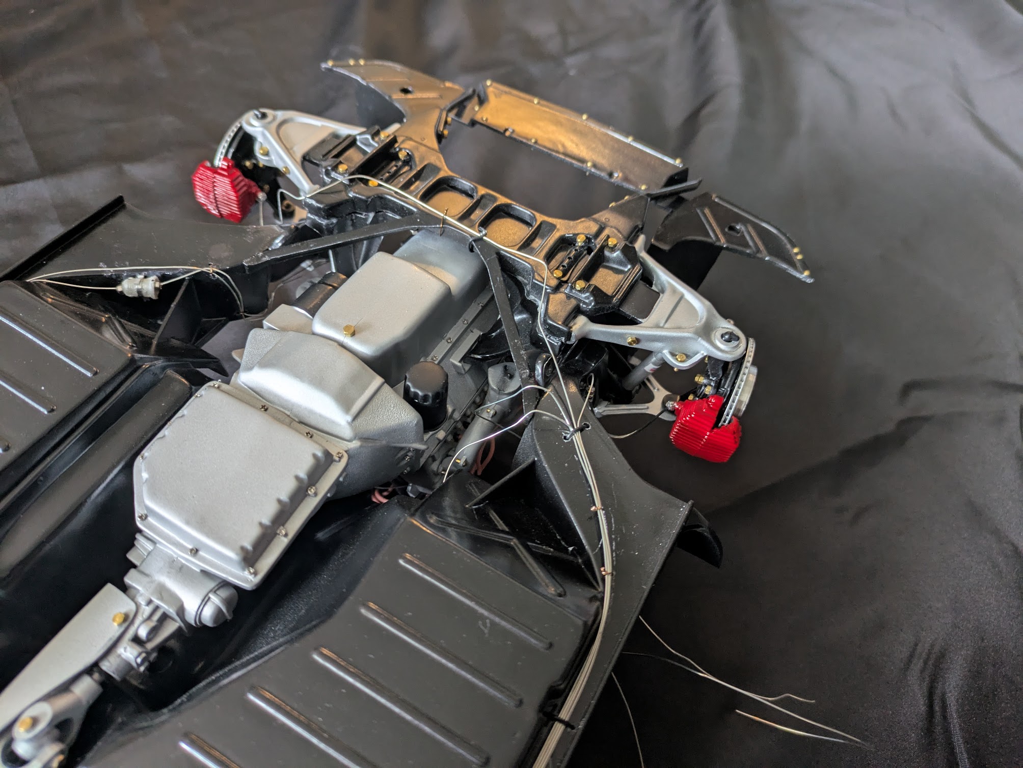

Made custom shock absorbers from aluminum pipes (I have KYB on my real car, so decided to stick with that :slight_smile: ) and added details to steering rack
Engine was reworked too
And here is undercarriage result (without mufflers and exhaust)
Then I added exhaust (bended stainless steel pipes), mufflers (aluminum can foil) + some hardware
(btw - all bolts are real - either brass bolts or steel nuts and screws)
