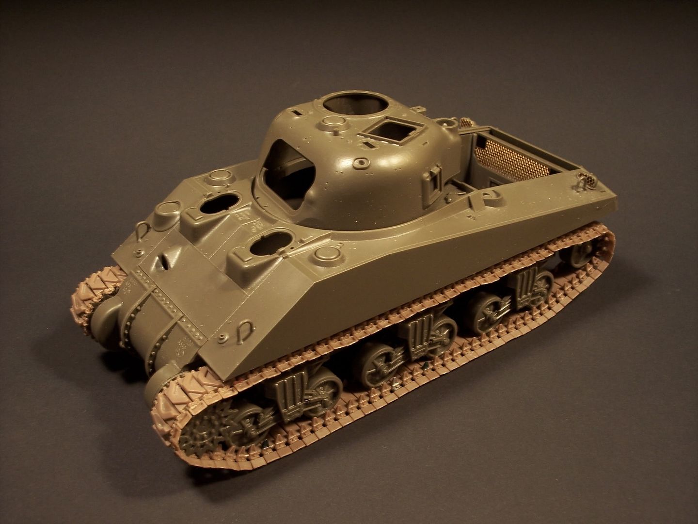

Personally I think the Dragon Sherman track gets criticised way too much. If you ever bother to look at real Sherman track, you’ll notice that all the VVSS types have two hinge pins per link, not one like German armor. The way the Dragon tracks are made is the only way to go for indy Sherman links - if they were made as one part per link, there would only be one hinge point per link, and the track would look ridiculous where it went around the sprocket and idler, only bending at every other pin. It also wouldn’t mesh with the sprocket unless it was flexible at both pins.
The DS Sherman track isn’t as bad as some, and the detail is quite good, with space between the links and good detail on the end connectors. (I’m looking at the T54E1 set from the Sherman Mk. III) The downside is that the tread blocks curve around the sprocket and idler, but it looks better than single piece indy links would.
