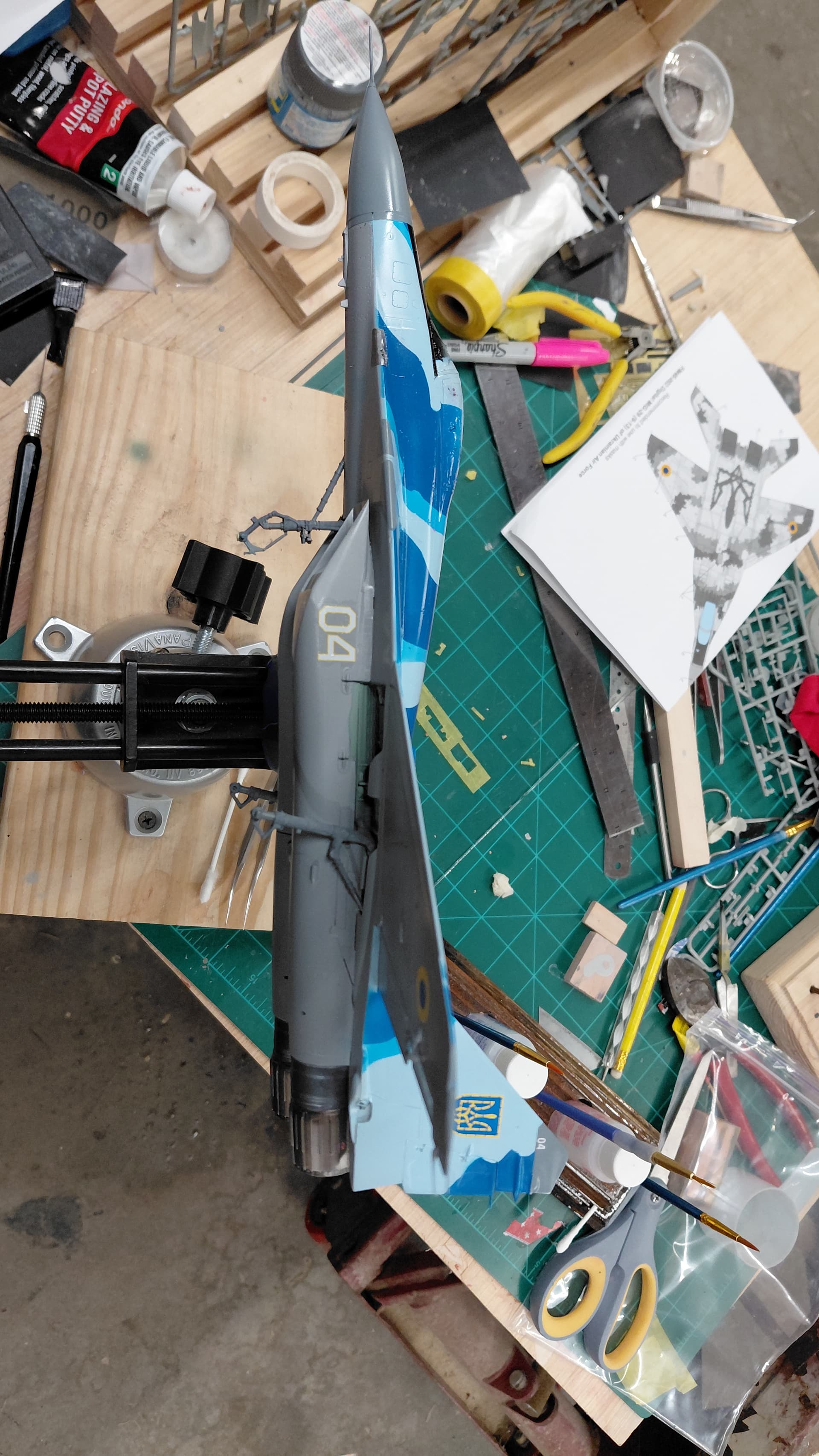

I have a wide rubber covered Jaw Panavise that tilts, turns and opens very wide.
When applying decals it is important to keep the decal softener on until it evaporates and this vise allows me to adjust to any odd angle I need to insure that it stays on long enough to evaporate.
