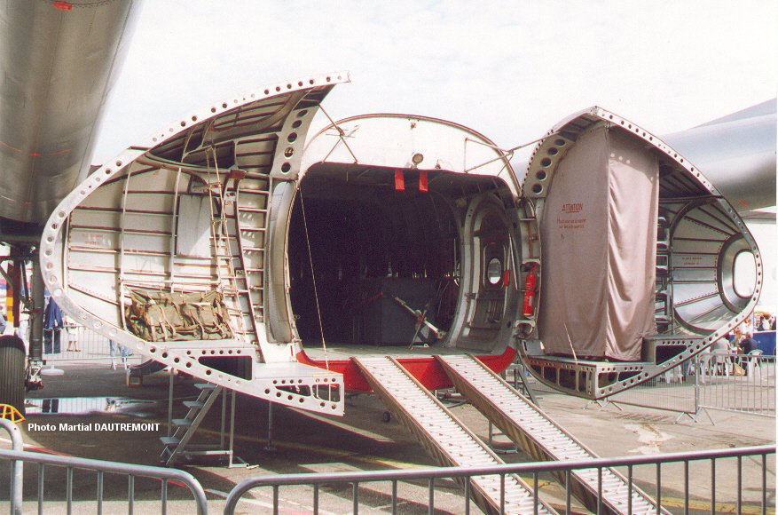

Here’s a pic:
http://dautremont.chez-alice.fr/Cargo/Noratlas_1.jpg
That’s a great pic , Thank’s Bill . there appears to be some struts and stay’s positioned at the top of the clamshell doors along with a support cable on each door as well . “BUT” please set me right , is that a toilet facility on the inside of the right clamshell door .[%-)].
John
I have no idea, but if the TP is in the duffel on the left, I’ll hold it in for the flight!!!
