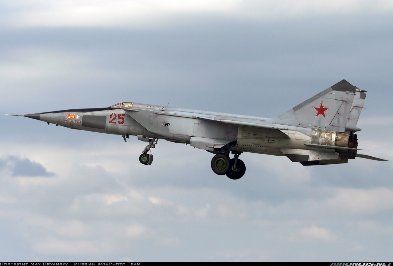

Looks like some kind of grey. Anybody knows what the closest commercial paint color is?

As you can see from the picture, there’s a lot of variation, so you probably have a lot of freedom here, but I believe the colour you’re lookin’ for might be FS36375 - Humbrol 127. I hope somebody else can verify this - good luck with your build and have a nice day

I purchased Begemot decals for a Mig-25 I plan to build one of these years. Anyway, the base color according to these decals is Light Grey FS26073.
But, if you look at the Federal Standard colors: Here The Grey is very dark.
I have a Kitty Hawk Mig-25, I’ll see what is says in the instructions, give me a few.
Light grey w some bare metal areas…
The instructions call out FS36320 on the pylons: Here
I think I will just use generic very light gray for the body plus medium and dark grays and bare metal for the special details.
The problem with using a precise shade of grey is after years of service the color will fade anyway and it will look nothing like the original factory hue.
The paint job on the MIG-25 in the photo looks a bit oxidized (old paint job). A few panels look like they have been replaced recently and painted.
The instructions scanned have on the painting instructions a formula to mix gunze sanyo H308 90% + H337 10%. (Humbrol Hum 127 90% and Humbrol 145 10%) The Federal standadrs are 36375 Light ghost gray (light compass gray) 90% plus 35237 which is a blue-gray. 35237 is labeled “medium gray” by testors.
Rather pragmatically a good guess for the aircraft’s color would be Testor’s “Aggressor Gray”. Its a color modeled after the gray used on soviet aircraft in the cold war. its federal standard is 36251.
I have been up close on this aircraft myself and from what I could tell it was not painted at all, it looked to just be steel, I remember a documantary saying thy had to create heat resistant paint for the red stars because the paint kept peeling off but didn’t menation the rest of the aircraft, plus when I was next to it, it just looked like unpained steel.
