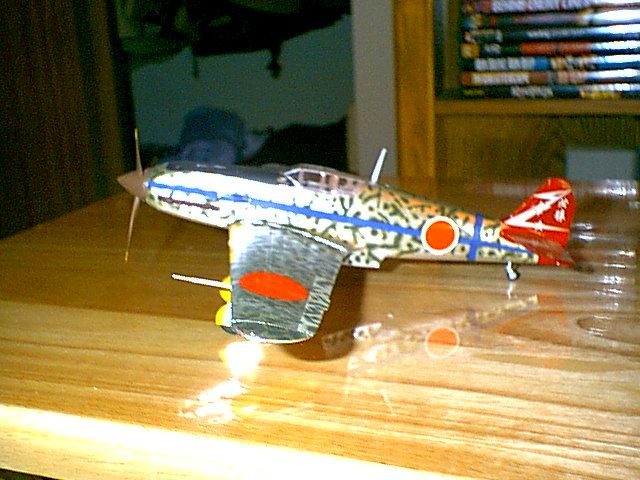

I use Bare Metal Foil all the time. I have tried Alclad and SNJ but I don’t like the clean up and vapors that go along with them. That’s the down side IMHO. The down side to Bare Metal Foil is that it is delicate to work with. Bare Metal Foil comes in the three different types and as far as the brightness of the completed model, in order to get a less shiny surface and to vary the brightness of different panels, I airbrush a coat of Micro-Flat on the areas that I want to dull up. The Micro-Flat gives the desired effect for the oxydized surfaces. I have even used a single light coat of Future that actually reduced the shine of the foil.[8D]

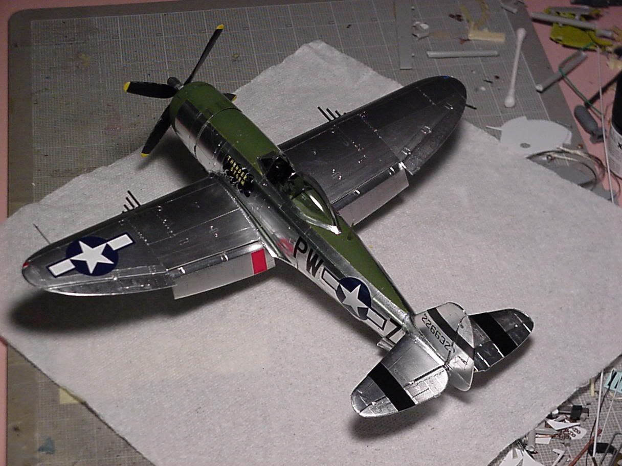

I believe there is no difinitive answer on this one. I have used both products, and have had decent results with each. It seems the big complaint with foil is that it’s too reflective. Alot depends on the aircraft you want to model. For instance, take a look at photos of a B-58 Hustler, or a just about any F-104. I would say the skin on those planes are extremely reflective. Bright, shiny. almost mirror like. I agree that many nmf planes in service were oxidized and dull, but there are times when the planes were polished and clean. For example, a squadron commanders plane.
I have color photos of this plane and I can tell you it was polished. Bright,shiney, and reflective. Commander Tice 404th P-47
In this instance I prefered to use foil. I dont think I could have got the same look with Alclad.
BMF is a sheet of aluminum, and after all, isn’t that what a plane is covered with?
Notice the different look to the wing panels. The wing is covered with foil from the same sheet! There is a grain to the foil, and to vary the shades you simply turn the foil 90 degrees to the other to achieve a reflective variation. If you turn the plane around, the dark panels are now light and the light panels are dark. Just like on a real plane. You cannot do that with alclad.

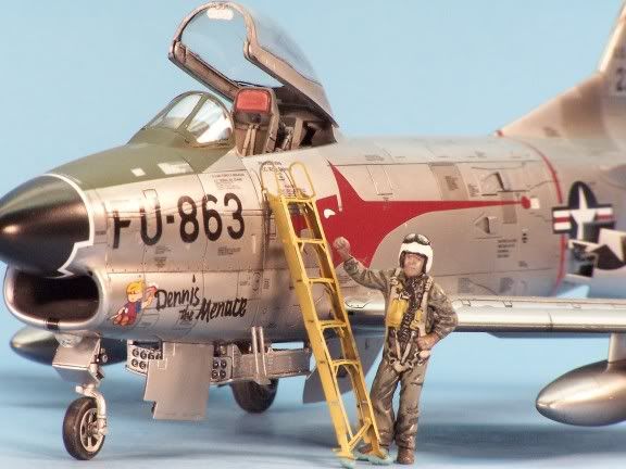

Here’s an F104 foiled. The wing tanks are Alclad. I used both.
