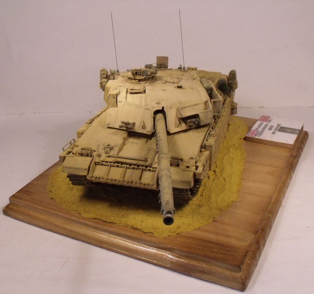

I use balsa wood to go around the edge of the base. The base itself is what ever wood i have to hand. then, if neded, i build it up with strofoam. I then add the balsa but slightly higher than the foam to allow for the celluclay. I stain and varnish the balsa before add the celluclay.
I don’t have any in progress images on Photobucket, but hopefully you can see what i mean.
Hope that helps.

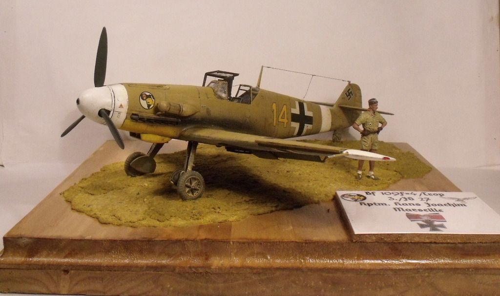

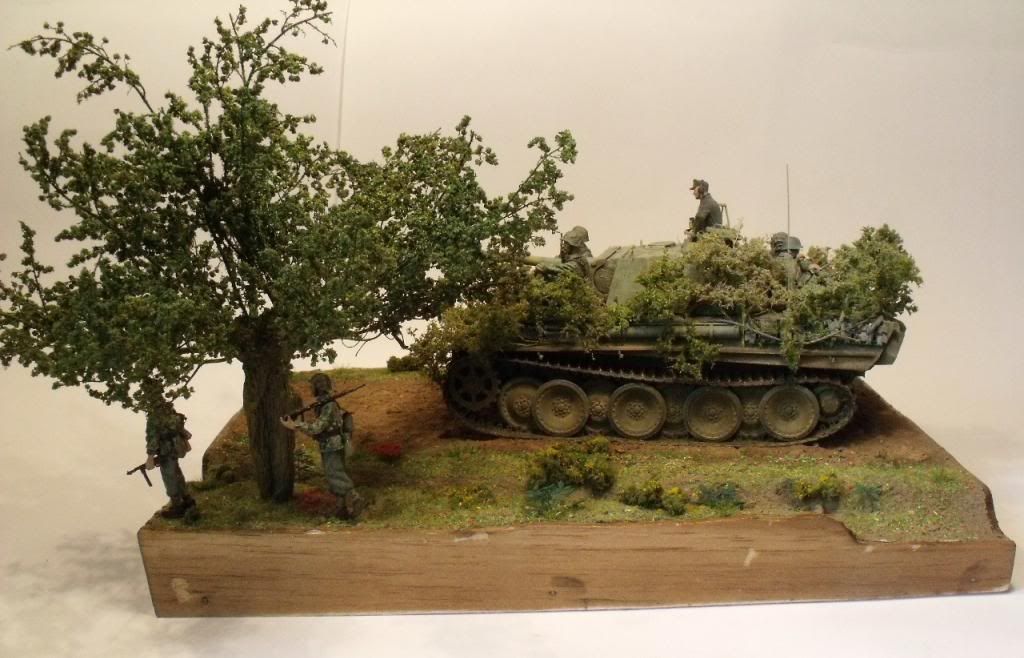

In regards to routing edges, i do that for bases when i am not doign a dio. I use a piece of shelf pine, sometimes 2 stuck together. I got a router quite cheap, about 320, and its really not that hard to use, and trust me, i ain’t no chipy either. But be aware, if useing celluclay on a single piece of pine, it can warp. I have had that happen a couple of times. But i would do this for a dio, as i like my dio’s to cover the whole base.
That was two pieces, one on top of the otehr. You can see the join, i need to improve on that. This is one piece and it did warp slighly.
