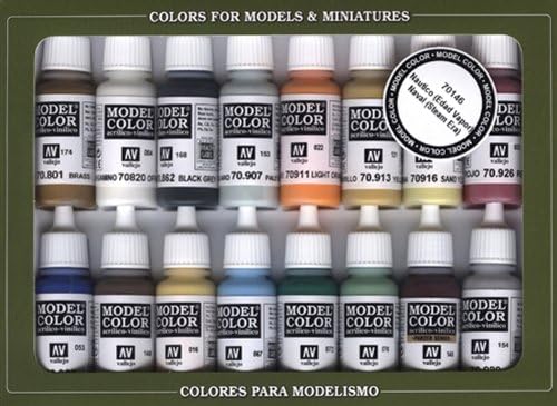

Here is a complete set for the steam ship era
Vallejo Model Color is an acrylic, brushable, water cleanup paint. Remembering that the steam era overlapped the end of the sail era. Many of the colors would be compatible. The picture is off Amazon, but you may be able to find the set through other online sellers

You can never go wrong with Vallejo. The standard line can be airbrushed if you thin them and keep them mixed up with airbrush thinner. They like to seperate but work okay if you bully them a bit with your stirring stick. The Vallejo air range airbrushes much nicer and should have many of the same colours. Panzer Aces are an off shoot of Vallejo model colour and may contain some suitable colours since they aim for perfect accuracy to real subjects.
You maybe able to find a conversion chart online to find the right vallejo colours you need.

I have been trying to get the Vallejo set in the islustration, but, Amazon shows it a s back odered, I have lookes in other location but, I have not been able to find it.

Looks like it may be instock & available from squadron. Item VJ70146.
