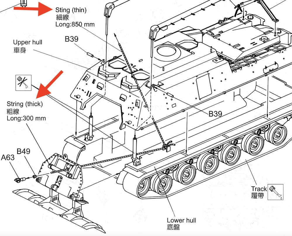

What is the size string in AFV CLUB'S kit, M88A1 RECOVERY TANK. I'm short string, don't know what i could order
What size string is in AFV CLUB’S kit M88A1. Not sure what size string to order.

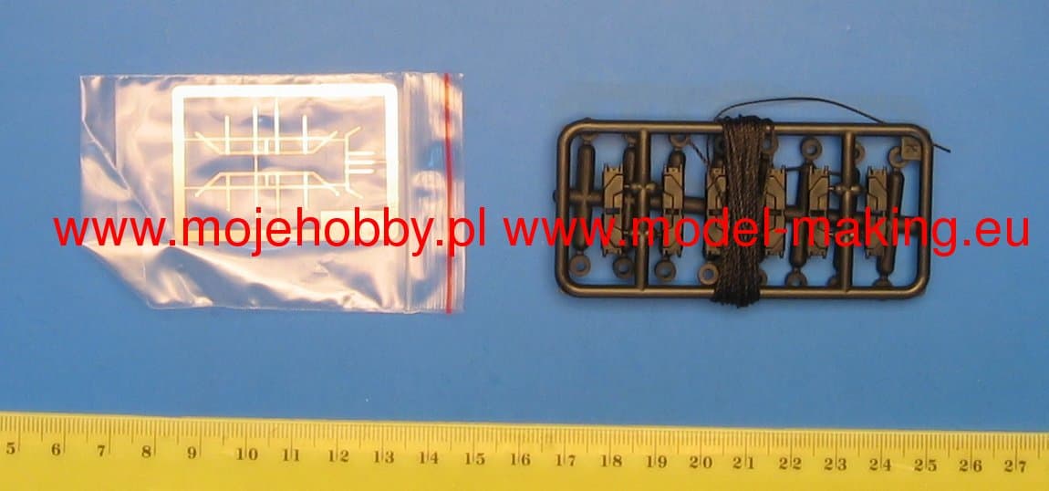

Don’t know if this helps, but here’s a picture of the string.
Thank you, I used my caliper. I believe it to be .5mm , i ordered some from Amazon. Very difficult to get a response from AFV company.

The cable for the boom and the two boom stay cables come in the kit as string.
There wasn’t enough string, i’m short 120 mm of string.
There also appears to be two string thicknesses.
