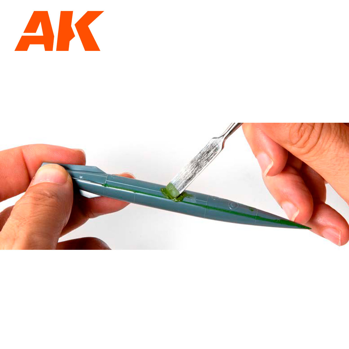

Personally, I like AK Interactive or AMMO MiG Jimenez products. They are both ideal for filling gaps or to refine some surfaces. They can both be easily sanded when fully dry and can even be “wetted” to make them smoother. They both come in dispenser tubes and a small amount goes indeed a long way. They both can be cleaned with water.
And here they are:
AK Interactive White Putty
AK Interactive Grey Putty
AK Interactive Green Putty
