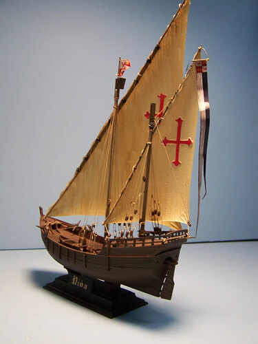

I have built this model and my preference is to make the sails so that they don’t distract, or stand out from the rest of the model, but have them sort of blend into the whole model. I have used silkspan, paper, and plastic sails. I start with spraying a base coat of flat white primer, then follow with a very light coat of off-white, then with a very soft, wide brush, blend with washes of the off-white mixed with a light brown. The goal is to get all the colors to blend and let lighting take care of shading. I prefer to stay with acrylics, water colors, and pastels vs paint that requires a thinner.
I lost my Jolly Roger years ago to a cat accident, but here is my only picture of it.

I’ve only used the vacuumed formed sails that come with the kit but I start by painting the sails with Buttercream acrylic craft paint. Tom me that color comes close to a canvas look. Then once their dried, I clear coat them and then either use an oil wash or pastels to weather them, depending on how “weathered” I want them to look.
