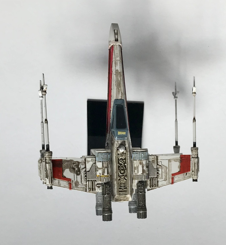

Perhaps try an oil wash with a very mild thinner such as Mona Lisa brand. It should not attack the Bandai Plastic. I can’t remember what exactly I used on my Bandai X-Wing 6 years ago…

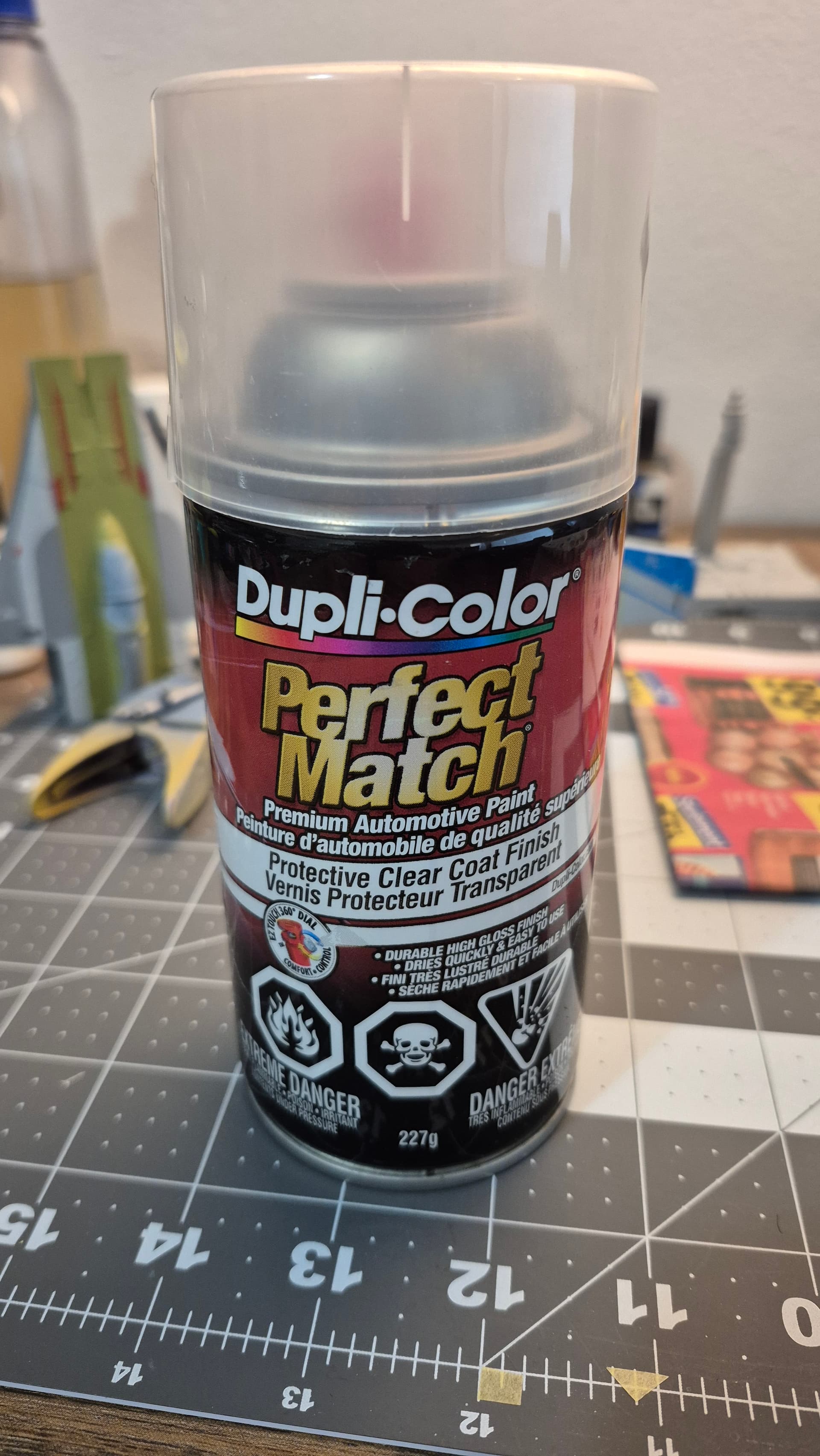

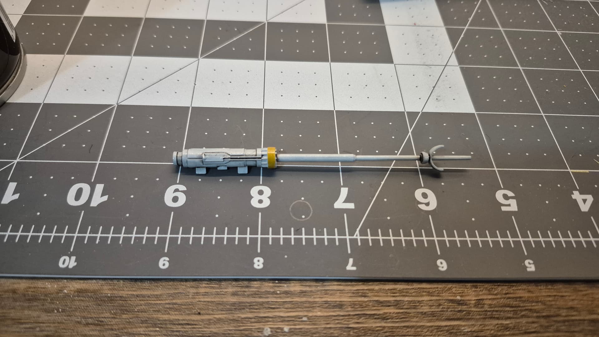

Update: I tried using Duplicolor lacquer clear coat on a test piece and it seems to have worked. I left the clear coat to dry for a day or so before applying the wash to be safe; it’s been a few days so far and nothing has cracked or snapped off :partying_face:
