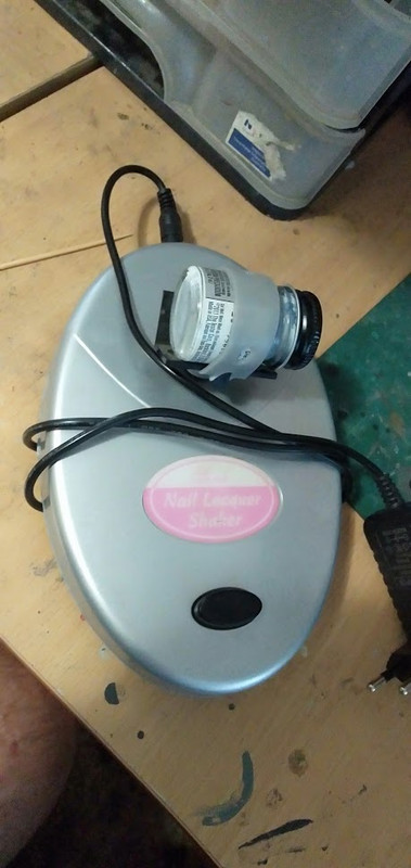

I got this a few years ago , nail polish stirrer , on ebay for about $5 .

I use this exact same machine…works great and it is relativly quiet!
