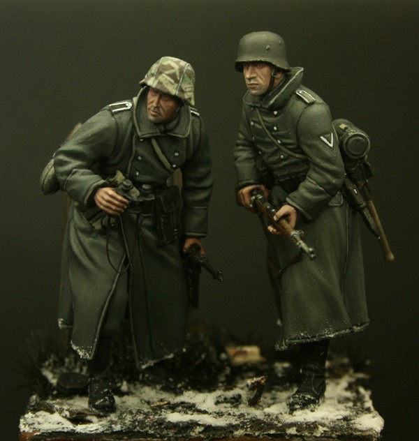

Getting a process down is going to take some research and trials—it’s an ongoing pursuit to put together your oun style----but I’d recommend following the detailed blogs / articles of some guys that can really paint—you’ll pick up more than enough ideas
Check these out
http://www.militarymodelling.com/forums/postings.asp?th=50835&p=1
http://felduniform.blogspot.com/
