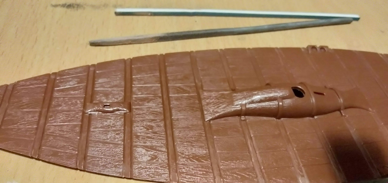

in the 3rd picture down , you will notice the bottom oar is way bent . any ideas on how to straighten it please .
Net, so what kit is it?
Hi;
That looks interesting. Now as to that oar. You can try some very distantly applied heat. That’s why I keep a " BIC " in the shop! Or a kitchen match that you just extinguished and is still hot.
I find a small heatgun less risky. Also, if you can, clamp it straight before applying heat.
I use hot running water to straighten bent or warped plastic parts. Simply hold the part under the hot water running from the kitchen tap, slowly straightening as you go. It should only take a few minutes. It’s easy.

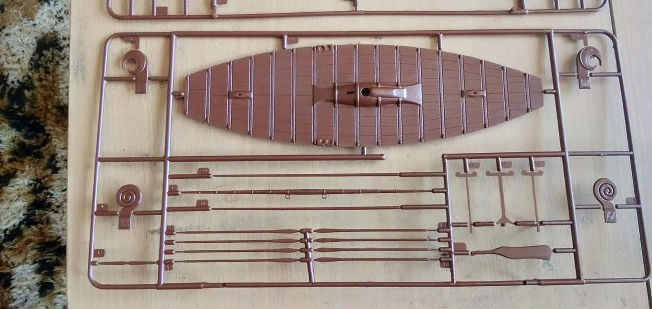

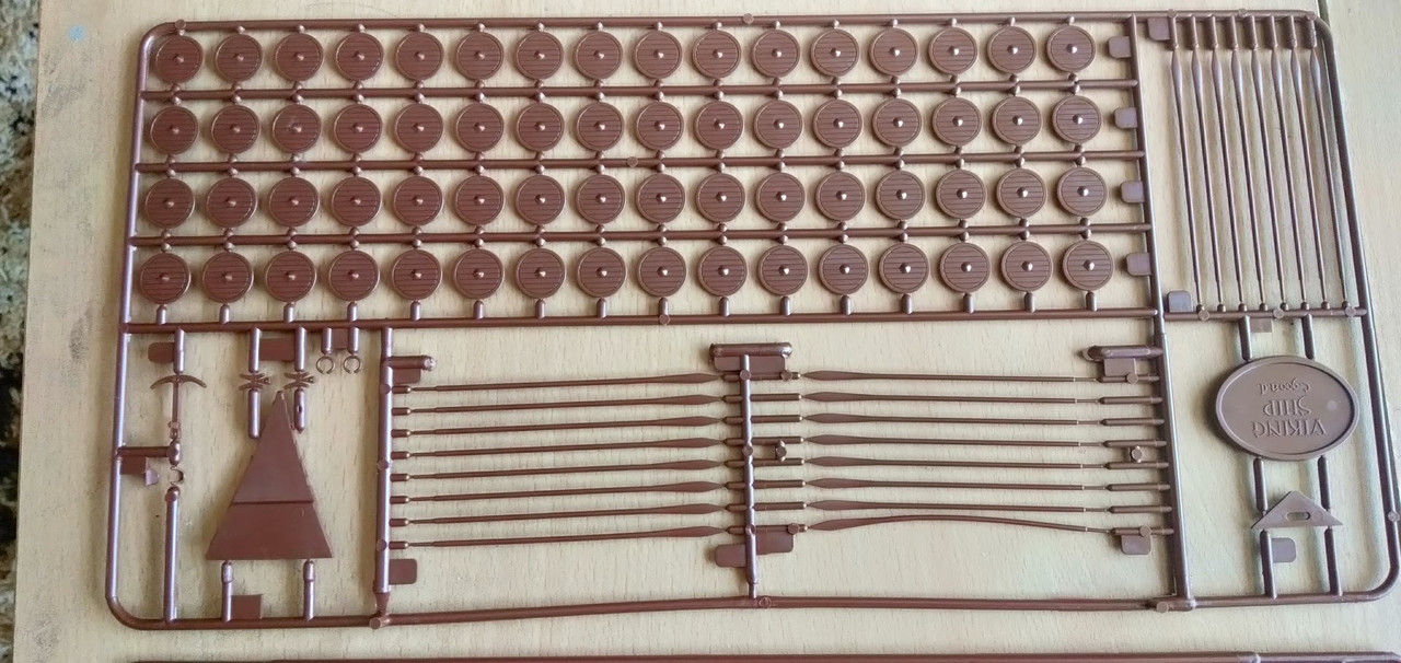

Those oars come in a number of lengths. Tilley and I worked up to the idea that this was to compensate for the oarsmen at the bow and stern being higher above the water than those amidships, due to shear.
The question I confronted was what to even use the oars for. It seems unrealistic to stick them out of the sides of the ship without oarsmen holding onto the end, and those are hard to come by.
We couldn’t figure out just what those T shaped posts up and down the centerline are for. The three most likely candidates seem to be the mast and/or yard, but that would be a chore to get up on them and why?
It could be the leech pole; the poles that hold the leeches or edges of the sail away from the ship when the sail isn’t full. That’s my guess.
Or the could be for the oars.

Revell.
sorry guy’s forgot to add this .

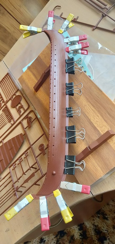

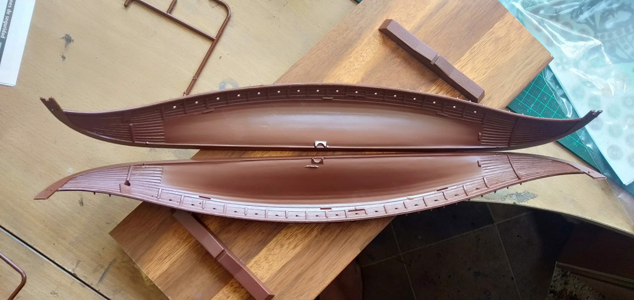

glued the hull halves together .

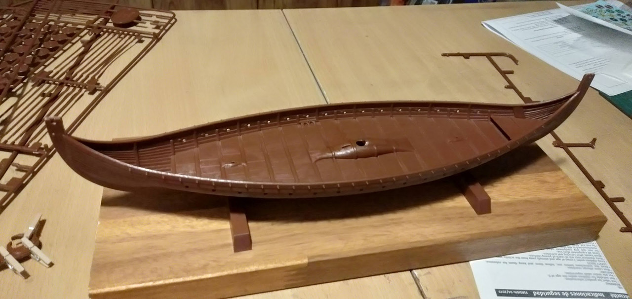

knocked the knees off of the deck , will post pic’s when I make my own . I am leaving the ones on the crone for the time being .
this piece of board should do for the display
