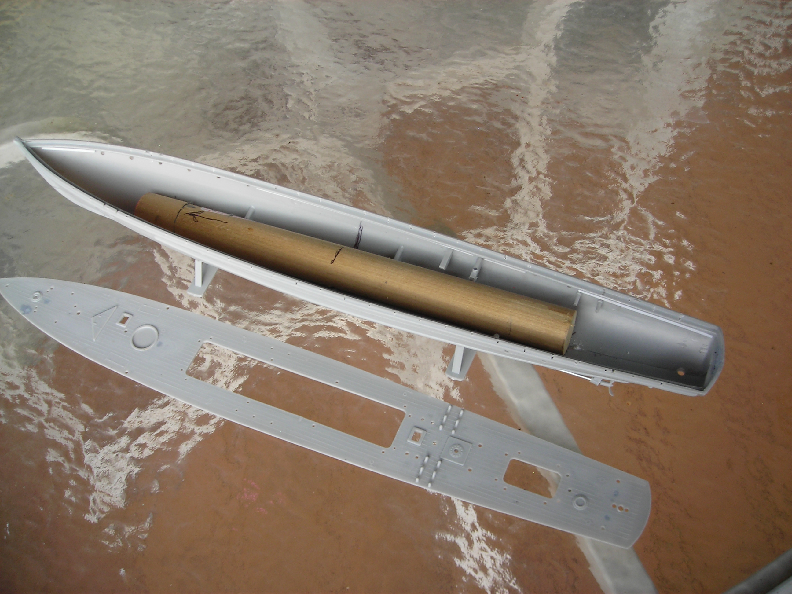

I took a few pictures of my start with a 1" piece of wood dowell about 9" long in the hull bottom, but I haven’t found them yet . They held the model base fine as always on my ship models. I use a #6 or #8 screw thru a piece of brass tube & a decorative pedastal to finish.

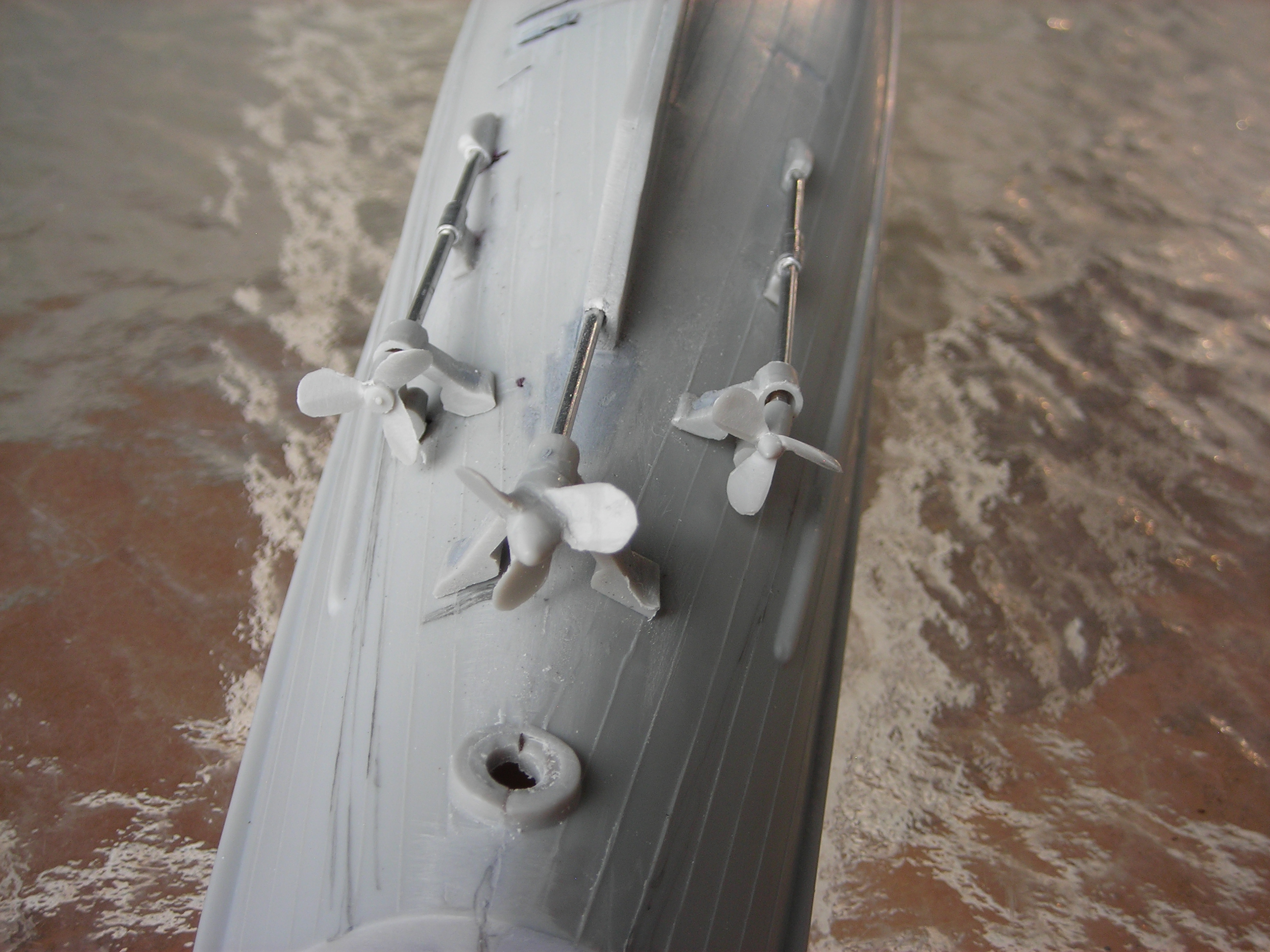

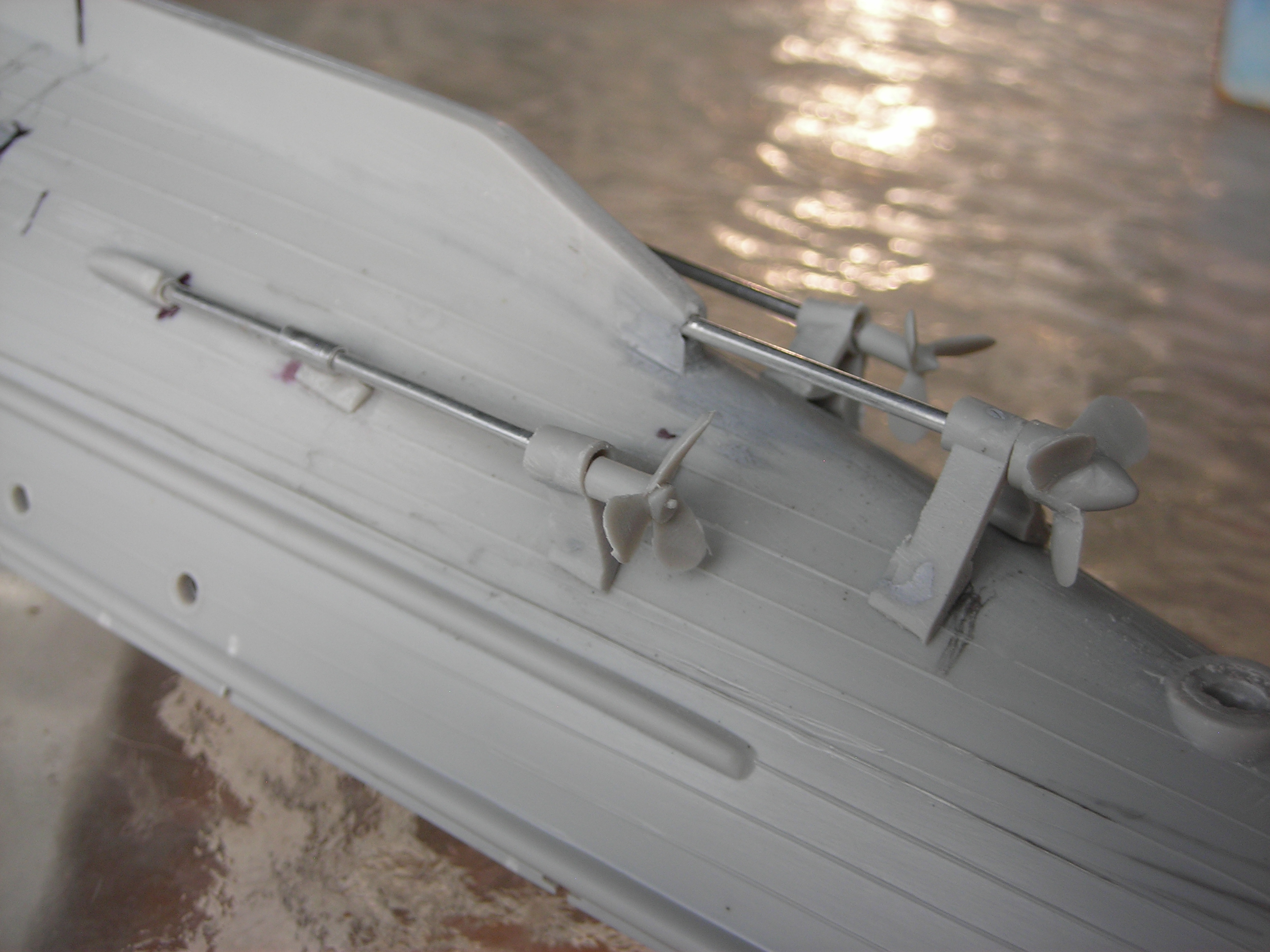

Some of the things I did were The 1’ dowell in the hull, the Scaledeck wood deck , the railing done with .032 brass rail posts & .020 pvc top rail & .o15 lower rails. I wasn’t happy with the plastic rails this time. Pilot house rail. Lifeboat extra detail, I ground the kit boat sides out to thin them & sande the seats down to fit lower & added oars & rope rings. The masts & flag poles ,I made from 3/32 & 1/16 aluminum tubes. That is all I want to use for this size masts. I added the lit mast tops . I ground the searchlite out & used my Chrome paint pen in it. I cut the plastic prop shafts off & used 1/16" alum tube for shafts. I reworked the gun & added some brass wire & extended the gun barrel with some fine plastic tube & a brass whell from a 1/32 Spitfire PE kit. I added an extra depth charge rack at the rear. It is not on the model yet, but it’s done. I made life rings from WW1 plastic kit fighter tires.

Here are some detail pics of the props &the wood dowell in the hull. That has worked fine for me for ages & it is simple, & strengthens the hull.
