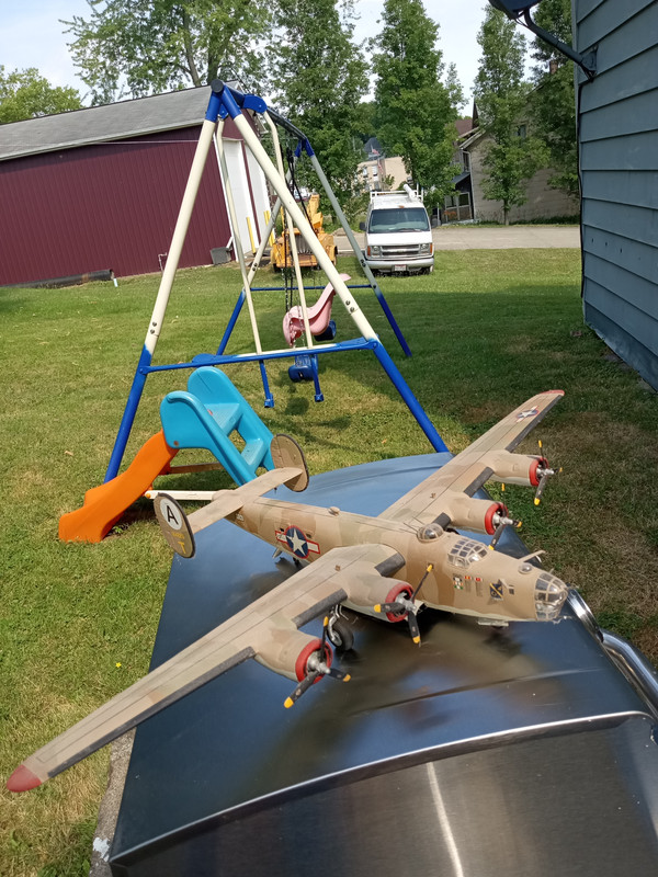

If’n I say so meself! one nice Bird! Looking Good my Friend. I just love that in daylight you got the colors to fall into line. She looks squadron Ops ready!
Great aircraft Eugene. Looksfantastic.
