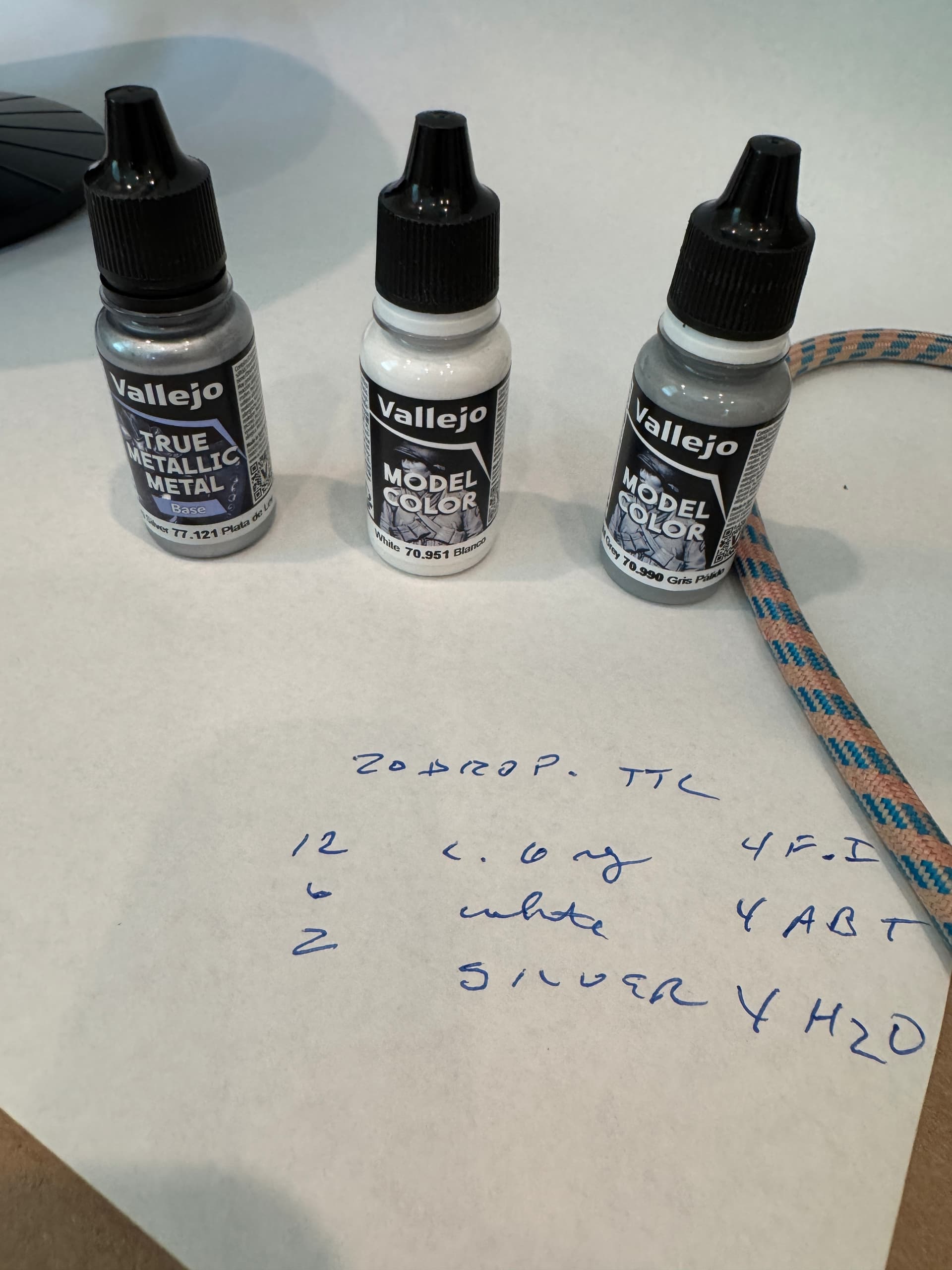

So im working on trying to get a shade of paint for NCC 1701 Enterprise Starship. Started to mix these and wondering - is it ok to mix VMC with Vallejo Metallic Meta Base?
Directions call for mix of 60% Light Grey, 30% white and 10% Silver. I have to use VMC White 70.951 , VMC Light Grey 70.999 and Vallejo True Metallic Metal Base 77.121.
I didnt know if was ok to mix the Metal Base with Model Color ? Just to test I did 12 drops light grey, 6 drops white and 2 of the Metal Base and 4 drops each of Vallejo flow improver & air brush thinner & water. The end result was bubbly and it made me wonder if I should be mixing True Metallic Metal with the VMC ???
Thought / tips welcome. Tks!
PS - I did not try and spray - this is just my starting point to try and get the right color im looking for. It also came out a tad too grey…
PS - I have VMC 70.864 Natural Steel I could sub out for the Meta Base

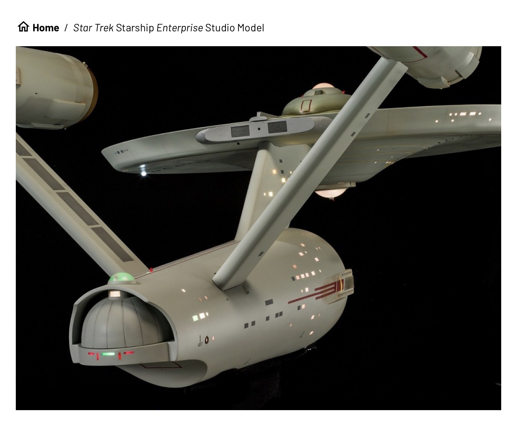

Which 1701 are you building? The reason I ask is the TOS Enterprise is Light Gull Grey according to Rick Sternbach who helped restore the original filming model at the Smithsonian.

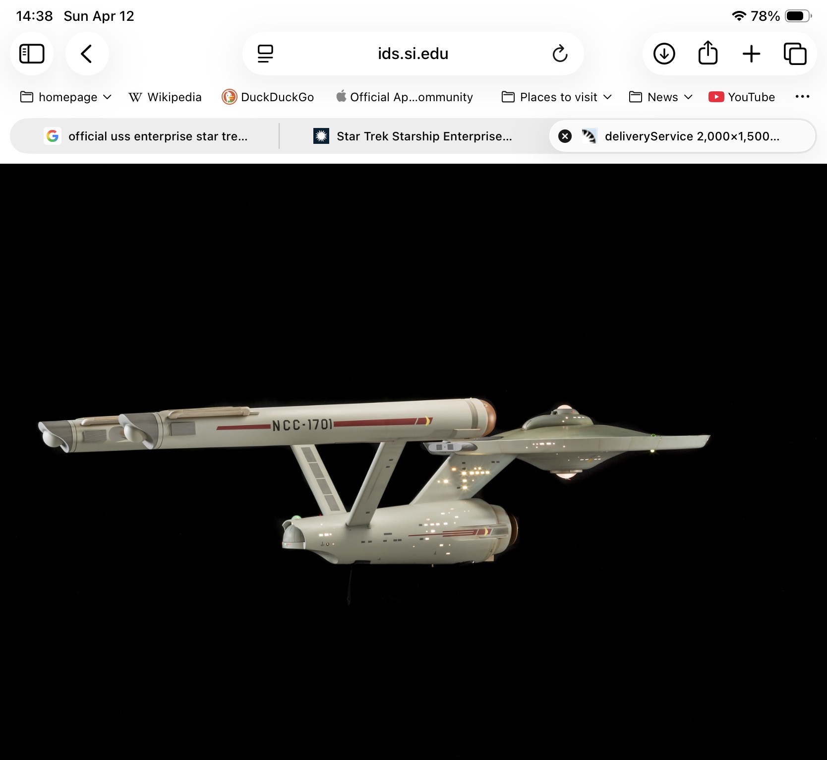

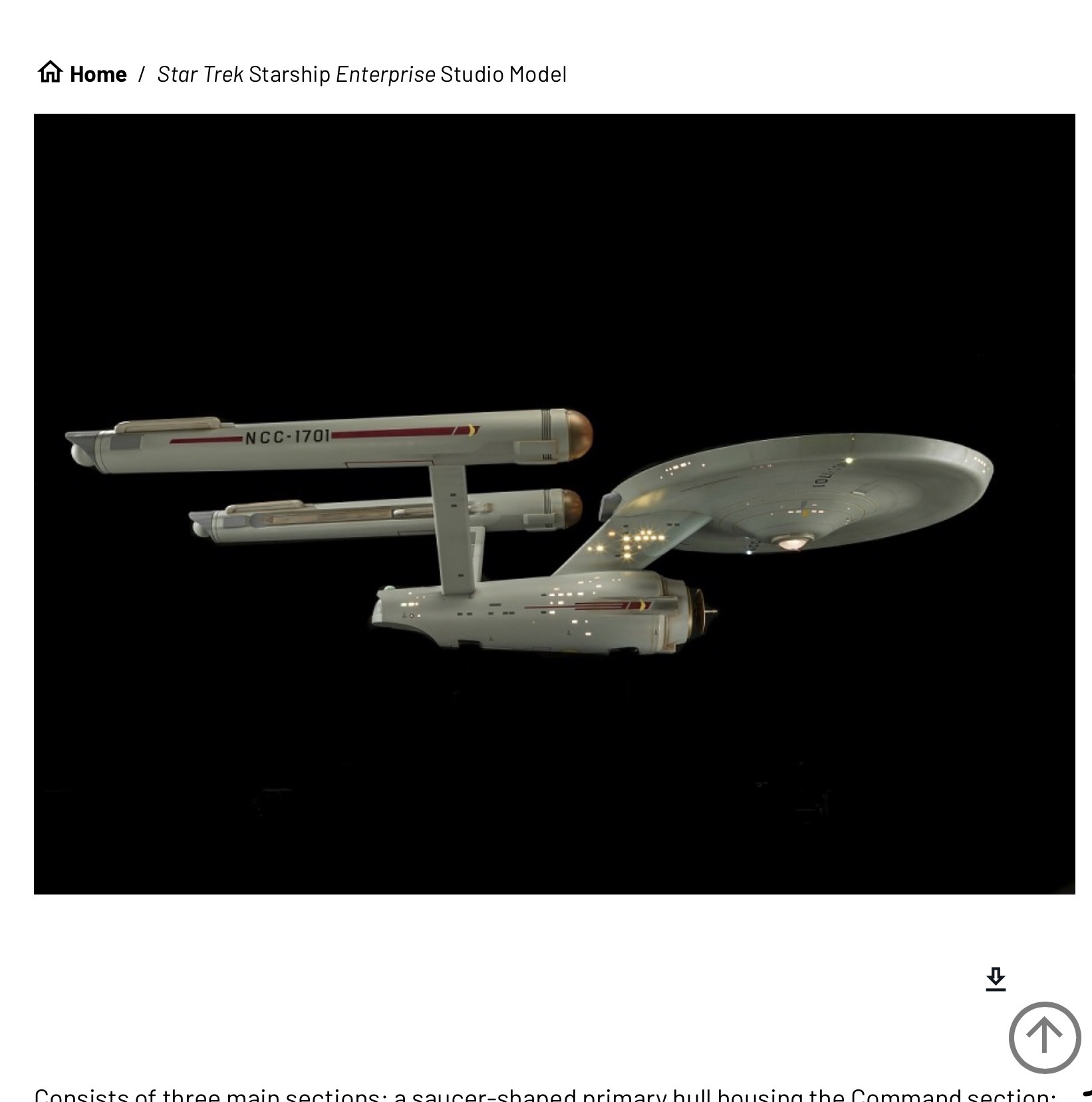

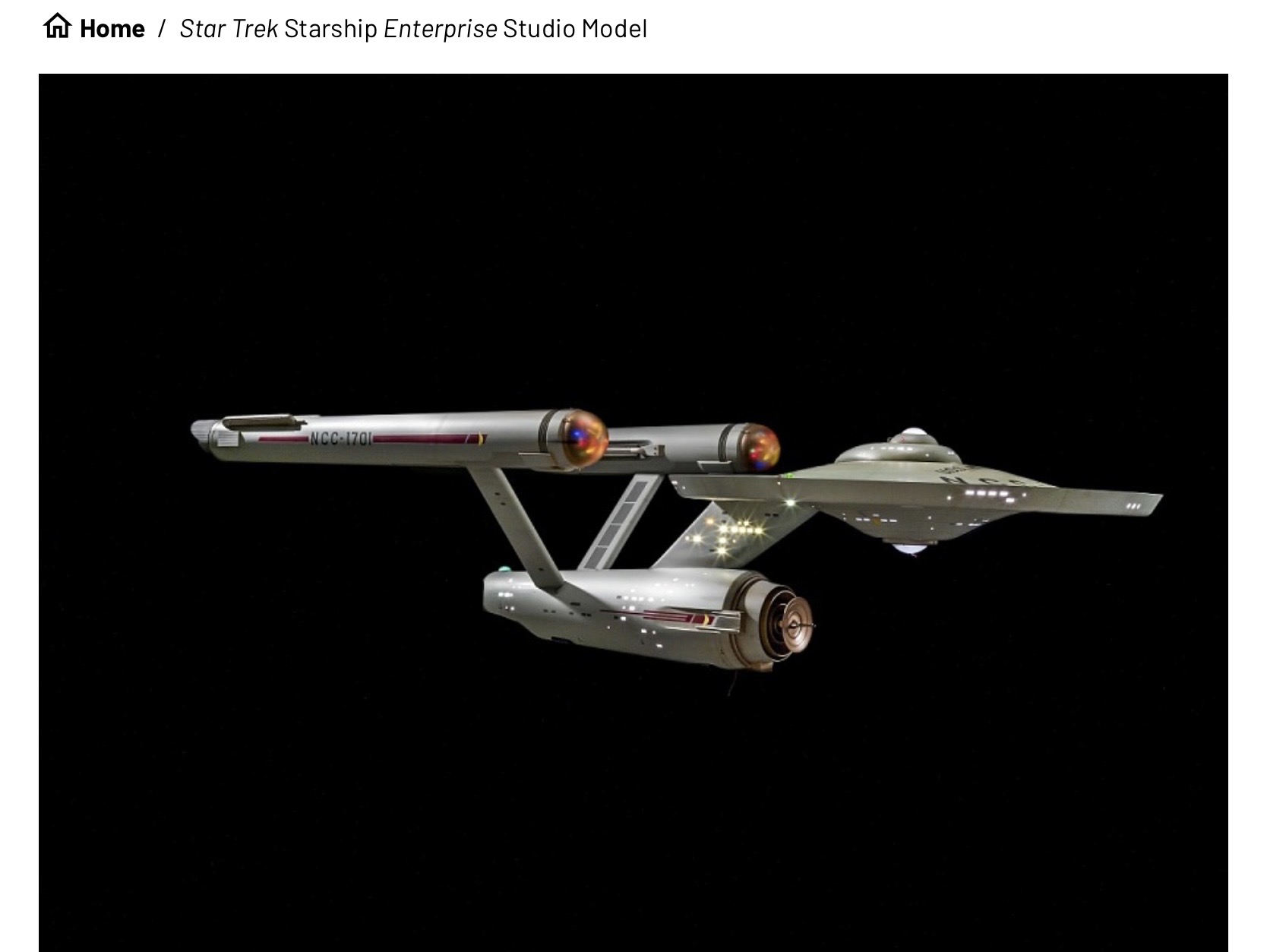

Here are some additional pics I got online:
Now I know images will vary according to monitor calibration, etc… But having watched all the original shows more than once, I recall a tad more whitish in what ive described as mixing with Vallejo. I did not spray the sample as I thought it too bubbly for some reason. Im not a AB expert or mixologist - haha - but, the number of times ive mixed paint it never settled down with bubbles which is why im asking re: mixing base metal & VMC.
Whenever I’ve watched the original tv series or looked at pictures of the Enterprise on the Net, all I’ve ever seen are mostly different shades of grey.
