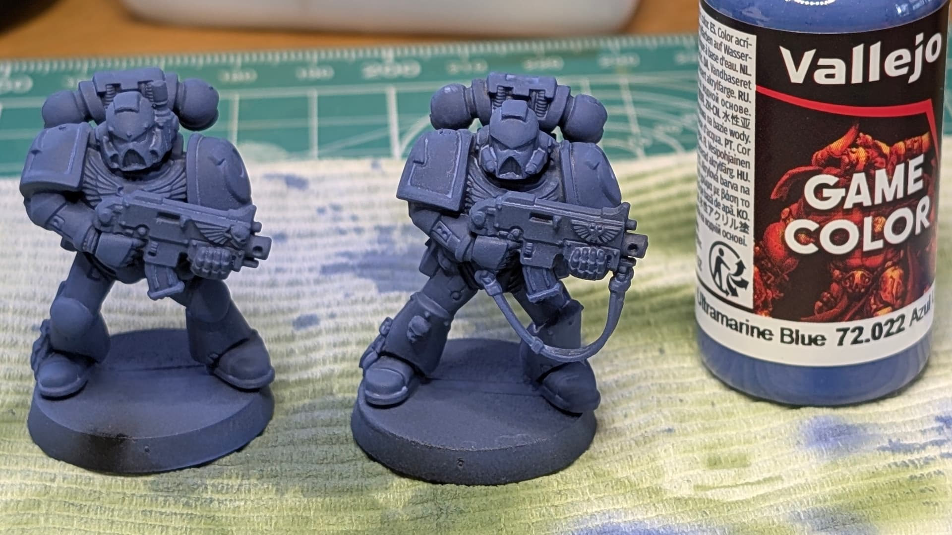

So, uh, this is a result of airbrushing Game Colour at a 2:1 Water:Paint ratio. This ratio wasn’t informed by science, just the X20A:Paint ratio at which I usually spray Tamiya. I intend to mostly hand paint these wargaming minis as a “couch hobby”, so avoiding investing in a spread of Model Air paints.
I suspect problem one was that I went too thin, resulting in the pooling, and the heavy water dilution meant the matting medium separated out causing the white marks where the paint pooled
Hoping the proprietary thinner at a more tailored ratio for airbrushing resolves the issue
Otherwise it thins well with water for normal brush work and exhibits excellent capillary behaviour when a little detergent is added for washes
Edit: Use their Glaze Medium instead of water or above a certain dilution the pigments and matting mediums separate causing the same issues I had with airbrushing with water above

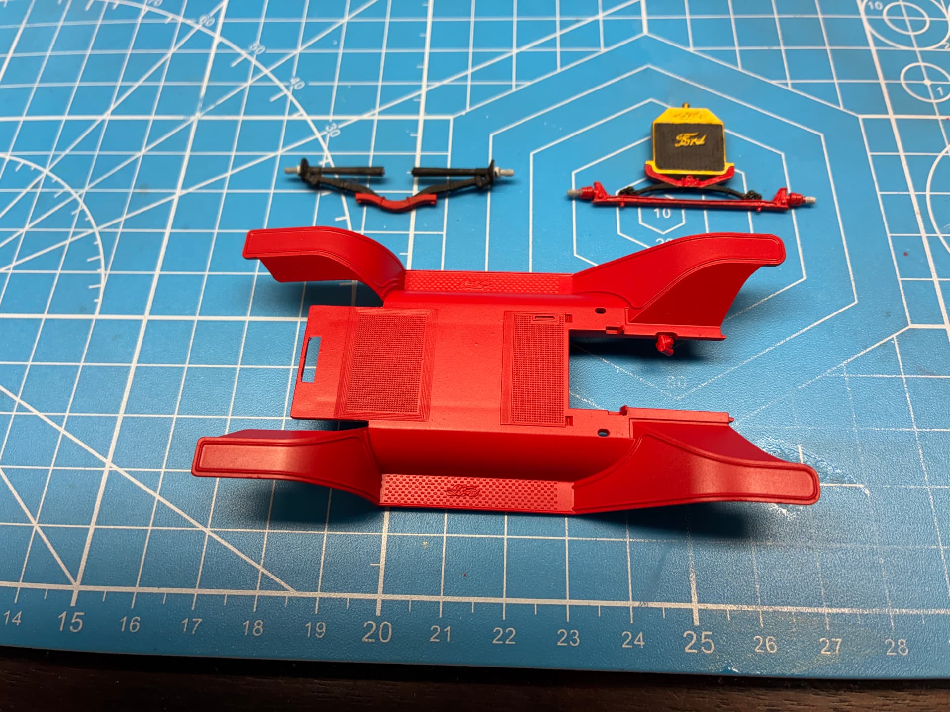

Started to build a 1/35 ICM 1914 fire truck. Mixed model color paints and Vallejo flow improver and thinner.
Chassis is airbrushed, axles are hand painted.

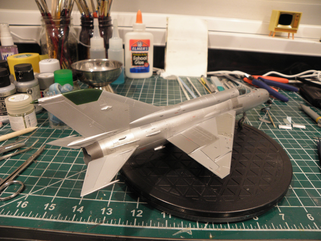

Ive been using Vallejo now about 4 years, Their metallics are really good.
Concur. Enamel metalics always dried slow. The Vallejo mettalics dry fast and can be masked (make sure the tape is not too sticky though). Use their black primer under metals. Now I don’t fear NMF
