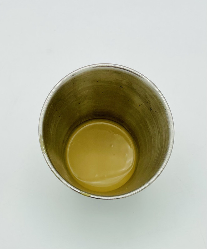

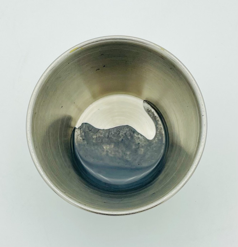

Well today I tried out a couple mix tests of Vallejo Airbrush Thinner with a couple of Acrylic brands that DO NOT work with Mr Leveling Thinner.
first up I tried Model Master Acrylic. Good results. No clumping, gumming up, or any other such mishaps.
I then tried the red headed step child of my acrylic paints, Humbrol Acrylics. Again Good Results. No clumping, gumming up, or other mishaps. There was a bit of grittiness that separated from the paint, but I also had that result with Model Master Universal Acrylic Thinner, and that combo airbrushed reasonably well.

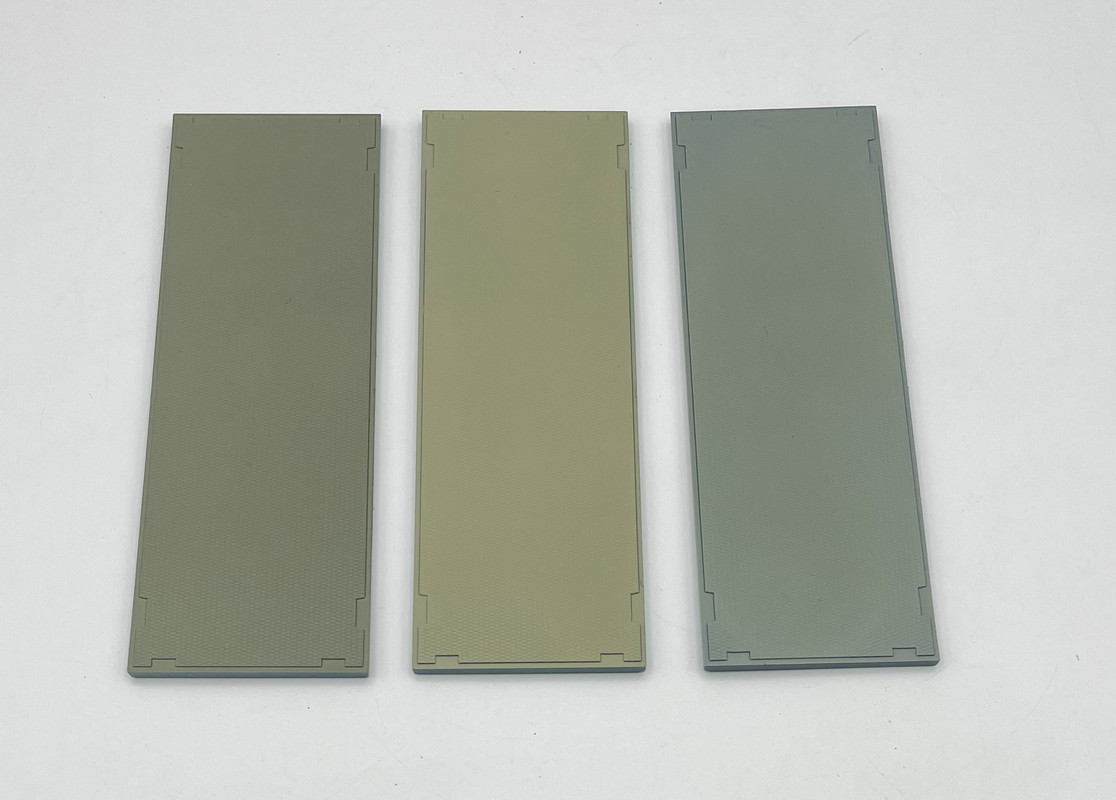

Today I did the airbrushing test of Vallejo with Model Master Acrylic Concrete, Polly Scale Old Concrete, and Humbrol Hemp(left to right)
Model Master Acrylic worked great at about a 1:1 ratio
Polly Scale had a few heavy bits come out, but otherwise was good. It’s an older bottle of mine, so it could be the age of the paint.
Humbrol I gave a slightly higher ratio of thinner to paint, roughly 4:3, and it came out beautifully with zero problems.
