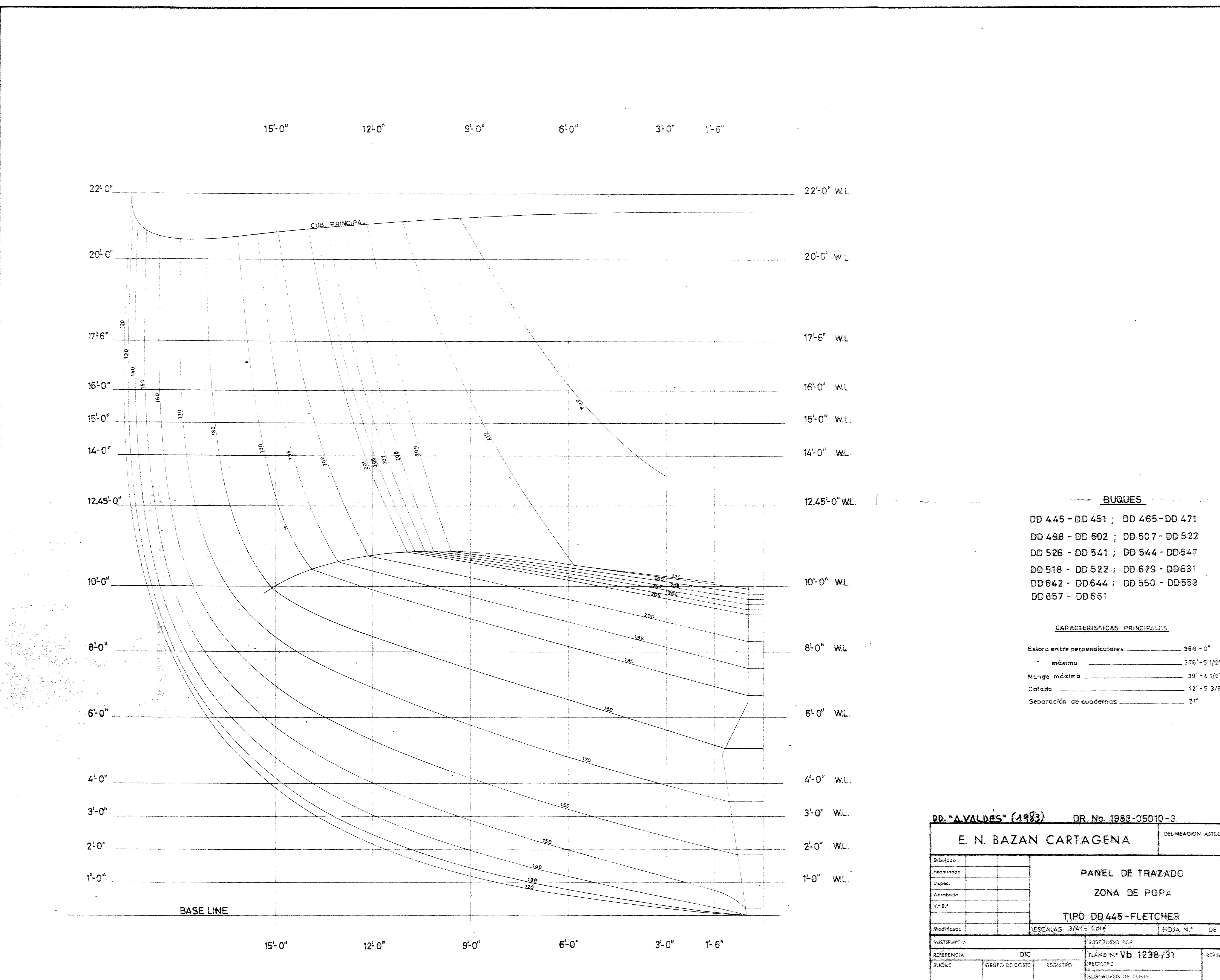

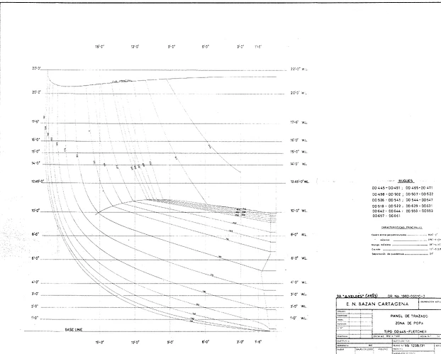

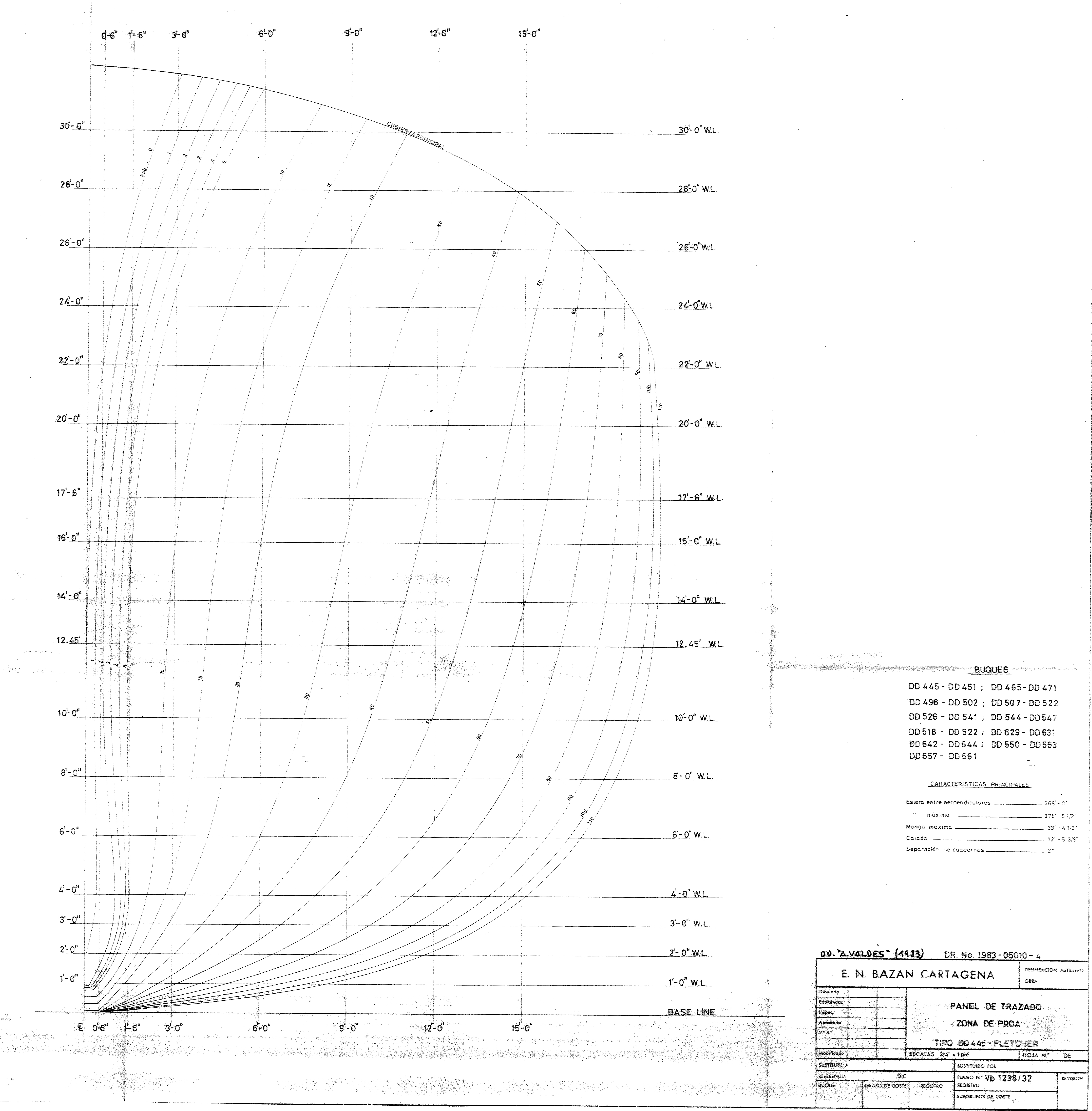

Speaking of the hull, here are some dimensions I’ve come up with to make the hull more accurate, although I haven’t verified them yet:
Forward perpindicular at the bow: add 5.0 mm.
Centerline #1 5" gun @ frame 32: add 3.0 mm.
Front edge of forward deckhouse @ frame 42: add 1.7 mm.
Front edge of weather bulkead @ frame 73: no change - control elevation.
Forward edge of aft deckhouse @ frame 137: no change - control elevation.
Centerline #5 5" gun @ frame 178: add 1.0 mm.
Aft perpendicular @ stern: add 5.0 mm.
I used the two drawings with mold lines together with an illustration I did a few years ago with the frame layout. The changes are a compromise and another modeler might have a different result. I’m building up a scrap hull to verify them.
