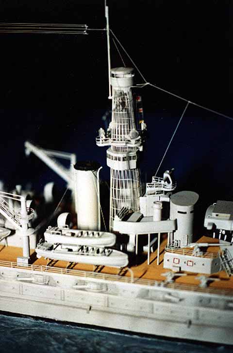

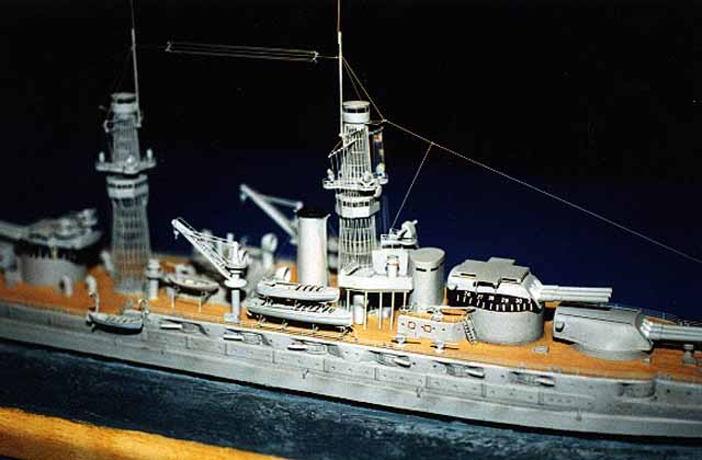

From there, with some decent reference materials, namely Paul Stilwell’s Battleship Arizona book, you can create a 1921 Arizona, or an early USS Pennsylvania. She’ll look like this:
Although this is the 1921 Tom’s Modelworks kit, I’ve done this conversion for a client and it’s not that hard if you have basic scratchbuilding skills.
