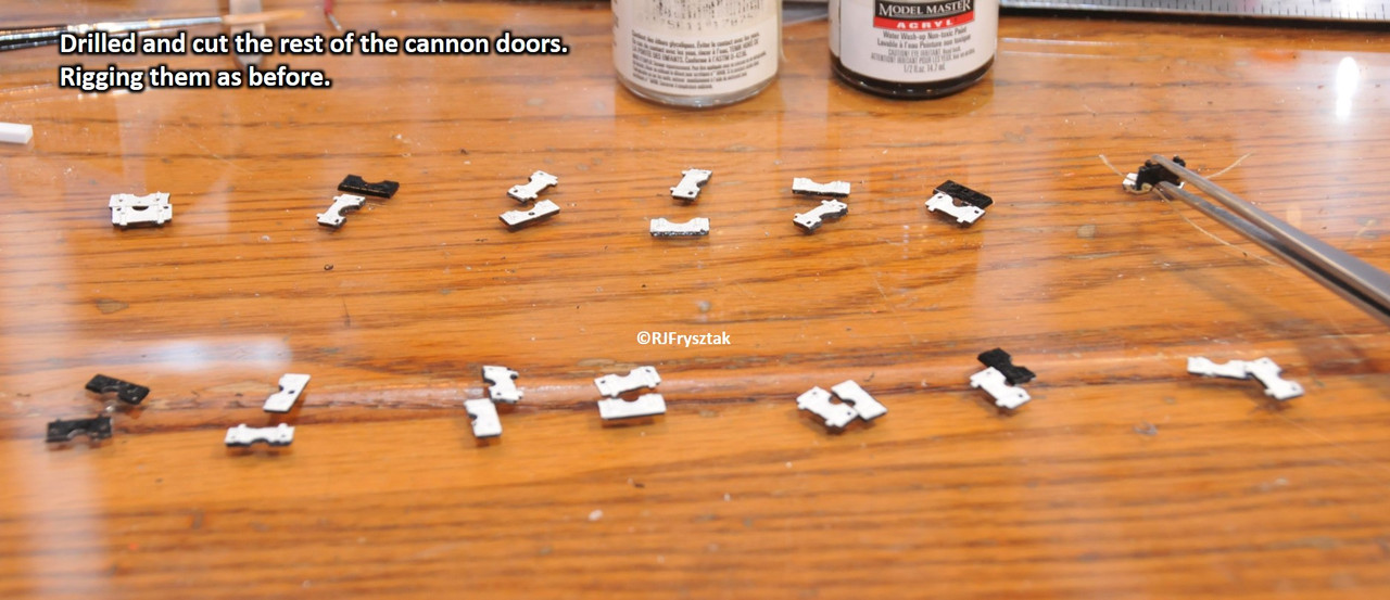

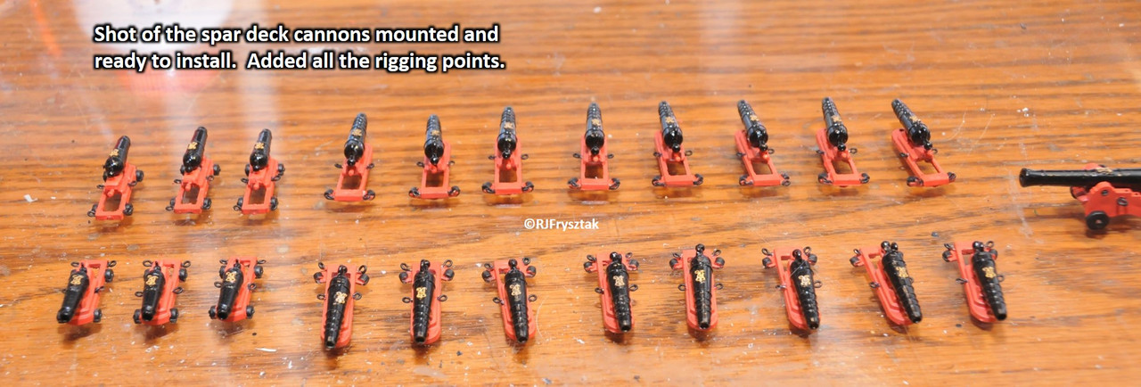

Been quite busy with work and holiday prepping, but managed to get a few small items done, such as the spar deck cannons. Started working on the port side gun deck doors as well.
spar deck guns
gun doors

Hey Bob, thanks for the greetings and may have much to be thankful for. I am way behind you in my Connie project - just trying to get the hull painted! I was wondering how you plan on mounting those guns on the painted deck so they will not break lose? Thanks for your insight, Ben

Shipwreck, I plan on stealing Gene’s idea/method of inserting a rod through the cannon stock and a small hole in the deck. Just have to watch out for the lantern lighting on the gun deck hanging from the ceiling.
