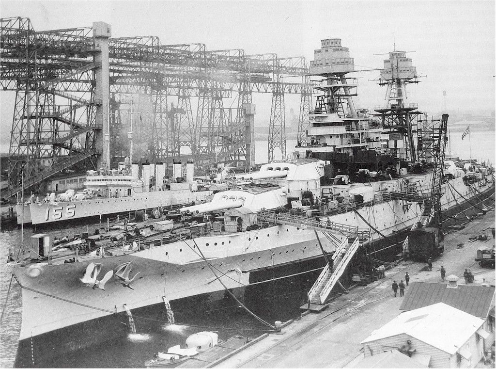

You are most welcome, as ARIZONA is kind of my thing. Now going by your intentions and not knowing your background, let me start by saying that in Navy ‘repaint’ jobs, do not forget that any potentially bare metal areas would be primed first, then painted. So, If you are doing an ‘in progress’ scenario, for places that you think would get wear and tear, if you want the primer showing it should be painted a dull pumpkin orange, as that is the color of ‘red lead primer’, which is what was used on steel back then. I would do some small spots between the new color and the old color. Also, there was some ‘construction’ happening on ARIZONA at the time, including a rebuild of the RDF shack and fire control director mounts on the superstructure and aft deck. those could all be ‘primed’ in your build. Just a thought.
As an example, this photo is from the1929-31 major overhaul. all of the dark areas are actually areas that are just primed with red lead.
