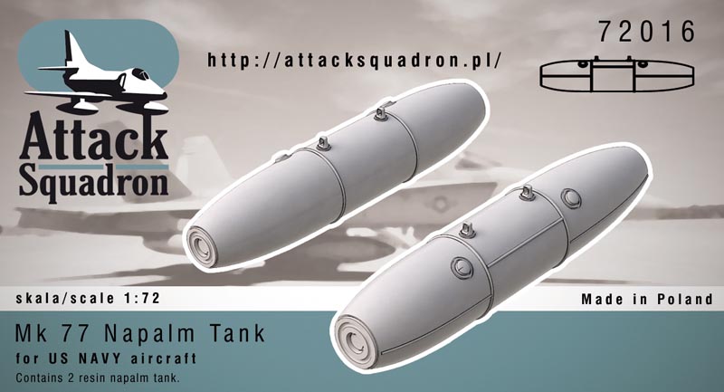

Napalm comes in the weapons kit I got, but it’s the wrong one. It comes with the finned BLU-27, from what I’ve read, the Marines didn’t use the finned ones in the late 60s. If I’m wrong, I’m wrong and I’ll accept it, though.

Best napalm bombs for a Marine Scooter would probably be these:
Mk.77 Nape

Here’s a VMA-311 Skyhawk at Chu Lai hotpad, All 4 wing stations have Mk. 77 napalm canisters and the centerline station has BRU-41 MER loaded with Mk. 82 Snakeyes: http://a4skyhawk.info/sites/default/files/images-a4-unknown/a4-vma311_19.jpg
Note that even though this is a different squadron, this would not have been an uncommon loadout for the unit you’re doing. VMA-223 was at Chu Lai around that same time and would have flown the same types of missions as 311 did.
