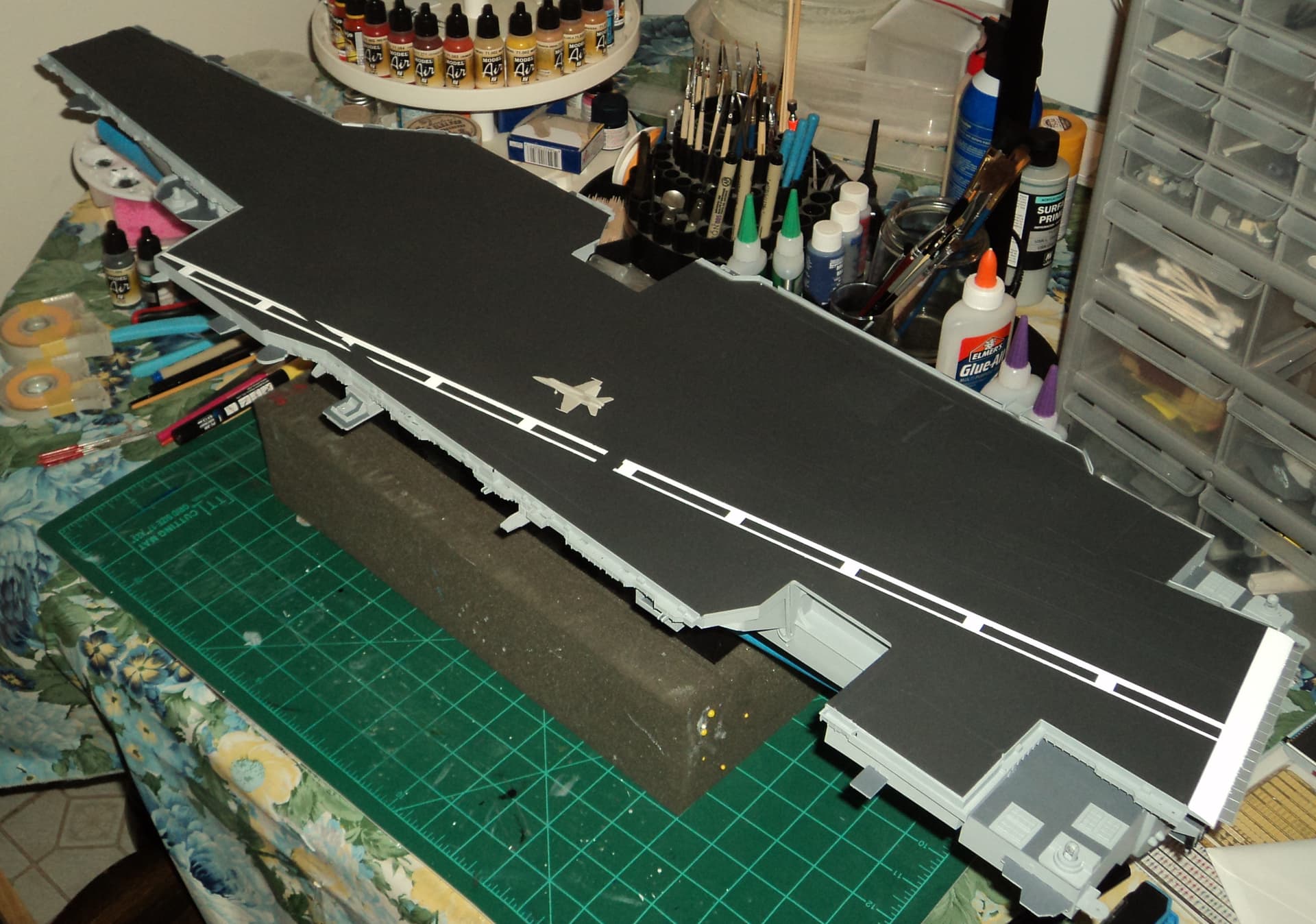

Has anyone used paint markers to paint the larger white and yellow flight deck lines on aircraft carrier models?
Or anything else like the black boot waterline stripe or other details?
If so, how good or bad did that work out for you?
And if you did use paint markers, what brands or types (Oil based or Acrylic) would be good to use or not use? What works best?
Sample pic:

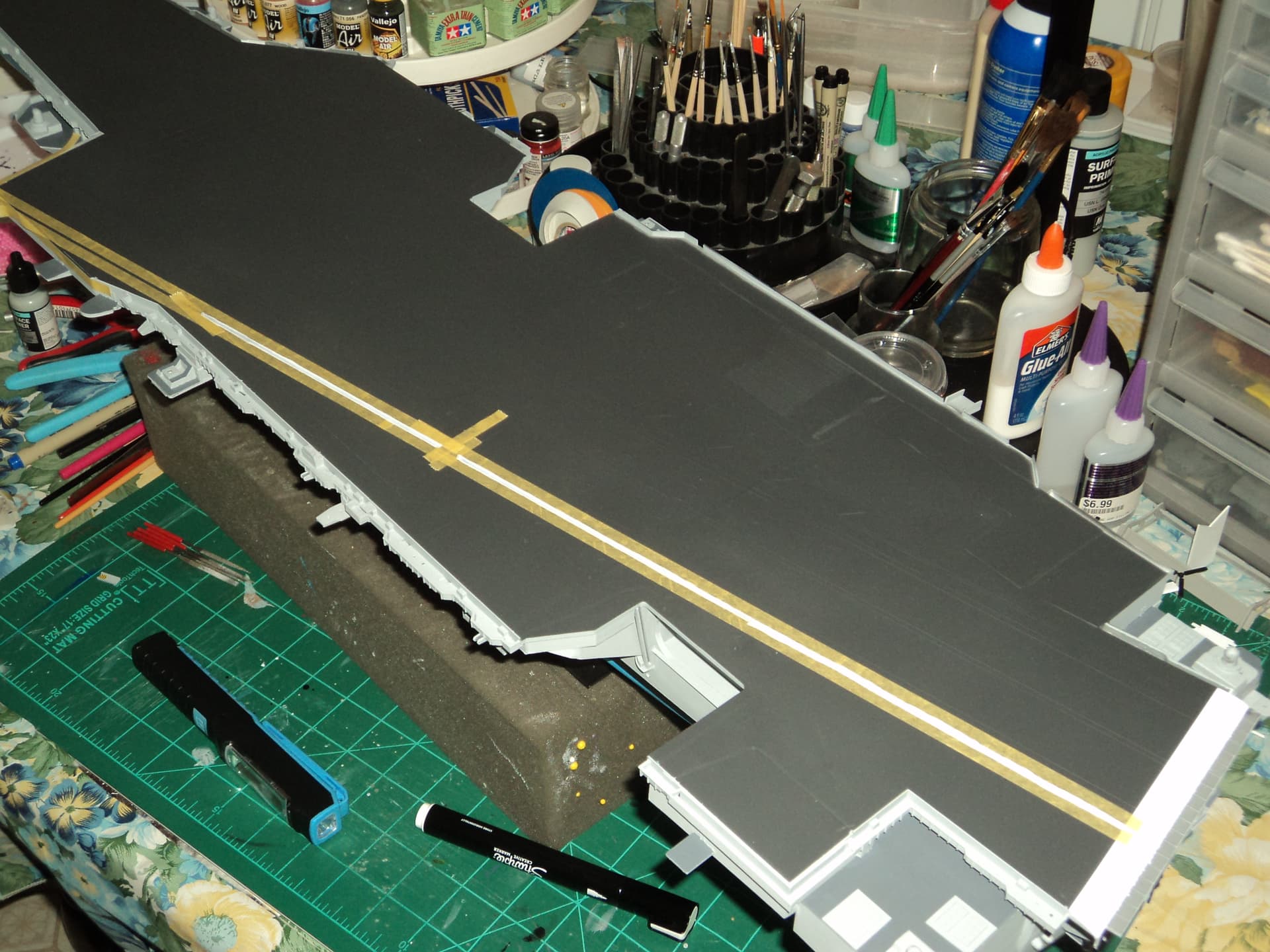

I tried a paint marker on the white deck lines on the Doolittle raid USS Hornet and it went very poorly. Running perpendicular to the ridges on the deck made masking a but impossible. Does anyone know of an after market maker of decals for things like this. 3 attempts with no success makes me want to drop this kit.

A few months ago, I used Sharpie Creative brand acrylic paint markers for coloring the white and yellow flight deck landing lines on my carrier. They worked pretty good, but I had to make multiple passes when “drawing” the lines cause one coat of the paint wasn’t enough.

Proper masking is important. I only use TAMIYA yellow masking tape.
