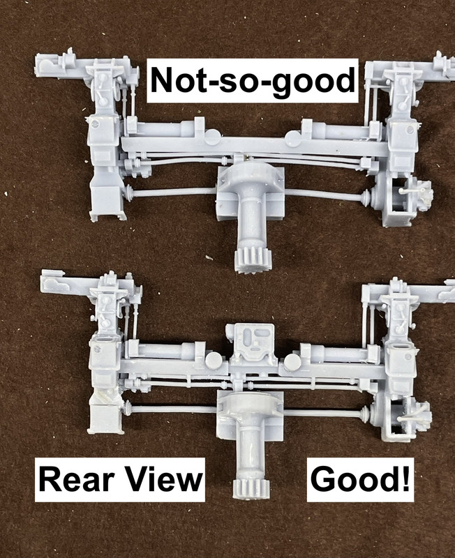

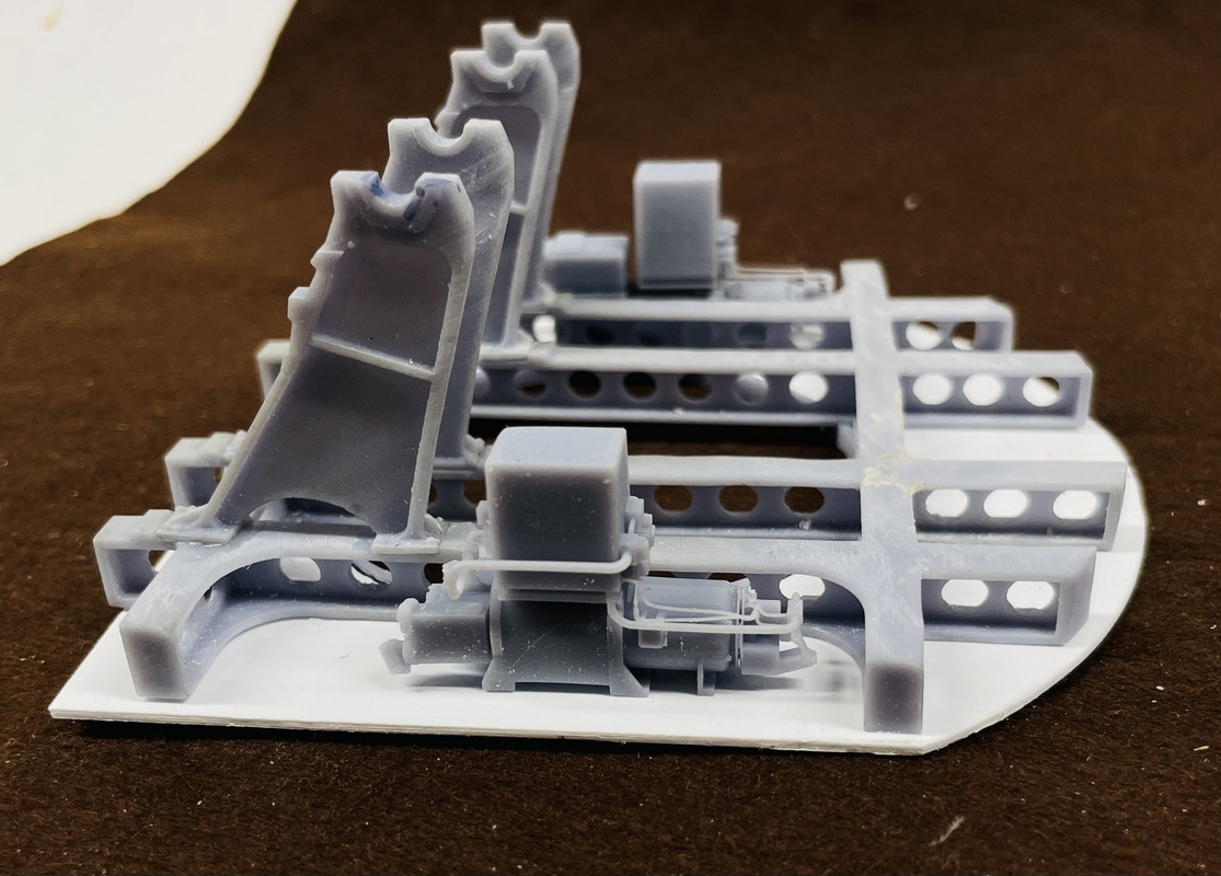

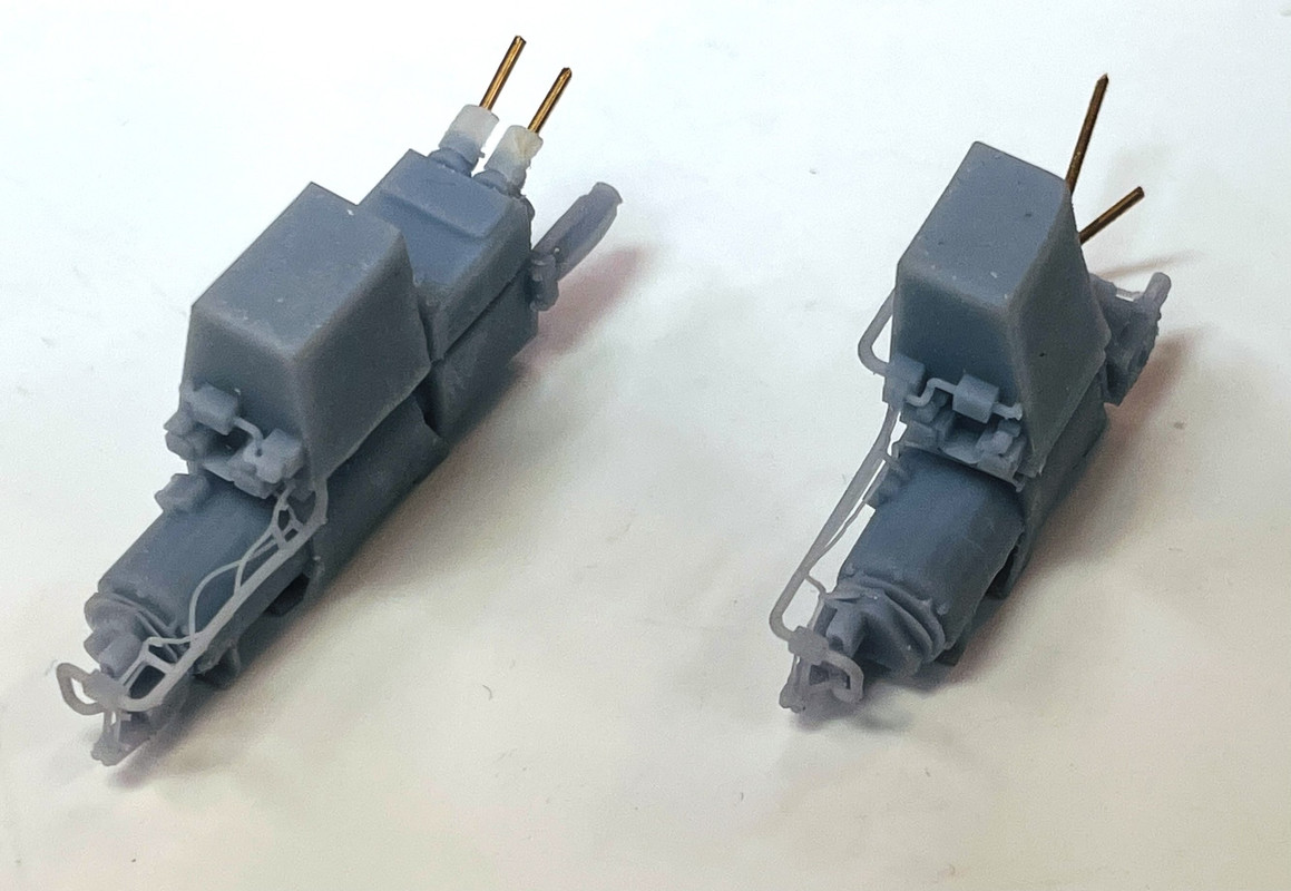

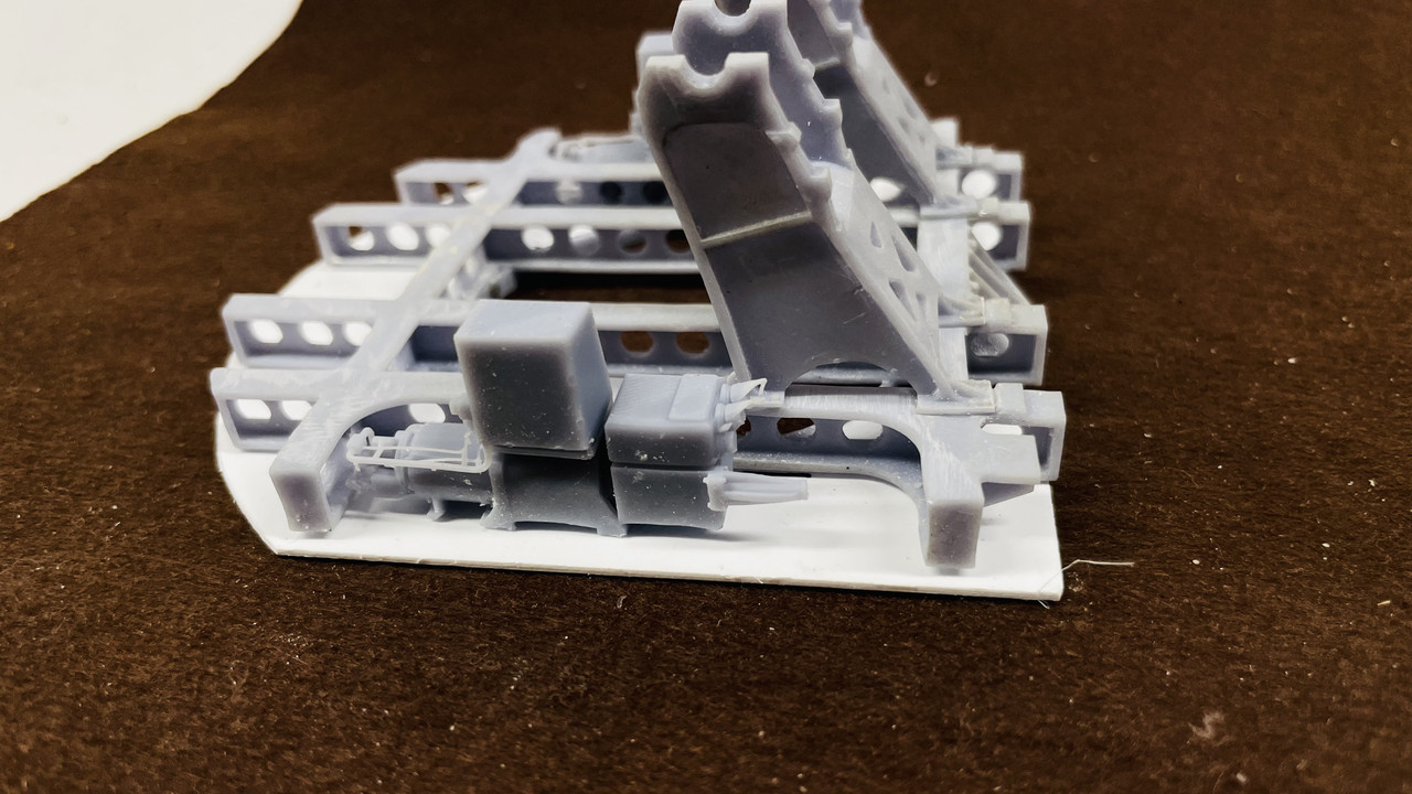

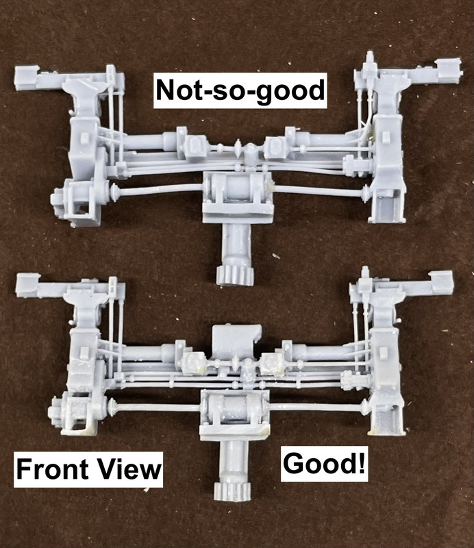

My first prints of the elevation and training pump systems was okay, but a couple of details didn’t form and it bugged me. Here’s the first attempt.
You probably can’t find the errors, but I know they were there. I tried them on to see how they looked sitting in the framing. And they looked swell.
When I went back and evaluated the support scheme, I found that I misplaced the tiny support on the upper side of the detail, not the bottom-facing apex. This caused the detail to not form correctly until the build reached where the support was. This is support skills 101: the support goes at the bottom-most point what would start to form and create an island. There’s a moving line in the slicer that helps you identify this contact point. In this case, I missed it a bit.
When I repositioned the errant supports I got a really nice print. I also moved some supports or made them smaller where they were difficult to remove without damaging the model.
Those piping details are very, very fine. The phos-bronze wire is showing where the links are going to connect to the regulating pedestal. They will not be this long. I pre-“drilled” the holes in the drawing so I could easily open them up with a 0.032" drill.
The new setting is amazing. It’s like learning to 3D print all over again. I’m also reprinting the foot rungs since the new setting will make a truer and stronger part, plus a less warped base that I’m using as a drill jig.

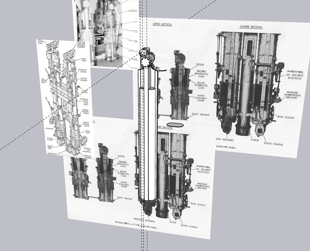

I’m now working on another complex unit, the projectile hoist. There are two of them, but they are not mirrored. They extend over two decks since they start in the Ready Service Room (RSR) before the gun house, pass through the center and end up in the gun house. I’m creating them this way. There are some structural steel cross-braces that support them. They do not go to the RSR’s floor. They hang above it and the whole deal rotates with the turret. Unlike the big guns where the entire deck rotates to keep the hoist aligned with their respective guns, in the smaller 5" application, the hoist rotates, but the RSR is stationary.
It’s very complicated to created curves on already curved surfaces in SU. You can’t do the simple push-pull extrude operation because that only works when the two sides are parallel. To cut a curve into another curve, you have to created a negatively-shaped “cutter” and use it with an extension called BoolTools2, to remove the interferece area and create the shaped surface. You can also do this directly in SU with “Intersect Faces”, but you have a lot of clean up work since it gives you the cutting line, but leaves an open space that you must hand draw all the interconnecting lines to create a closed solid.

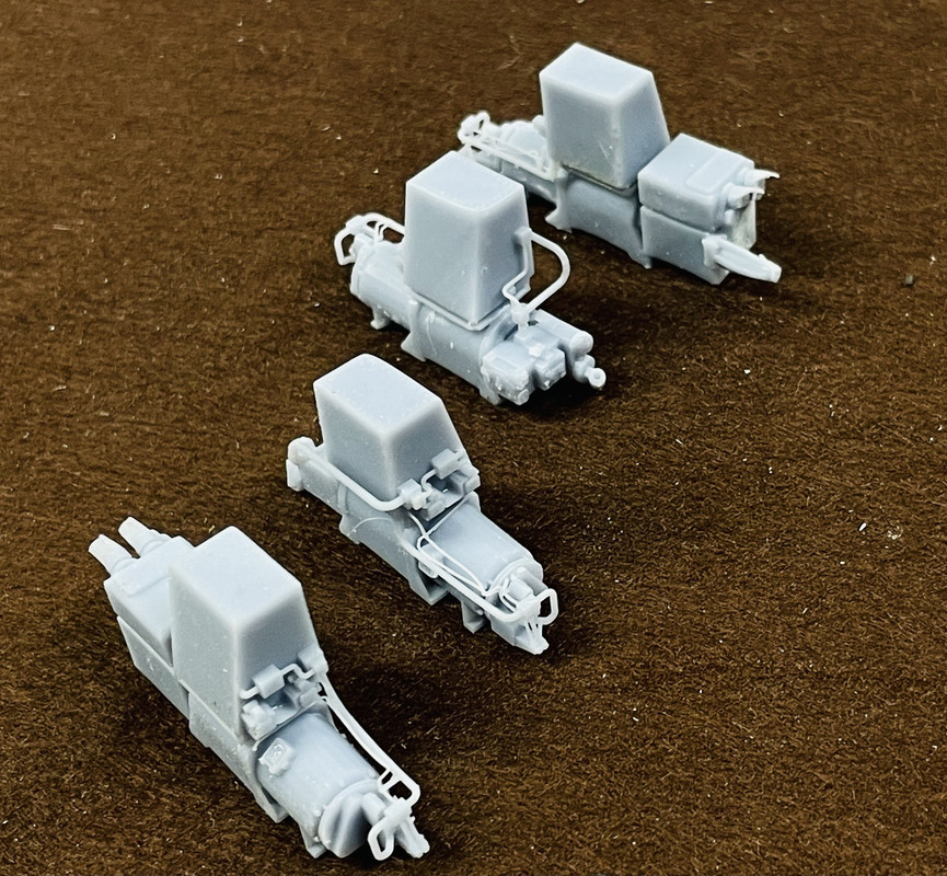

It printed nicely. I also printed the opposite hand versions of the optics shields so I can pick either open or closed on both sides of the gun shield. And I printed some scale 5" projectiles. I’m going to need a bunch of these since they’ll appear in the gun, the hoist the ready service room and the magazine.

First, a screen print off of SketchUp: The tiny thing you see in the red square is the exact same object 100X smaller. That’s actually real-world size. I’m drawing the object 100X enlarged to prevent any “small curve segments” that SU runs into. The entire drawing is saved as a component. Anything I add or modify on the big version duplicates instantly on the 1:1 version. I use the 1:1 version in the master drawing of the entire model, and it’s the one that’s exported to the scaled drawing where I reduce it again, by .021 to make it 1:48 scale for the printing and the actual model. By using it as a component I don’t have to copy and scale it every time I want to use the 1:1 drawing. it’s always there and up-to-date. It’s so tiny that it’s easy to lose it, so I put it on that big red square so I can easily find it.

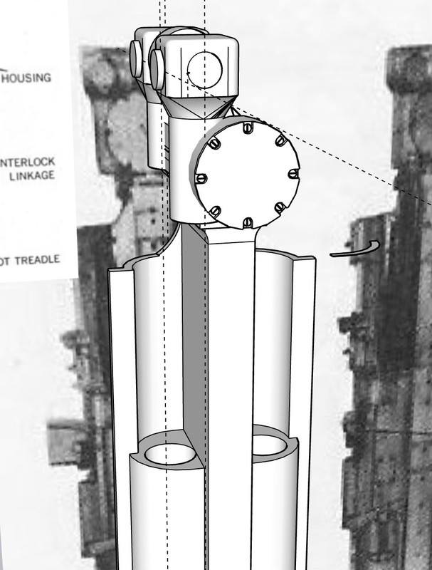

It took over a week to draw the projectile hoist. It’s complex, ambiguous in parts, had penetrations and curve cuts that needed shape cutting, and finally, required some major rework to get it as right as I can.
The rework was this.
This central core had gotten so messed up with multiple diameter layered in on each other which created voids, reversed faces, and other anomalies that I couldn’t get a decent solid image on the slicer in my tests. I finally bit the bullet and stopped screwing around with it and redrew it from scratch. This time it was perfect. All the discontinuities that plagued me were now gone.

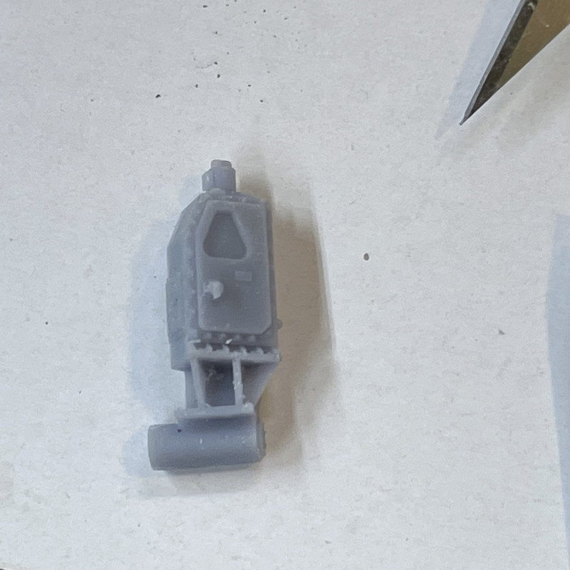

I was able to get good parts for the projectile hoist after three tries. The first, for some reason, came out 20% over-sized. Something occurred when I made the scaling in the slicer. I don’t think it was loading the wrong factor (2.08%), but rather was my entry. I may have double-clutched and got an erroneous value.
It was a shame. It was a pretty nice part.
The powder hoist portion was decent, but the control links were too fine being close to scale size. I doubled their thickness, and also increased the floor thickness by 2X to increase its stability and make the diamond plate texture more pronounced.
The 2nd projectile print, while correctly sized, needed a lot of repair. I broke one of my cardinal rules: Scale thickness doesn’t always translate well in the 3D printed 1:48 world. I made the columns prototypically hollow with the twin bores extending full length. The resulting wall thickness was so thin that it ruptured all over the place. It was actually translucent. I attempted to rebuild them with Bondic, and while structurally stronger, looked awful.

The sight setter’s seat came out better than expected. The support post is delicate, but the new 3.1 second printer settings are producing small details that have some strength. I post-cured these last two batches BEFORE cutting off the supports to impart more strength to withstand the support removal. It worked well.
This little bit of floor has to key into the flanking gun mounts. I needed to find out if I could install it after the sighting system part was installed. Luckily, it could be.
This was the test.
I now had another decision facing me. Do I paint the sight system before installation or after. I put it together now. It required a lot of pushing and shoving to get it all aligned during the tests, and I even broke one of the cross-rods. This led me to believe that I would really mess up the paint job in the process. I bit the bullet and permanently glued it in now and will wrestle with the painting going forward. What I can’t reach with paint won’t be visible anyway—or so I’m assuming.
For some reason—probably some warpage—the trainer’s regulator console didn’t sit down on the frame. Rather than continue to forve it, I made a shim. Again, no one will notice this when painted and enclosed in the gun shield.
Right now I’m about designing the cartridge chutes. I have good orthographic line drawings, but they don’t show the contours. I don’t believe these sheet metal contrivances are rectangular in cross-section. I’ll do the best I can, and then, after New Years ask Ryan for some pictures of its true shape.
