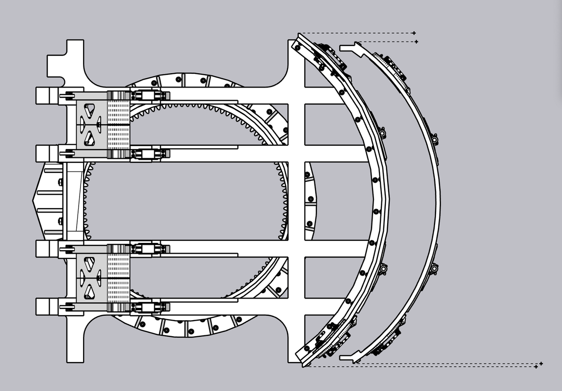

5IP Main Drawing
5IP Main Drawing1920×839 92.3 KB

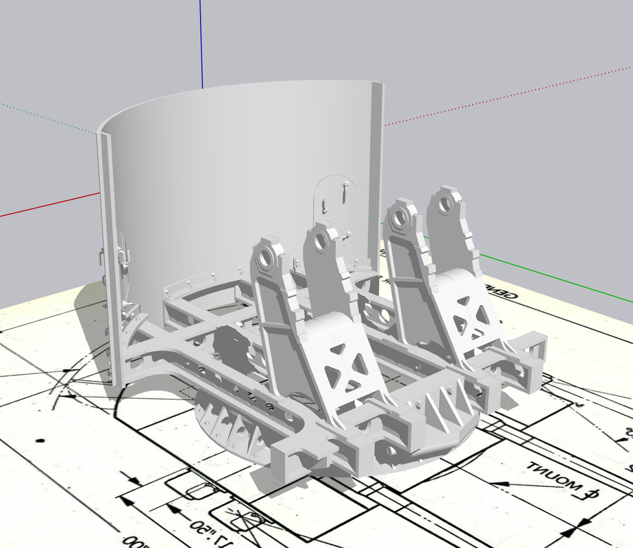

I’ve already done too much desiging the subframe that supports the two pairs of gun mounts. For example: Just looking at the box art I see that the training buffer (device to stop rotation before the turret hits something it shouldn’t) is already attached to the exterior of the turret. I don’t see that detail like that on the battleship turrets. So I have to do more research. While the guns were essentially the same in all of its applications, there were slight differences. I’m doing the battleship version. Another example is the base ring. I can tell already that the box art is not a battlehsip application.
While my drawings show pretty good renditions of the floor plans of the turret, I have no idea how this relates to the Takom model. My main reason for doing the drawing was to ensure that my 3D printer could produce it in a single part. I just fits.
This is the subframe.
Screenshot 2023-07-16 at 6.58.12 PM
Screenshot 2023-07-16 at 6.58.12 PM1644×884 53.9 KB

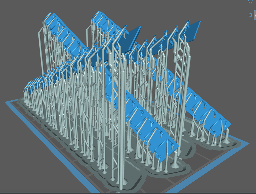

And he it is tentatively put on the 3D printer slice (ChiTuBox). I am not printing this! I don’t know if it’s correct or not until I get the model. My LHS has ordered another kit since he sold his last one.
Here’s the test piece on the slicer. The red areas are out of the print range, but are just small parts of the raft that won’t matter. That said, every other angle to which I rotate the object puts some part of the actual part out of the print range. So it JUST FITS. Convenient!

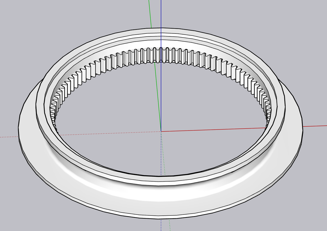

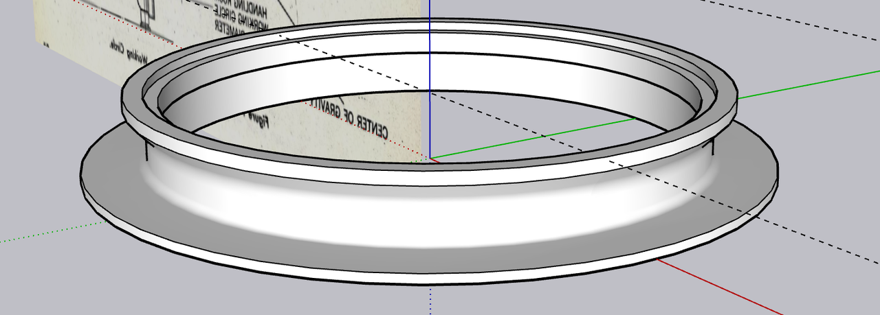

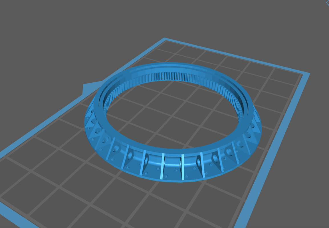

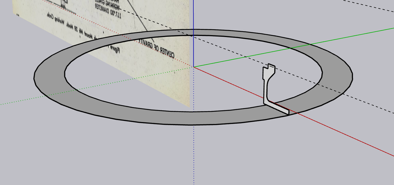

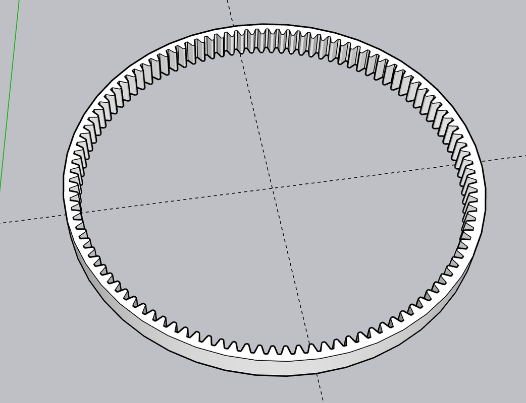

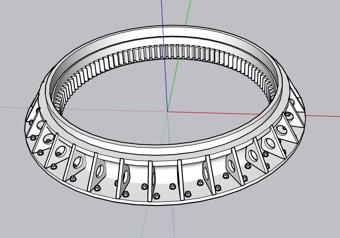

I have actual diameter measures of the base ring and training gear so I chose to start here. I also have a section drawing across the ring which I scaled. I placed the profile on a ring that corresponded to the base’s overall shape.
Using the “FOLLOW ME” tool (select the ring, select FOLLOW ME and then select the profile) and the program magically lathes the profile around the circumference. The counterbore and the land represent the lateral and tapered roller bearings on which the rotating mass revolves. I’m not going to detail the bearing. Unlike the monsters in the big gun, these would be almost indistinguishable in 1:48.
I learned how to do internal ring gears in building the big gun, but I’ll quickly review it. I have an add-in to make volute gears. You enter the number of teeth, the pressure angle, and the pitch circle radius and Voila!, it draws a gear as a separate item. It only draws external pinion gears, not internal ring gears. I was able to find the exact number of teeth and the pitch circle diameter of the Mark 28’s, and with those numbers drew the external gear. I also had the outside diameter of the gear which was the inside diameter of the bottom counterbore. I centered the external gear over a filled circle of the outer diameter and INTERSECTED the faces. I now had a drawing of a filled circle with line drawing of the internal teeth inscribed on it. I delected the inside, and then PUSH-PULLED the remainder to the height of the full gear as shown on my scaled cutaway drawings. All in all it took as long to do it as to write this paragraph.
I inserted the completed gear into the base ring.

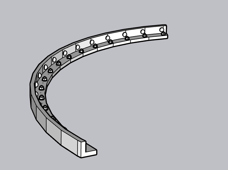

The last things to do was add the reinforcing ribs and the nut/bolt/washer N/B/W images on the ring flange. I made one rib based on profile drawings and counted the number on the prototype. Looked like there we 32 of them. In SU, you use the rotation tool, with the center placed in the ring’s center. You move/copy a single rib 11.2 degrees corresponding to the gap between them, and then key *31, the program copies the rest equally around the ring. It’s “31” not “32” because you’ve already copied one.
I did the same thing with the N/B/Ws making a set of two and copying them around the ring.

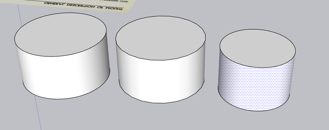

Because the geometry is so regular and one dimensional, I am going to attmpt print the entire part directly on the build plate. It will all depend on the build plate’s ability to hold onto the part during the formation of the base perimeter layers which have the greatest amount of surface area. I those layers stay put, the rest of the print will be no problem. I will only take about 20 minutes to print, so I won’t have long to wait.
If I was printing this part in 1/35 instead of 1/48, it would not fit this way and would have to tilted. Without tilting, there are no supports to deal with and details come out perfectly.

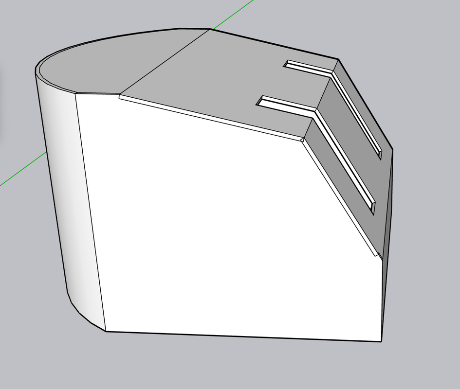

With accurate overall gun house enclosure dimensions and wall thicknesses, I was able to adjust my frame drawing so it was exact. If I was using the kit, I would have to wait until I could meassure it directly before finalizing the frame. I also had the exact diameter of the ring that connects the rotating to the fixed structure and attached it to the frame. I moved the training buffer inboard of the frame extremis to conform to the Mark 28 configuration.
Again, in 1:48, this fits the printer nicely and will be a single part. This ensures perfect alignment of this important structure.

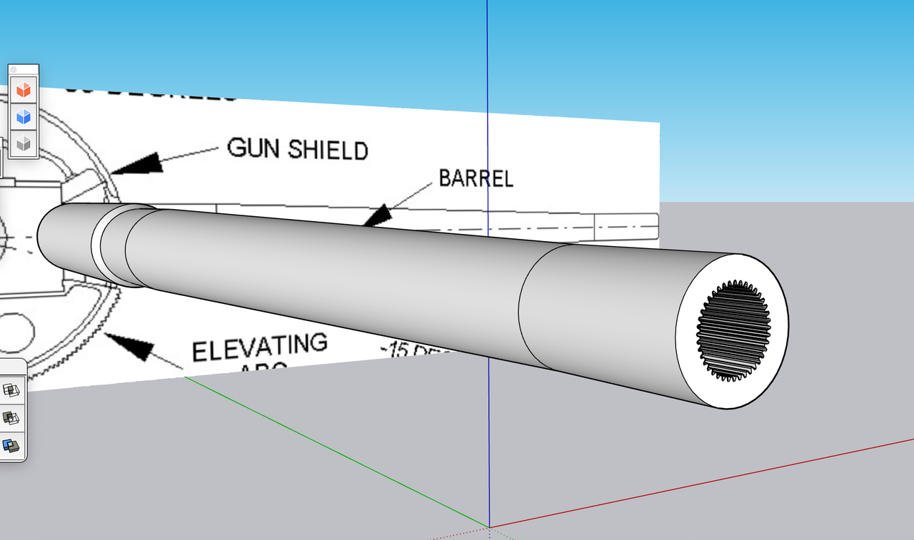

Last part I detailed was another critical one; the guns. I had good profile drawings so I was able to create the correct straight and tapered portions. I added some rifling. There are 40 lands, but did not add any twist. You’re only going to visualize the very outer edges of it. The outer lip of the muzzle is rounded. I will do this as a post-print operation.
I’m trying two print schemes: Directly on the build plate and raised off. Since it’s so symetrical, it can be printed straight up with no overhangs or islands. While it should print directly, I’m thinking that raising it will facilitate liquid resin draining from the bore.
We’ll see which one wins. Unlike the ring gear which had little height, the guns will take over 6 hours to print. In LCD resin printing height is the key varialble in print time.

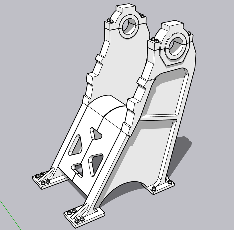

I found excellent elevation views of the all-important gun mount castings and will tackle them next. Also found good information about the complicated projectile hoists.

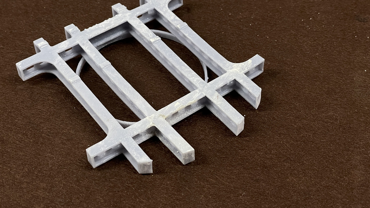

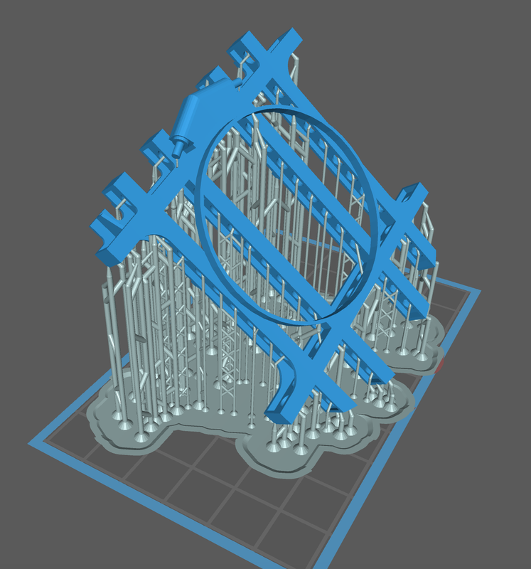

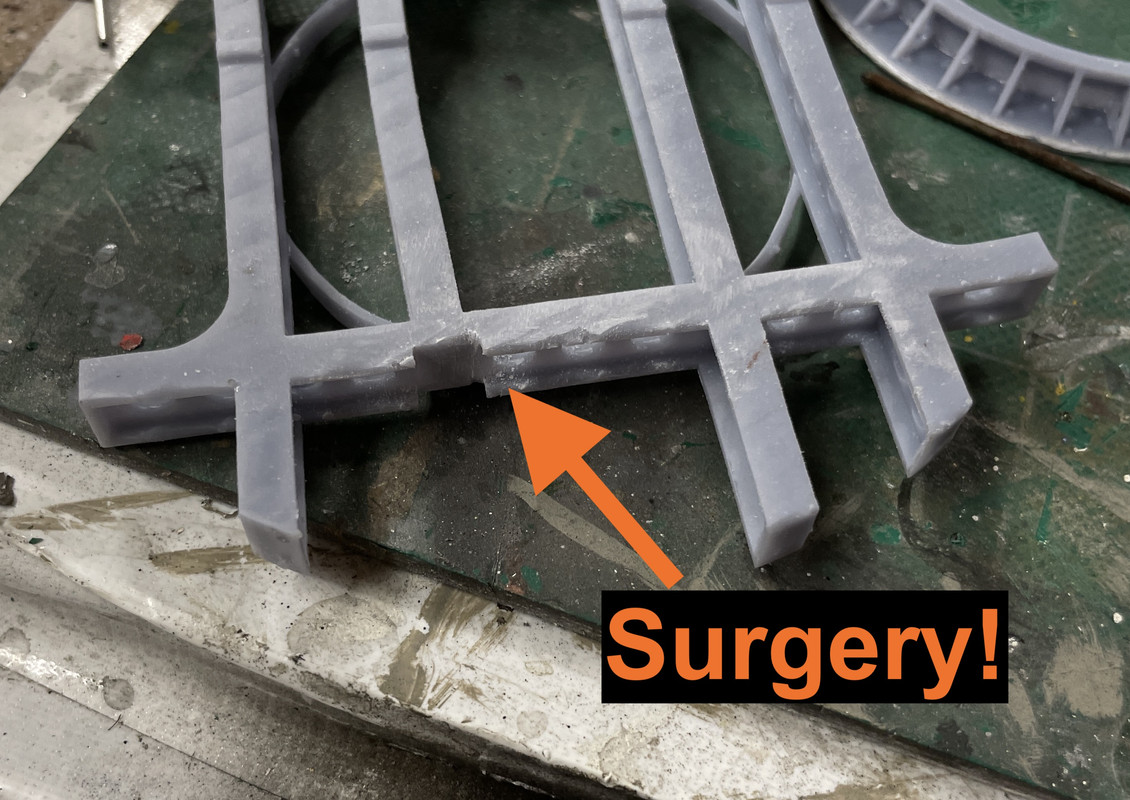

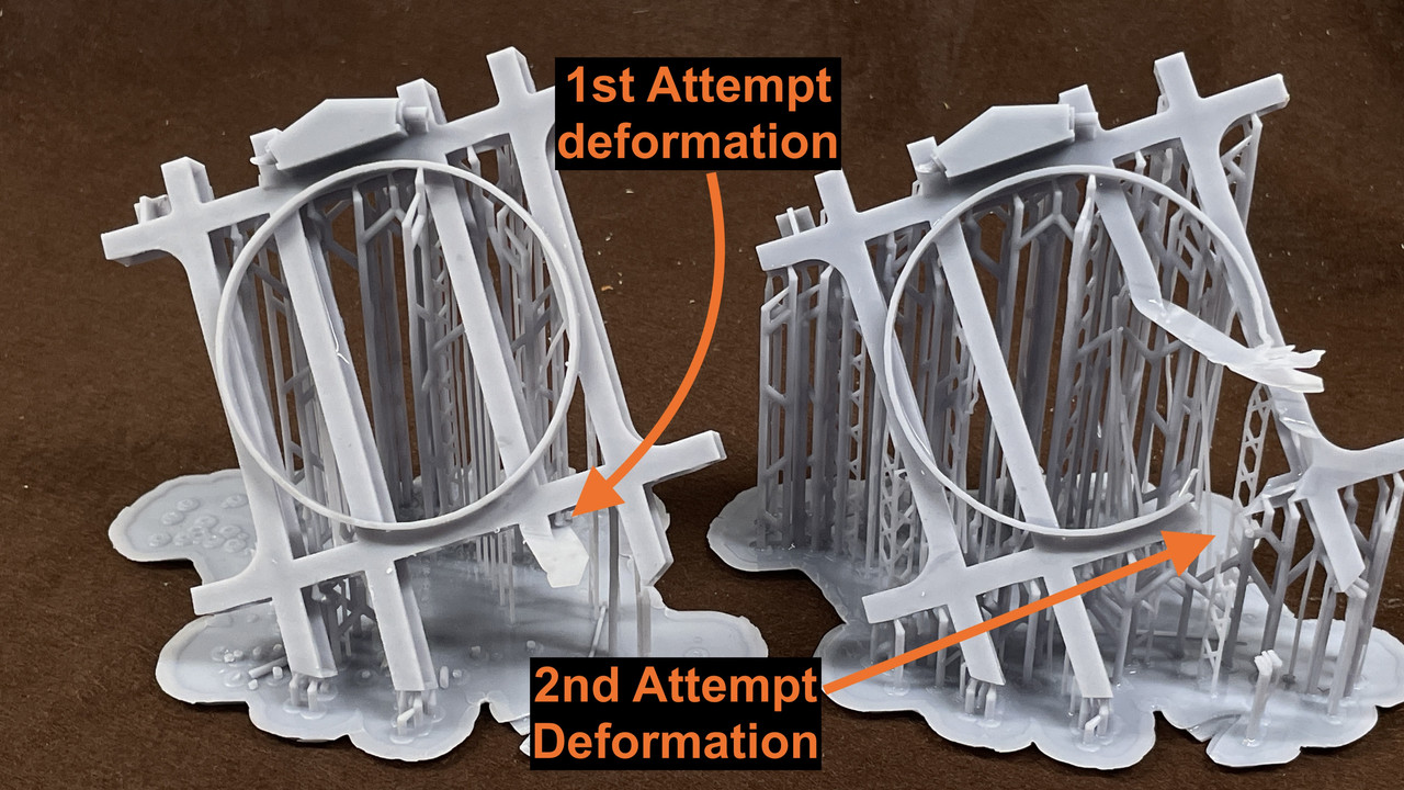

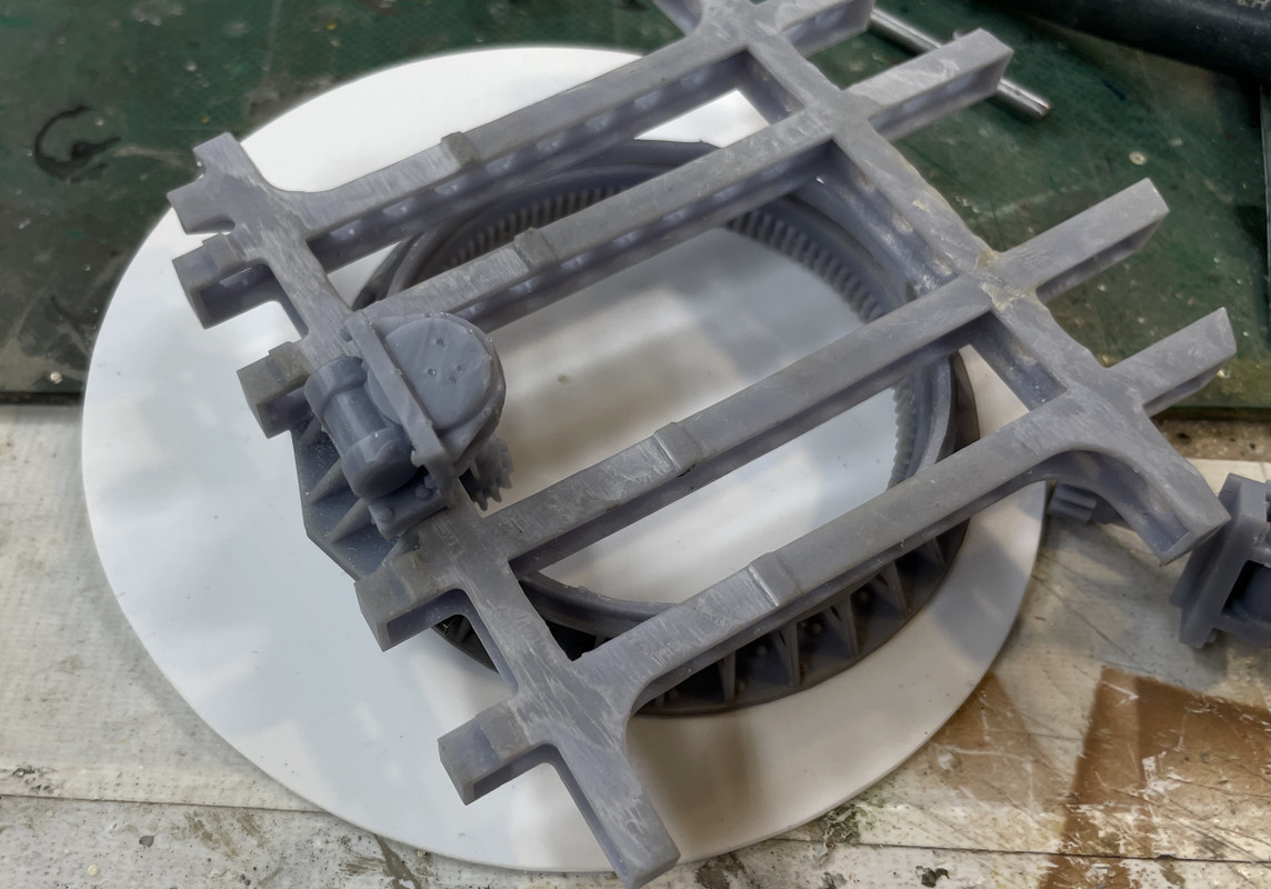

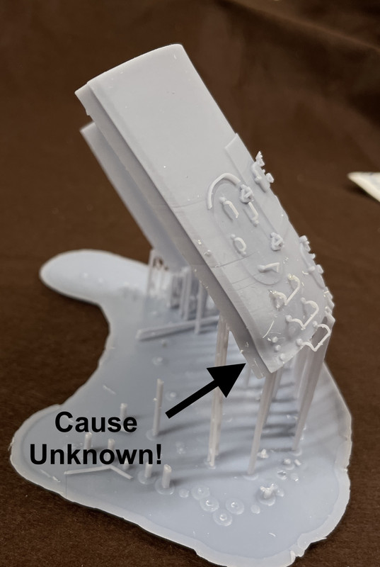

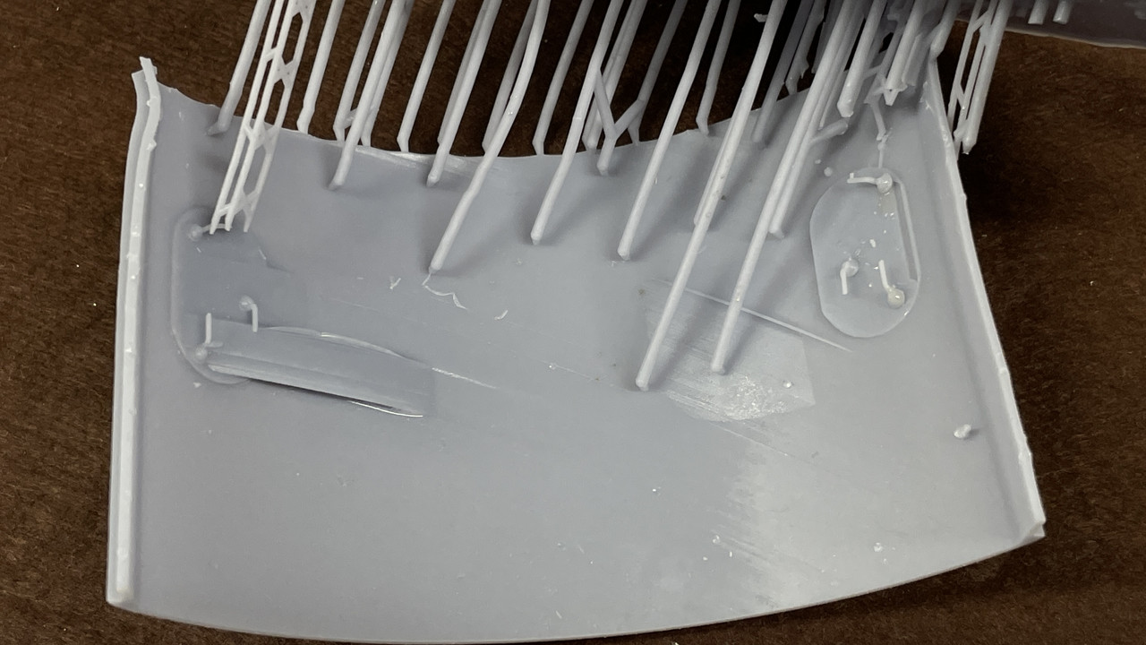

I’ve started producing parts with varying success. My first part was the base ring printed flat on the build plate. For some reason, the training gear teeth started to form and then just stopped. A few layers were laid down nice and parallel, but then nothing. I also had some slight delamination. The delamination I could fix, but the gear teeth would be a bit trickier. I could print the gear separately flat on the plate and insert it. Meanwhile, I’ve set it up at an angle and will try again before going with the separate gear approach.

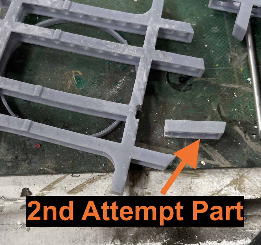

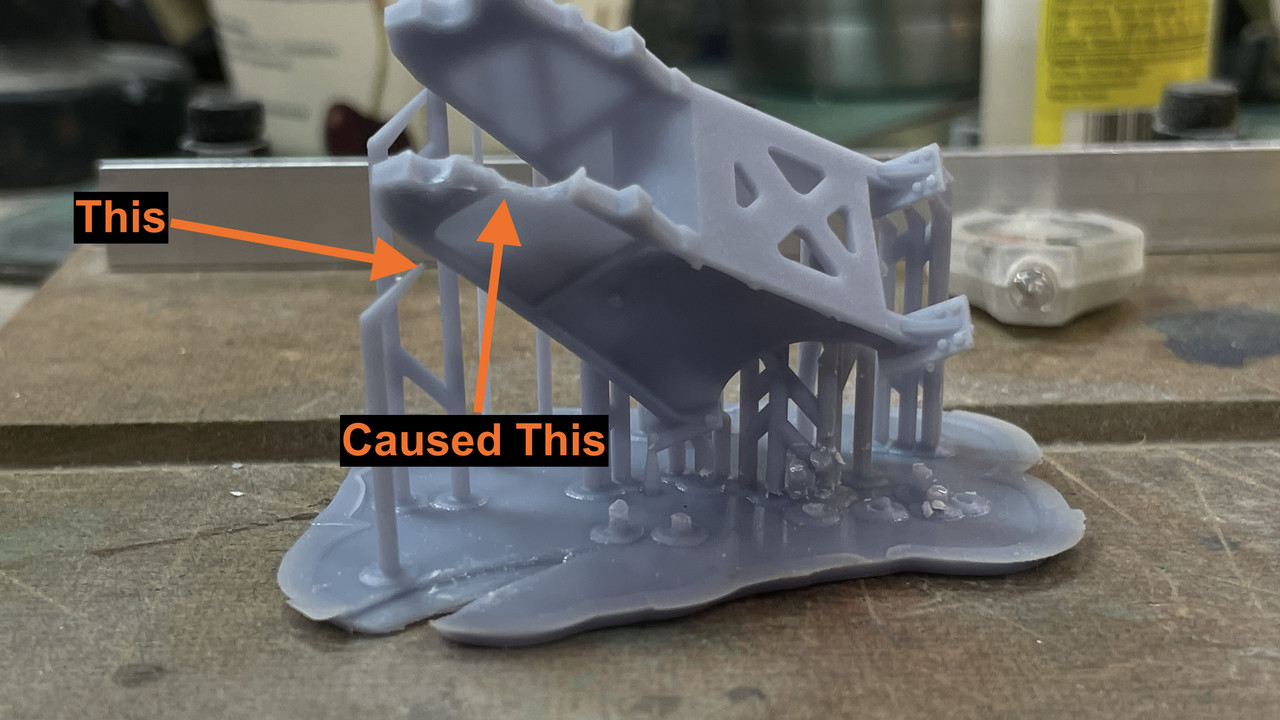

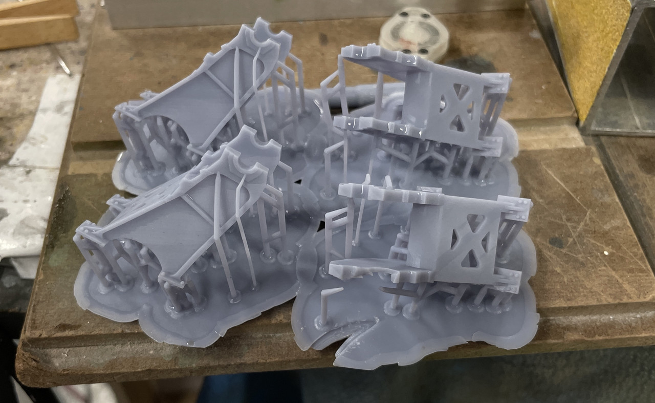

Next print was the main frame. Strangely, one set of supports failed causing one of the frame’s lower extensions to fail. I changed the supports in the slicer and tried again. Here’s attempt #1 compared to attempt #2 which was clearly worse.

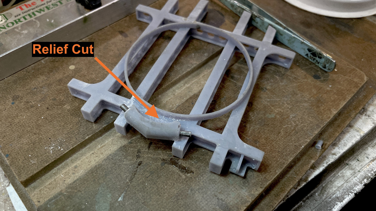

There’s a silver lining. The arm extensions are mirror images of each other. By surgically removing the bad arm from #1, I was able to graft the good arm from #2. With some thick CA followed by Bondic UV resin, the graft is invisible and strong. The Bondic is the same chemistry as the UV printing resin and when applied to UV parts welds them. Only caveat is the UV curing light must be able to reach the Bondic so it can be used on blind glue joints. Otherwise, it’s essential in your UV printing tool box. It cures in seconds!
Here’s the removal of the bad arm.
Here’s the part ready for the graft. I broke apart #2 to better expose the arm for amputation. I then trimmed the end properly in a miter box with razor saw so the end was square.
I used the CA to stabilize the part (with accelerator) and then used the Bondic to fill all the gaps.
And after sanding, the part, when painted will show no evidence of being “Frankensteined”… Just made a new verb.
Here are the remains of #2. It served well and saved me a bunch of resin. Resin is not cheap, about $40 a liter. I never throw away rejects and have used them many times to provide repair pieces. I’m creating two boxes… “good parts” and “bad parts”. Often it’s about 3:1 bad to good. 3D printing is an art with a scientific underpinning. I thought I had figured out the failure mode on #2, but the results were worse. The failure still started in the same region some something was going on there. Since I now have a good part, I’m not going to worry about it any longer.

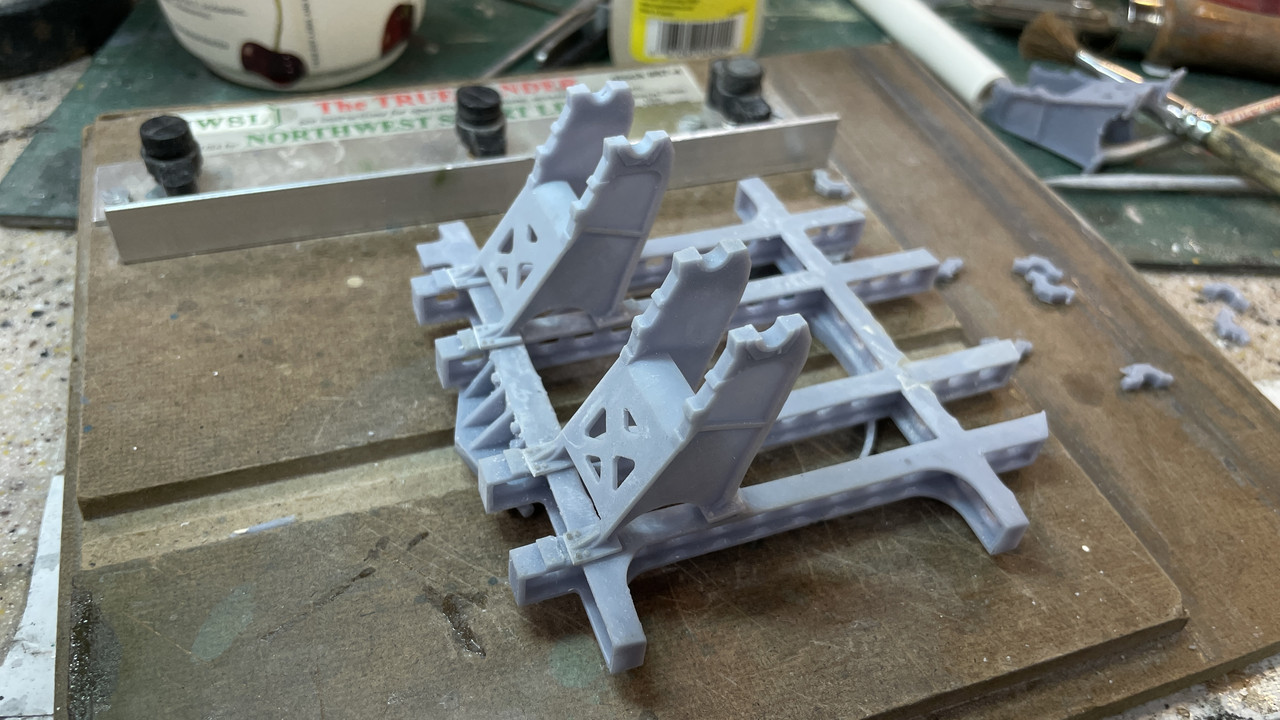

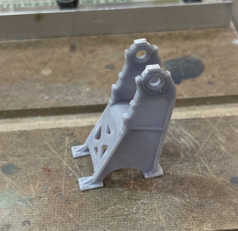

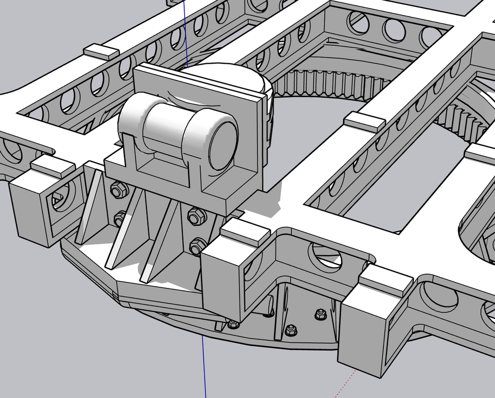

I almost have the gun mounts ready for printing. I drew them over my profile drawing. My first attempt had the cross bracing in the front on the wrong end. I was able to fix it without too much difficulty.
The guns are printing successfully with both setups building straight down.

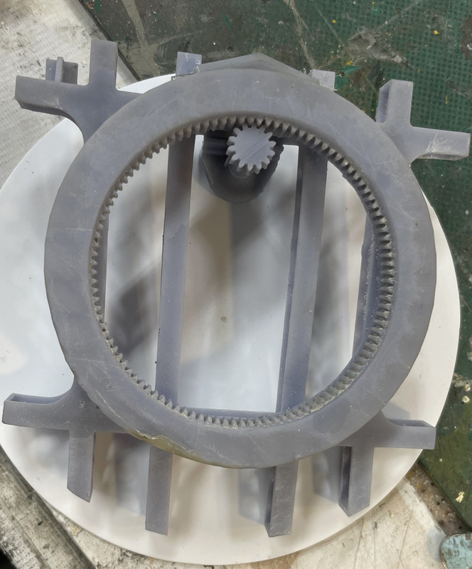

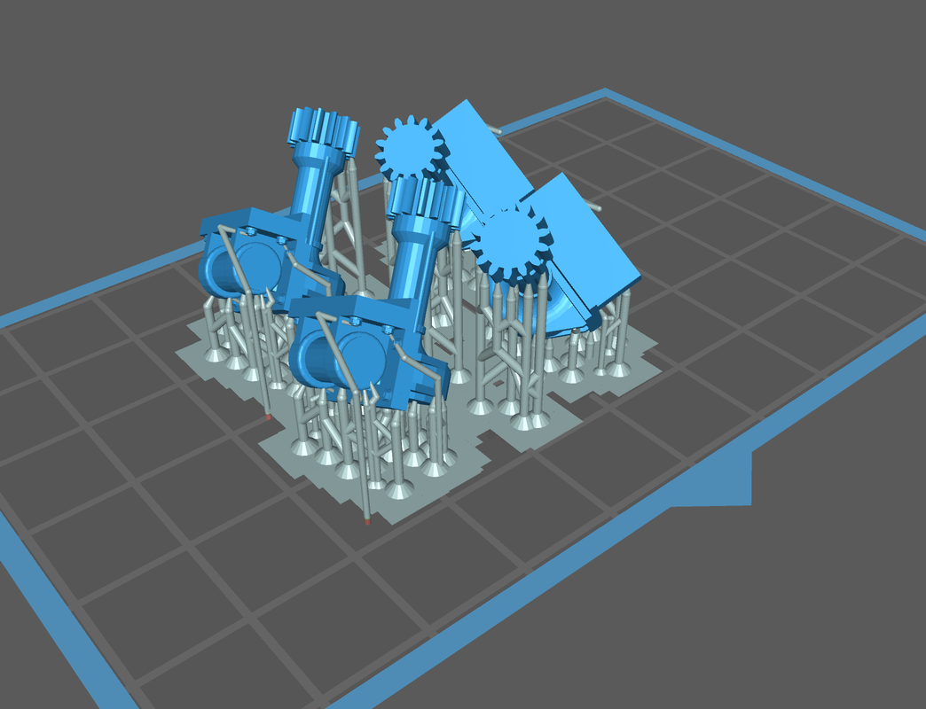

I redid the ring gear for printing and drew the training worm and pinion. I ended up making the gear with 14 teeth and a pitch radius of 8". It meshed well. Nothing is going to have to move and everything is printed as a solid obect.
Here are the finished drawings of the engine mounts. I saw that there were bolts holding them down so I added those and added bolts to the Trunnion Caps (being printed as a separate item so so the guns can be installed. The bosses jutting out from the side are where all the sighting gear is attached
I did have sufficient drawing to build the training worm and pinion with reasonable fidelity. The worm is driven by a drive shaft from the hydraulics. Manual drive is selected through a series of clutches, but still enters the worm via the same shaft. I’m probably going to use metal shafting for all of them… and there are a ton.
Front view:
And reverse view:
Here’s how the training gearing is going on the printer. As usual, I never print just one. It cost about 20 cents worth of resin for each one and it doesn’t add any printing time. If this was a filament additive machine, the more parts you have up on the machine the slower it is since it must draw each line like a plotter, versus the resin machines that expose an entire layer at once, like a laser printer. I group them close together to facilitate popping them off my flexible build plate.

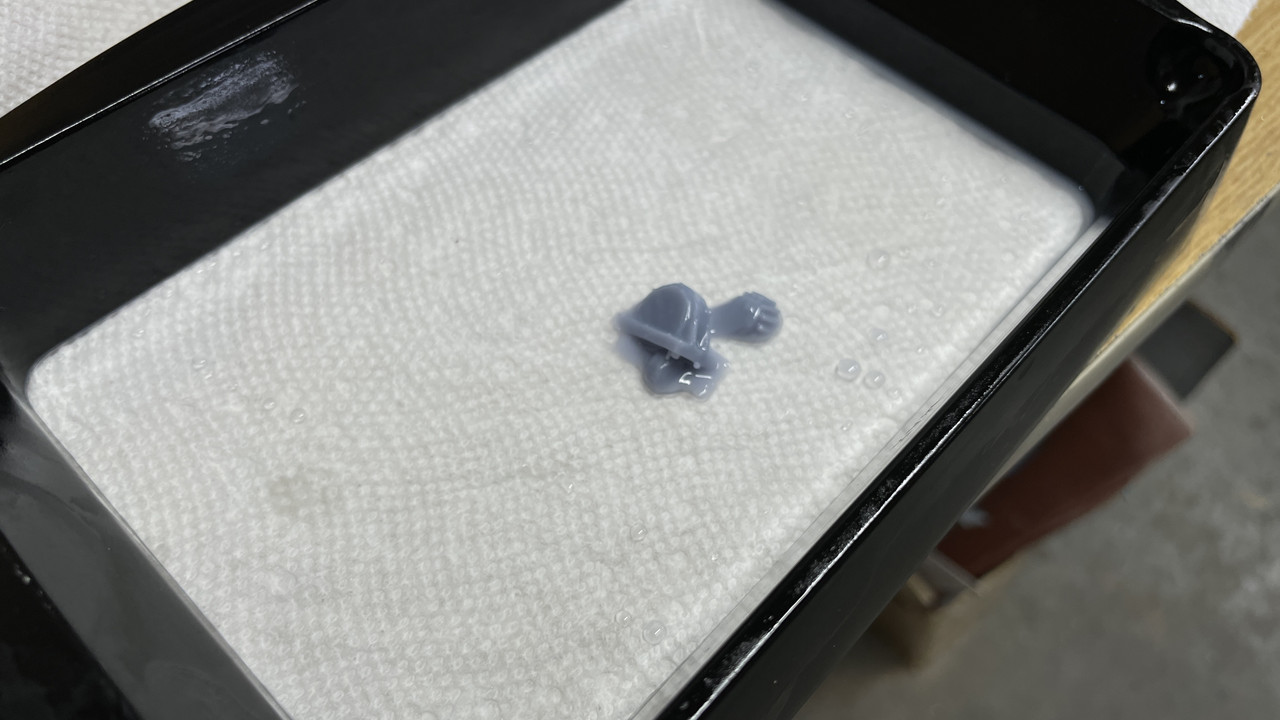

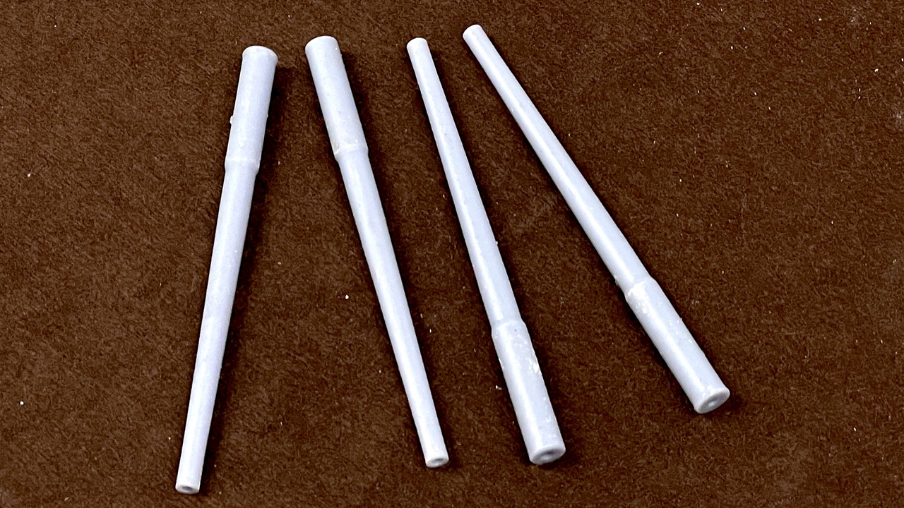

Guns just came off printer. I was correct. The resin didn’t drain well from the one that was printed directly on the plate and the bore is narrower at the plate end due to “elephant footing”. Elephant footing is the phenomenom created when the part widens at the first five base layers. These are generally exposed at 1 minute instead of 2.5 seconds. The long exposure is used to create the “raft” that holds the model to the build plate. You really want this layer fully hardened so it sticks well. When you put a part directly on the plate, that 1 minute exposuse/layer causes those five layers to widen also. They become wider because the long exposure leaks from the pixels that are to be illuminated to neighboring ones.
The gun with the support’s bores are parallel throughout the print. They’re in the Ultrasonic cleaner now. I will take pictures as I clean them up. I just put the modified base on the printer. It will be done around 10 p.m. Nice thing about printing… I generally like to print overnight so it’s working when I’m sleeping. Unlike string printing where you have to keep an eye on a clogged nozzle, with resin printing, when the part is right and mounted right, and the printer is lined out, it will work without any attention.
From my cursory inspection the guns show no imperfections and should look great.

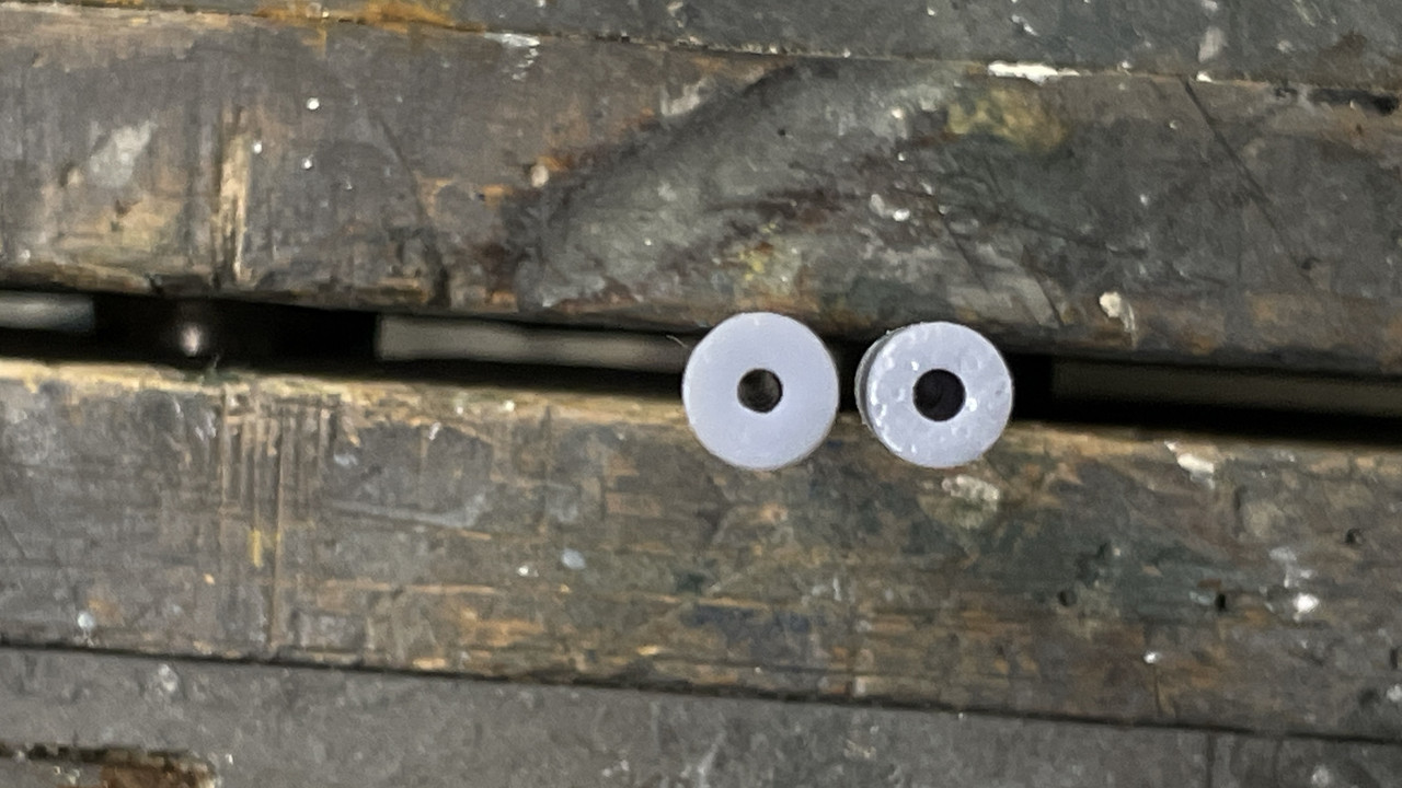

After cleaning you can see the difference between the non-support, direct print one on the left and the one with the supports that raised it a bit off the build plate.
Besides that slight difference in the bore at the breach end, the rest of the print is perfect and not different between the two. They’re getting post-cured now and only a very little cleanup will be required to create some beautiful guns. There are no layer lines and they ARE NOT warped that I can see. I’m quite pleased. I will not have to get machined barrels.
Once they’re cured, I will take a diameter reading at the slide end and use that number to draw the bore in the slide, plus some clearance tolerance. I don’t want a press fit. If I wanted to, I could make the guns able to recoil, but I probably won’t. This will be enclosed in Plexiglass and never be touched to play with it.

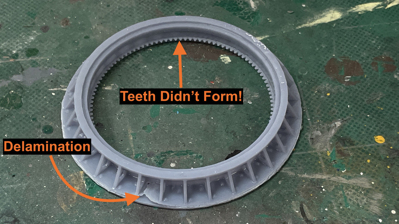

The reprinted ring gear was excellent, one slight area needing fixing. I fixed with Bondic. It fits the mounting ring on the frame well and the two can rotate. The real one has retaining clips that grip under the training gear and I’m going to duplicate so the turret will be positionable. I found that the Training Buffer interfered with the ribs on the stand, I surgically removed the offending material. I found another drawing of the buffer and it looks like the back is relieved for the same reason.
The mod: I also replaced the printed plungers with steel. One didn’t form right and after replacing it, I did the other to match.
The gun mounts printed well. I always make more than I need and one set had a fatal defect. Didn’t matter, I had three more and only need two. As printed off the machine.
Finished set: Not glued, just set in place.

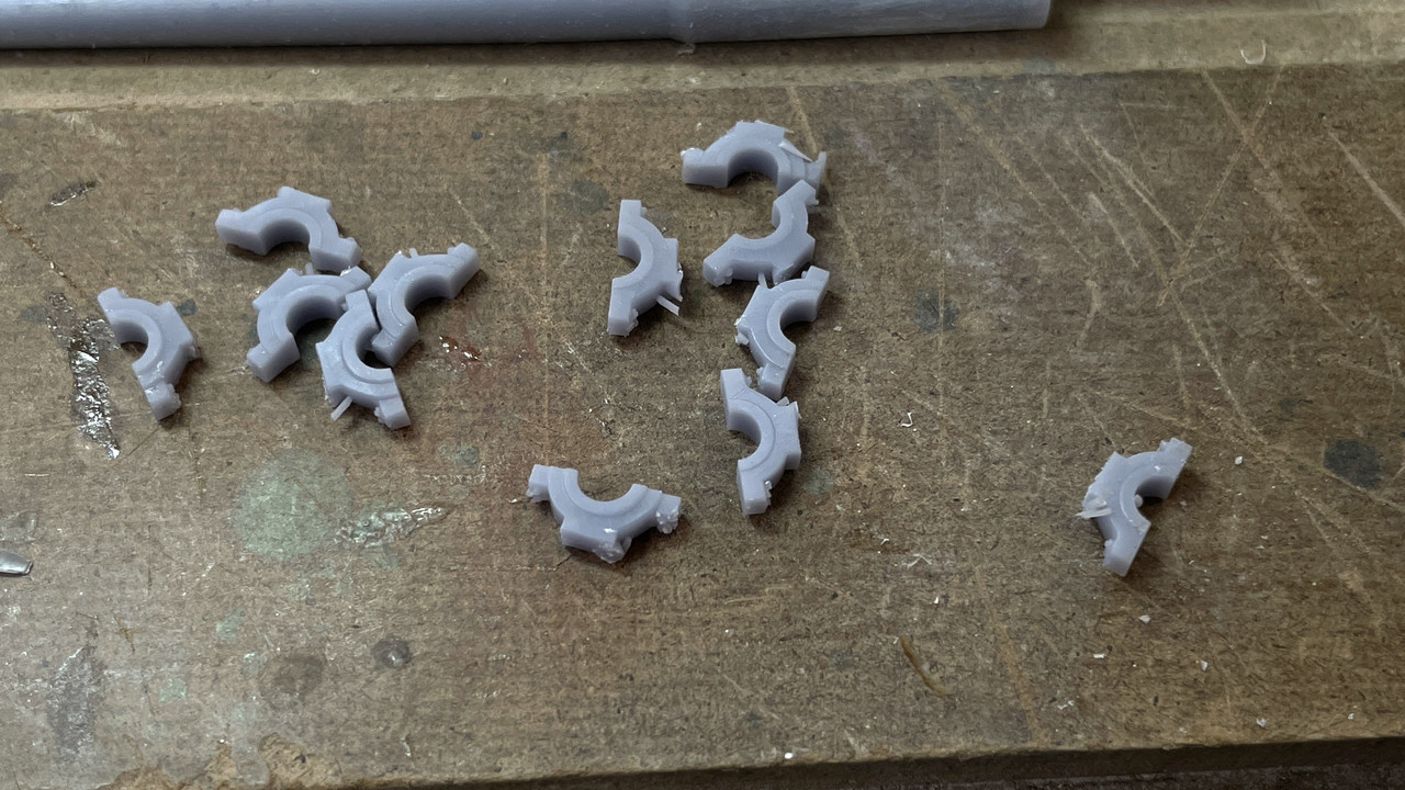

Printed a gaggle of trunnion caps. I erred. I put two bolts on each side. There is only one… Not going to worry about it.
Here’s the caps placed on the mount. Again… not glued. Can’t do that until the guns are in place.

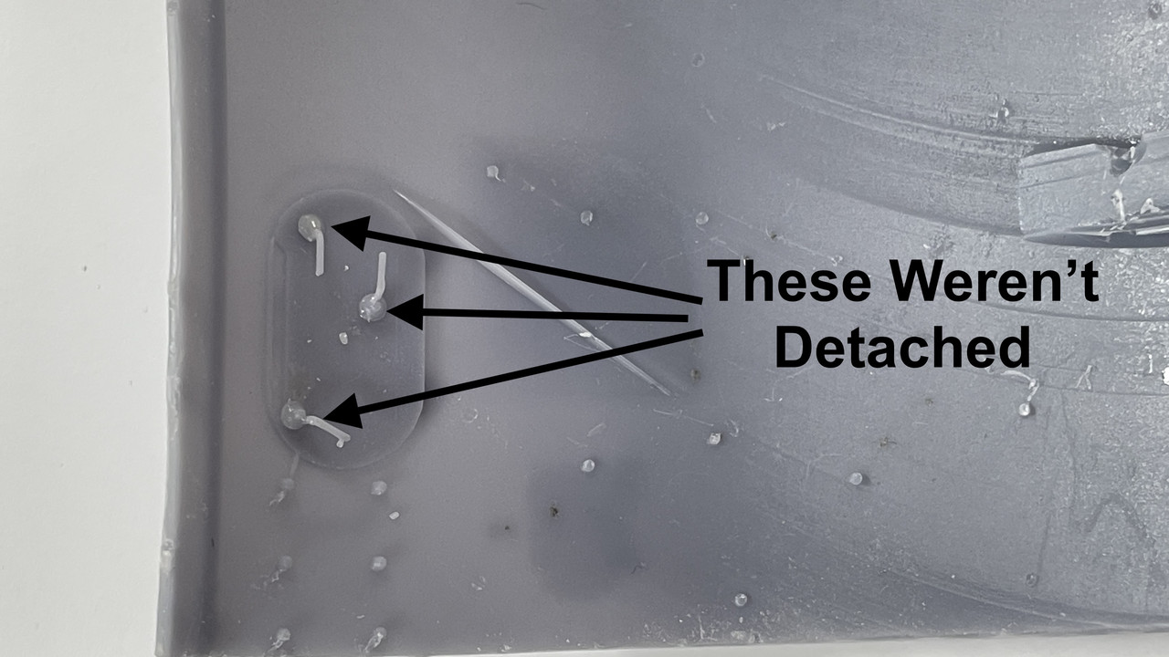

Here’s the one that failed. And you can see why. That support failed. When the support fails it usually leads to a local or catastrophic failure depending on how strategic the support is.

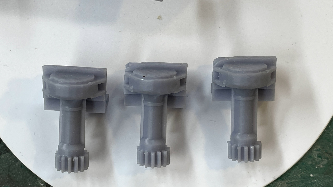

I also printed successfully, three out of four Training Worm/pinion assemblies. Only need one. This one was also a support failure, but of the more catastrophic variety. It left the partially formed part stuck to the FEP film at the vat’s bottom. The new version of Elegoo’s FEP film is very forgiving. Stuck parts pop off with no damage to the film. I can run for months without having to replace the film … a 20 minute job. Looks like something that didn’t make it through the Star Trek transporter too well…
Here are the good ones. Even among these there are some that are better than others. Always make more than you need!

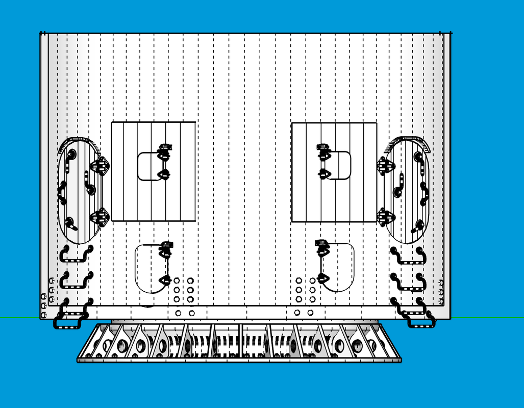

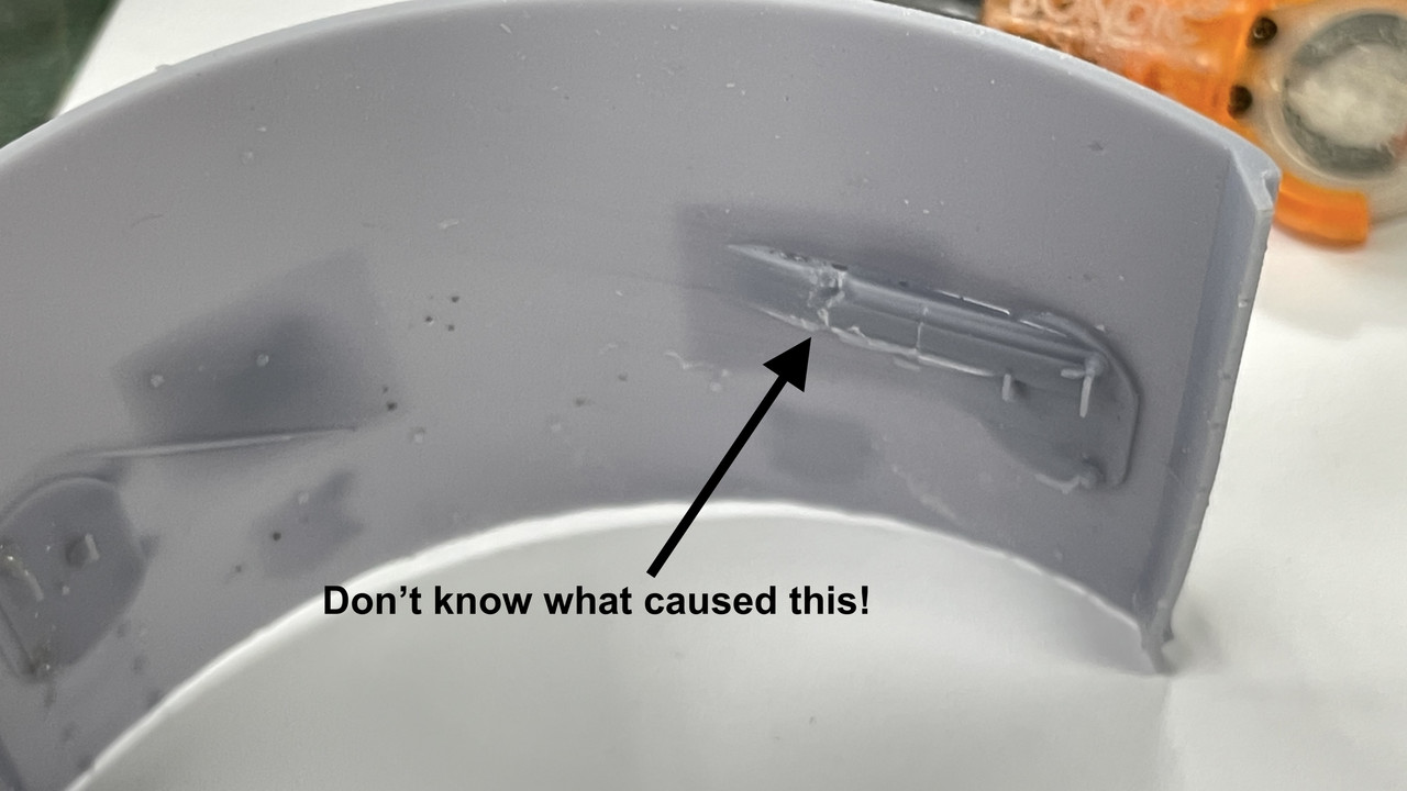

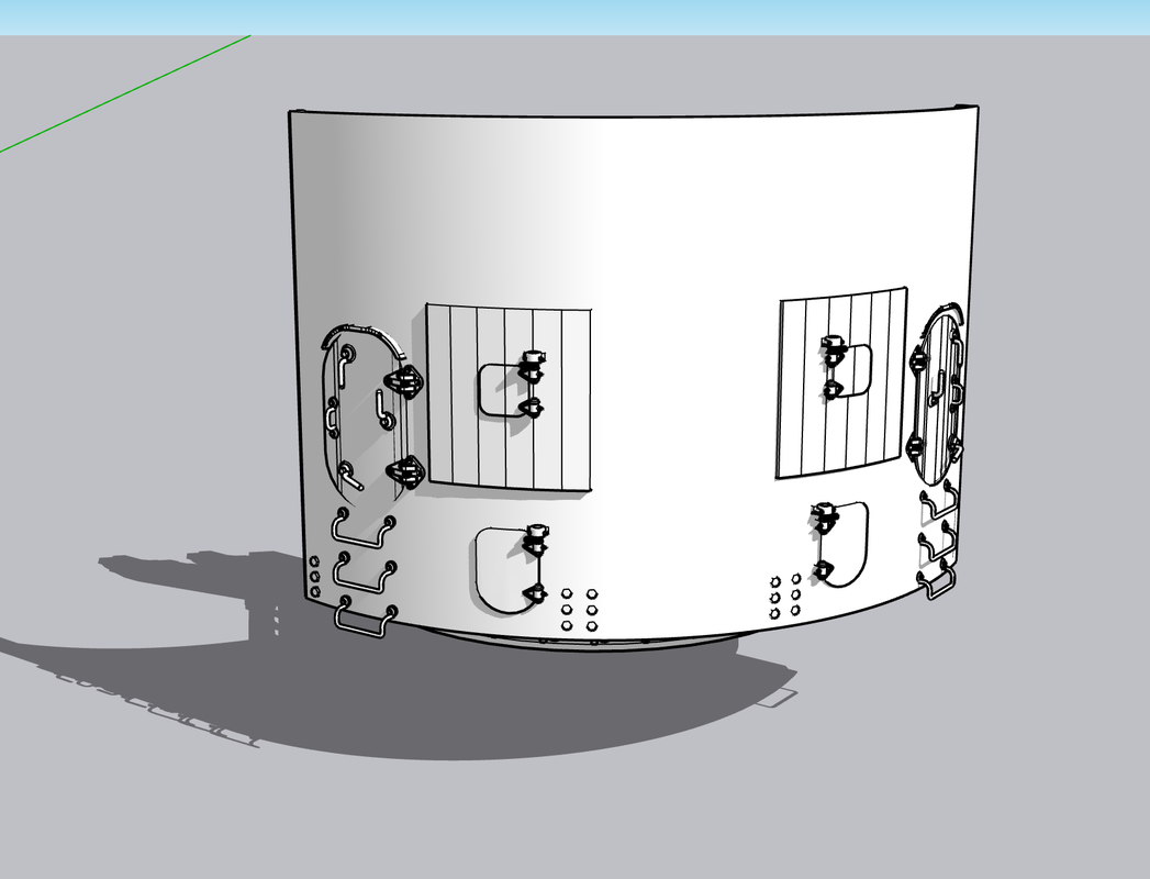

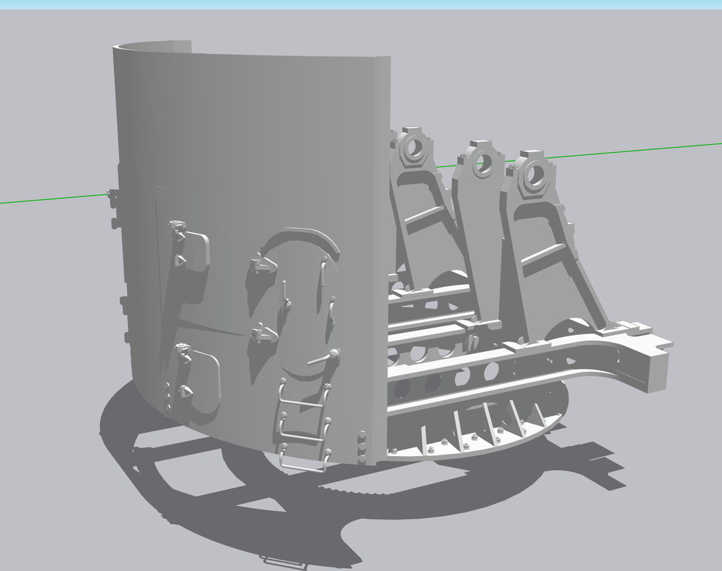

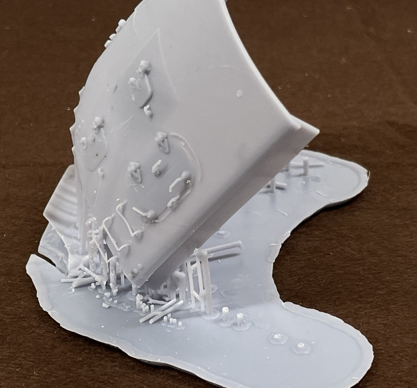

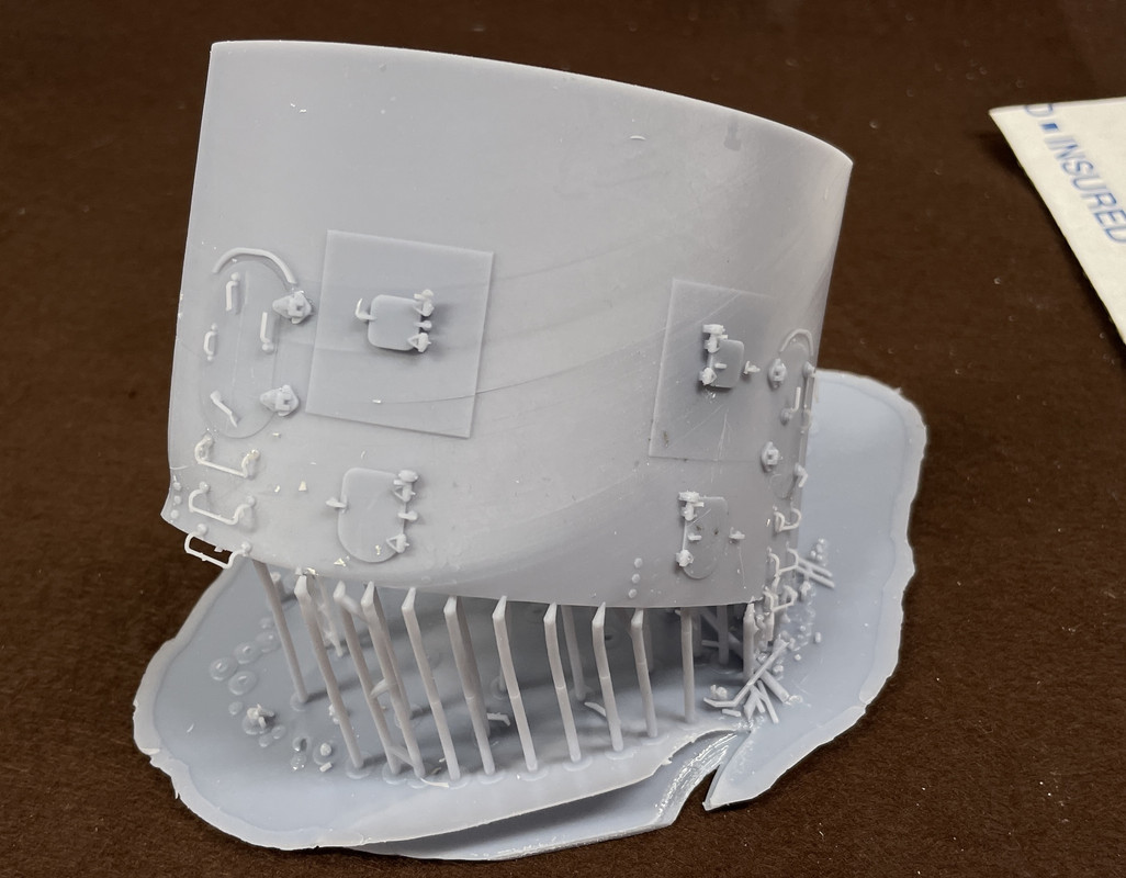

Here’s some WIP shots of the rear panel. I’m not sure if the hatch is curved. It too a while to create the curve using a copy of the wall section to cut the inner and outer faces. If flat, that’s much easier to do in styren. In addition to the crew hatch, there are four others for the cartridge discharge chutes.
Here’s the wall flattened as a test.

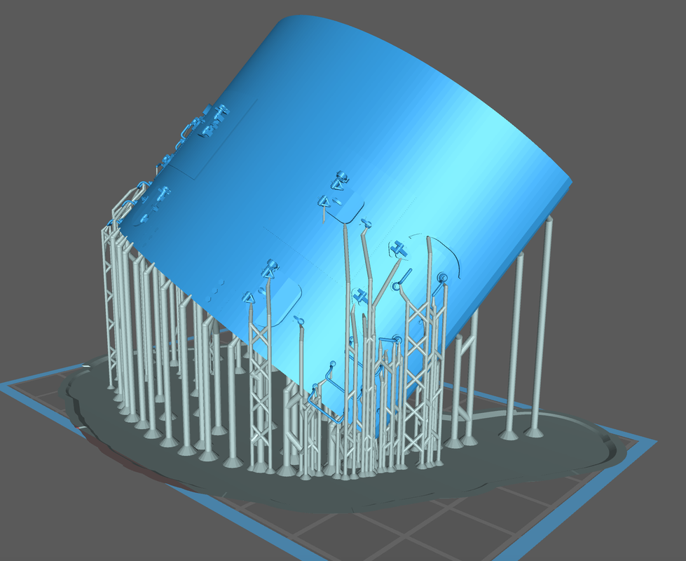

There are angle bars that attach all of armor panels to shape the gun house. I’m going to 3d print these with fasteners. My shape isn’t exactly right as I’ve ssen on some video footage. Don’t know how anal I’m going to be about it. The fastener pattern’s probably not right also other than it’s a combination of rivets and bolts.
Here’s the actual back do. I’ll print the foot rungs too. Hatch looks flat. This is the lower discharge port. The six bolts to its left are those that are holding the housing to the longitudinal frame rail.

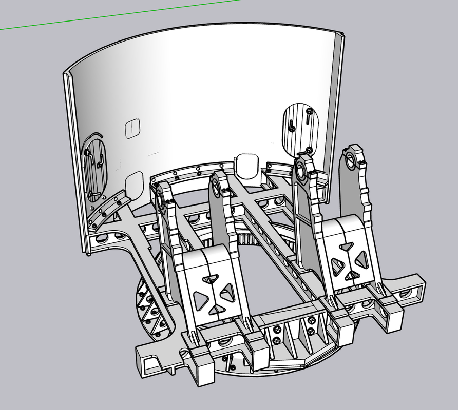

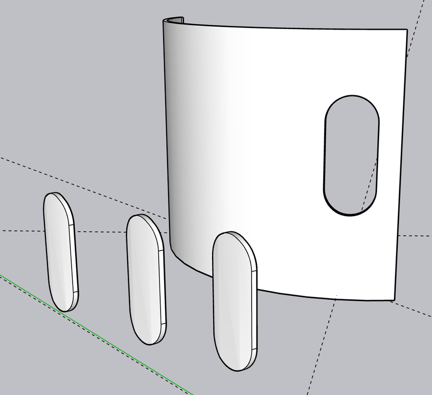

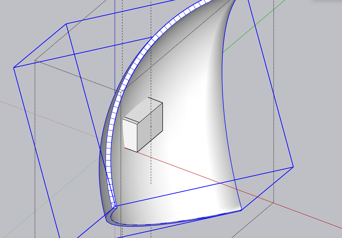

Now the gun. The geometry is a killer for me! I don’t have any drawing of the parts separated, e.g., slide, housing, etc. I was very difficult for me to visualize just what parts move during recoil and what parts are fixed. When you watch videos of the guns firing, the recoil is so fast you can’t stop it when recoiled. I suppost you could copy the video and do some frame-by-frame editing, but my bet is that it would highly blurred.
The real of the housing is curved in two directions… sort of part of sphere. I first had it curved only in the vertical direction, but realized it was wrong. To do compound curves in SU, I find it easiest to create a cutting too of the right shape and use it to shape the object. In this case, I created a segment of a sphere and placed it so it would remove the right amount of material.
After cutting I grafted the part to the rear of the gun frame and it actually worked out. Still have lot of details to include and am constantly checking that the object is still solid and printable. Last night started working on the rammer hydaulics. I used one of my drawings a as guide only to find it was completely wrong for the reservoir. Found others that were accurate. I spent almost 8 hours yesterday just doing drawings. And I have hours and hours more to go. Taking the day off to go see Openheimer.

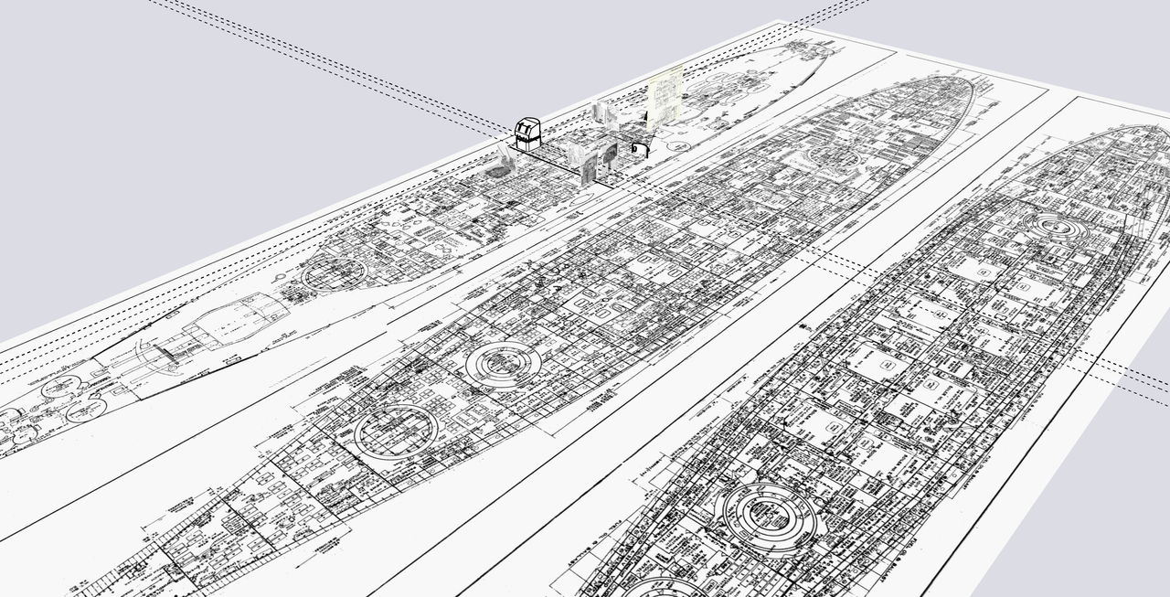

I was able to find FREE deck plans of the USS Missouri in 1950 configuration when it still had all the 5" gun mounts. I was able to load up the main, 2nd, splinter and 3rd decks into SketchUp and display them in full size… you read that right… in SU this file is a ship 887 full length measure. SU doesn’t care. I also had profiles of the exterior and center line section. With these I was able to line them all up and finally understand just where everything is going to go. I was also able to size the Ready Ammo Handling Room that supports the turret, and the elusive powder and projectile magazines which do not lie directly under the guns.
The 2nd deck has no gun handling apparatus as does the splinter deck. The splinter deck is a shallow void space to catch any explosive debris before it gets to the delicate spaces below like boilers and magazines. I used the 16" barbettes to register the drawings since the lower decks have overall sizes that are slightly smaller than the main deck due to the ships lines. You can find those plans here: https://archive.org/details/bb63bogp1950/08%20-%20second%20deck.png
When overlaid in correct resgistry I am able to model in full size the paths of the curved powder and projectile hoist trunks. These trunks are designed like this deliberately to mitigate fire from spreading from the upper decks to the magazines.
And I was able to accurately scale the Ready Ammo Room both in area and height by matching to the full size floor plan.
I erred in my design by including a lip around the rooms roof. It is flat.

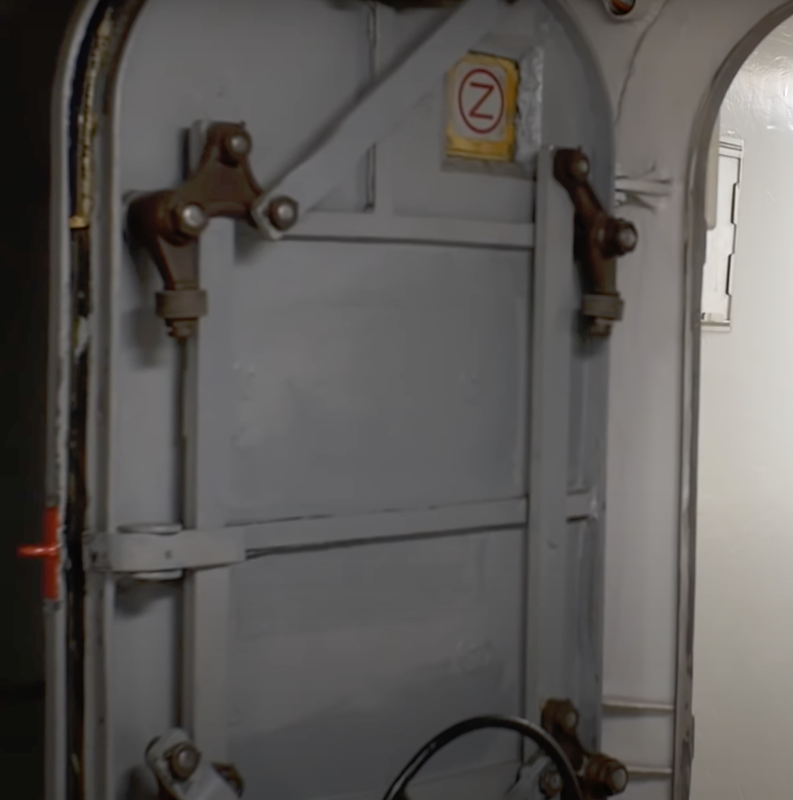

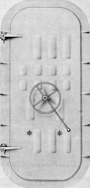

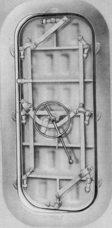

I also found very good data on the design of the Quick Acting Watertight Door (QWT). It took a while to search through hundreds of images until I hit on a sight that manufactured the style used by our Navy with great head on images on which I could draw the door. I also took screen shots from Ryan’s USS New Jersey video “Doors”. With these sources I was able to create a very respectable prototype.
Here are the three drawings I used:
Outside:
Inside:

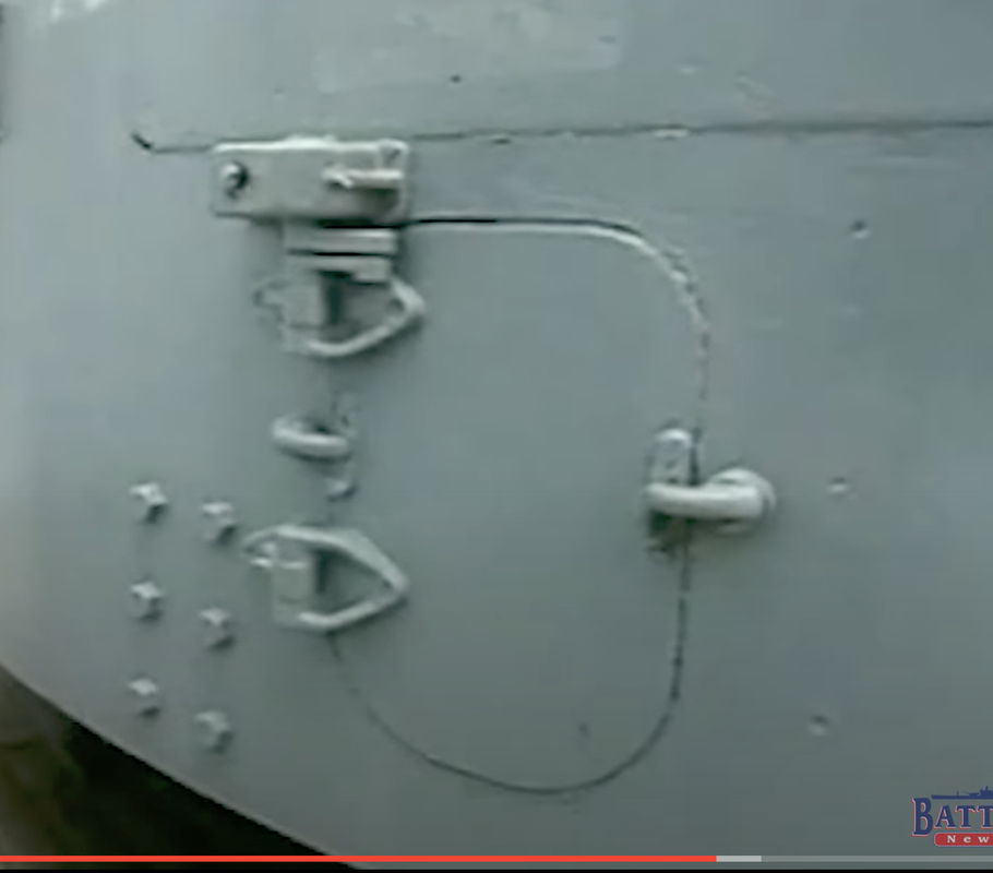

And then the best… the door without the hardware where I could get good fixes on the positioning of the dog pivots.
This was a closeup from Ryan’s vid. It shows nicely the roller dogs.

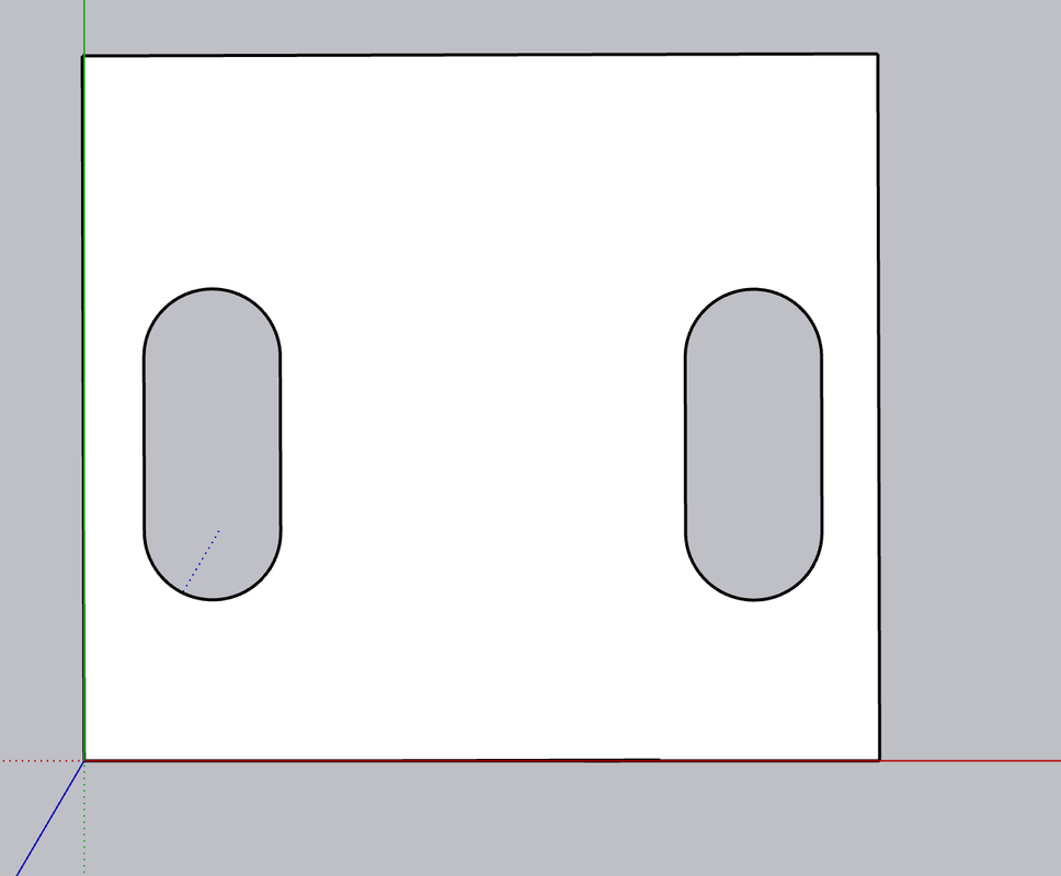

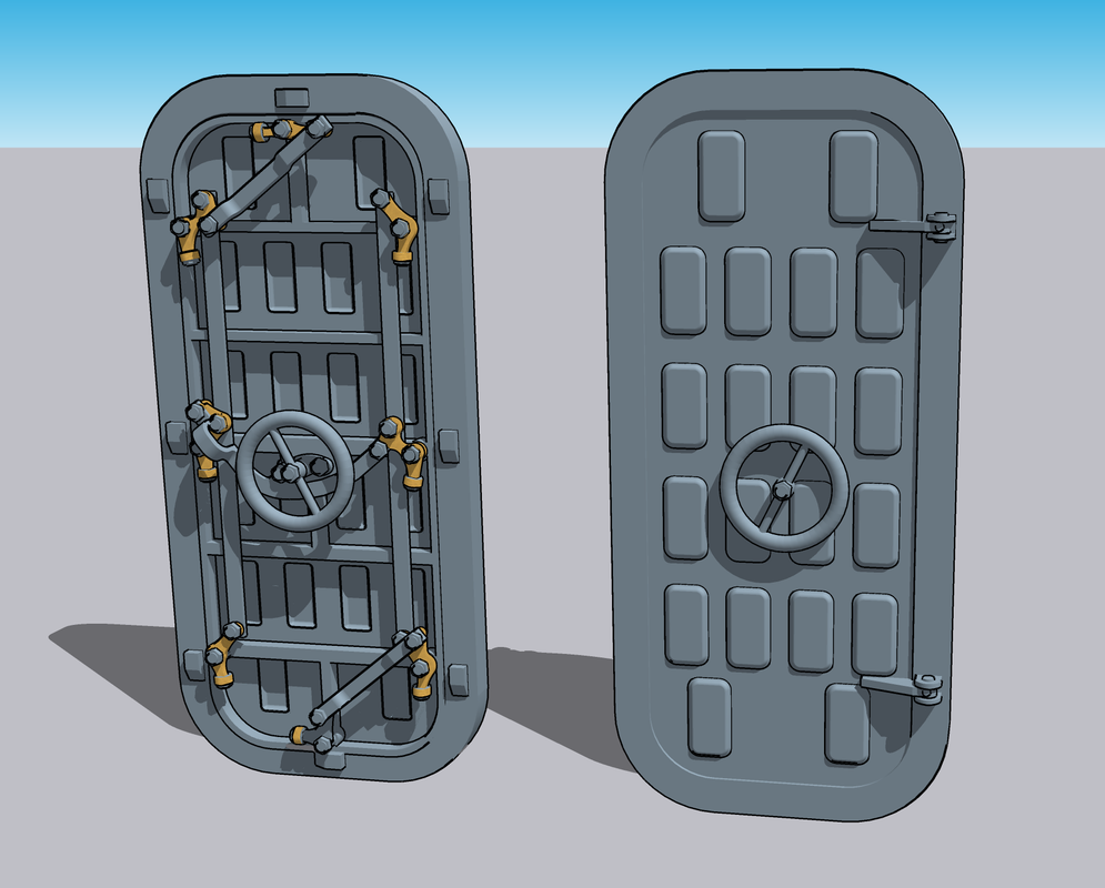

I drew the door in layers and 10X scaling. Sketchup has a trouble with working with curves especially when doing contours in FOLLOW ME. If the segments are too small, it leaves them out and makes holes, whereas when enlarged it fills them complelety. When you shrink the drawing back to original size, the filled areas stay put. I don’t know why this is, but it is. To make those bulges, I produced external rounded rectagular shapes and internal ones and bonded them to the drawing on both sides ensuring that there was some material thickness between them. They’re printing now, so I know if there was enough material to produce a viable part.
I then produced the frame as a component and finally overlayed the dogs and all their operating links. Some of the links were challenging since they have curves that enable them to clear the other parts.
And here’s the finished product showing both sides. The real door has an extension lever on the wheels to give more torque. These would be too frail for printing and I’ll attempt to add them with wire. I am attempting to print the doors as a single part. I will see how that works out. I also had to thicken everything. At scale thickness many of these peices would not be viable. The beauty of 1:48 is you can really lay on the detail and have a reasonable chance that it will show up.

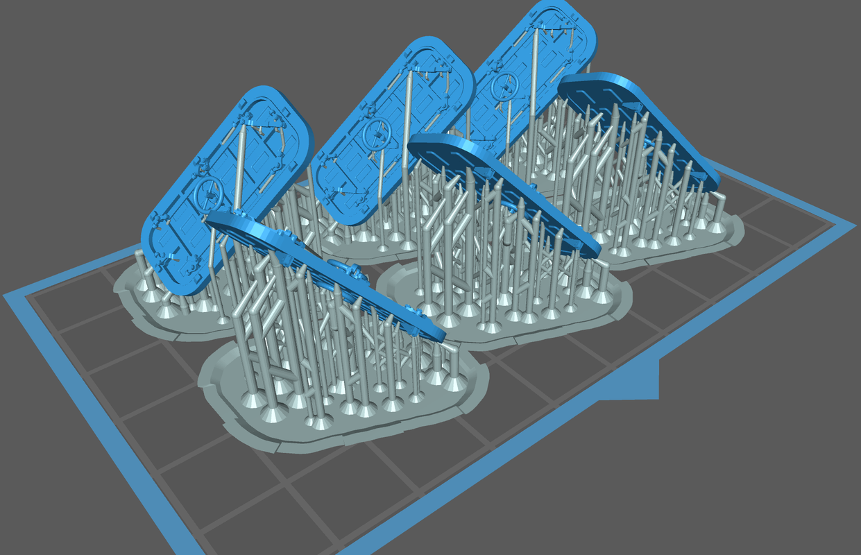

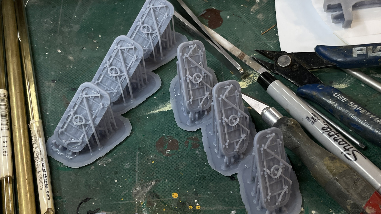

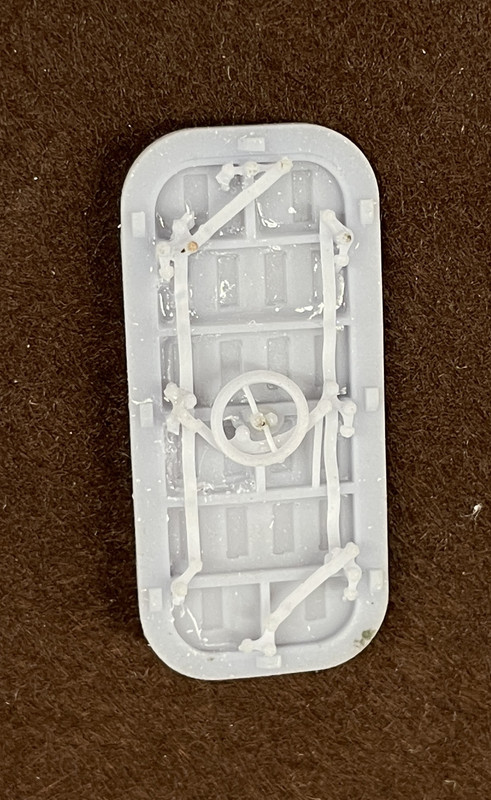

As usual, I print multiples. I will probably need at least this many. I’m also contemplating printing the entire rear curved wall of the gun house including the hatchs and details. It might be the easiet way to go if it all fits. Otherwise, I’ll print the curved corners with rabbets to seat the styrene walls. That will work to, but won’t be as elegant.
Whew! That was a load of stuff. Now I’m goint to check on the print which just finished. Let y’all know how that worked out.

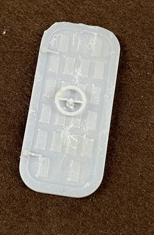

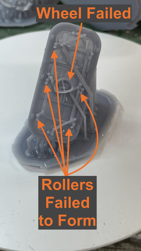

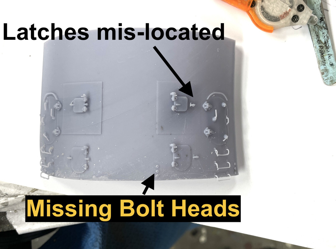

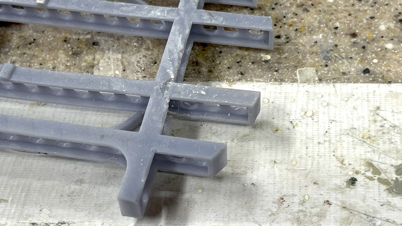

The prints were marginally successful. All of the complex contours, cranks and arms printed well. The handwheels failed as predicted and the rollers on the ends of the bellcranks didn’t form well. They were highlighted in pink, but it wasn’t bright pink so I thought they might make it.
At first glance it looked pretty good.
Upon further inspection here’s what I saw.
I’ll print the handwheels off the model and add them after post-curing. I will also do something to support the roller ends and that should do it.
The reprint looks good, but useless! The door I drew is not used in the magazines. Jim Slade and Ryan sent me photos and information about the magazine doors. They’re not quick acting, but have individual dogs and they’re much smaller. I will share and keep the full-size QAWT door since it’s used a lot of places onboard ship.
Trying to print the moving door hardware separately of the doors probably would answer the printing qustion; bnut not likely be successful overall.
(It would probably want a “casting block” that would want sanding away–that or a holding jig/fixture to install on the doors; or both.)
I’ve run into both problems while 3d printing–of both havign “too much detail” and “building up too much detail as separate parts.” There’s likely a happy medium, but it will ellude a person at times.

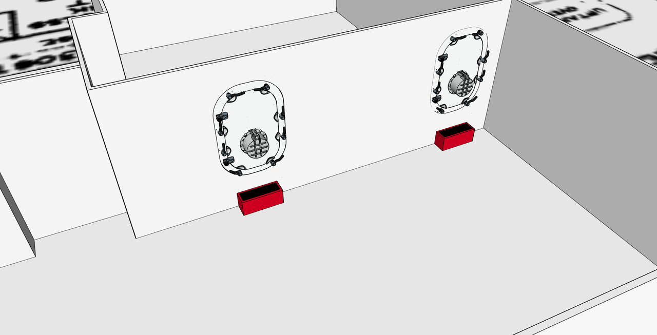

Based on information from Ryan and Jim Slade I completely redrew the magazine doors. There appears to be two types, both smaller than the standard QAWT that I drew eariler. They’re the same width (26"), but significantly shorter at 45". They are also locked by individual dogs (8) and have the pass-through scuttles where the powder canisters are passed from the powder magazine into the projectile magazine where the dredger hoists are that take both (separately) up to the ready ammo handling room.
I’m going to print the door complete with all the levers attached. I believe it will work as long as I don’t break them all in handling. I can always subsitute wire (I did this in the big turret).
Here they are installed in the partitiion that separates these two spaces. There’s still a ton of work and research I need to do on them to make this a viable model.
The larger doors have a 7" sill, whereas these have a 24" sill requiring the step to make them easier to negotiate.
Here’s the opening side. The floor plan shows which direction the door swings. I now know that the black bump on the door’s symbol is the scuttle in the middle of the door. There is also a line on some of the door symbols that shows the handwheel of the QWAT door. Then there are the rest without specific symbology which I have to figure out.
Here’s how they’re going to be mounted on the printer. I’ll put them on tomorrow. Print time is less than two hours.

SketchUp does not actually draw curves. It draws a series of straight lines that approximate curves. For circles the default is 24 segments. That’s quite clunky and in 1:48 would be very noticeable. To fix it you’d have to sand all the peaks down to curves, but all the details are part of the print and they would get in the way. For the tools that make curve parts, the default is 12 segments. When I’m doing a surface that I want to print almost a true curve I go minimum 48 and even better 96 segments. SU’s computational engine works harder the more segments that curves have. For graphic display purposes, SU smoothes the curves, but the segments are actually there and when you export as an STL, there they are.
Here’s an example:
The drums are R-L 24, 48 and 96 segments. With the curve smoothing they look like perfeect cylinders and if I were to print or render this, it would look great.
When I turn on “Show hidden surfaces” you see the segments, although the surface is still smooth.
But after STL conversion and loading into the 3D slicer, this is what the cylinders actually look like. In 1:48 that flats will be very noticeable.
One of the most difficult aspects of drawing the back wall was putting the details onto a curved surface. SketchUp works on an X-Y-Z coordinate system with X being the red axis, green the Y axis and blue the vertical Z axis. It is always best for many reasons to orient your drawing with the these axes which facilitates moving things around. That works great on a rectangular object with 90 degree corners. With a curved surface like this wall, only one spot in each quarter turn aligns with the axes. I drew all the details off the model, ensured they were each printable solids and then embed them in the curved wall’s surface. I actually push them into surface just a bit to ensure that the details don’t form detached in space. I they have separate supports, which many will, they could completely form, but not part of the print. When the wall surface is not on axis, when you move the object in the x or y direction it moves in an angle. So if I wanted to put the part in a specific location, I had to zig-zag and creep up on it. It took a long time.
Then about 3/4 the way through the exercise, I decided to copy and paste the completed wall to the master drawing. When I placed the wall against the rest of the gun house I drew previously. It didn’t fit! Frankly I don’t know when the size change. I say “changed” because the original curved wall was that gun house’s back wall which I copied and then added the two scale inch depth. This image shows the first wall I drew superimposed over the corrected wall. This difference was unacceptable. The side walls have to intersect with the 0.040" thick side walls with no gaps.
Here’s a vertical look at the wall over the main frame. Again, the wall has to key into the frame correctly. The new wall is on the frame and the incorrect one behind it.
I couldn’t just stretch the wall to fit. I had to start over. However, I was able to take all the details off as a group and preserve them. That sounds easier than it was since they were on slightly different distances from the center and lying on slightly different radii. Lots of trial and error. Notice I’ve thought ahead for a change. I included the mating flange that will connect to the straight side walls. There is angle brackets on the real turret that do the same thing.
Here’s how the finished product will look. Notice also the curved angle bracket that secures the floor and back wall to the frame. This is not the fianl look for this part. I have to study the pictures and drawings more.
And the finished front.
And in a more rendered way.
Here’s how the wall fits on the printer.
I’m using heavy supports on the wall itself and a lot of them. It’s not that there’s that much surface area, but it’s a bit heavy and that weight starts to play a part in the support scheme. All the details are supported by fine supports. Notice how fine the facets are on the surface using 96 segments. Very light sanding will remove them entirely. In 1:48 you can include ALL the detail.
While the attached foot rung will print, I’m worried about thier longevity, especially the ones hanging down below the lower edge. I will surely break them off. I am printing them in bulk so I can replace them if necessary. I’ve included a 0.020" stub on them that will fit into a drilled hole. Each rung has to be supported separately. I can make many of these fairly fast.

I finally unloaded that batch of QAWT doors and they did come out pretty well. The handwheel cross bars are almost too fine to hang together, but even there I did get some successful ones. The operating bars are so thin they’re kind of floppy and if I were to do them again would make them about 2X thicker. As I’ve said before, real world material sizes sometimes don’t translate successully to the model especially at 1:48 or smaller. Regardless, I’m happy with them. They will work and I don’t know where to put them in the model. It gives me confidence that any other doors I produce will work.
And the flip side. All the major supports were on the front side and the only supports on the mechanism side were supporting the dog rollers and removal didn’t damage anything to badly. I hadn’t don final sanding on the edges.
And here’s the second one I cleaned up. I still have four more that I haven’t trimmed that are in the spares box. This one did have the edges sanded. When primed and painted they should look pretty spiffy.

Then, this afternoon, I put the back wall in the printer. 6 hours later here’s what I got. It wasn’t totally bad, and, in fact, since it’s quite an unusual piece to print, I’m not too upset, but there were some weak points.
Here’s as it came off the machine looking at three views. I had removed some of the supports around the delicate details, but did not post-cure.
On the left corner there was some distortion. I don’t know what cause it, but it’s usually a support failure. I will have to evaluate whats going on in the slicer. The handles and steps all formed nicely.
Note the delamination of the base raft! That’s also strange showing there was good adhesion to the build plate. Could be too much attraction to the FEP.
No distortion on the right side!
And the back. Strange things were going on in the back.
Some remarks about this…
I thought the drawing was finalized, but the latches on the right side cartridge chutes moved out of position. The center section bolt heads are not there. That too is a drawing error.
BTW: As predicted, I already broke those bottom two foot rungs. I will have to add them late in the build and maybe make them out of metal.
In the back, the right side latch dogs were not attached to the surface. Remember was I was saying about have to be sure their embedded in the drawing. Well… I guess these weren’t. I was able to put them back using Bondic, but I’m not keeping this part for the model. It’s going in the scrap box and will be used for parts if necessary.
And then there’s these malformations. I’ll have to explore this defect. Because it’s actually more material, I can grind it off if I need this part.
