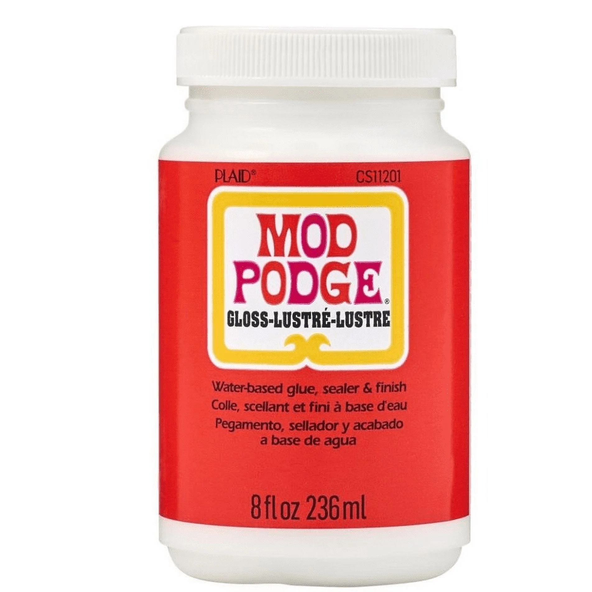

I use mod podge Amazon.com - Mod Podge Dishwasher Safe Waterbased Sealer, Glue and Finish (8-Ounce), CS15059 Gloss, 8 Ounce ( Amazon link) for “ glass” parts. Always works for me, it’s cheap and the container will likely outlast you.

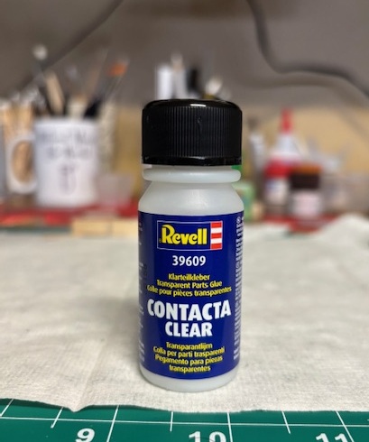

I’ve used Revell Contacta Clear and it’s done a good job.

Yup, it is expensive PVA glue in a Revell bottle.

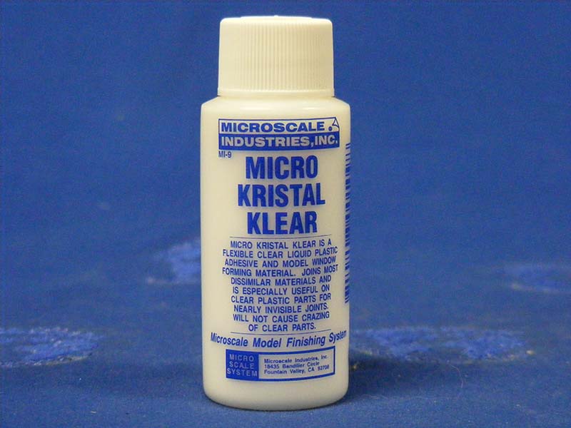

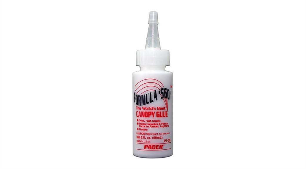

PVA (white glue) is good where you can’t see it because it cures opaque dull. Like a dull coat. The best for clear parts is Micro Kristal Clear, Pacer Canopy Glue, and Mod Podge Gloss.
I was coming here to say, micro crystal clear, it works great.

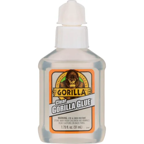

I use Clear Gorilla glue to make lenses but it could also be used to glue lenses in place. Downside is that it takes, at least, 2 hours to dry.
