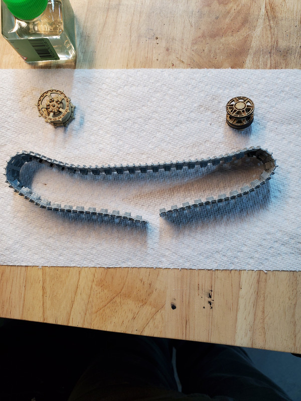

ok I’m missing something the instructions imply I should glue the tracks one to another which I did if so they would be unable to spin around the sprocket??.
Once the tracks have been glued together, before the glue has time to completely dry, you can form the tracks around the drive sprockets, idler wheels, road wheels, and return rollers. So the polly caps in the sprocket is only for it to be able to turn while you put the tracks on. And also so you can remove the sprocket if needed.
S.H.
Okay I believe that Tamiya uses link-and-length tracks,my process is for individual links but the process is pretty much the same.
First I glue the whole run together using Tamiya Extra Thin and let dry 25 min
Then I flex the whole track around the running gear and let dry overnite
Remove when dry
Paint,weather and return to tank
The poly caps hold the sprockets in place,and make them easier to remove.Hope this helps.
