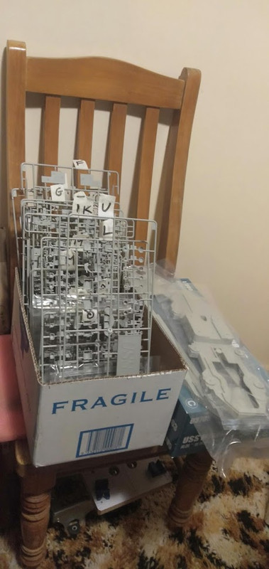

your right about the pe capnmac , their is a lot of it , he said with a shudder , the stuff on the left is out of the kit stuff .
all the frets are organised .
this is a tad on the large size .

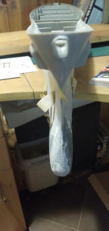

I found a pic of the bulbous nose on the missouri , could you explain to me what those side fenders , sticking out of it are for please , sort of toying with the idea making my own bulb , skills permitting of course .

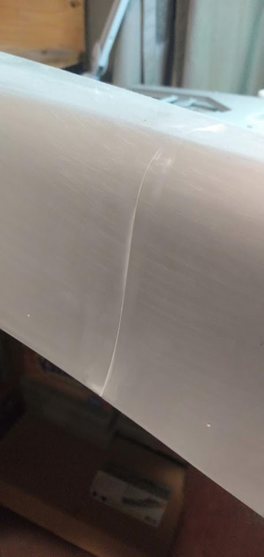

joined the bow section onto the hull , had to use a bit of bog , will know how good a job I did after primer .

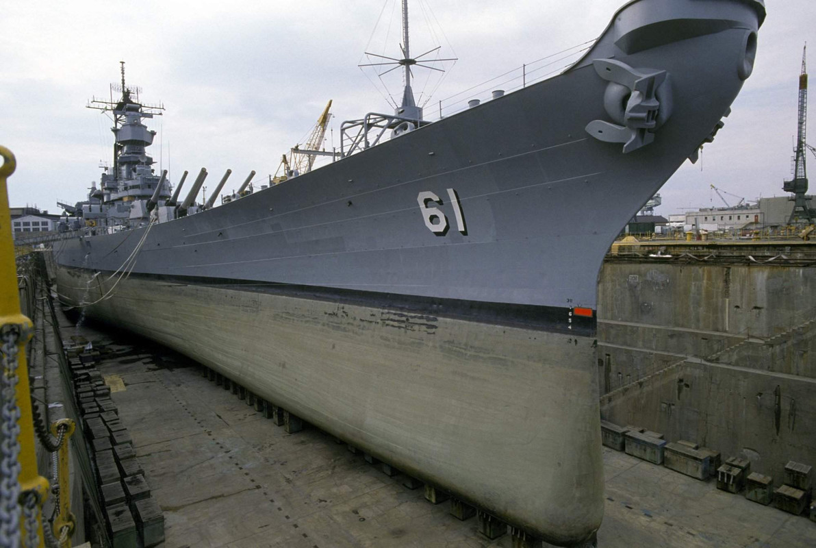

The side things are part of the build / launch cradle.
As for biulding your own bulbous bow, check out this shot as it shows the extend of the hull lines from the bulb on back. As you can see, it does not narrow again aft of the bow.
Looks like they cut an opening in the bulb to gain access for some reason. Note the top of the “wing”, looks like it penetrates the hull, but still open just above.
Is the Navy that paranoid about the ship moving without permmission that they drop anchor in dry dock? LOLOLOL!
Well, some ships are more motivated than others . . .
No actually, you should note that that chain is considerably smaller than the anchor chains, and is there for streaming paravanes (mine sweeping). As the paravanes swing out because of their ‘wings’ , the chain weight keeps them from pulling the cable out of the water. Without the cable in the water, you don’t catch mines, you find them when they detonate against the hull, which is not a recommended practice.

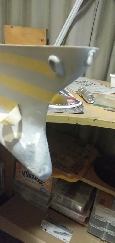

here we go , didn’t think I was much of a sculptor , this is as good as I can do . will hit it with some primer see what needs to be fixed . at least it has a bulbous nose now , still have to fix the little ring down below , that should be easy enough , get back to you soon .
You’ve got the width looking good, but there’s a bit too much toe. In profile, the bow below the waterline should be near verticle. Check out the photo of Iowa’s bow, which should be identical.

thankyou for that capn , i learn a lot from you mate . I have started shaving excess milliput from the bulb , as others have suggested , i can only go so far as I put a ball to the bow , to start me off . live and learn I will be better next time .
