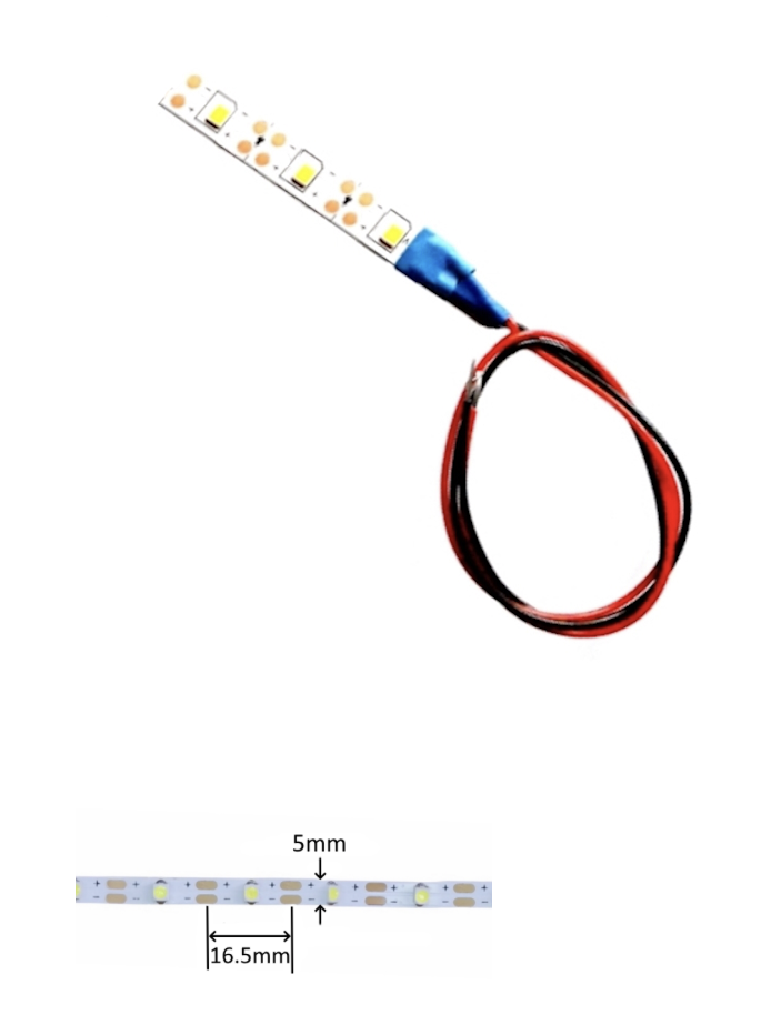

Thank you, veedubb67. That was what I expected to hear. But I’ve found another LED strip that wouldn’t even need to be shortened:
It’s exactly the right length (and the same design as the two longer ones I needed), and if were too bright I could trim it, or apparently paint the LEDs with clear very light yellow acrylic to darken them slightly.
Bob

I love using LED tape! One of the nice things is that you can cut it very inch or so. Most of it runs off 12 V, but using 9 V reduces the brightness to an acceptable level for starship lighting.
@veedubb67 — I was using 3V, and the lights were still very bright, but the main problem was the colour — bright white. The LED strips I ordered (and I just ordered some more) are warm white, more similar to the electric lights that Titanic would have had.
Yep - the Warm White LEDs should do the trick!

Those little copper dots are solderable, so you could shorten it at those points, and solder speaker wire to them to lengthen, or wrap it around a corner or something. I’ve used these LED strips alot around my house (under kitchen cabinets, in display cabinets).
You can put a dab of white or cream colored paint on the LED to knock down the brightness and make it a warmer color too
