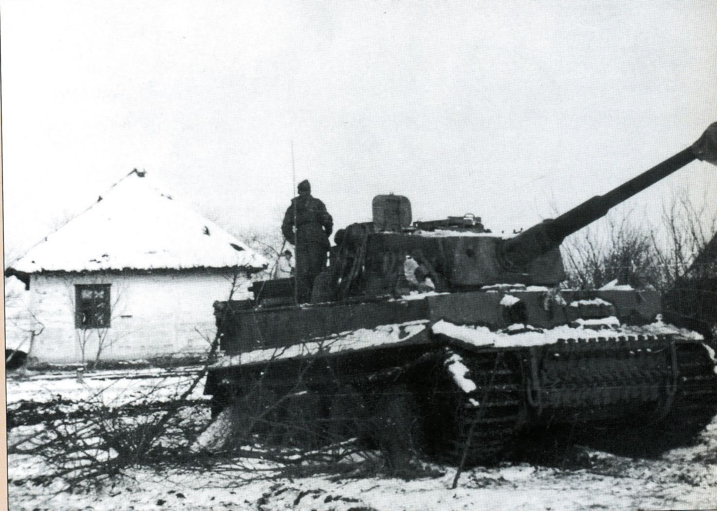

I found some pictures in Jean Restayn’s book “Tiger I on the eastern front” There are more than i will show here and you can find more Wolfgang Schneiders book “Tigers in combat” Vol 1.
Your best choice is s.Pz.Abt 509. there are a good number of pictures of thier mid production tigers without zimmerit, and some of the mid production tigers with feifel filter, i have only scanned 3 pages here and some of them are Jean’s artists impressions of what they would have looked like, from what i can see they are fairly accurate. Enjoy, and i hope it helps.
