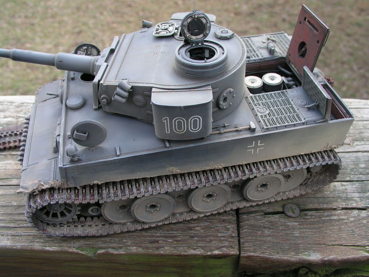

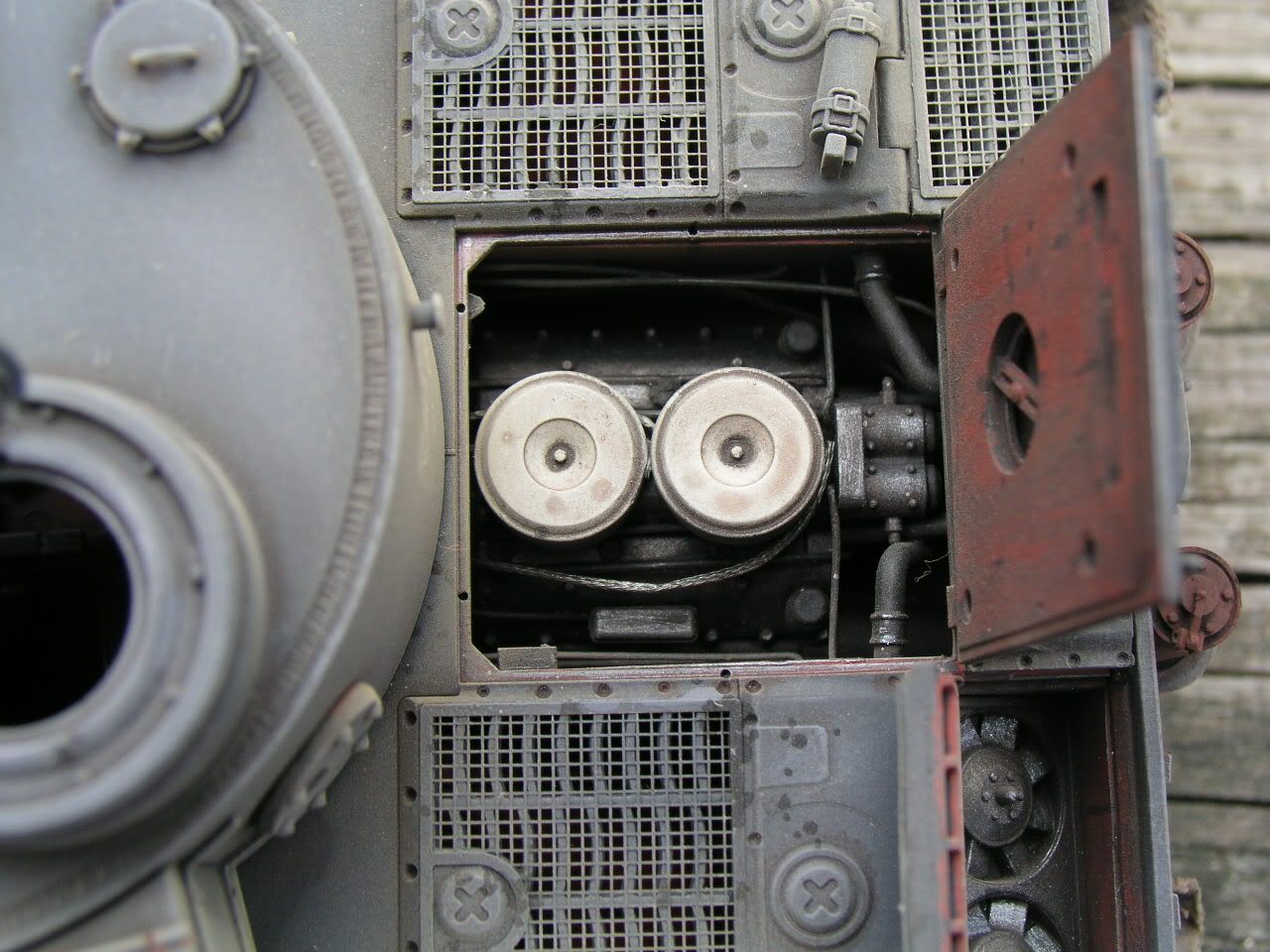

Well, I may not have the correct number of air filters, but here is my installation of the Verlinden set into the DML Tiger 1 initial…it does work:
The problem with the Verlinden set is that they provide no plumbing. The Tamiya set provides just the “top” of the engine, but does have plumbing. I scratched my hoses from 1/8" shrink tubing and parts from the Tamiya engine set.
Steve

I think we have the same thing Alan, You get a PE engine compt wall(s) and an oil tank and a resin engine, right?. But, no piping for the air intake fans etc.
Steve

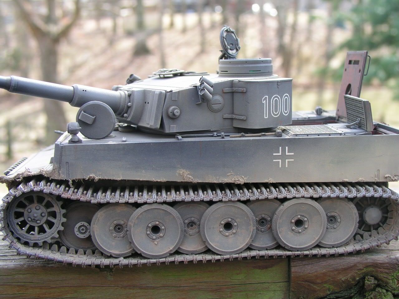

hey kernop-- that is a cool link[:D]–i really enjoy reading about the technology of days gone past-- you would think with all the ‘forward’ thinking they could of put a package together that didnt break down so often and had more power(for the size and weight of the vehichles)it had to be in–the 210 was o.k. for the panther but for tiger and tiger II (even the 230 upgrade) was inadequate-- sorry i am kinda off topic-- treadwell-- enjoyed the link!-- p.s. parks-- nice photos and build !-- initial tiger looks real good[8D]
I often thought the same thing treadwell why they didnt come up with a better engine for the tiger. Parks and Crockett your engines builds looks great! Even if its not the right engine, you guys have done some great work there on your initial DML Tiger builds. I put the right engine in mine, but i didnt do all the extra work with the plumbing you guys did, that makes you guys engine look way better then my work.Nice builds[tup]
