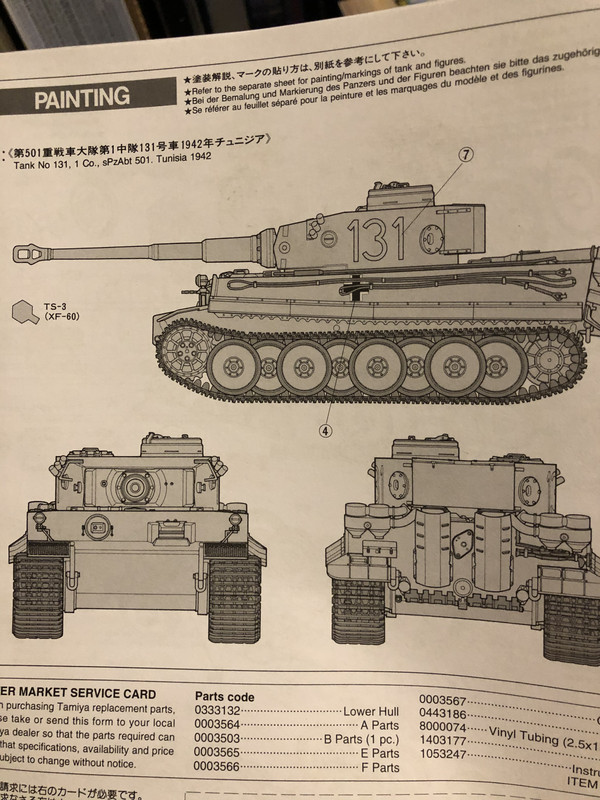

Hello friends. Can someone tell me if this Tiger 131 represented in the Tamiya instructions is the same as the Tiger 131 at the Bovington tank museum? The Tiger at the tank museum has different style numerals on the turret and also has a light olive camouflage. The one in the instructions does not. Thank you!

Yes, this is supposed to represent the same vehicle as found today at Bovington. The Tamiya instructions are simply wrong. Start here;

I thought that the Bovington Tiger was from 504th Heavy Tank Battalion, and not 501st.

From what I see on the instruction sheet pictured above, that is a 501 Tiger. The Bovington Tiger is indeed, as Stik pointed out, from the 504th. It would have the rounded exhaust guards (not angular with slits), only the one pistol port on the left hand side of the turret, and their numbering were smaller red digits - no white outline. There are a few other things …

All the Tigers from sPzAbt 501 were RAL 8000 with RAL 7008 camo patterns. Due to the haste in the battalion being deployed, some equipment was not fitted right away. You will see RAL 8020 on turret stowage boxes, track tool boxes and some Feifel air cleaners. Tank 142 had Dark Gray Feifels and a RAL 8020 tool box. The turret numbers were tall white outlined digits with no color infill. Later, when the tanks were absorbed by the 10th Pz Div, the numbers were filled in with red. 1st Company of the 501st became 7th Company of 10 Pz Div. and 2nd Company became 8th Company of 10 Pz Div. One tank went from 2nd Co., of the 501st to the 8th Co of the 10th Pz Div., then back to the 7th Co of the 10th Pz Div. It was captured and eventually shipped to the US.
All of sPzAbt 504’s tanks were RAL 8000 with RAL 7008 camo. They were completely outfitted before deployment so no color variations exist unless repairs were repainted. Their turret numbers were smaller and all red. The Bovington Tiger is an example.

sPzAbt 501 tanks had a stalking tiger on the front armor plate by the driver’s view slit as a unit insignia. sPzAbt 504 had a white panzer rhomboid on the forward end of the upper hull side plates as a unit insignia.
So technically Stik, the tiger in my instructions should have a stalking tiger emblem?
Not always. I can’t find an image of 131, but this is 112.
The Tamiya decals are not wrong, they just don’t depict or claim to depict the Bovvy Tiger.
I can’t say yes or no on that. Some 501st Tigers had the emblem, some did not. A superb website, Tiger im focus, which is now members only but used to be general access, has photos of most of the known Tigers in Africa. And the detail differences between them. I used it as reference for my Tiger build back in ‘13. But since I’m not a member I can’t access it to say if 501st’s 131 had the insignia. It may have, it may not have had it.

Converting the Tamiya kit would involve the following:
  • omit pistol port right ear of turret
  • add escape hatch turret rear
  • move headlights to top of hull (though could probably leave them off altogether)
  • curved exhaust shields
  • different style of mud flaps (both front and rear)
If you want to model the Bovington Tiger and stick with the Tamiya brand name, you would be better off with kit no.35216 - though it is missing a decal for the cross located on the hull rear. Also refer to TigerInfo site for some minor corrections.
