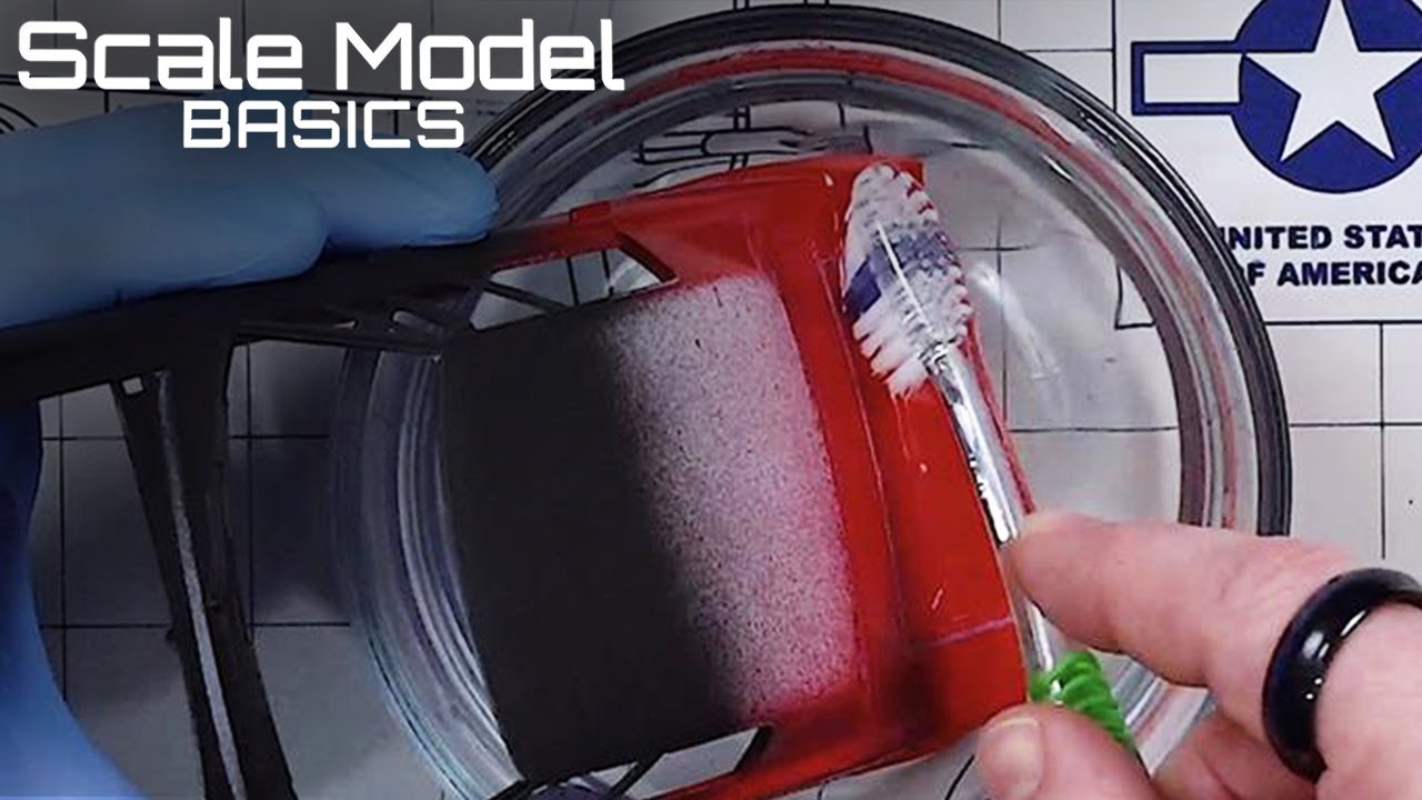

The big difference in my method vs your video, is that I used an old toothbrush with some water to remove the paint, not cotton swabs. I think both methods have their uses.
One last warning on the EasyOff (among others previously pointed out), don’t use an aluminum pie plate to let the parts soak in it, the aluminum will break down and disintegrate.
Another vote for Easy-Off - I’ve been using it for 40 or so years, and rarely had it take more than a half hour to work, usually 15 minutes is more like it. I put the model or parts in a Tupperware tray and spray, making sure all surfaces are covered, then let sit for 10-15 minutes before - like @Frozin - using an old toothbrush and running water to scrub the stubborn bits away. Occasionally re-spray and repeat, but usually not necessary. Last step is to wash everything with dish soap to make sure the last traces of the alkaline are gone.
