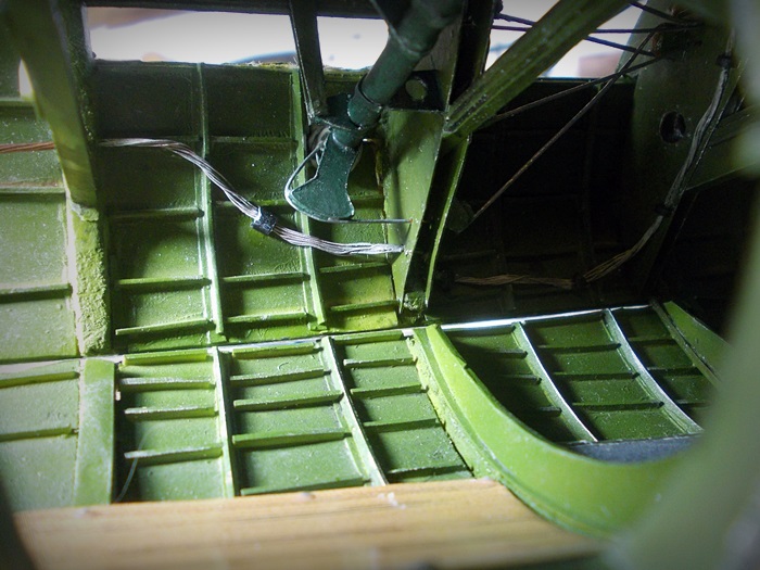

THE FINAL HURDLE!... 1:20 scale scratch built B17G

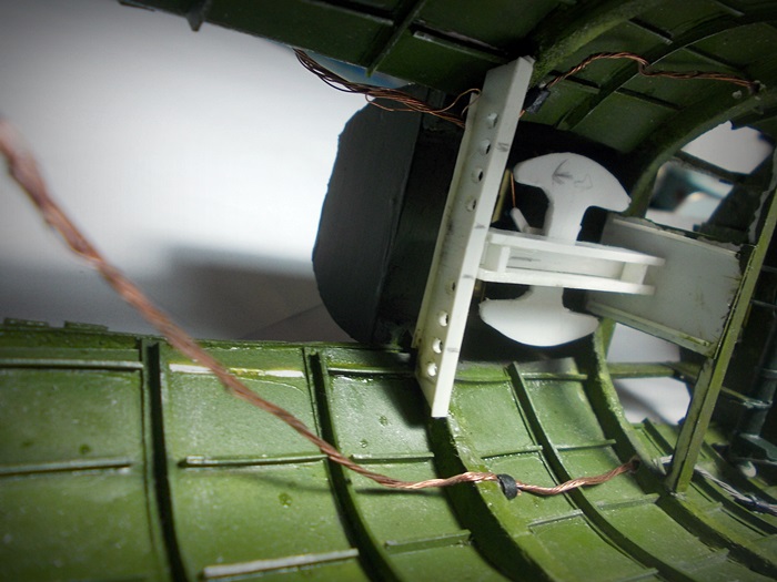

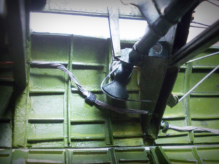

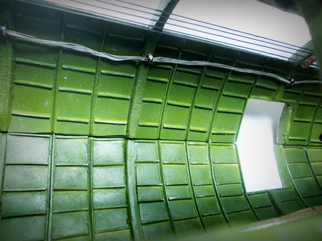

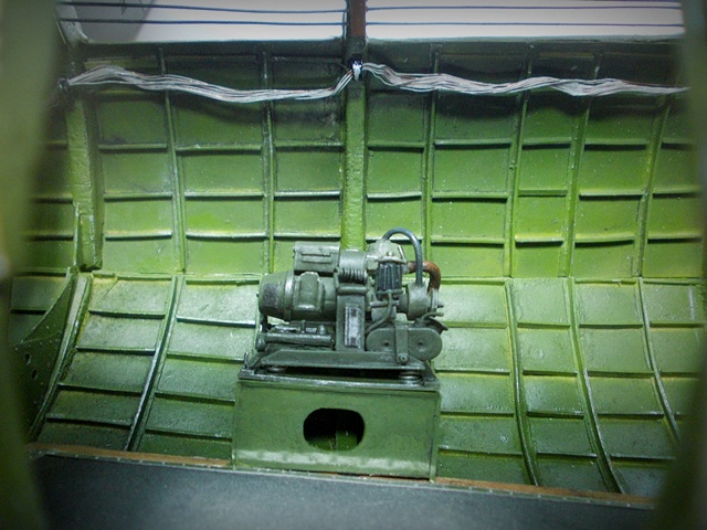

I also placed all the electrical cables on to the side walls…
I also made a little tail wheel crank for emergency use…imagine how exhausting that was to hand crank down!

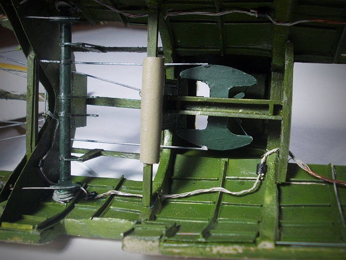

So now to the correction of the detail in this area…

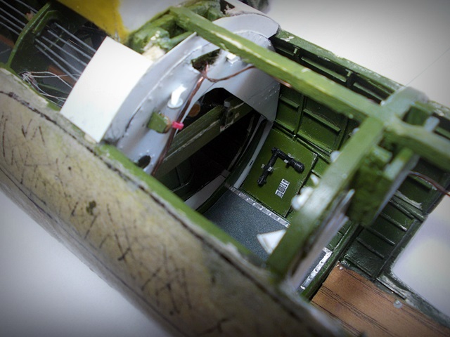

From the new photos I noticed that there were not one but two C1 auto pilot units. In a sense I was pleased about this as the one I previously made seemed very long! After doing a bit of measuring I reckoned that if I cut the unit I made in half I could make the two I needed!..it would be just a case of adding some extra detail for the second unit and a bit of tidying up. So I carefully pulled the unit of its tray…not easy as most of my detail I super glue in!..but never the less got it out without too much damage.It was then cut in half and made into two units…
…and then carefully glued back onto the shelf…

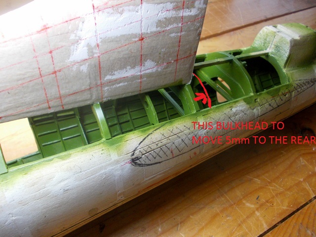

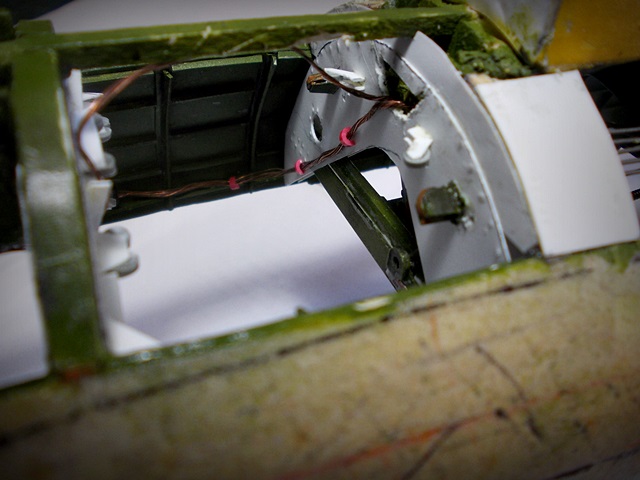

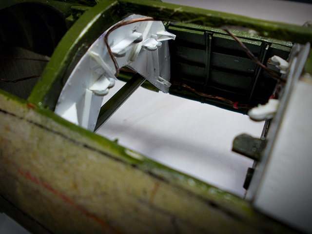

OMG!..The next correction was a lot more difficult!
One of the bulkheads at the rear of the tail wheel was in the wrong position by at least 5-7mm. Doesn’t seem much in the scheme of things but it was throwing all the detail that I had to do out of scale! …here is what I mean…
It took me some time but adjusted it all in the end with pieces of plastic!

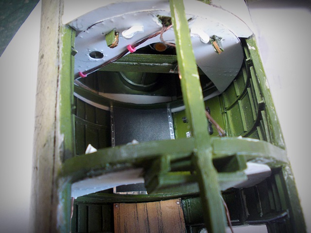

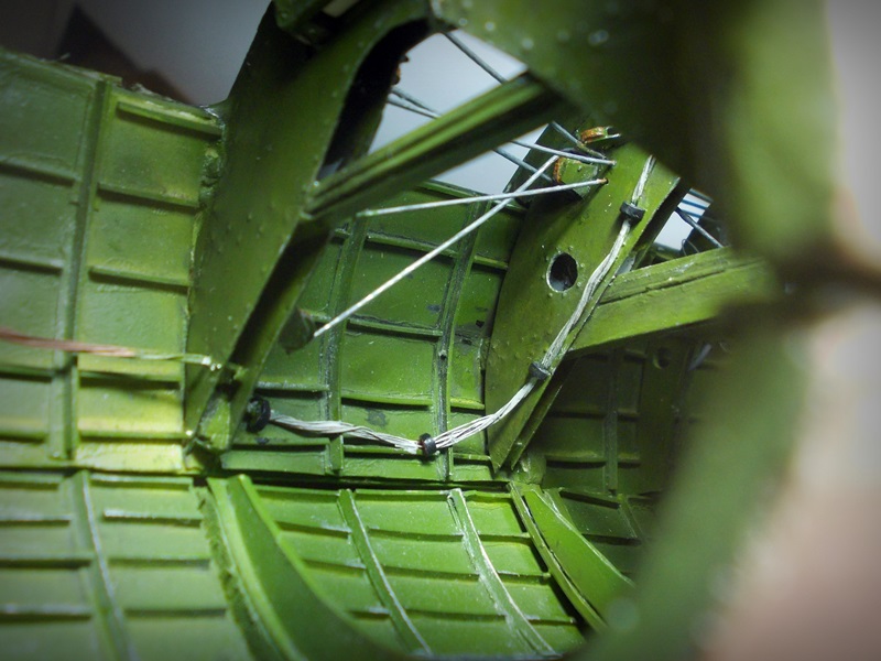

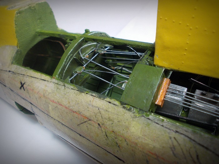

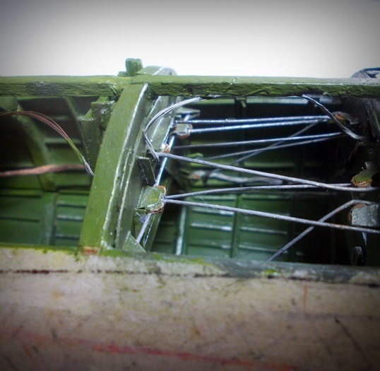

Now I was ready to detail the area with the use of the new photos. Between the two bulkheads past the tail wheel there is all the pulley system used to pass the control cables to the elevator and rudder…all very small and fiddly…for example here is one of the many pulleys I had to make…
So the next 6 photos show the re vamped bulkheads with all the pulleys attached …
Here is that section painted…
Although it set me back a week or so I am pleased that I made the correction…I have to say it was driving me mad as I knew it wasn’t correct…at least now it looks a lot better!

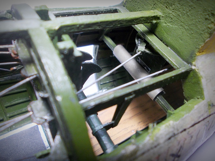

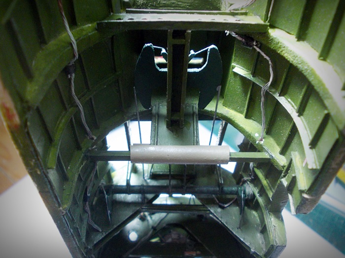

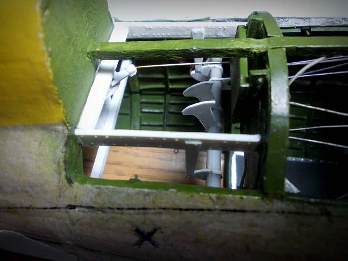

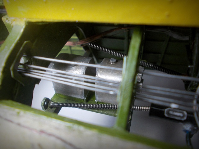

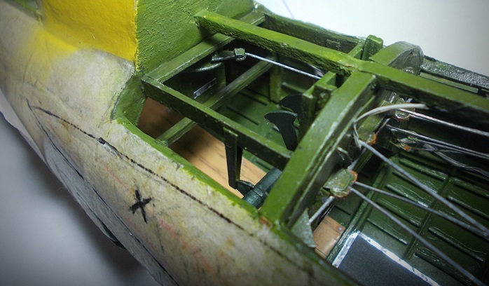

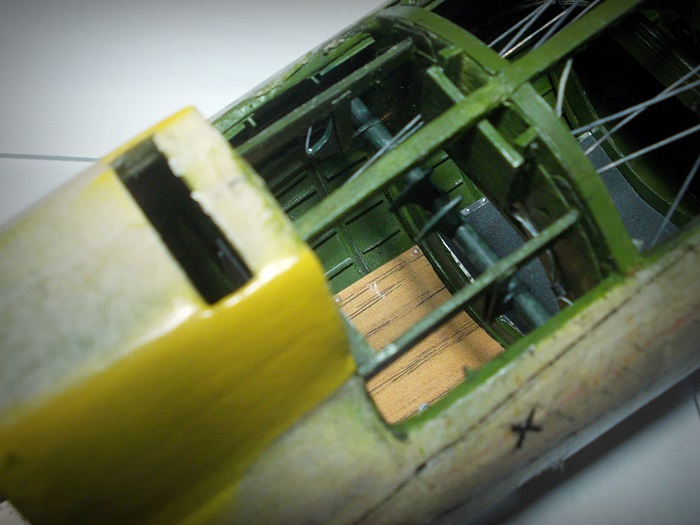

So this final post of this year is all about the elevator and rudder actuators…wasn’t an easy task as I only had a few photos to go by kindly donated by Ol’scrapiron…but I got there in the end and this is how it all turned out.
To start with, this is the elevator mechanism.The tube/bar was made from an old plastic sprue and the rest from cut pieces of plastic…
You can see a few cables attached that operate the mechanism.
The next few photos show it all painted…

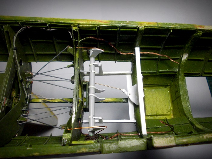

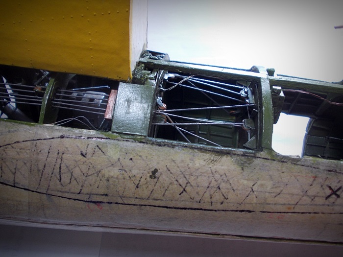

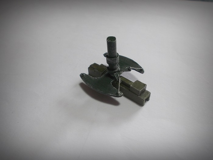

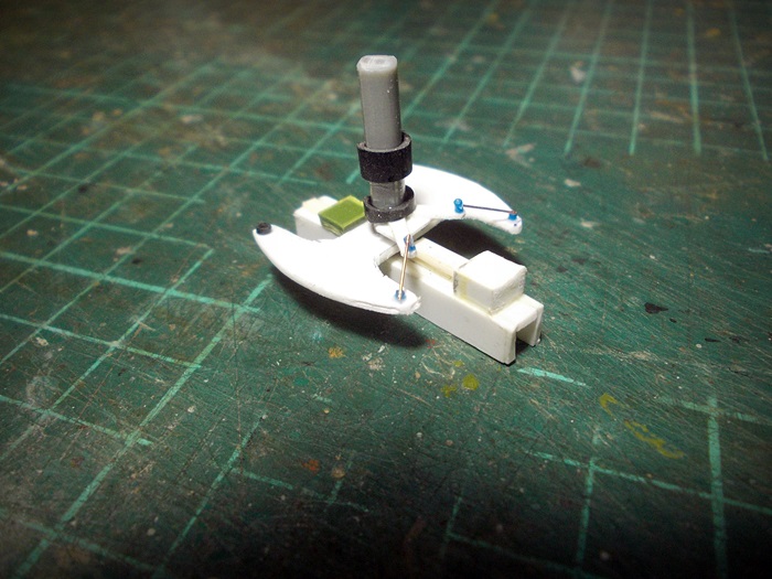

Now I turned my attention to the rudder actuator…which was difficult as I only had shots of a very small part of it. Not to worry as when in place under the rudder you can hardly see it!..so I was lucky!!
Here it is …

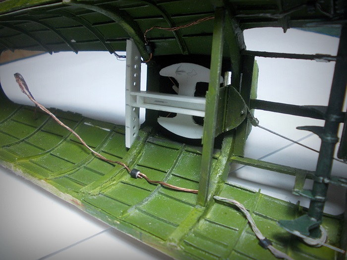

The platform was then constructed out of plastic and the mechanism dry fitted in place…
Finally I painted the rudder actuator before placing on the frame…
and then painted the frame and placed the actuator in position…
Photographing this area isn’t very fulfilling as you can’t get the camera in the right position to take the shot …but hopefully you can see the progress that I’ve made!

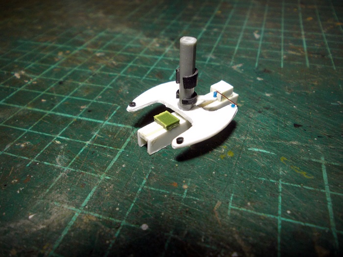

First things first…I made the support post and platform for the MGs…as you can see in this photo…
A plate made from plastic card was then built which will eventually sit in position above the guns…
I then painted the gun support…

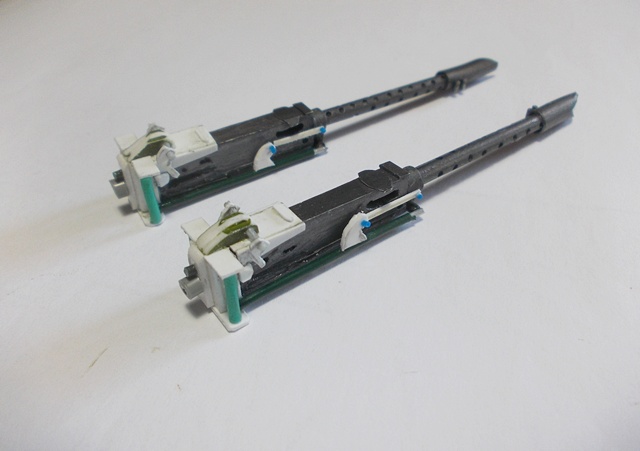

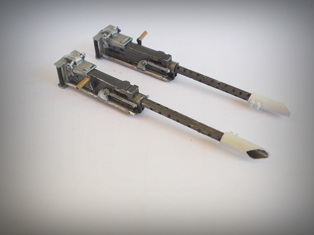

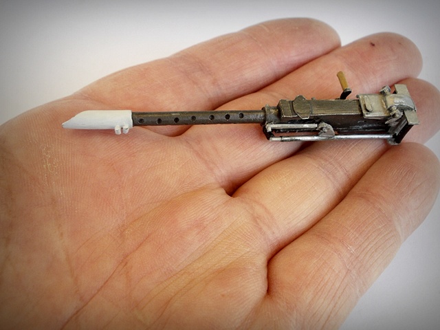

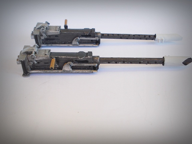

So … because I have still got to do another two MGs for the waist guns later , I decided to build those along with the two that will go in the tail…I cut some plastic pieces into blocks that will be the basic MG minus the barrels!
…and with the use of photos added the detail onto the blocks…

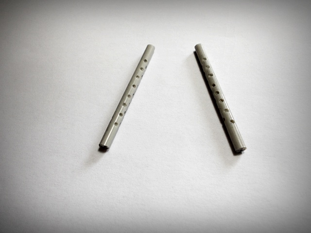

Plastic sprue came in handy now for the barrels…luckily I had just the right size!
Pieces were cut to length and the barrel shroud was simulated by drilling holes along the length of the barrel…
I placed flash suppressors, made from wire insulators onto the end of the barrels and then glued them onto the MGs …and then painted them in Gun metal…
At this point I decided to place some detail onto the front end of the turret…I had done it months before but the detail somehow fell off!..this time super glue was used!!
Adapter- gun mounts were made from plastic and wire and attached to the MGs…fiddly as hell!!
That was then all painted.
The next 5 photos show the MGs all finished…

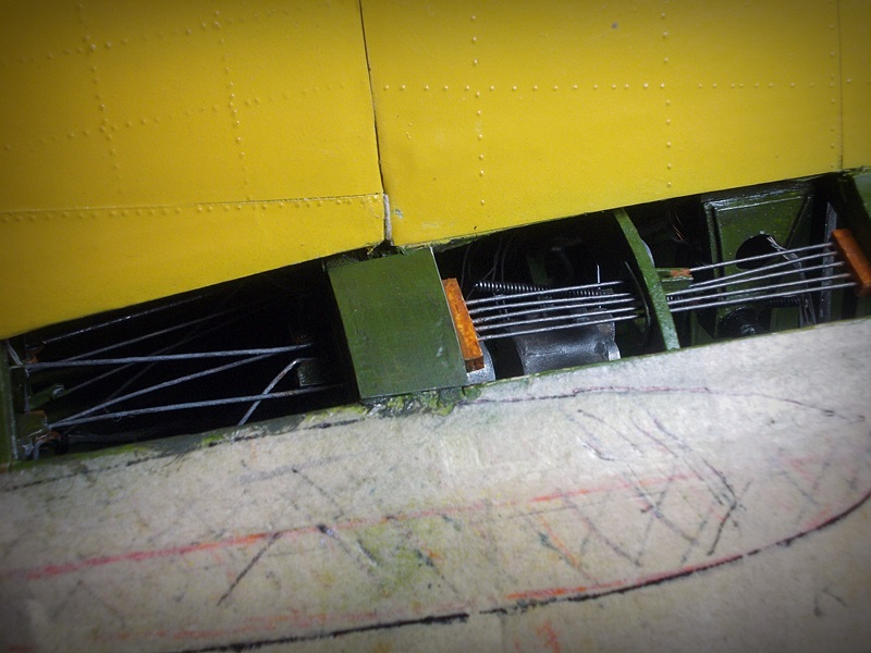

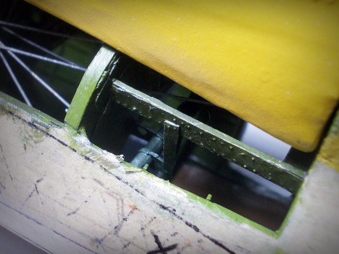

OK …so I managed to get the Tail plane connection area complete…difficult shapes as the fuselage is round of course!..but I also added a bit of detailing as you can see in this first photo…
So I made the simple cartridge shoot for the Cheyenne turret and cut a slice of Coca Cola can for where the barrels go into the turret.

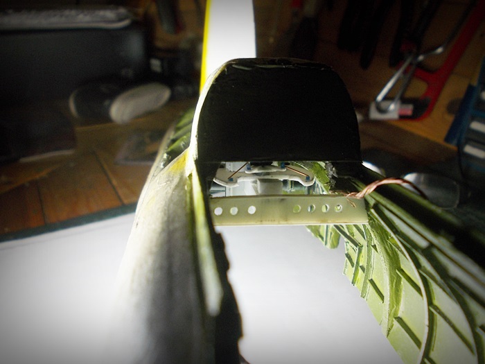

Now onto the Tail plane connection.
This was all scratch built with plastic card. If the tail plane was off the fuselage this is what it would look like. The protruding sort of 4 bars you see would be connected to the horizontal stabilizer and in the D shape there was a cog that operated the elevators…
After it all was painted and weathered a tad this is the end result!..I made little canvas bags out of tissue paper to go over the D shape…this was to protect dust and dirt from entering the fuselage …and saved me making connection cogs!
…and here is the tail section so far!..

I have finished both waist guns except for the ammunition belt which I will have to think about as it won’t be easy!
First off I had to make the swivel mechanism that holds the gun in the perspex…so this first photo shows the wooden stick I will use!..just thought you might like to see the stick!!!
After sawing a piece off and drilling a hole and sanding…this is how it looked…
Next photo shows the 2 plates that the swivel mechanisms are bolted to…
here we have it glued to one of the window frames…
The next photo shows a dry run of the fitting of the MG…and looking at it I must remember to take the sight post off the end of the barrel as that’s for the MGs without the compensating sights on!
I rummaged through my collection of clear plastic packaging and found a suitable piece to make the perspex for both windows apertures.
I already half built the guns a few weeks back and now it was time to finish them off…
…and here they are completed …

Last post had me fitting the waist guns into the perspex windows but the very last detail after 10 years is to make the ammunition belts that feed the guns…so here are a few photos…
The ammo belts have to be able to twist and turn from the ammo boxes to the guns so I had to scrap the belt I had previously made as they wouldn’t bend without snapping in half!..so I decided to use slivers of aluminum from a Coca Cola can to make up the shape I needed to go from the ammo boxes to the guns!..you follow me?..probably not!..so here is a photo!..
In this way I have it bent to shape before I super glue all the hundreds of rounds…(cut pieces of wire…took all afternoon!!)
This next photo shows some of the rounds on the belt.
All I had to do then was enclose the rounds in the belts using strips of paper which when painted will hopefully look the part!
Here you see I have attached the belts to the ammo boxes and to the guns…starting with the starboard MG
Here is the port MG
…and a couple of shots looking at both Waist guns from the rear…
Now came the part that I had been dreading for months and months and that was gluing the top and bottom halves together!
It had to be a strong setting glue that would be permanent and since the fuselage is constructed out of balsa wood I thought wood glue was the way to go…nope!..it’s no good…it will have to be super glue!..but I had to work fast and be accurate as if it didn’t line up it would be impossible to take it apart without destroying the fuselage!..so working from the rear to the front I super glued a few inches at a time…remembering to make sure all the internal detail was in line from the top to the bottom!
Finally after a few nerve racking minutes it was complete!..all lined up and secure!..
That for me was a huge worrying part of this build…it was as well for the front section ,Bomb bay ,radio room!..still all done now!
Skinning!..I kind of enjoy it!..very slow process but if I can get it right then worth the effort!
First of all I had to mark the entire fuselage with a marker of where all the rivet lines go…that took a day!..and then all the separate panels had to be cut out of a sticky back aluminum sheet used on real aircraft kindly donated by my good modelling friend Finn and marked up for rivets and then placed onto the fuselage…here are a couple of photos I took during the process…
So here we have in the next batch of photos the fuselage all skinned.
