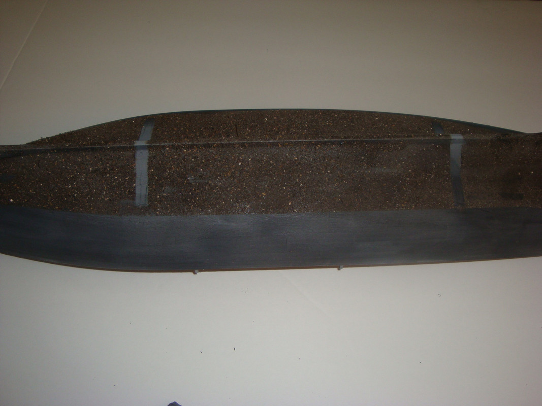

The next one is the bottom of the hull with the barnacles:
hull botton

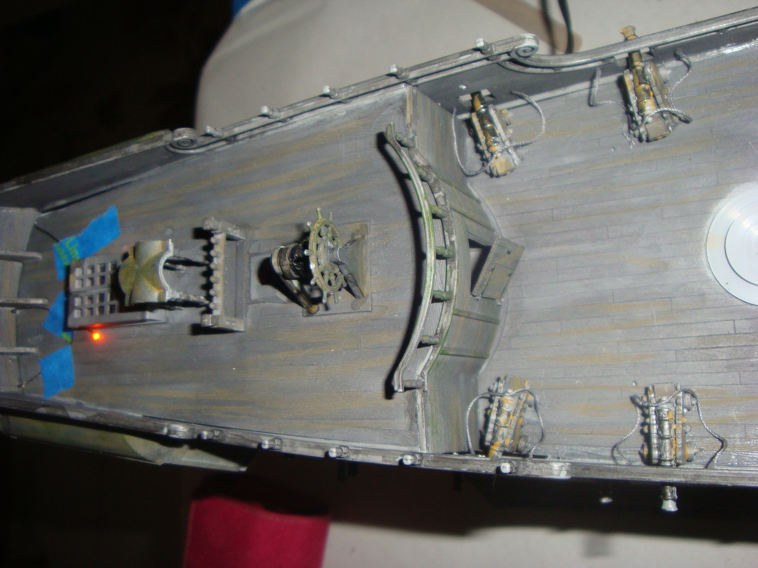

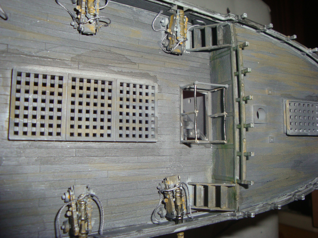

And last is the top deck with preliminary weathering:
Top deck
I hope you guys like what I have done so far. I am planning to use cloth sails since the vacuum sails that comes with the kit are rather thick and not very realistic, also I will be doing the shrouds and rat lines instead of using the kit ones.

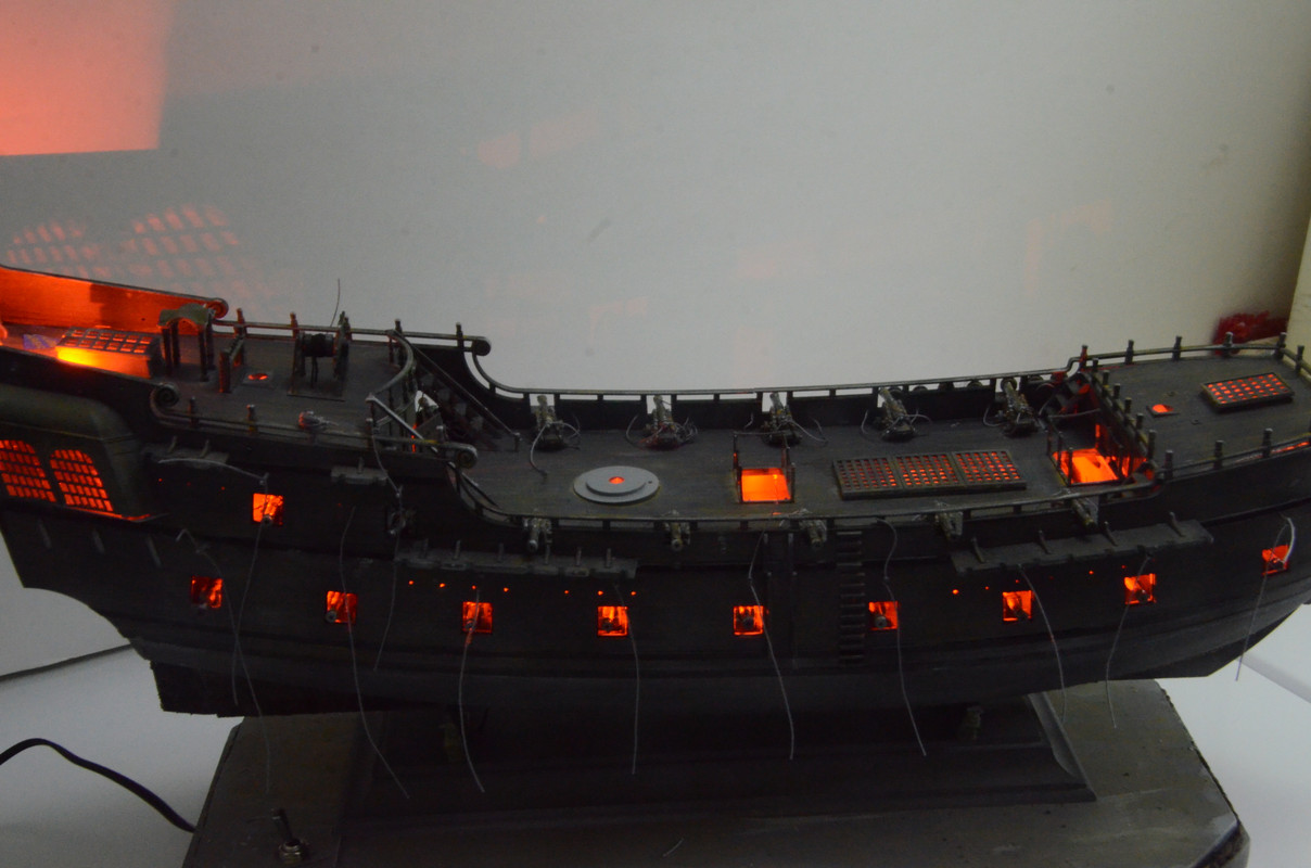

I have not posted much lately because I had to stop building due to an error in the lights order, my som-in-law mistakenly order flashing lights instead of flickering, so I had to call the company and had them replaced, the company, Evans Design, worked with me to get the right lights. It is refreshing to find a company now days that still wants to make sure that their customer is satisfied.
Attached are some photos showing some progress:
Ship side
The cable in the photo is the power supply ( A 7 to 12 volt transformer), it goes to a switch that allows the lights to be turn on and off. I an still working on improving the weathering.
Fron the top
Back
The following photo I took it in my laundry room using a small flashlight as main light, so the ship lights could be seen, the bright lights in the back are the one that are going to be used for the lamps.
Lights on
In here the switch is visible. The reason I added the wooden base was to hide some of the wiring and also to have a place to put the switch.

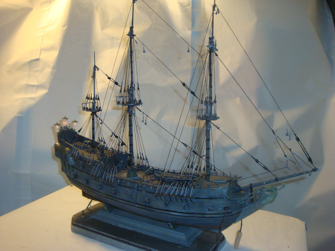

Time for a progress report! The Pearl is coming along nicely, the masts are up, I just finished the shrouds and starting to do the rag lines. I am not using the kit provided shrouds, since they are not very realistic and they do not fit properly in the masts, next I will start the work on the sails, I have discovered that the mast that holds the sails provided by the kit is molded to the sails, which means that I will have to construct the mast then attached it o the my sails. I was lucky that I was able to find in Hobby Lobby a dowel of the right size, with a little sanding I may be able to create the taper to make it look like like the actual mast.

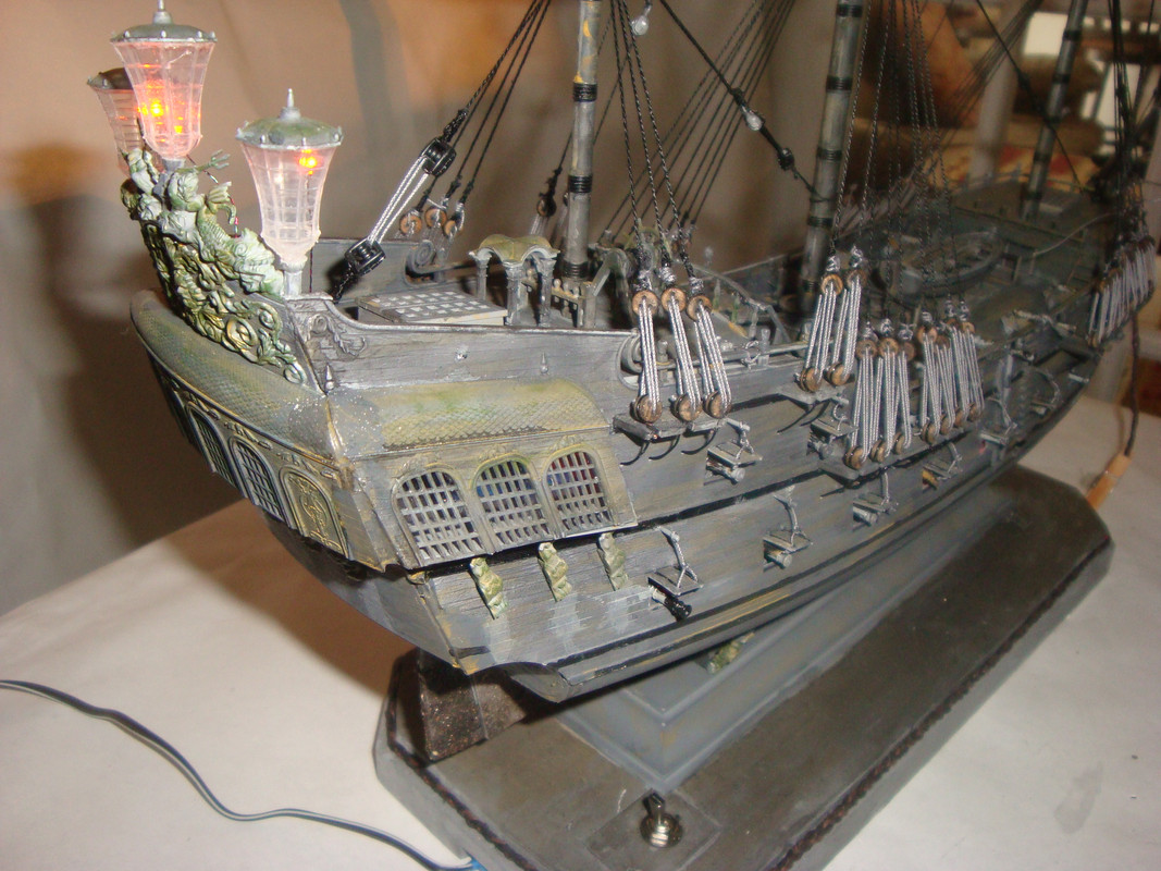

Following a side view of the ship with its lights on:
Ship side
Rear of ship were the lights can be seen in the lamps and also shows the on/off switch.
Rear of ship

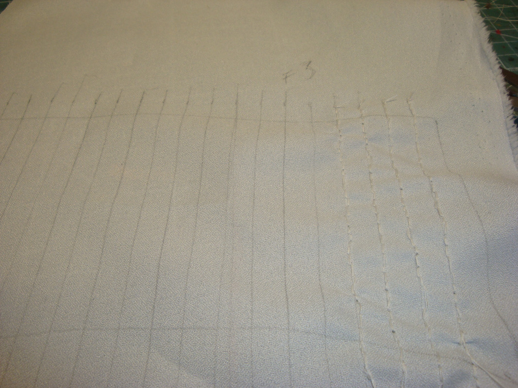

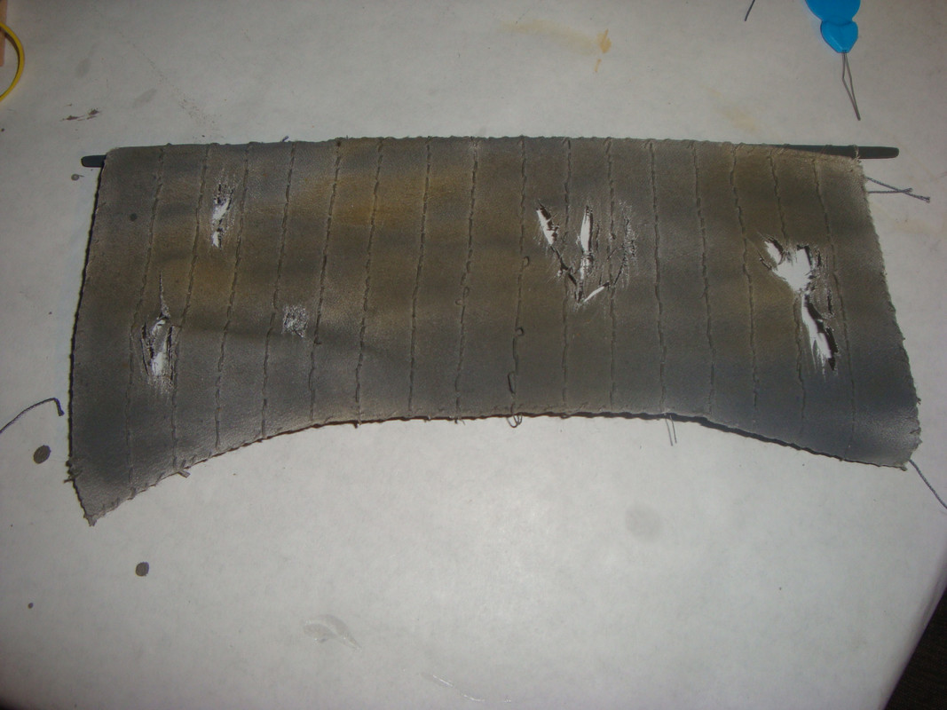

I have finish making the sails, I first sew the line on the sails, then added a border to them. Here is the first photo:
raw sail
The second photo shows the sail after painting it, I airbrushed it using Tamiya dark Grey then lightly sprayed it using Vallejo ochre.
Oainted sail
In here I attacked the sail with my hobby knife to create a distressed appearance.
Distressed sail

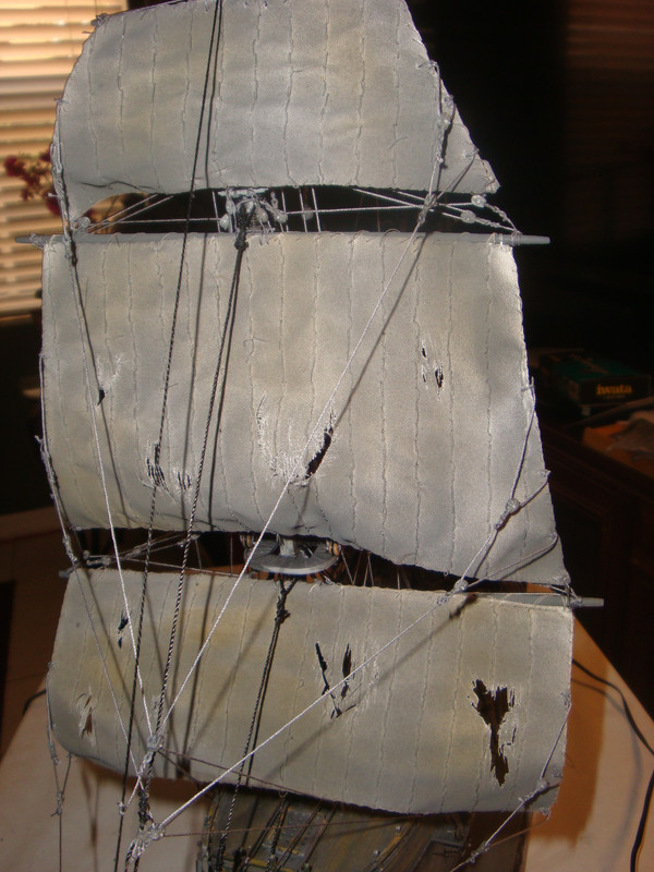

Finally, here shows 3 of the sails already mounted to the ship. Those of you who has build this ship knows that the rigging is rather complex, it takes me 1/2 hour to attache a small sail and 2 or more hours to mount the bigger ones.
sail on ship
