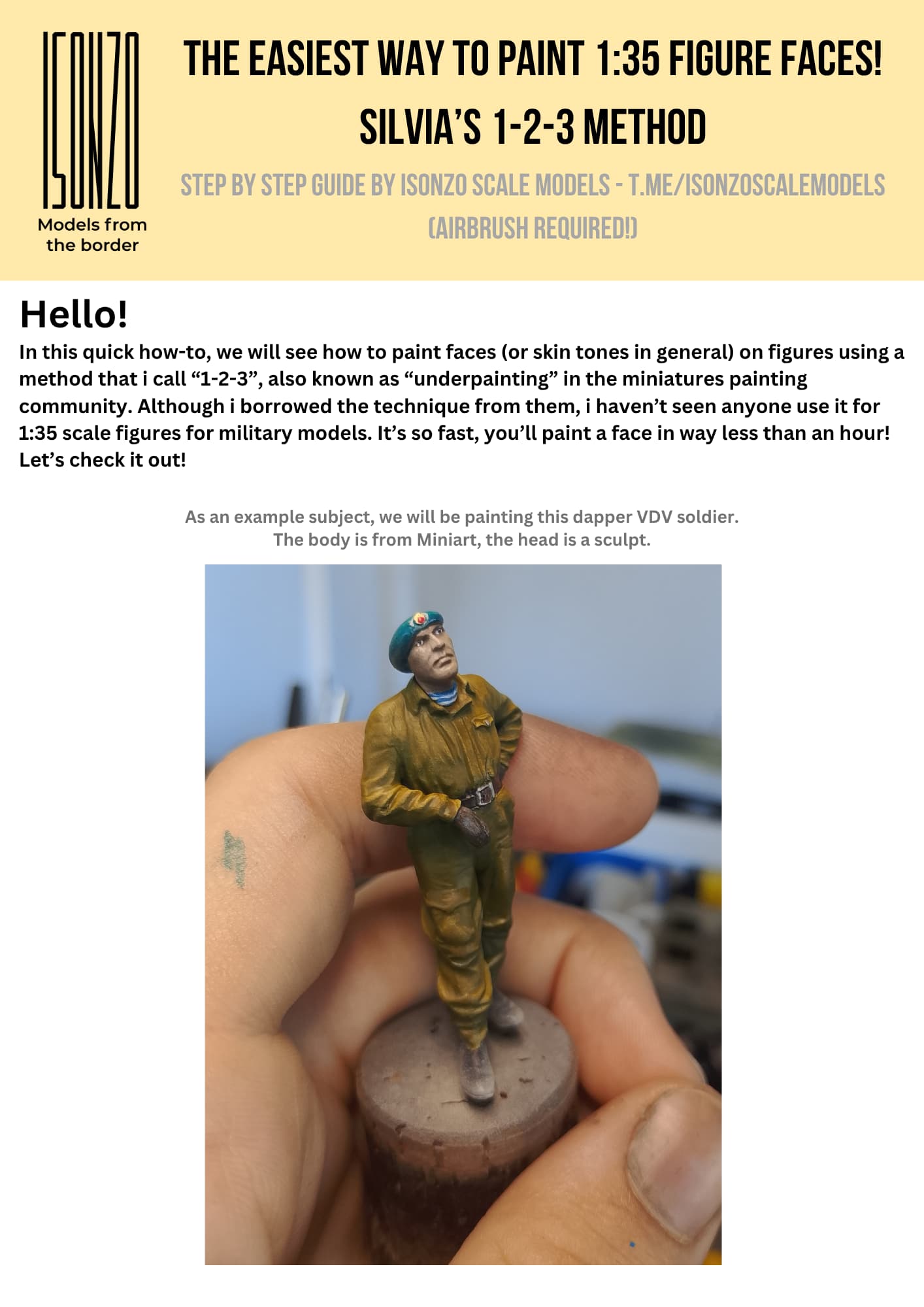

Hello there!
My name is Silvia from Isonzo Modelworks.

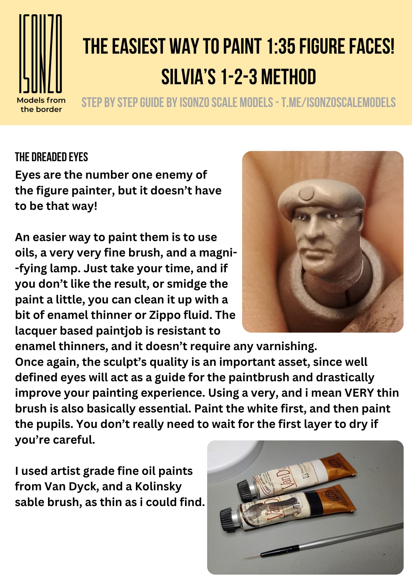

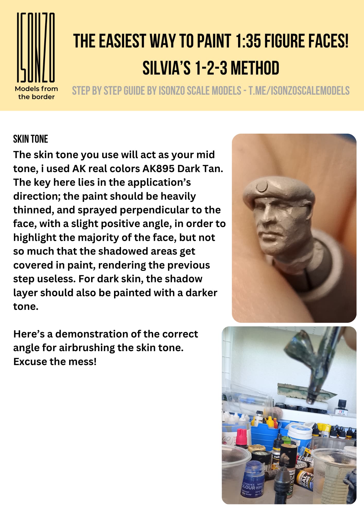

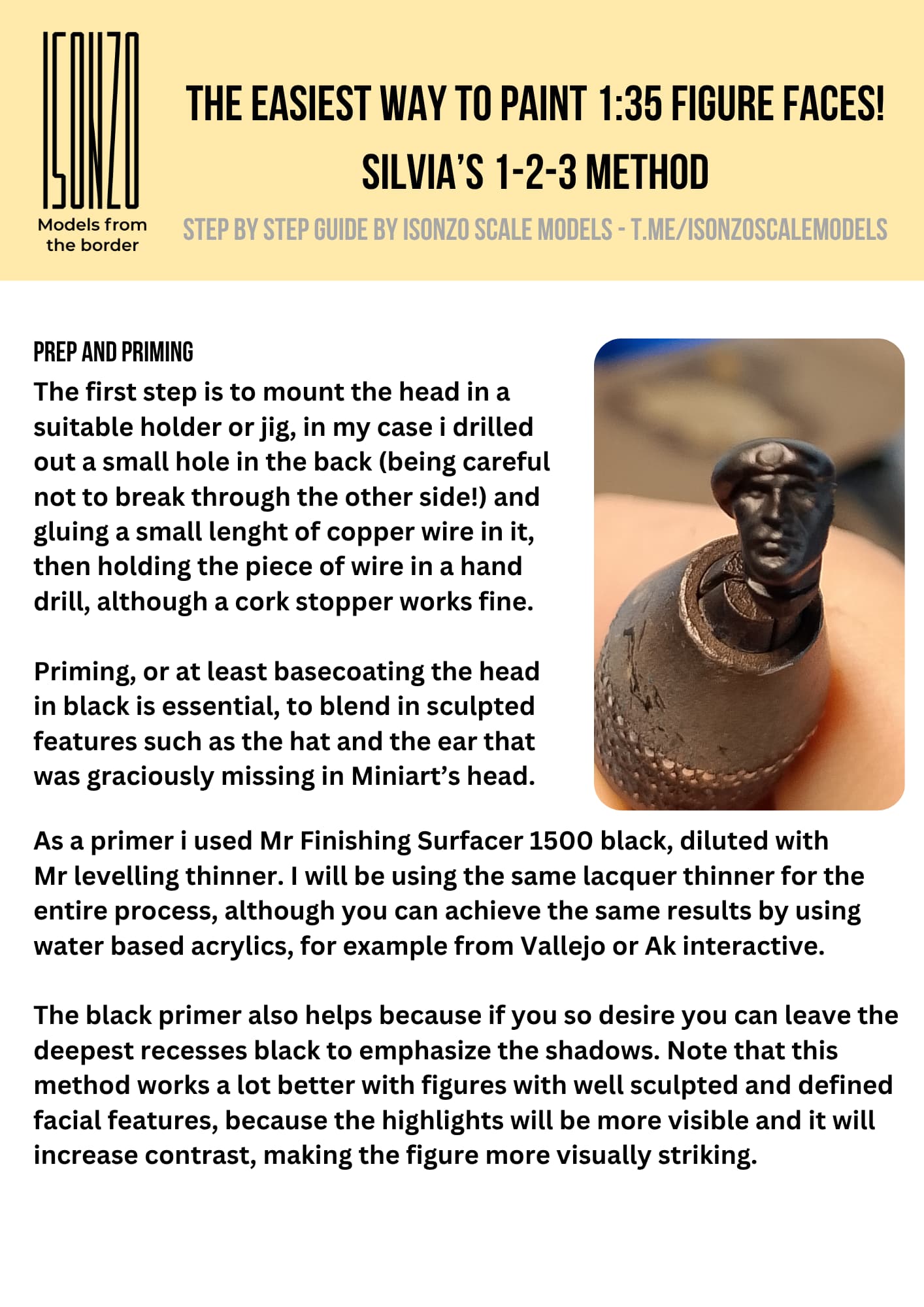

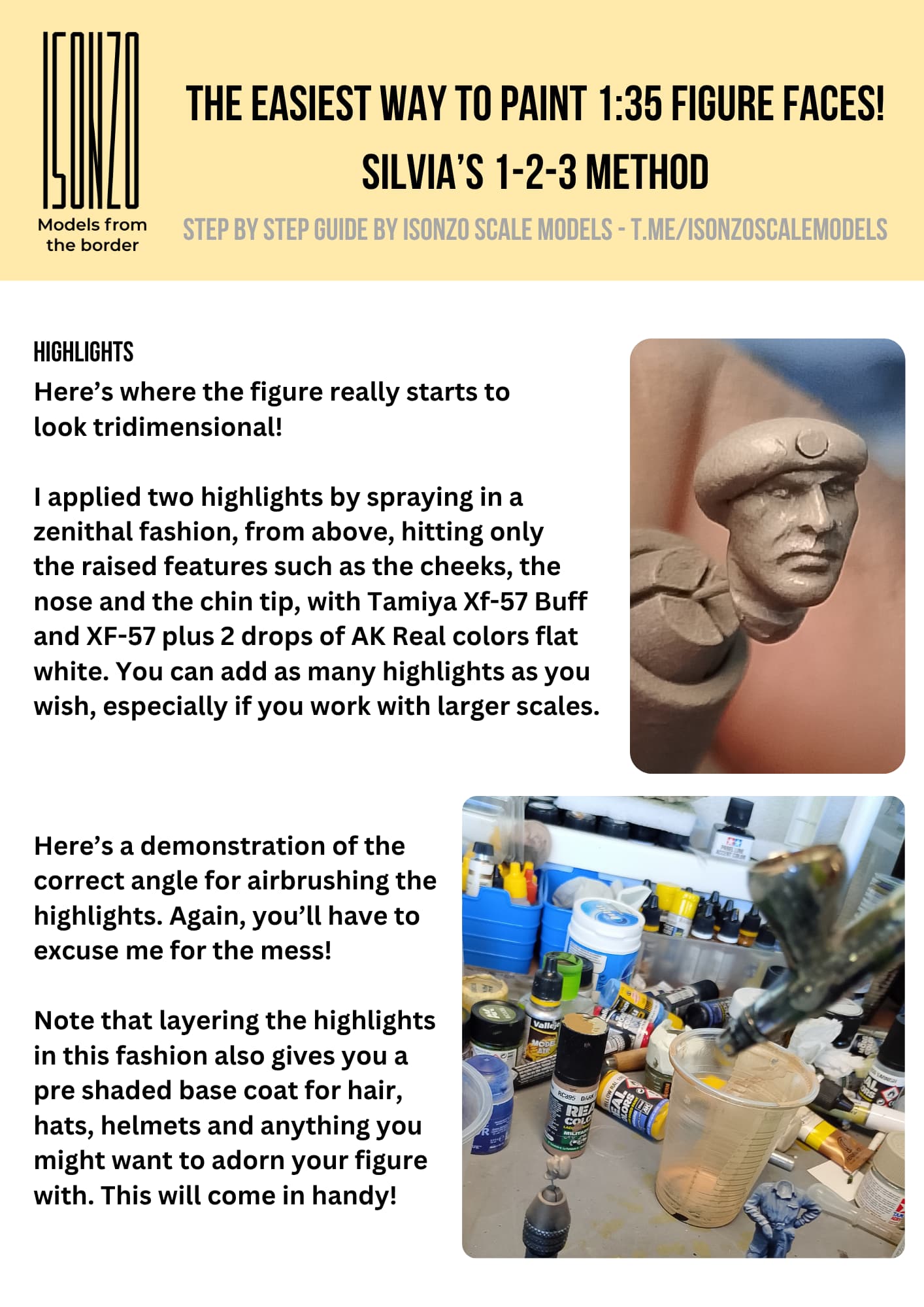

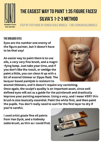

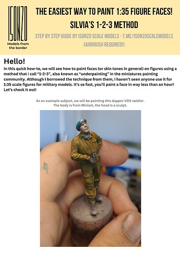

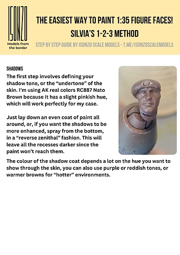

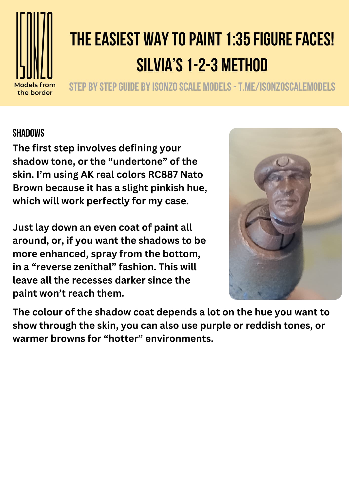

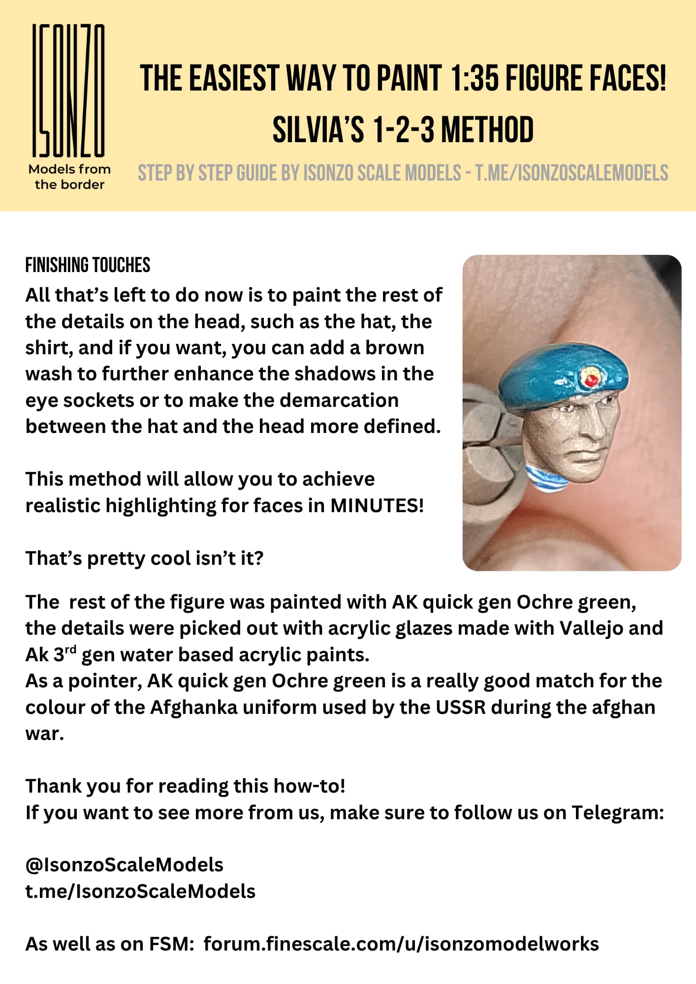

I have developed a method for painting 1:35 scale figures faces that is literally so much easier than almost anything i’ve seen so far. In my case i used an airbrush but it should also work with sponges!
i hope you enjoy it and if you do, post the results in the comments!
it also works for hands, legs, arms, and any patch of skin, of course! ![]()
